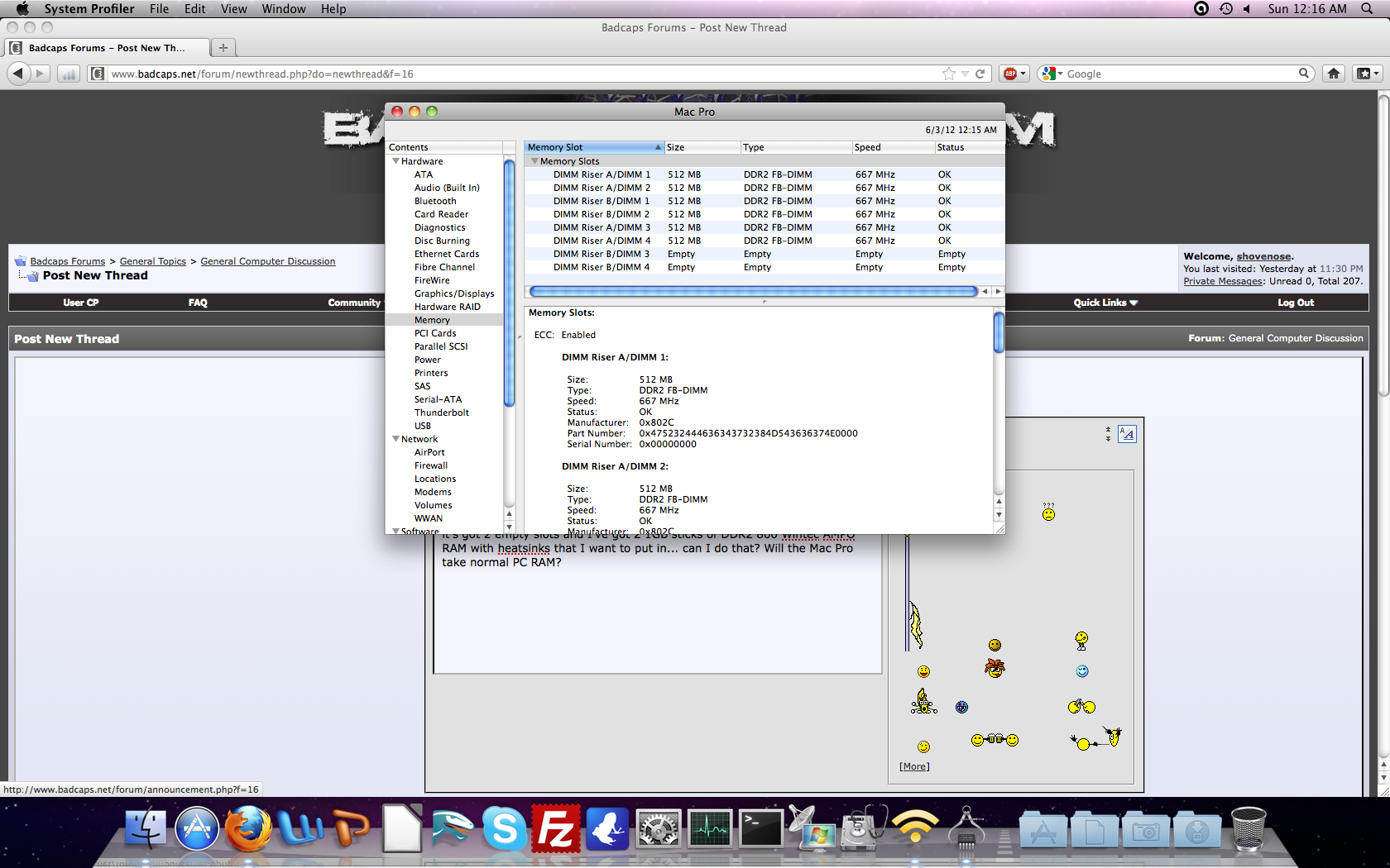

    So I got a 2006 Mac Pro running OS X 10.6, with a 20" Apple Cinema Display.
    I have a question: I noticed it uses "FB-DIMMS" I'm assuming that means they are Fully Bufferred ECC... can I use completely normal DDR2? Because it's got 2 empty slots and I've got 2 1GB sticks of DDR2 800 Wintec AMPO RAM with heatsinks that I want to put in... can I do that? Will the Mac Pro take normal PC RAM?
    Because I really rather not buy more RAM for it!

    have you tried? the notches shouldn't even line up between FB DDR2 and Non FB DDR2
      Re: RAM for Mac Pro
      FB-DIMMS are Fully Buffered ECC. So no you can not use normal DDR2. Also the memory gets very hot in those machines that is why apple uses the massive heatspeaders they do on the memory. I do not think a normal heatspreader would keep the memory cool enough but it may, just dont have a cow when you fry the ram if you didn't use the proper heatspreader. The memory also has to be installed in pairs as well if I remember right.

            Unfortunately you are right My normal DDR2 RAM won't even fit, lol
