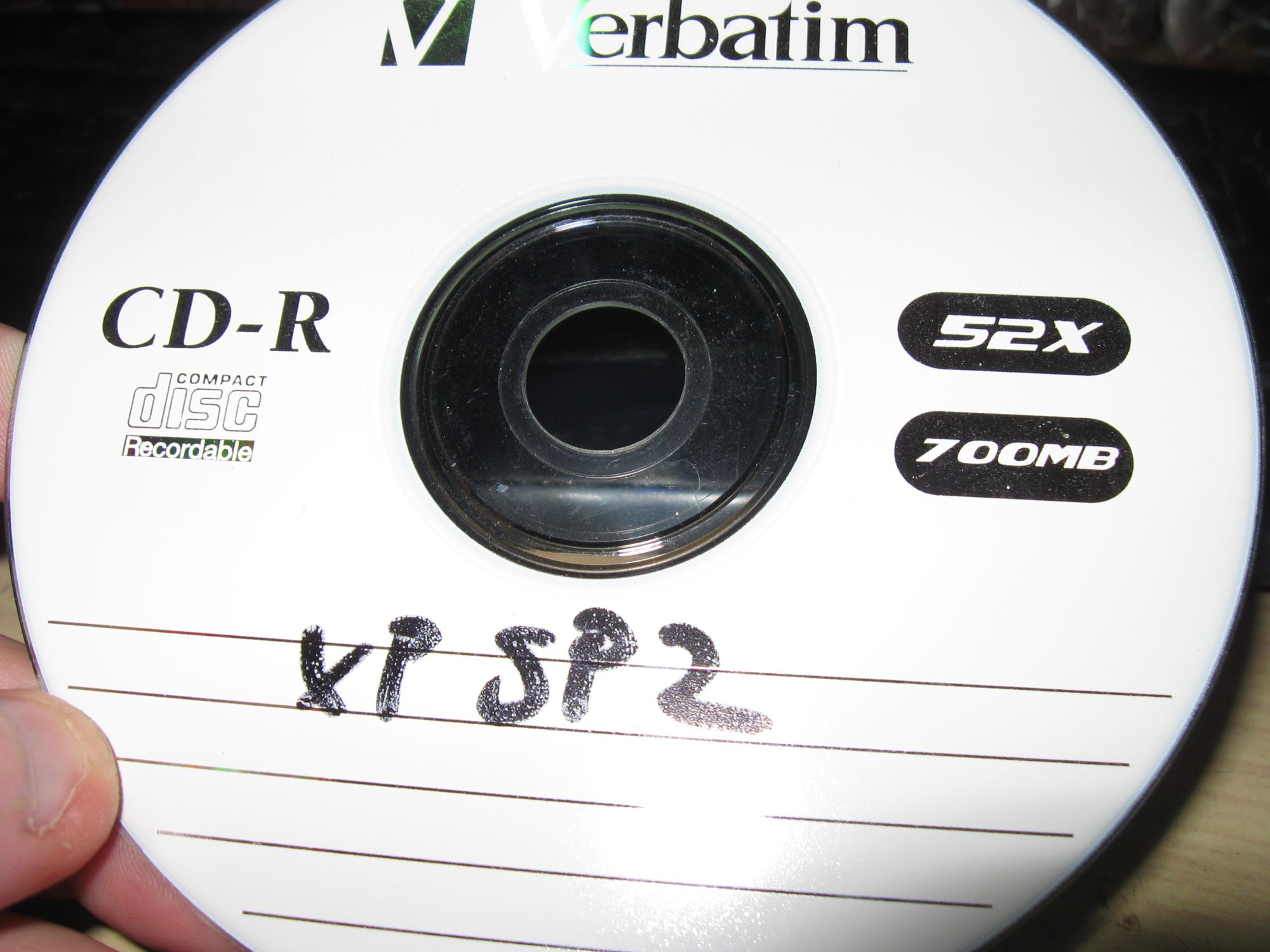

                    non-azo 700MB:
                    ATIP Information:
                    Disc ID: 97m26s66f
                    Manufacturer: CMC Magnetics Corp.
                    Start Time of LeadIn: 97m26s66f
                    Last Possible Start Time of LeadOut: 79m59s71f
                    Performance (Write Speed):
                    Descriptor 1...
                    -> B0: 0x02, B1: 0x00, B2: 0x00, B3: 0x00
                    -> EL: 296658 (0x000486D2)
                    -> RS: 3,656 KB/s (24.4x) - WS: 706 KB/s (4x)
                    Descriptor 2...
                    -> RS: 3,656 KB/s (24.4x) - WS: 1,411 KB/s (8x)
                    Descriptor 3...
                    -> RS: 3,656 KB/s (24.4x) - WS: 2,822 KB/s (16x)
                    Descriptor 4...
                    -> RS: 3,656 KB/s (24.4x) - WS: 4,235 KB/s (24x)
                    Descriptor 5...
                    -> RS: 3,656 KB/s (24.4x) - WS: 5,646 KB/s (32x)
                    Descriptor 6...
                    -> RS: 3,656 KB/s (24.4x) - WS: 7,057 KB/s (40x)
                    Descriptor 7...
                    -> RS: 3,656 KB/s (24.4x) - WS: 8,468 KB/s (48x)
                    The max speed inside the disc is listed as 48x, the disc outside says 52x. Also, outsourced to CMC Magnetics. OK discs, but not comparable with AZO.

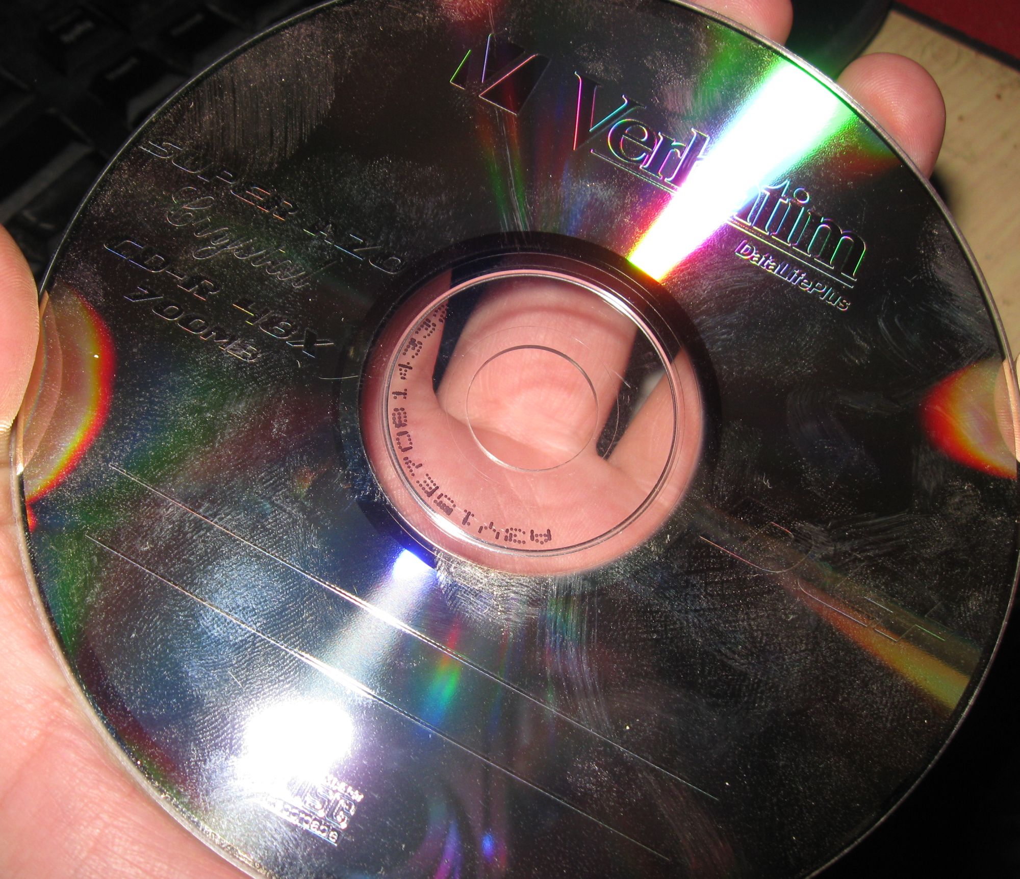

                    And now the real thing, AZO CD-R, Verbatim DataLifePlus :
                    ATIP Information:
                    Disc ID: 97m34s23f
                    Manufacturer: Mitsubishi Chemical Corp.
                    Start Time of LeadIn: 97m34s23f
                    Last Possible Start Time of LeadOut: 79m59s73f
                    Descriptor 1...
                    -> EL: 323996 (0x0004F19C)
                    -> RS: 3,654 KB/s (24.4x) - WS: 706 KB/s (4x)
                    Descriptor 2...
                    -> RS: 3,654 KB/s (24.4x) - WS: 1,411 KB/s (8x)
                    Descriptor 3...
                    -> RS: 3,654 KB/s (24.4x) - WS: 2,822 KB/s (16x)
                    Descriptor 4...
                    -> RS: 3,654 KB/s (24.4x) - WS: 4,235 KB/s (24x)
                    Descriptor 5...
                    -> RS: 3,654 KB/s (24.4x) - WS: 5,646 KB/s (32x)
                    Descriptor 6...
                    -> RS: 3,654 KB/s (24.4x) - WS: 7,057 KB/s (40x)
                    Descriptor 7...
                    -> RS: 3,654 KB/s (24.4x) - WS: 8,468 KB/s (48x)
                    As you can see, not lying about the max speed, 48x on it and in the profiles...
