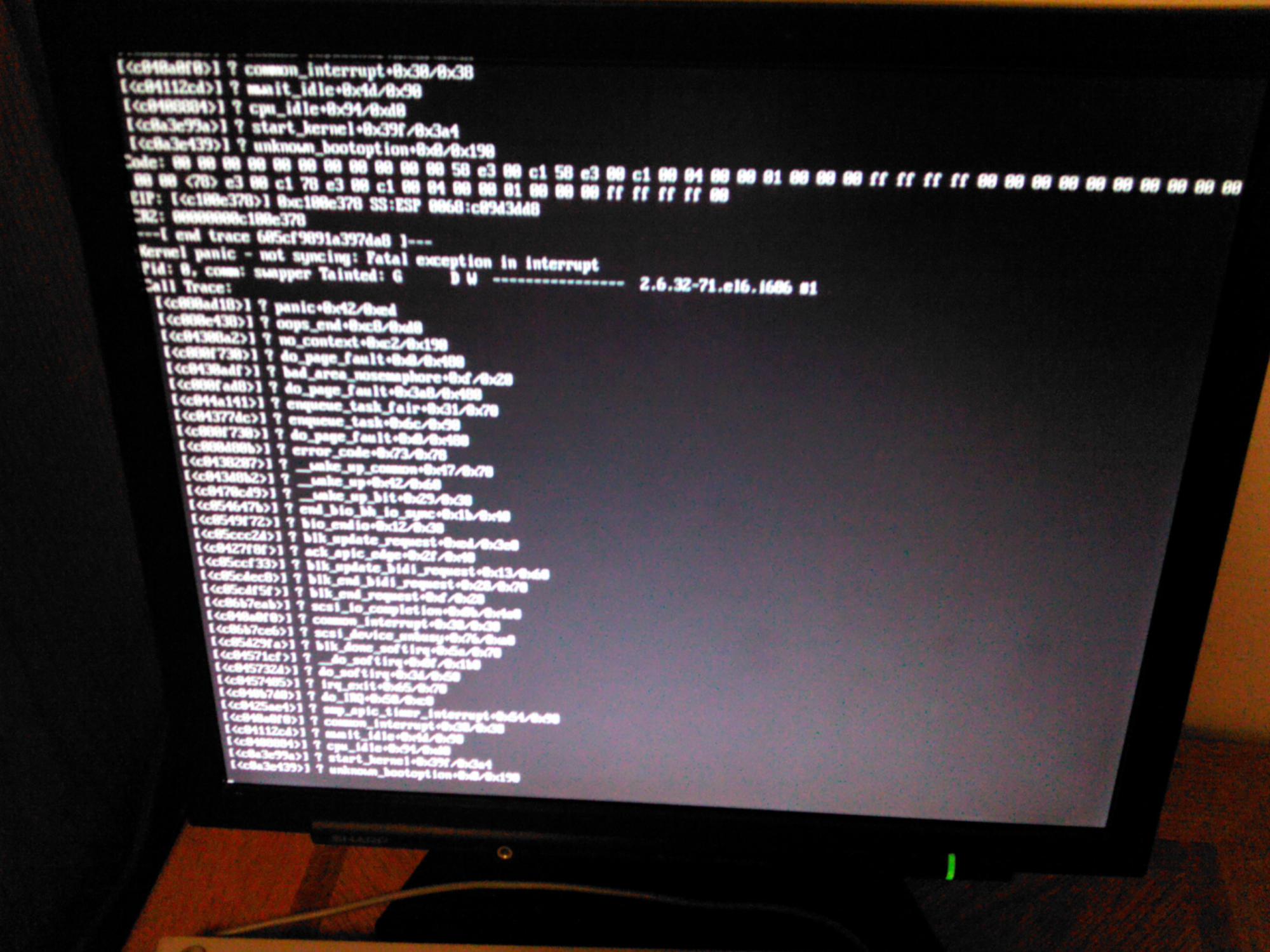

    My intel D201GLY mobo is quite annoying.
    I'm trying to set up a server for school (I've got the green light to do it from one of the high-level IT people in the school district).
    It would basically be a Windows deployment thing.
    I'll need help setting that up, but step 1 is getting the computer to work.
    And I'm already stuck on that...
    If I try to install XP Pro SP2 it will hang Setup while inspecting my 40GB seagate HDD. If I try Lubuntu or CentOS6 I get a kernel panic
    1GB DDR2, Celeron 1.33GHz CPU, 250W PSU,
    what the heck am I doing wrong?!?!

      What's the kernel panic say? Lots of important information there.
      Any bad caps (do we have to ask )?

        Nope, lol! The motherboard was NIB off eBay, the PSU is a re-capped (by me) FSP/SPI 250W. The original 250W Lite-On was causign the same problem, that's why I switched to the FSP...
        The Kernel Panic on CentOS is different from the one on Lubuntu. Which one do you want?
        Also, the Scroll lock and Num lock lights on my (PS2) keyboard blink after a kernel panic, is that normal?
        EDIT: Attached is the CentOS 6 32-bit kernel panic. Sorry about the lousy picture, that was taken with my Acer Iconia Tab A100

          OK, I had a brilliant idea: memtest from CD
          Almost immediately it started flipping out and it said it stopped running because of some unexpected interrupt or something...
          So I tried a 512MB DDR2 instead of a 1GB... So far (3 mins) no memtest issues at all...
          great, so I've established that my computer works.

              When you first described those symptoms ram was the first thing that came to mind.
              Why would you get such a nasty board? SiS isn't bad but it isn't the best. If you're using it for testing purposes it should be ok. What kind of server is this?

                I have the exact same board.
                it ran ubuntu 11.10 with a 1gb module installed without issues other than the worst graphics ever (static everywhere, unusable). I tried a different gpu driver via a PPA which made the 2d performace great but the 3d disabled (open source driver w/o 3d yet).
                I doubt your issue described is an SIS problem.
                sounds like you have a bad or non-compatible RAM module. The 1gb that worked for me was a PC5300 Corsair module (pulled from my main rig)

                        There have been 13 BIOS updates to that board and most have to do with the SIS chipset.
                        Lots of mods to make video, lan, RAM, and drives work right. [On just THAT board.]
                        Wouldn't be like that if the SIS chipset adhered to the accepted standards to start with.

                          I'm installing the latest BIOS update right now
                          It actually performs quite well (on XP Pro) with "384MB" of RAM, an old 5400RPM 40GB Seagate hard drive, and all that
                          Edit: well at least now it boots up with my 1GB RAM stick in there... but it BSODs almost immediately after starting up. Gonna try some different RAM...
