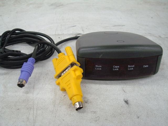

    Yesterday I aquired an old IR Mouse/Keyboard set...
    the issue is that while it uses PS/2 for the keyboard, it uses serial for the mouse.
    this is fine for windows, but for linux, its a PITA at best... I couldn't get it to work despite my best efforts.
    What I would like to know is whether they make serial to PS/2 adapters... I know microsoft made one at one point and that the linux tool I was able to get to work reports the mouse as using the intellimouse standard...

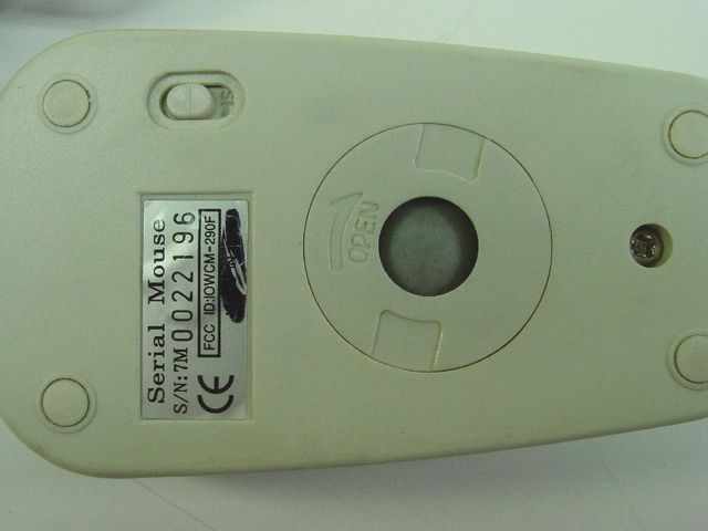

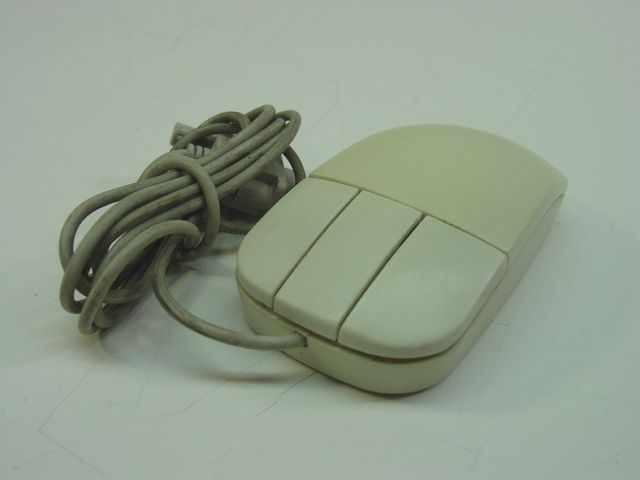

                Read the fine print in the ebay listing:
                PLEASE NOTE: This product will only work with combination mouse, a mouse electronically designed to work with both serial and PS/2 applications,
                Your mouse has to have the appropriate guts inside it for this to work. The 'converter' from the first ebay link is strictly passive. In other words it only converts pins from one connector to the other.
                Mice that supported both typically had a switch on the bottom to tell it what kind of port it was being hooked up to. I think there is one at the office that I can snap a picture of if you don't believe me.
                Edit: found some pictures (attached - site is slow)...
                http://www.recycledgoods.com/product...MS-Switch.html

                  it emulates a MS intellimouse if that means anything (the linux tools said it needs the intellimouse serial driver, not the standard mouse serial mouse driver)
                  from what I have read, it probably isn't convertable so, yup, i'm screwed.
                  EDIT:
                  WAIT- there is hope!

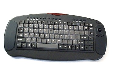

                  my set is one of these:
                  while finding that I found this pic of the receiver:
                  sounds like if I can find the right adapter, I am in luck.

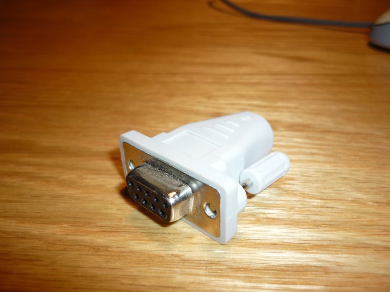

                    Re: Serial to PS/2 adapters
                    Maybe one of those standard adapters would work, then.
                    -David VanHorn
                    • bluto
                      • Oct 2007
                      • 560
                      Yea looks like it would be worth a try. I thought I had one to give you but it is the wrong gender variety...
                        I have one of those...
