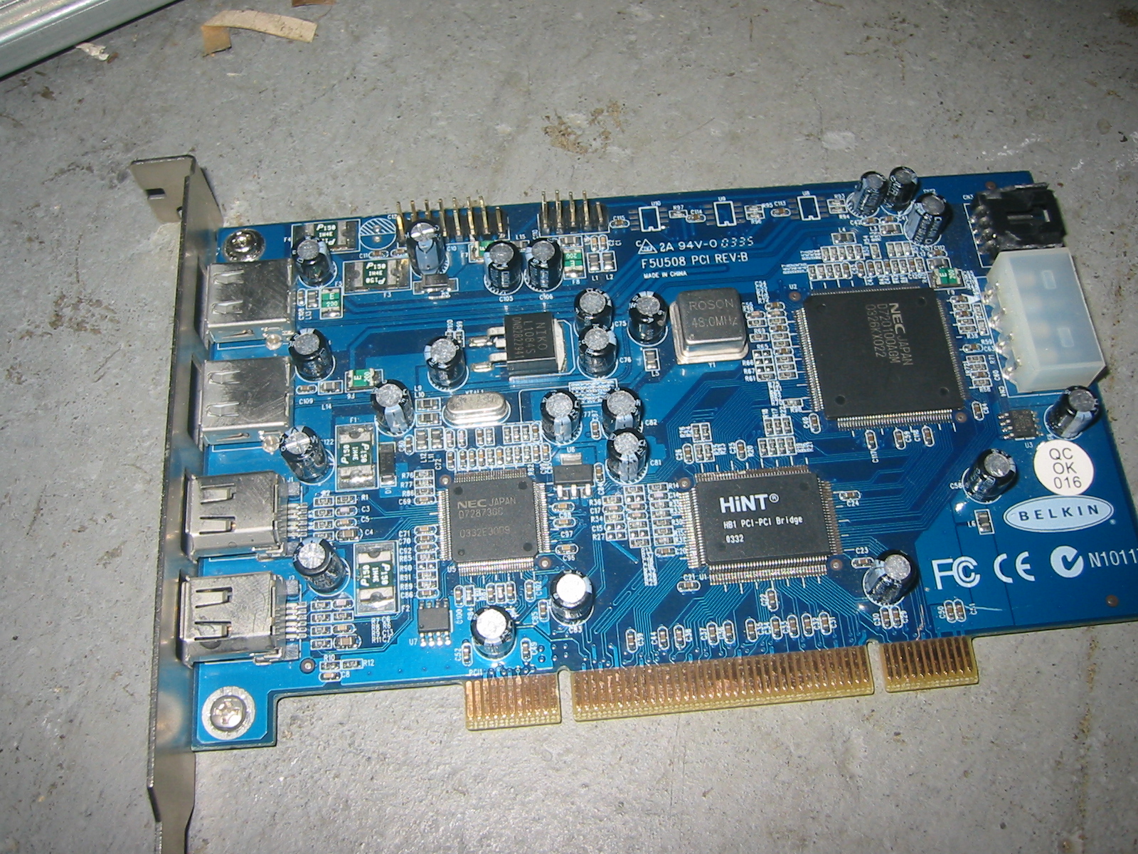

        modded the usb/firewire card
        about the crad:
        -has 2 chips, one for firewire, one for usb 2.0
        -both chips are NEC made
        -has 2 external usb2.0 ports, one internal usb port, and 2 external firewire ports. also has a couple headers which I have no idea about.
        -it also has a molex connector to give extra juice to the firewire
        -it's blue and matches the mobo and graphics card (and psu)
        what I did was I cut and desoldered the cd-out port off a dead optical drive and swapped that for the intenal usb port. this way, i can use that port for my card reader/floppy combo.

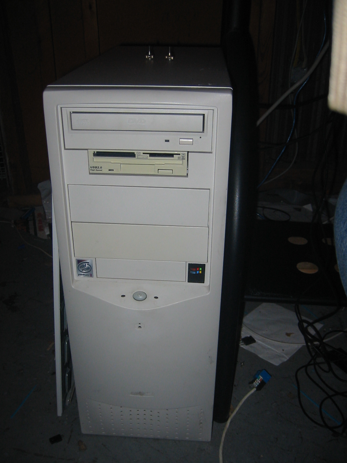

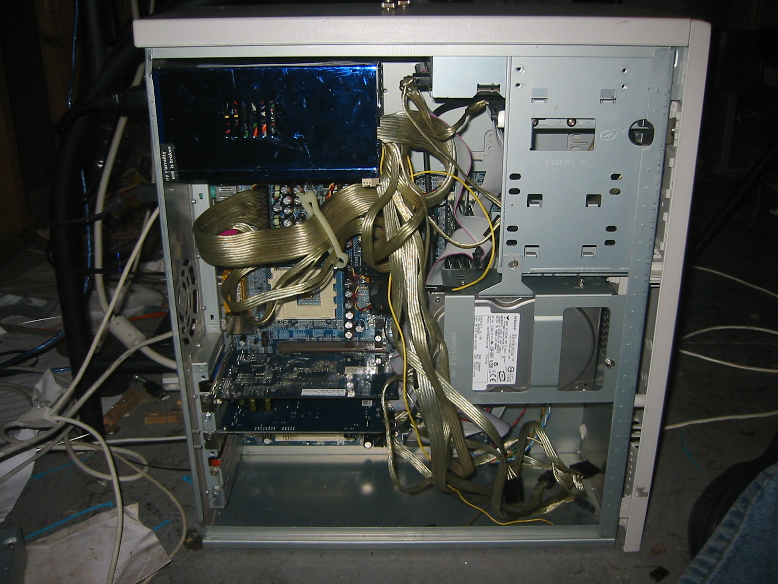

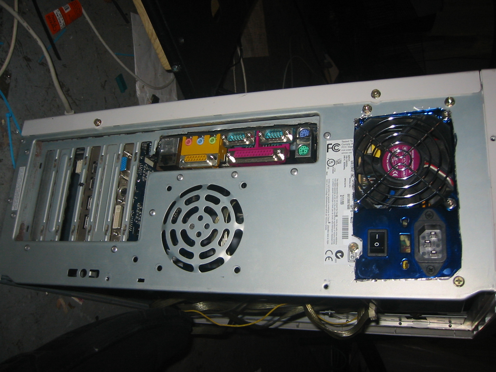

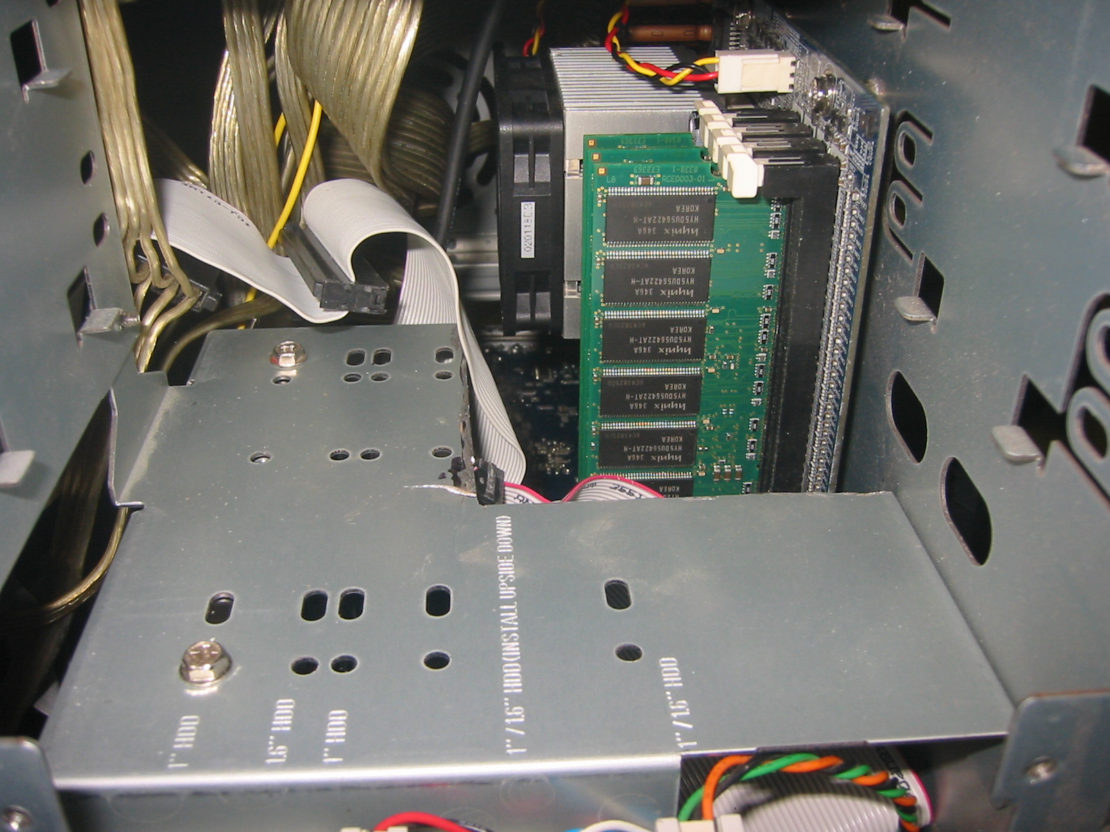

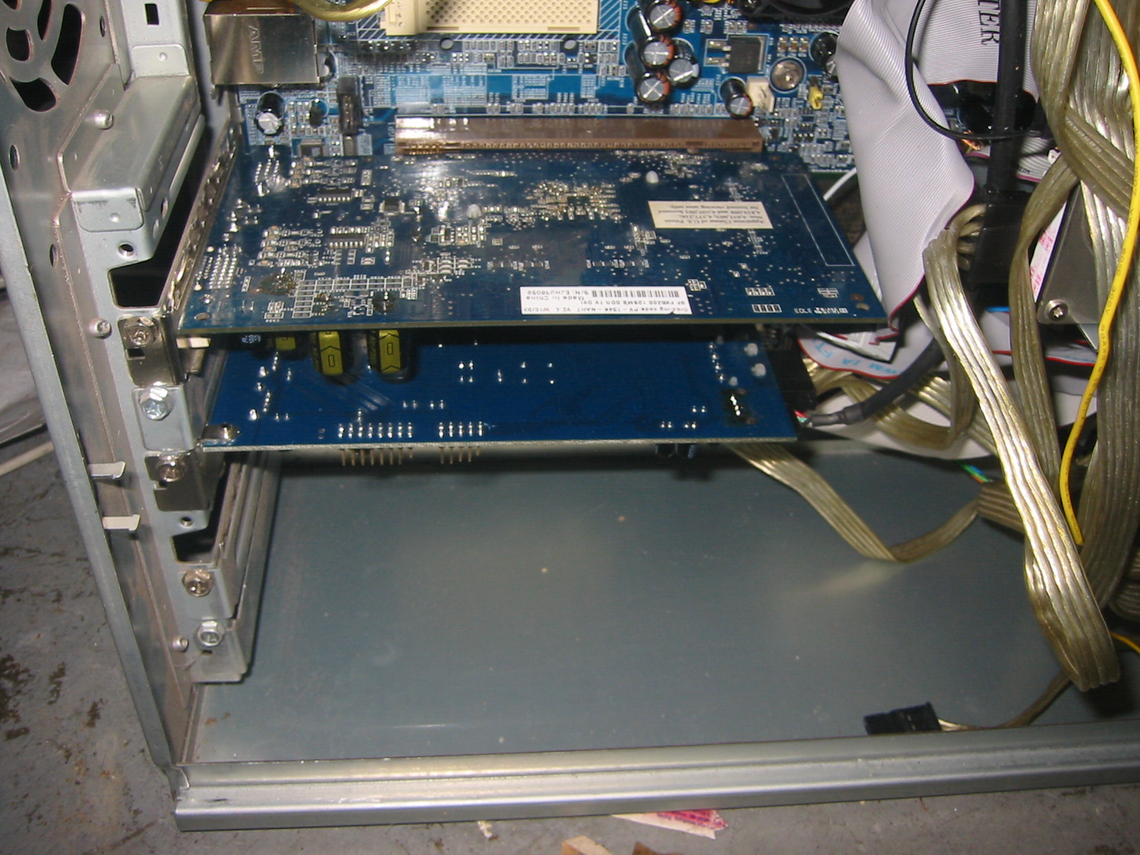

          #84
          Re: old OC rig suggestions
          pics time! (and hopefully, no popcorn! )
          The front. its been de-branded, but it seems i forgot to remove the pII and win98 stickers... being chased out of your thankfully detached garage does that.
          The DVD drive is a toshiba 4.8x unit. i know, old, but it came with the case and last I checked toshiba was a good optical brand (I have a similar looking dvd-rw burner in my emac). as for a second optical (like a cd-rw), once i have a longer floppy cable, I'll be able to work that out.

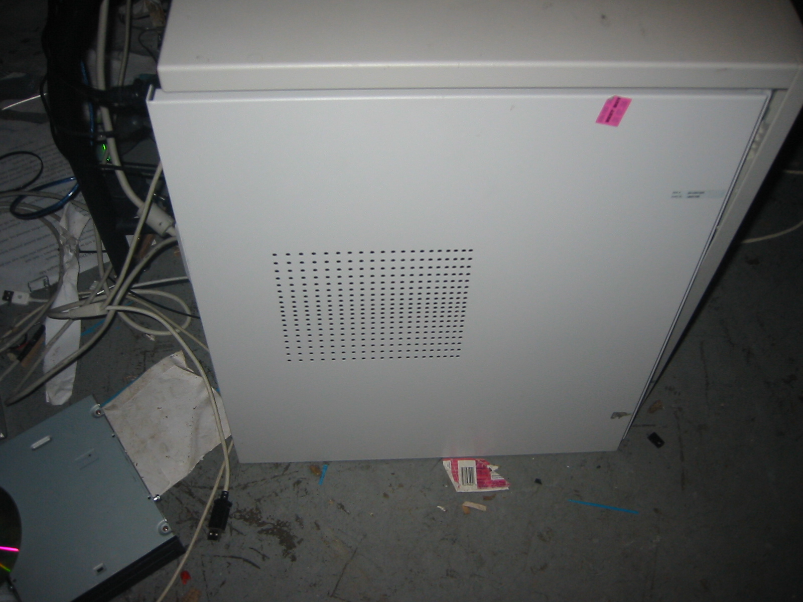

          the side panel. the vent is good for up to a 140mm fan, but (for any side fan) it would require drilling it out... All I have is a 120mm at this time, I may hunt for a 135/140 and than go drilling... thoughts anybody?

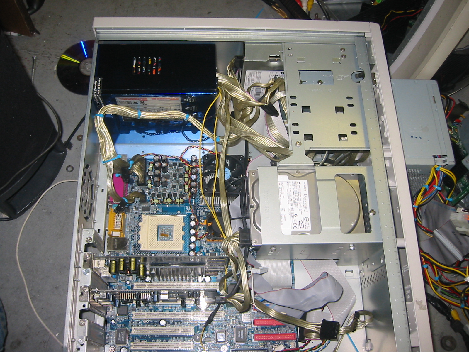

          the insides. it looks cramped, but it works very well.
          I haven't gotten to mounting an 80mm fan yet... its on the "list" though.
          The back. yes, the new I/O hole is poorly cut... I did my best, considering the PITA it was (burnt through 6 dremel discs on that hole). since I have no I/O shield for the board, its not too high on the "list."
          also, I metal taped the usb ports, since they are non-functional. just to avoid any dumb*** moments.
          The 2 cards, which like the mobo and PSU are blue.

          the usb/firewire combo. the header int he upper right corner was orginally a usb port before I swapped it for a header. its a perfect fir for the cable routing as well... it's a perfect fit. Also note the twin NEC chips, one for firwire (small), one for usb (big). for the $5 I paid for the lot it was in (which had a 775 cooler and a 256mb rambus stick), was that a good deal?
          I also dunno about the stock headers... the one on the right appears to be connected to the usb chip and the left to the firewire... from the looks of the the pico fuses, they look to be 2 ports per header for both... what I am unsure of is whether they are actual separate ports or just re-routed ports from the back.
          (and yes, the belkin manual mentions NOTHING about the headers)

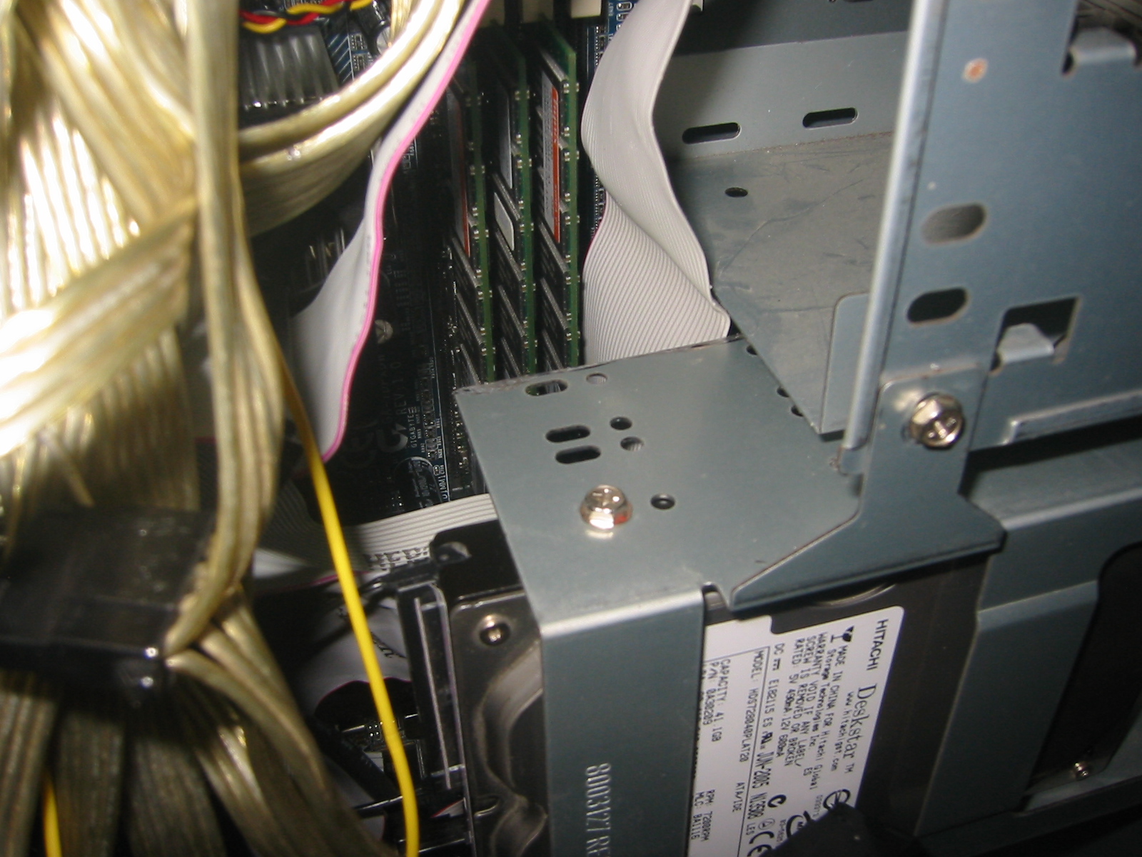

          the dremel'd hdd cage. I had to chop out most of the innermost hdd mount, but not to worry, it still comfortably holds 2 hdds. in the cage. The only thing in danger of contact is the mounts for the lower external 3.5" bay, which I will probably remove.
          Also, that ribbon cable seen taught is the floppy cable, which are barely long enough to reach... the mobo put the port at the very bottom of the board...
          (and that was a relatively long floppy cable )

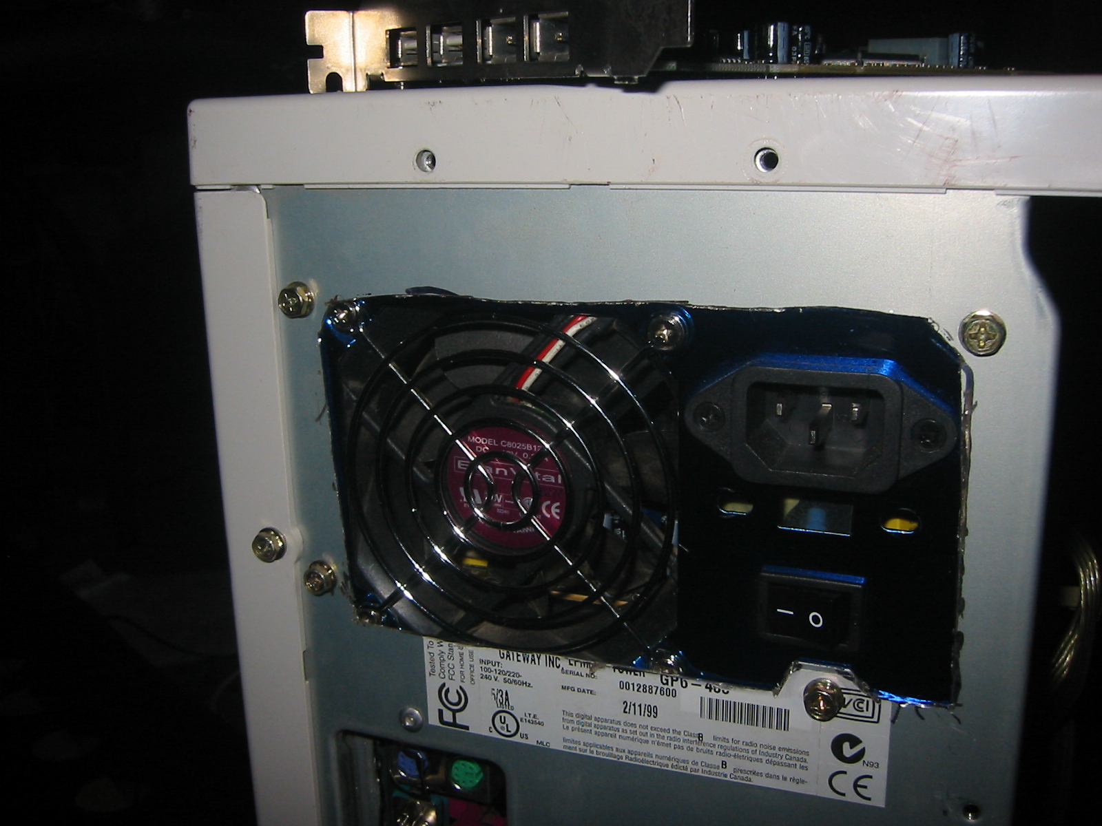

          the new PSU mount. the mount holes are stock, the opening is not. hence why the psu is upside down... thats right, if I used a modern style psu (120mm+ fan), I'd either be screwed or forced to drill vent holes in the top of the case. Luckily, all the venting on this psu is on the ends, which makes it a perfect match for this unit.

            2 more pics:
            i took out the lower 3.5 caddy to make things a bit roomier. I also moved the floppy cable to make my dremel work easier to see.
            now that I look at the cage formt his angle, it looks like I can mound 3 hdds still... instead of 4.
            I also rerouted some wires:
            comments?

                the usb/firewire combo. [...] Also note the twin NEC chips, one for firwire (small), one for usb (big). for the $5 I paid for the lot it was in (which had a 775 cooler and a 256mb rambus stick), was that a good deal?
                Combo-cards like that go for at least 15eur new here (which is almost $20.. damn the dollar loses value fast Oo), and those are usually the really cheap and nasty ones (mostly Via)
                I just googled the part numbers of the NEC chips.
                The NEC D720100AGM is a 5 port (4+1) USB controller, so the pin header has 2 additional USB ports for front USB or another USB bracket at the back.
                The NEC D728730C seems to be a 2 port firewire controller, so they might just be re-routed to the pin header (?!)
                Continuity check with a DMM might help here..
                BTW: if I remember correctly, you have to use the molex plug if you want to use firewire devices, as firewire is supposed to deliver up to 1.5A per port
                Depending on the card's design, they might also use it to power the USB ports (I mean.. why not use the 5V from the molex plug? It's there already lol)

                  yeah, I always use molex plugs.
                  noted on the header- my case has no front usb and from experince i know the PITA it can be to add (been there, done that)... header bracket?
                  edit- yup, the usb header is a go (tested with a header plug set from a discarded hp).
                  too bad my only header bracket I have currently is a 4 port, not a 2 port... I'll have to find one or something.
                  edit2- btw, the 4 port is all in one block of plastic... so no, I can't just remove 2 ports.
