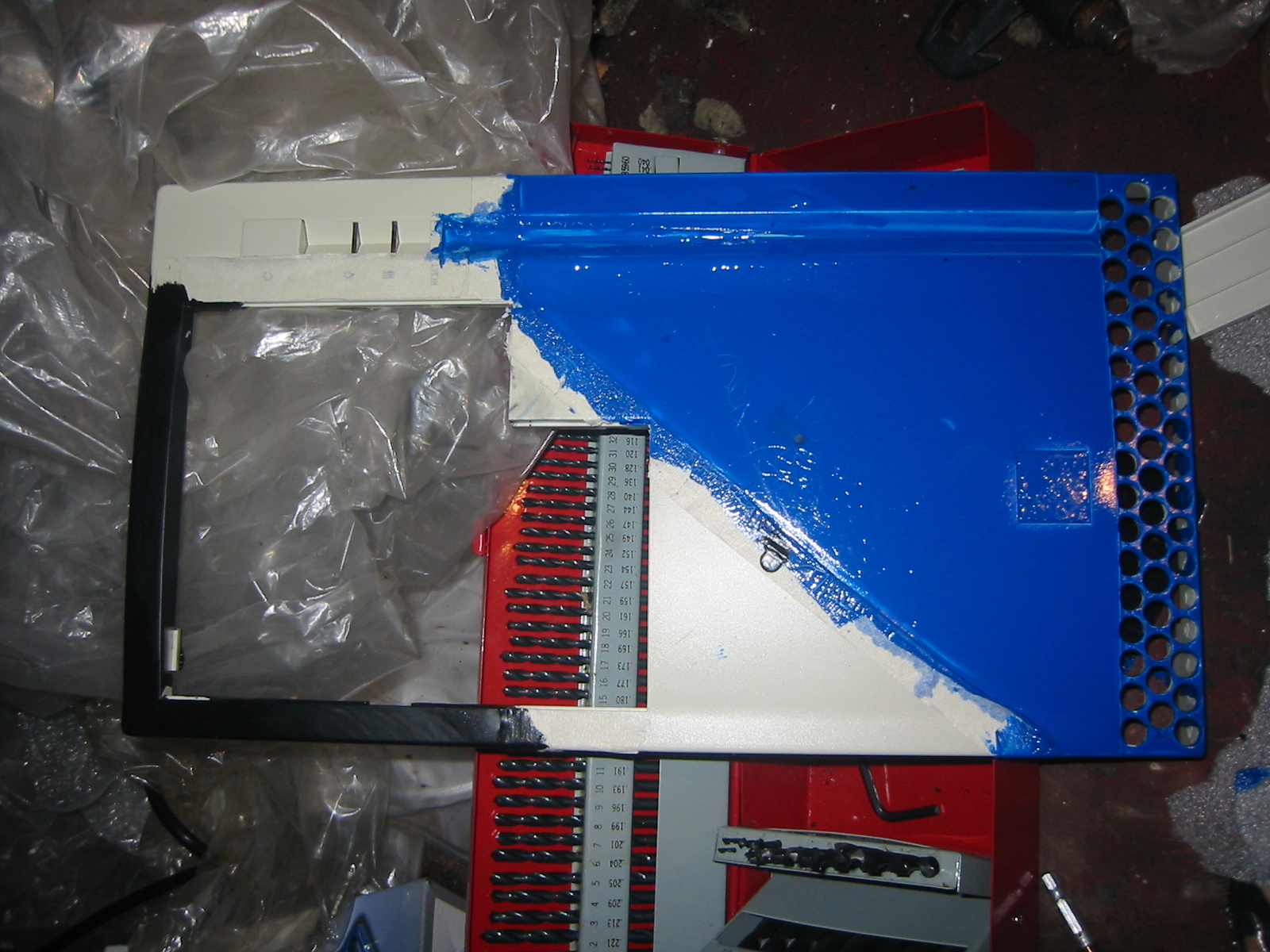

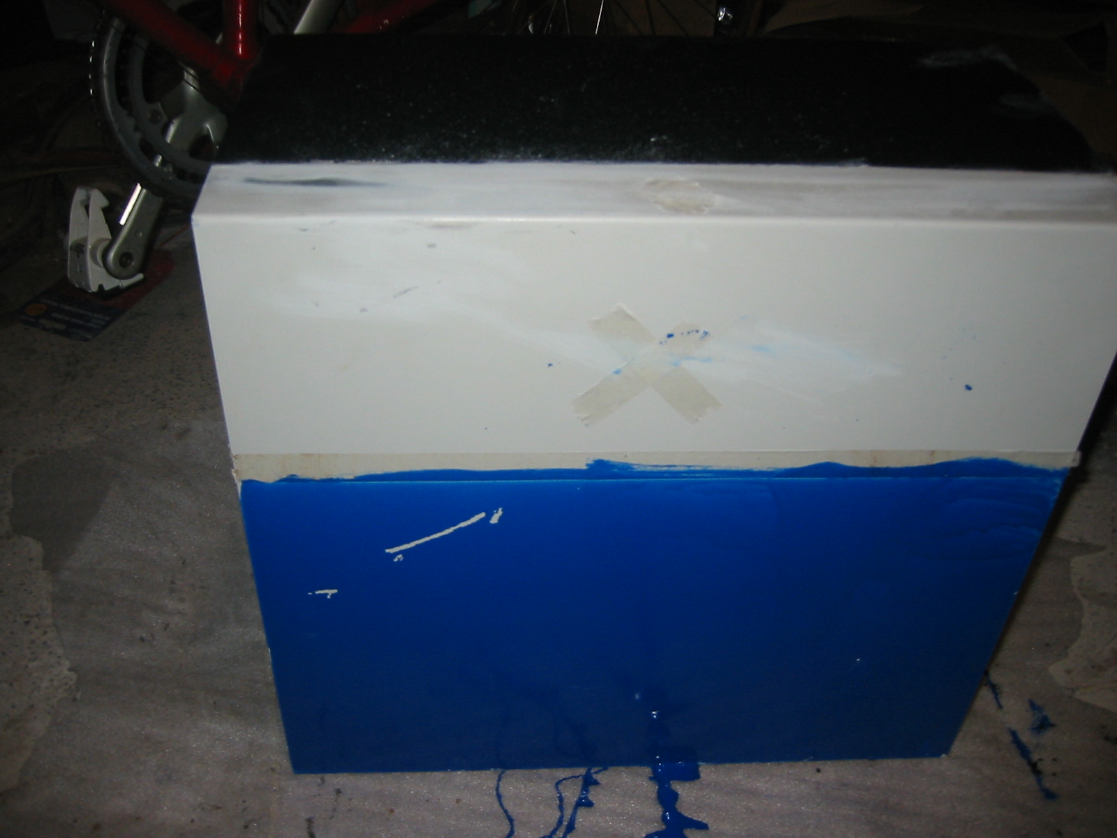

                  the paint job was a fail.
                  my garage must have gotten too cold... the paint dripped and ran over the tape, the tape also peeled, and the blue paint is flaking off
                  I went to sand the drips and without warning it went down to bare metal. oops.
                  remind me to NEVER try painting a case ever again, at least if it is multi-tone or being done in the late fall, winter, or early spring.
                  I may be able to fix it with touch up paint... but either way, it will end up looking like crap i bet.

                    ok, i have come to the conclusion that i will likely look for an old case and use that, since this case just barely worked in the first place.

                        its bad.
                        the front is covered in flaking paint (cracks)
                        bad drips everywhere
                        the paint seeped under the tape in spots
                        ill get pics when the paint finally dries (the cover is dried, the front less so).

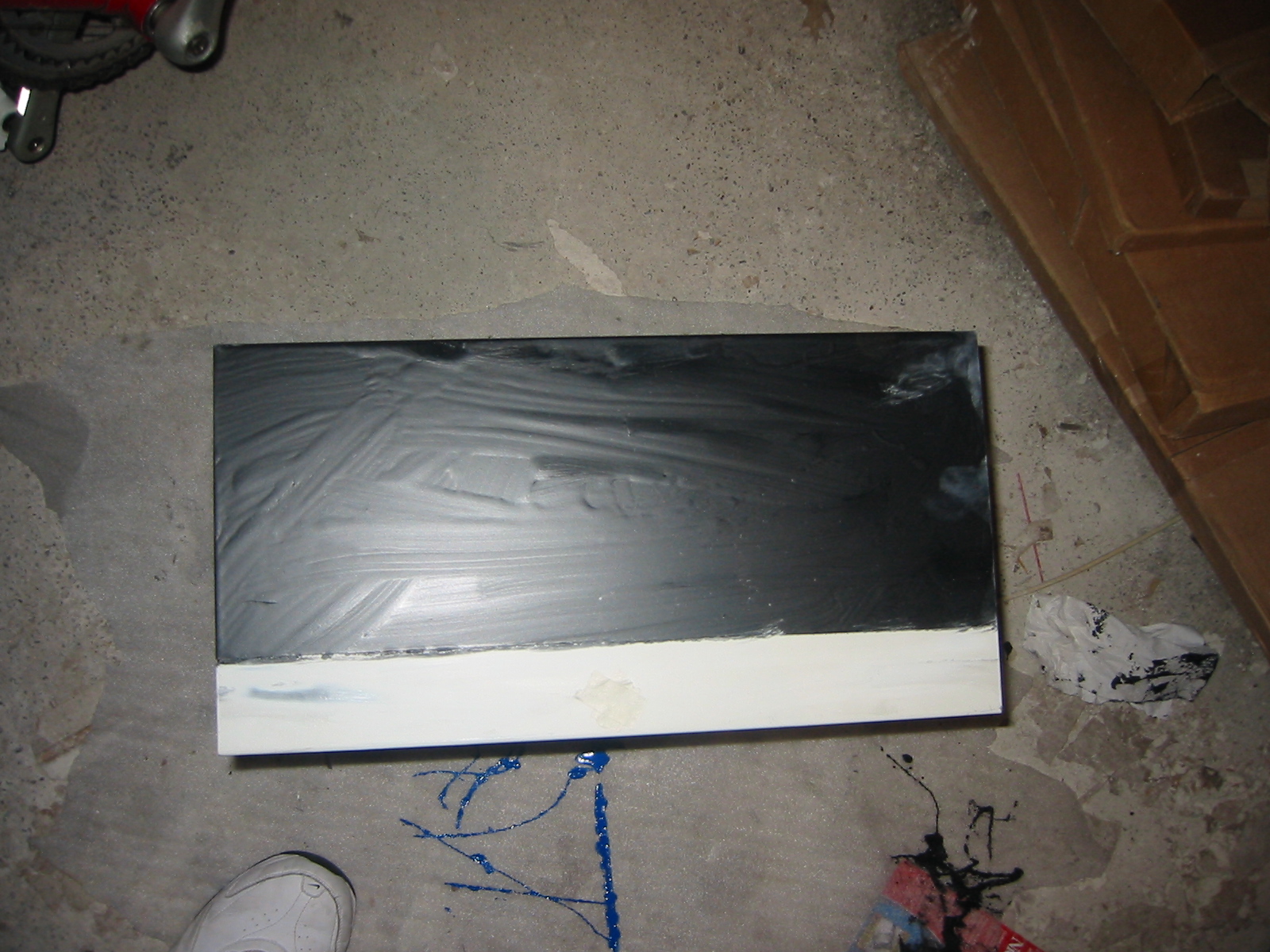

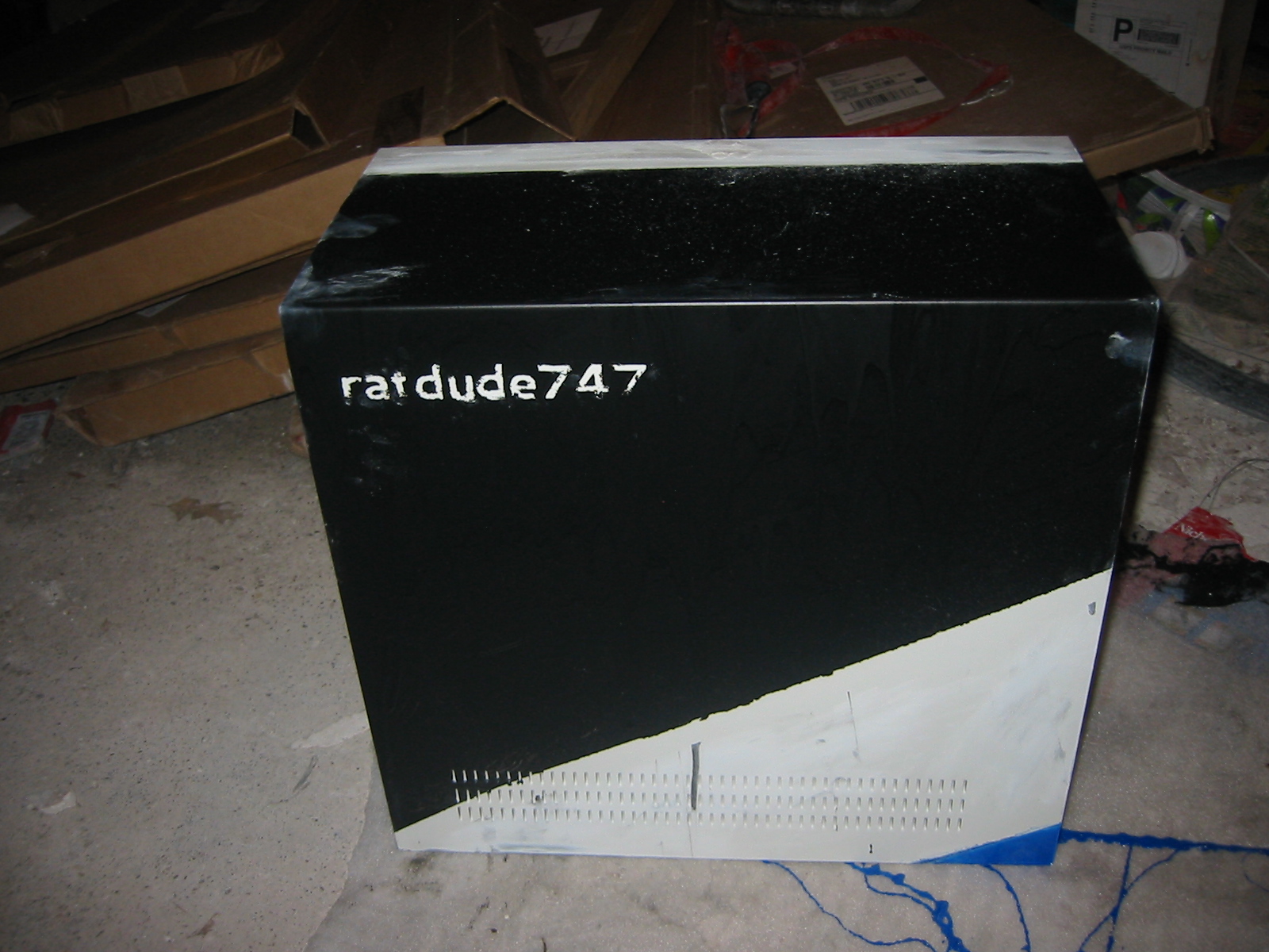

                            it was rustolem flat black and krylon royal blue
                            i took some pics:
                            (some tape removed, some not removed)
                            me thinks some touch-up paint and sanding will fix it... either that, or ill seek out a roomier case... the weather won't be warm enough to paint until next spring.

                              Cases are hot-waxed at the factory to make them shinny and slow oxidation.
                              Is like at the DIY car wash and you flip the switch over to 'wax'. - That stuff.
                              Have to scrub it off with hot soapy water or isopropyl to get good adhesion.
                              Same-same with things like CD drive and card reader faces, screen plastics, laptops.
                              It's hot waxed.

                                        on the plus side, i think i can save the paint. the black is holding ok... the blue, not so much... most of the blue will go bye-bye, and the back/white can be touched up.
