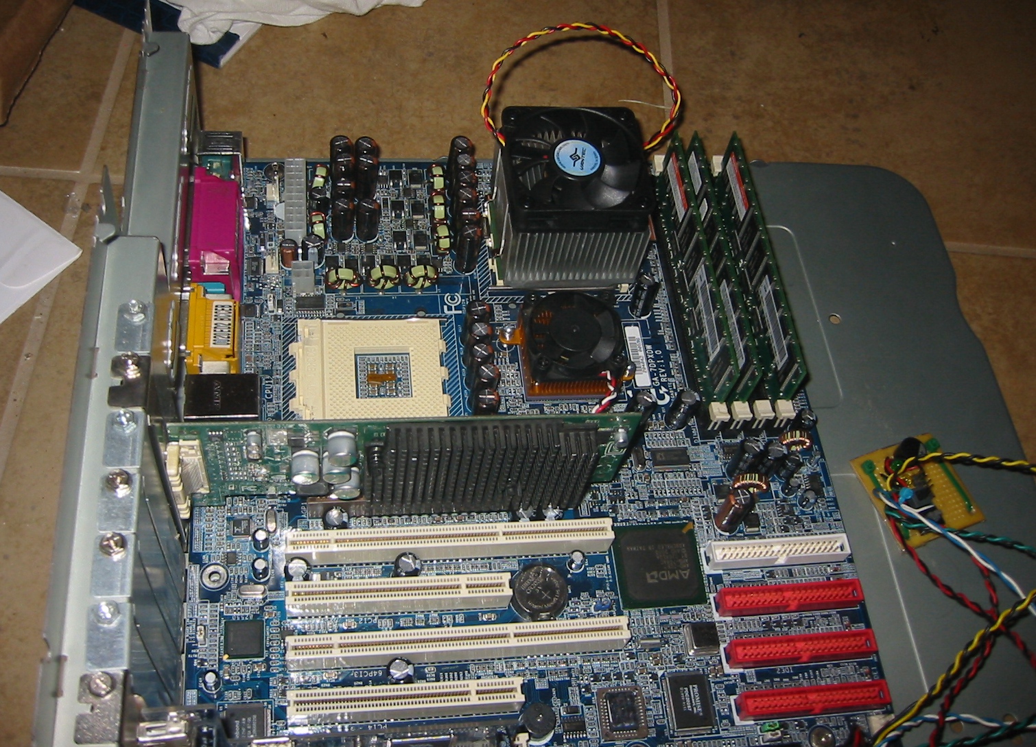

          anyway, i have great news:
          I tried my extra old case, but it didn't quite fit. undeterred, I grabbed the mobo tray out of it and mounted my board...
          the board seems to run fine, as does the recapped graphics card. the only issue is that the chipset fan is wasted; next time i am at fry's i will grab a new mini fan (the old one has rattling ball bearings).
          all i need now is a case and 2 cpus...

            bad news. the usb on the board is dead. supossedly my board had the ok b2 southbridge, but this baord that i have has the b1 with disabled usb
            thank god for having a spare usb2.0 card...

                        Found a case.
                        turns out the case from this thread is a fit, as long as any drive in the lower 2 5.25" bays is one of the short lite-on type drives... with one of those there (I have 2 in the system), the ram cleard by 6mm... and the way the IDE cable attaches to the drives, they too clear the ram.
                        the server in that thread was moved into a dell dimension 4100 case i had... it needed a differnt case to fit in my network cabinet anyway, so no loss here.
                        once i get a set of MPs for it, i'll take some pics.

                          ok, I just took some pics anyway:
                          yes, the drives clash. I have a feeling i may be using some spay paint in the future.
                          full of cables...
                          you can't quite see it due to the cables in the way, but the ram sits about 1cm from the end of the cdrom drive (all 4 slots usable)
                          yeah, its a tight fit. note that due to the cpu layout, neither cooler is more than 40% blocked by the PSU. where it is, there is plenty of gap between fan and psu.
                          ironically, the main reason the case works IS because it is side saddle... it widens the case on the mobo side of the drives, giving the ample space for the hdd to clear the ram.
                          the board on the tray. the new nichicons and rubycons sure look nice!
                          a beautiful recapped VRM.
                          the usb card chipset. why i needed to use the usb card:
                          note the highlighted "B1". that is the stepping of the southbridge. b1 had the defective, disabled usb, b2 had working usb.
                          comments?

                            on a separate note, there was an issue i ran into:
                            the video card int he pics is not the recapped one. the recapped one made the system unstable, or so i think. I'll try swapping the cards back, but if its hosed, then I will need another video card (the card in the pics is stolen from another computer).
