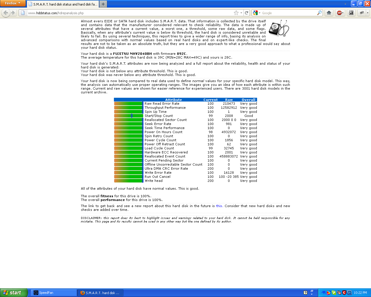

    Where did this come from?
    Last week, my computer suddenly became very slow. When I opened Task Manager, I found a process called setup.exe with 100% CPU usage. When I ended the process, a second GoogleUpdate.exe process started (I have Chrome installed, so one Google Update process is always running). Ending this new GoogleUpdate.exe process ended both processes at the same time, so I thought Chrome was updating.
    Today, I ran Malwarebytes and it found two setup.exe files and a registry key related to the setup.exe file. All were detected as Adware.CNNIC. These were the only three things the scan found. I was using Firefox with AdBlock Plus and NoScript. How did this manage to download?

        A full scan with Malwarebytes and Avast didn't find anything else. The last registry cleaner I used messed up the registry so that no antivirus software would install.
        This computer has done some strange things since I started to connect to the college's wireless network. If I try to open Internet Explorer (the login page for the college's wireless network will only display in Internet Explorer), the window will sometimes close when the home page or login page starts to load.

                              Re: Where did this come from?
                              For me, registry cleaners don't do anything good. Updating drivers or the BIOS also have a negative effect on the computer's performance and stability unless the update fixes a known problem.
                              I just remembered that I can't test the memory because the optical drive is dead. The computer can boot from a USB floppy drive, but I don't know if it can boot from a flash drive.
                              Do you think the hard drive is bad?
                                  Yes, many registry cleaners will pick up things they shouldn't. If you know what to delete and what to leave from the list they give you, they can be okay.
                                  If that utility is correct, then YES, your HD is going bad.
                                  According to the screenshot you posted, your HD has 160 reallocated sectors, 108 that have been registered as reallocated (Reallocated Event Count) and 300 pending to be remapped (Current Pending Sector).
                                  Try HDD Tune and see what it tells you. If it's the same thing, then the hard drive definitely is going bad.
                                    If that's a report from Speedfan then I would say it's accurate.
                                    That many reallocated sectors, your drive has issues. While it doesn't spell immediate doom, it's a good sign.
                                    Backup your data if not already, and get a new drive. Hopefully you can find someone who hasn't heard of the floods in Thailand.
                                      Ultra DMA CRC Error Rate 200 21
                                      Offline Uncorrectable Sector Count 1 255
                                      Current Pending Sector 100 300
                                      Reallocated Event Count 100 108
                                      Reallocated Sector Count 100 160
                                      With the exception of the first one, my belief is that these should never be nonzero, otherwise the drive is not reliable and should be replaced. The first one may indicate cable problems.
                                      This is an example of a disk in good condition. (It's getting "old" but I wouldn't worry about that because everything else is perfect.)
