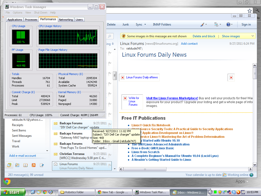

                            well, on my dell latitude d400 (1.8ghz pentium M donthan, 2gb pc2100), it was running slow...
                            and look what I found:
                            why???

                              why???
                              Because the graph is wrong, or mislabeled rather. "PF Usage" in XP task manager is actually measuring the commit charge. Commit charge in Windows is the size of the virtual address space. It doesn't tell you how much of the virtual address space is stored in memory vs. on disk. The graph has actually just been renamed "memory" in newer Windows versions.
                              Not that Wikipedia is the most reliable of sources, but it explains the whole thing quite clearly, and I know this to be true.
                              In the Task Manager utility under Windows XP and Windows Server 2003, the graphical displays labeled "PF usage" and "Page File Usage History," despite their labels, reflect not the pagefile contents but the total (or current) commit charge. The height of the graph area corresponds to the commit limit. These do not show how much has actually been written to the pagefile, but only the maximum potential pagefile usage: The amount of pagefile that would be used if all current contents of RAM had to be removed. In Windows 2000 and Windows NT 4.0, these same displays are labeled "Mem usage" but again actually show the commit charge and commit limit. Similar displays in the Task Manager of Windows Vista and later have been changed to reflect usage of physical memory.
                              http://en.wikipedia.org/wiki/Commit_charge
                              As for Th3_uN1Qu3's original post - I suspect a memory leak in one of the programs you were running. XP will increase the page file size any time the commit charge approaches its limit. Even though physical memory was available, there wasn't enough space in the page file to swap out all the memory contents *if needed*...XP does this proactively. There were probably some inactive programs already swapped out to disk taking up space in the existing page file, and not enough space to fit the active programs in memory *if* they needed to be swapped out.

                                well, i see. the hdd was fragmented beyond belief so auslogics is doing some janitorial work... slownesss cause?

                                    None of the numbers on that tab tell you how much of your virtual address space resides in the page file.
                                        I figured out my error and hence the post edit. read the post again.
