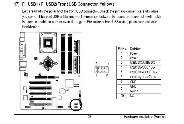

    Hello.
    I have 3 identical PC Cases and 1 black that is different.
    All the 4 cases have front panel USB ports.
    I also have 2 different motherboards:
    Intel Desktop Board D845PESV
    Gigabyte GA-8IPE1000-G (rev. 3.x)
    Every one of them supports USB 2.0 and has front panel USB headers.
    Intel motherboard D845PESV works with USB 2.0 ports of every PC Case.
    But Gigabyte GA-8IPE1000-G (rev. 3.x) works only with the black case ports...
    If I connect it to any of the 3 other cases USB ports and then mount any usb device to it I get "unknown usb device" message...
    I have double checked the connections and they are right. I have also tested the usb ports and their cables with my multimeter and they show negligible resistance.
    One last thing to mention: The Gigabyte mobo has an external usb bracket that connects to the back side of the case like a PCI card. I swapped it with the front panel USB ports and it still worked while the front ports gave "unknown usb device".
    So, what the fuck happens???

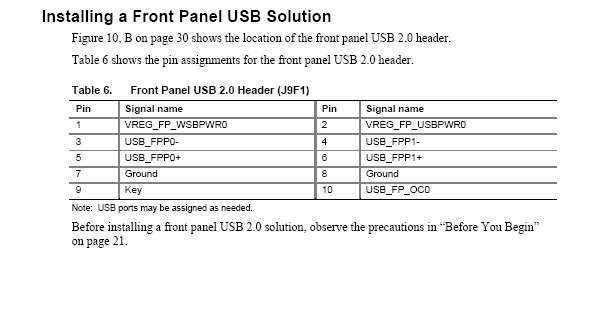

                  Re: Very strange problem with front panel usb ports
                  The motherboards pinout here...

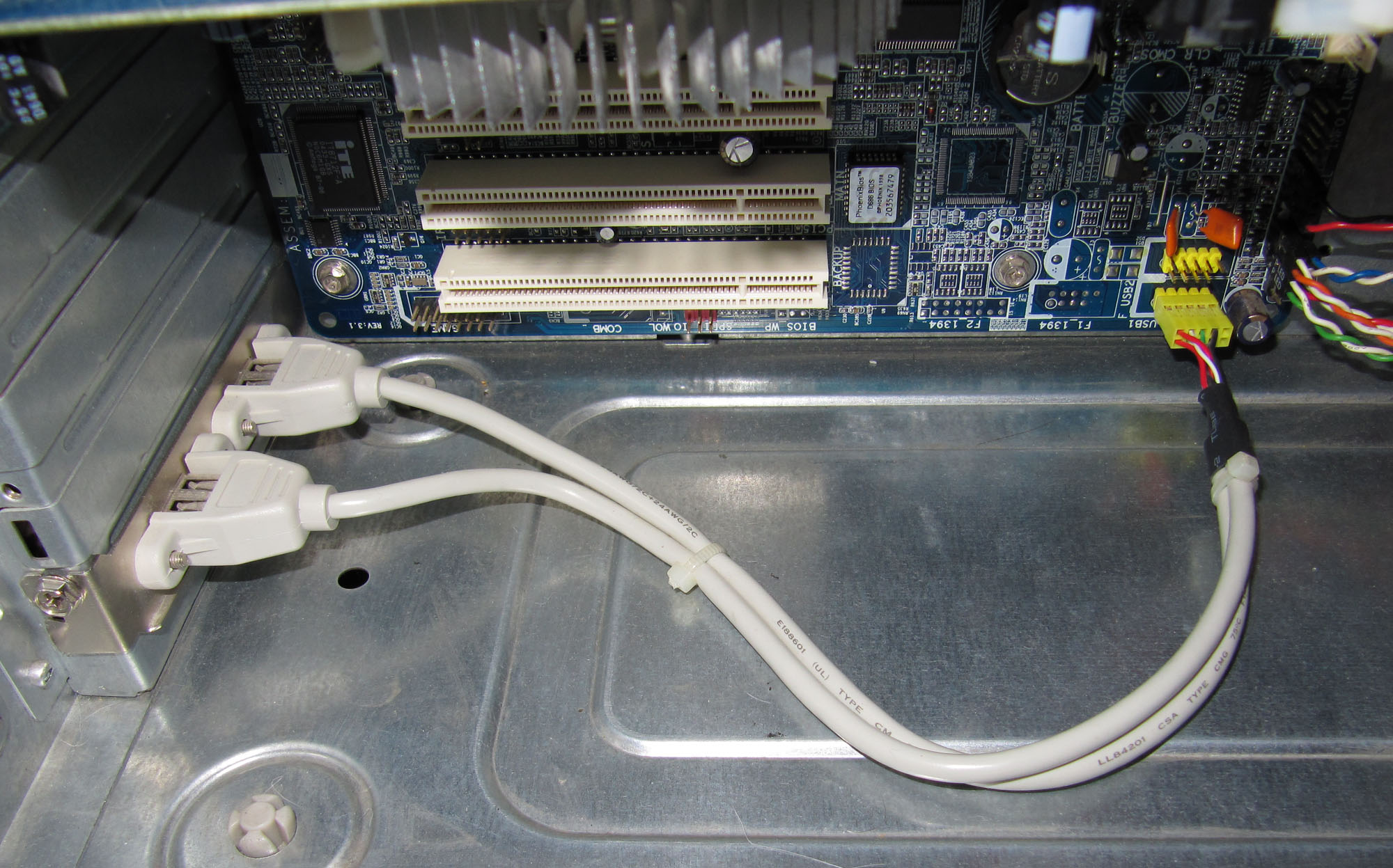

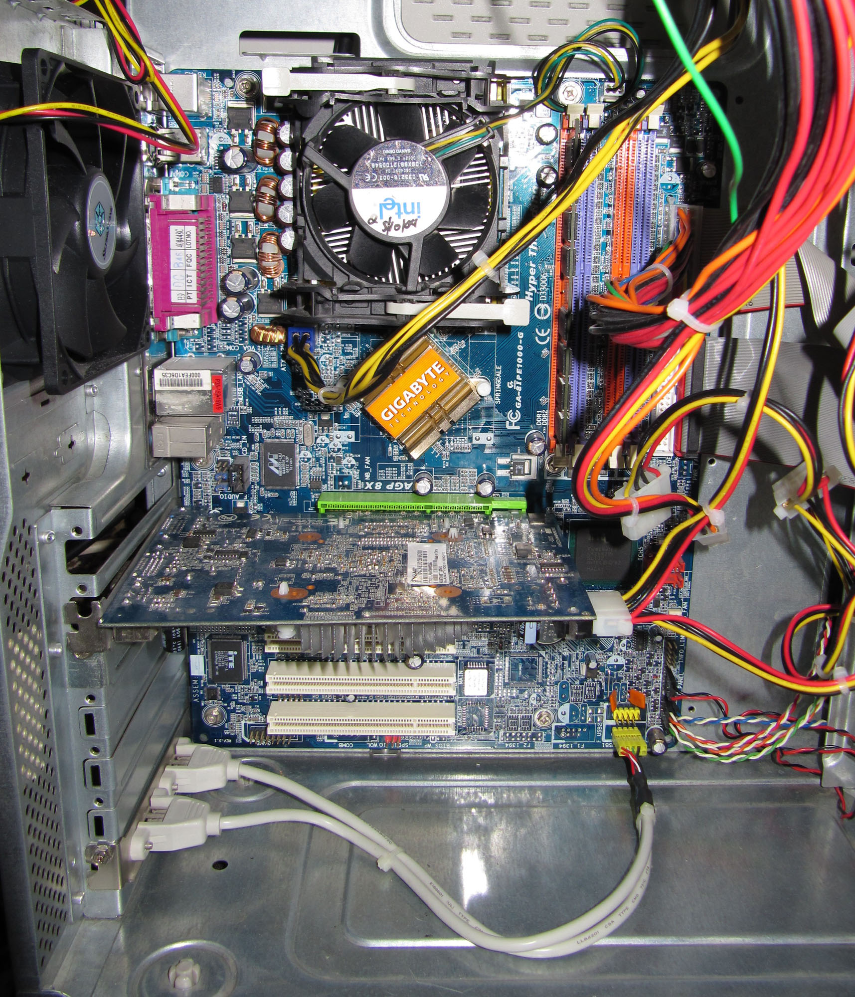

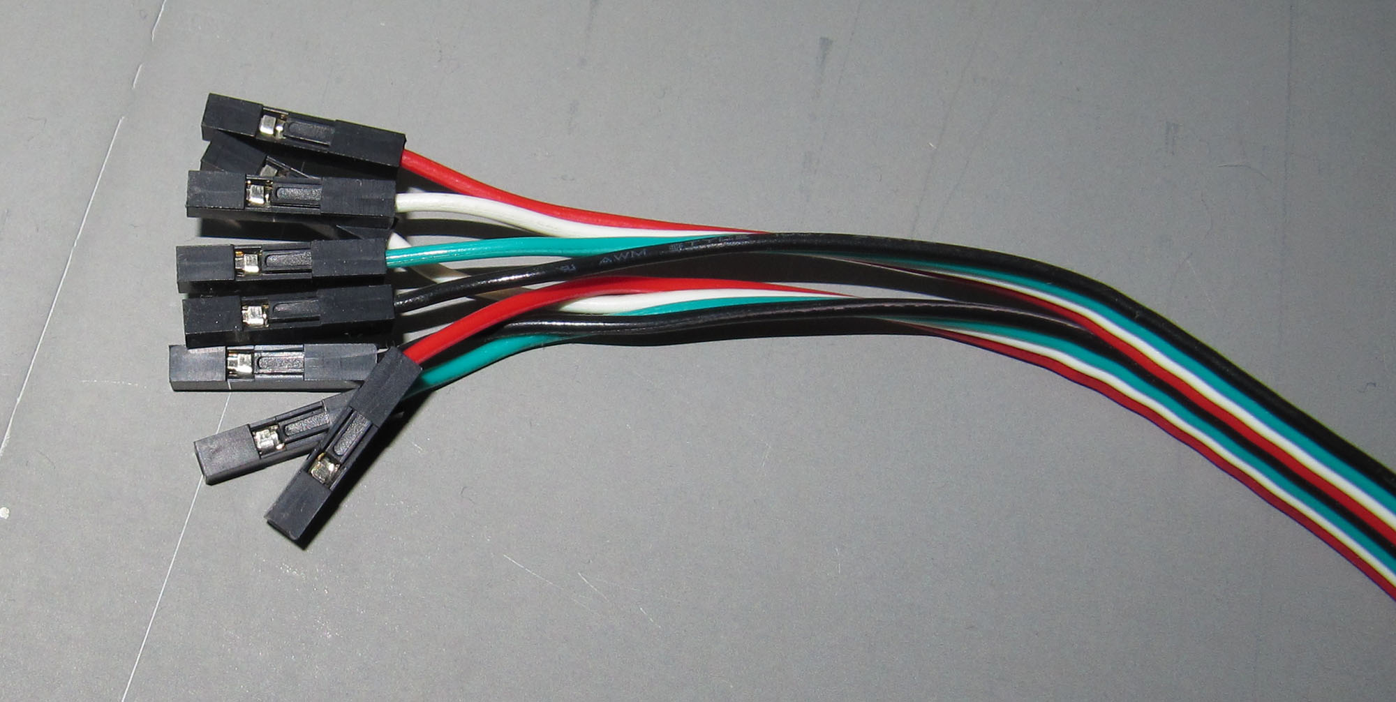

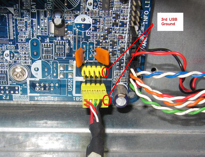

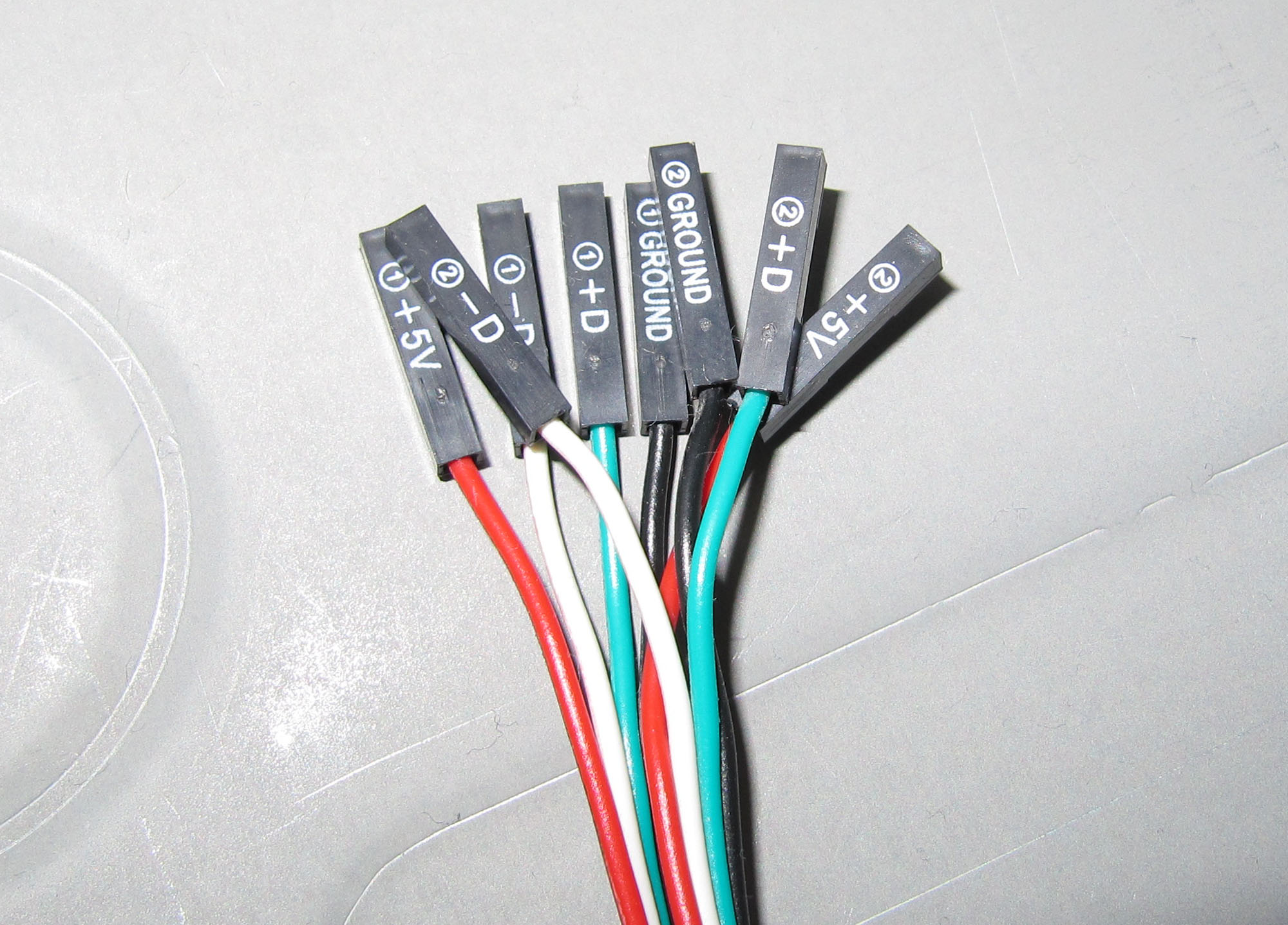

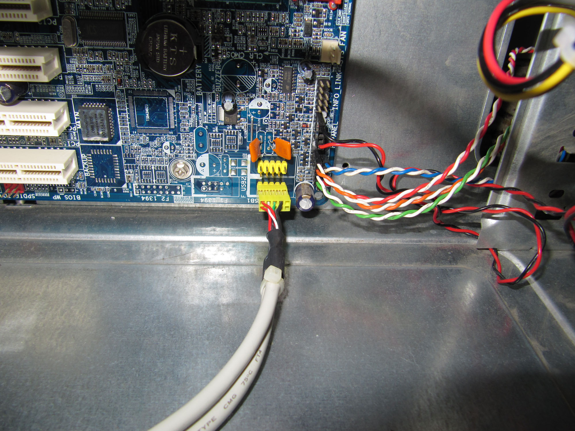

                              Here are photos from the Gigabyte motherboard in question and the USB backplate that works.

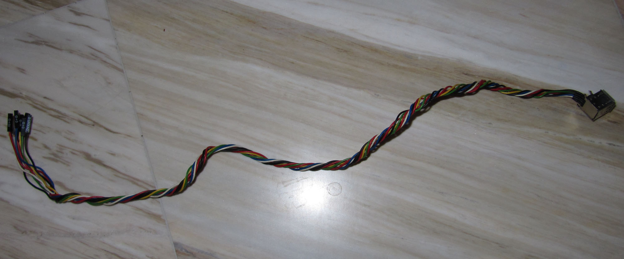

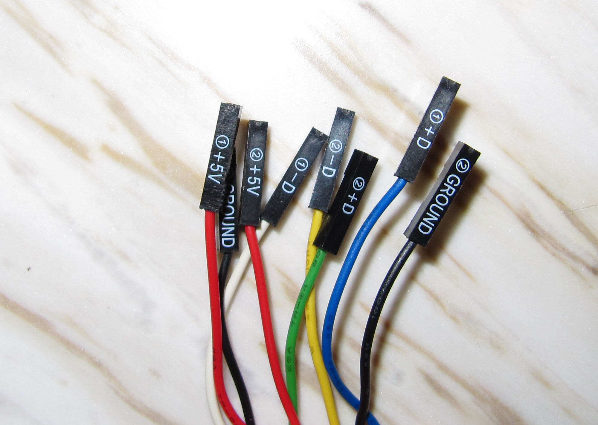

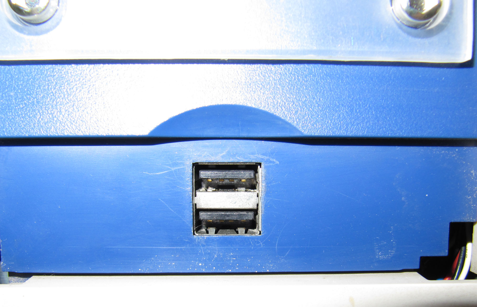

                                The front panel USB of the cases that don't work with the Gigabyte motherboard...

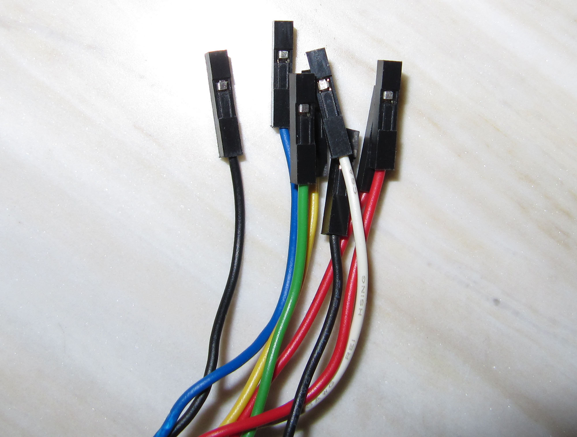

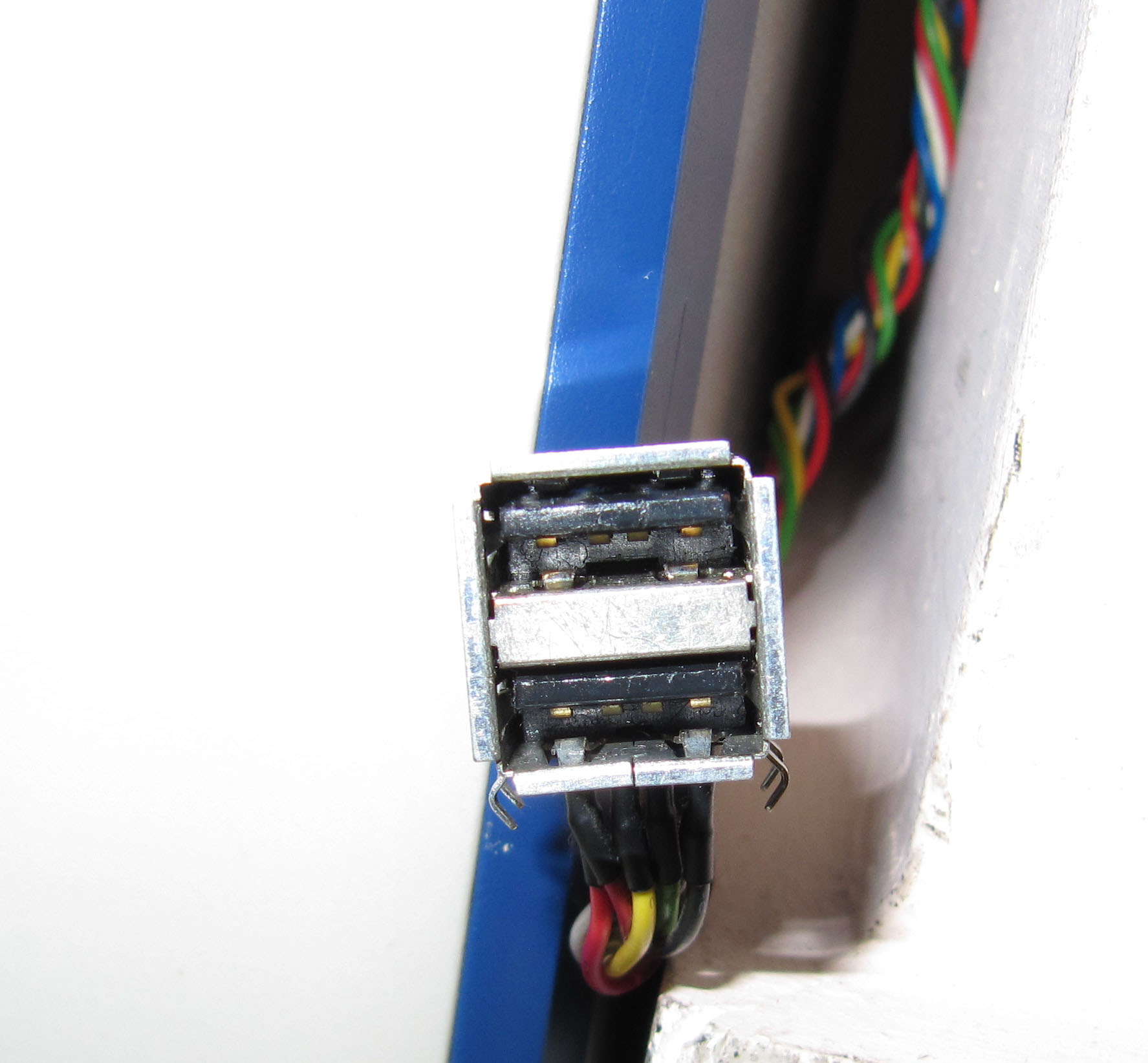

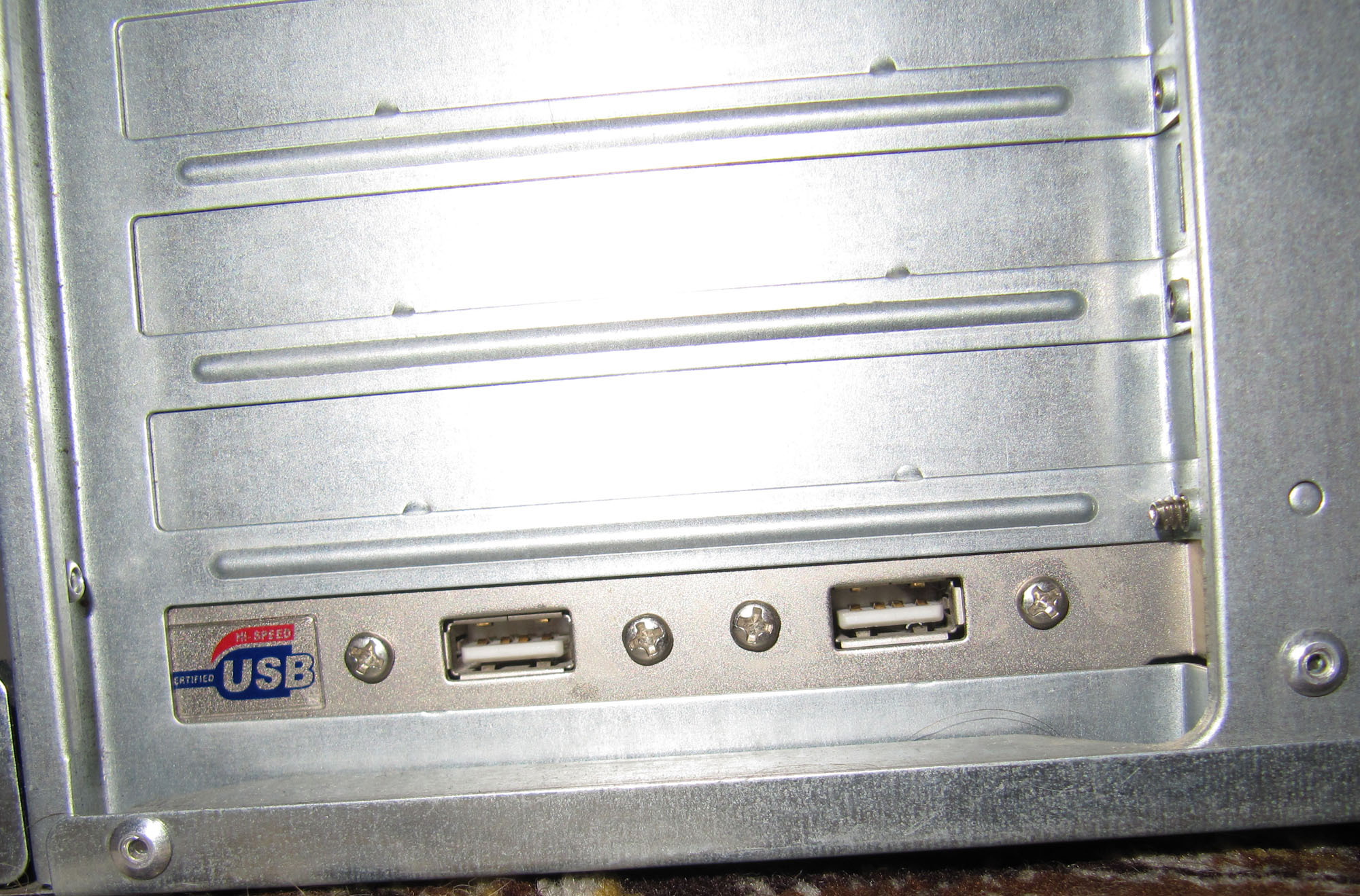

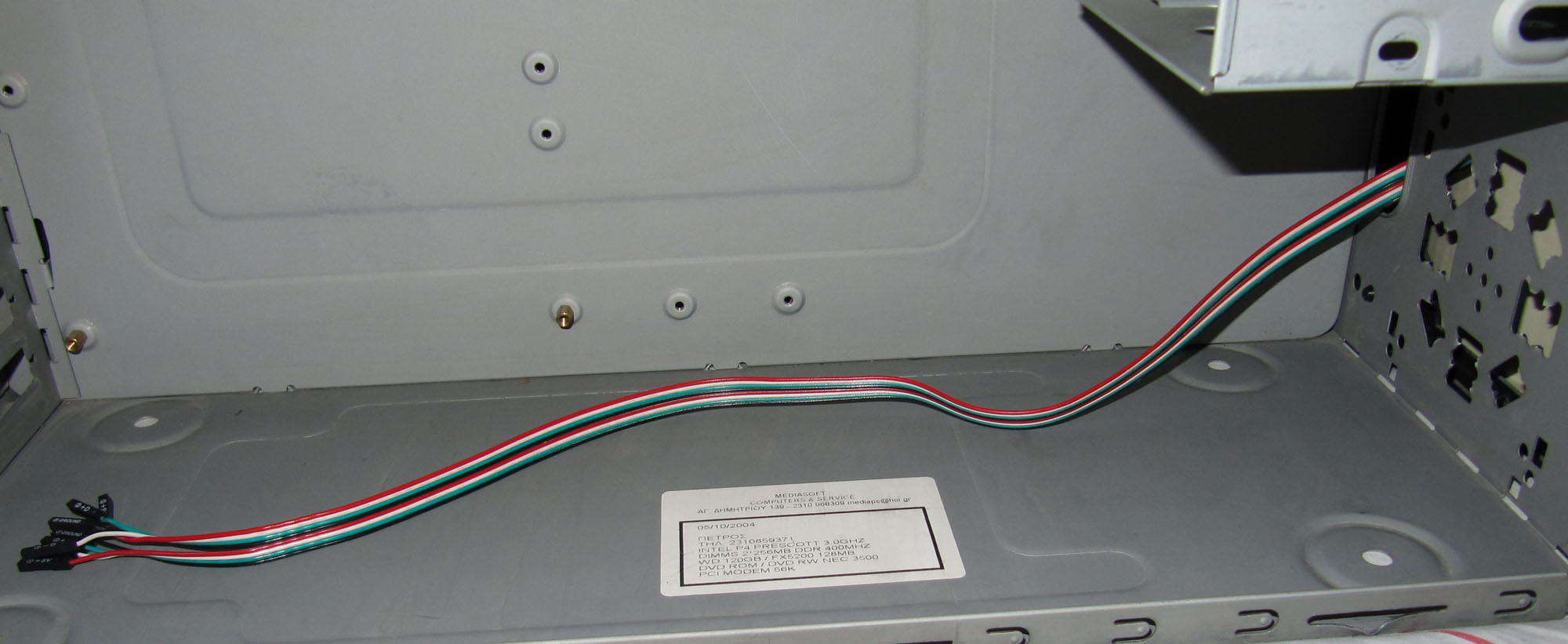

                                  And finally the black case's USB ports and cable that works.
                                  I am unable to notice any difference between the "white" PC cases' USB and this..
                                  • PCBONEZ
                                    Grumpy Old Fart
                                    • Aug 2005
                                    • 10661
                                    Your Gigabyte adapter probably has shielded cable with a drain wire wrapped around the shield and attached to the ground wires.
                                    Most case wires are just wire with no provisions for cross-talk. (That makes them USB 1 regardless of what the case ad claims.)
                                    See pic.
                                    That's what I was talking about before..
                                    That often unused pin sometimes has a third ground wire connected to it in better quality USB parts.

                                    • goodpsusearch
                                      • Oct 2009
                                      • 2850
                                      • Greece
                                      Well, I think I found out something interesting.
                                      1)The black case's front panel usb ports have their ground pins shorted.
                                      The +5V pins are shorted too.
                                      That should be the reason they work with the Gigabyte motherboard...
                                      2)I tested 1 more PC case with front USB ports and they worked with the mobo. Guess what, the power pins are connected together again and so are the Ground cables.
                                      3)And then I got for free a PC case with front USB ports that had only their grounds shorted, but not the 5Vs. That one sometimes worked and sometimes not and I got the unknown USB device message.
                                      So, shorting together the power and ground cables is a cheap way to improve the signal or reduce the EMI???
                                      edit: 4)The 3 identical cases with the USB ports that don't work with the Gigabyte motherboard don't have the ground cables neither the 5V shorted.
