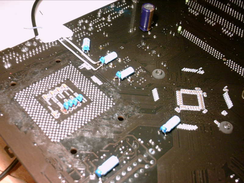

and folks think i am nuts for the mods i make!
i increased overclock on several boards by bumping up capacitance and lowering esr.
adding tants and mlcc helped too.
apply the mlcc as near the cpu vcore pins as you can.that means tacking between socket pins on the back of the board.
