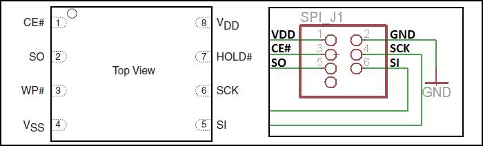

                              Oh dear more drama on removing 8 pin SOP
                              Desoldering I was a little bumfisted and pulled 2 solder pads off
                              They are pad six and seven. Can see the trace to six but none for seven
                              Have I had some luck and seven is unused?[
                              IMG] Uploaded with *************[/IMG]

                                I guess if they didn't use Pin 7 then you don't need it
                                What does the datasheet say the "Hold#" pin is for?

                                      My Willem EPROM programmer has an SPI pin header on it for doing this sort of thing I believe. But your design there looks nice if you didn't have a programmer already
                                      -David VanHorn

                                        #39
                                        Re: EPROM [BIOS] Programmers - What's good?
                                        the SPI header is indeed very useful ..
                                        almost new mobo have this type of bios chip
                                        even if the chip is not soldered on board (dip8 pin)
                                        my maximus has soldered bios chip but with spi header present on it ..
                                        you can modify the cable to accomodate no soldered bios ..
                                        here's the pin guide reference
