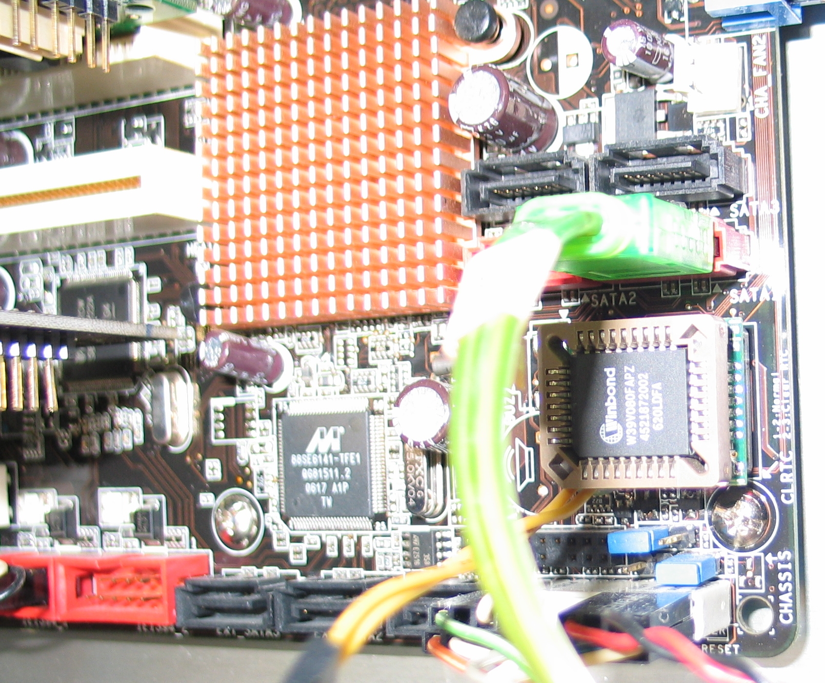

                I have an old Pentium II motherboard I use to hot swap bios chips in case of a failed flash. It works well with Uniflash, except for certain Phoenix bioses.

                      Re: EPROM [BIOS] Programmers - What's good?
                      Originally posted by bigbeark
                      Can you please explain how you hot-flash the BIOS chip?
                      You start up the [flash-host] board which loads the BIOS into RAM so the machine can run the floppy drive.
                      Then with the board powered up you pull it's BIOS chip and install the chip you want to flash.
                      Then you flash from the floppy drive.
                      Then you turn it off and switch BIOS chips back.
                      I suppose it might work with a USB or CD based flash but I've never tried that.
                      Quite risky but it works.
                      I've done that several [many?] times in the past but not for ages.
                      If you don't have a board you can afford to lose that takes the right BIOS chip you are pretty much stuck though..

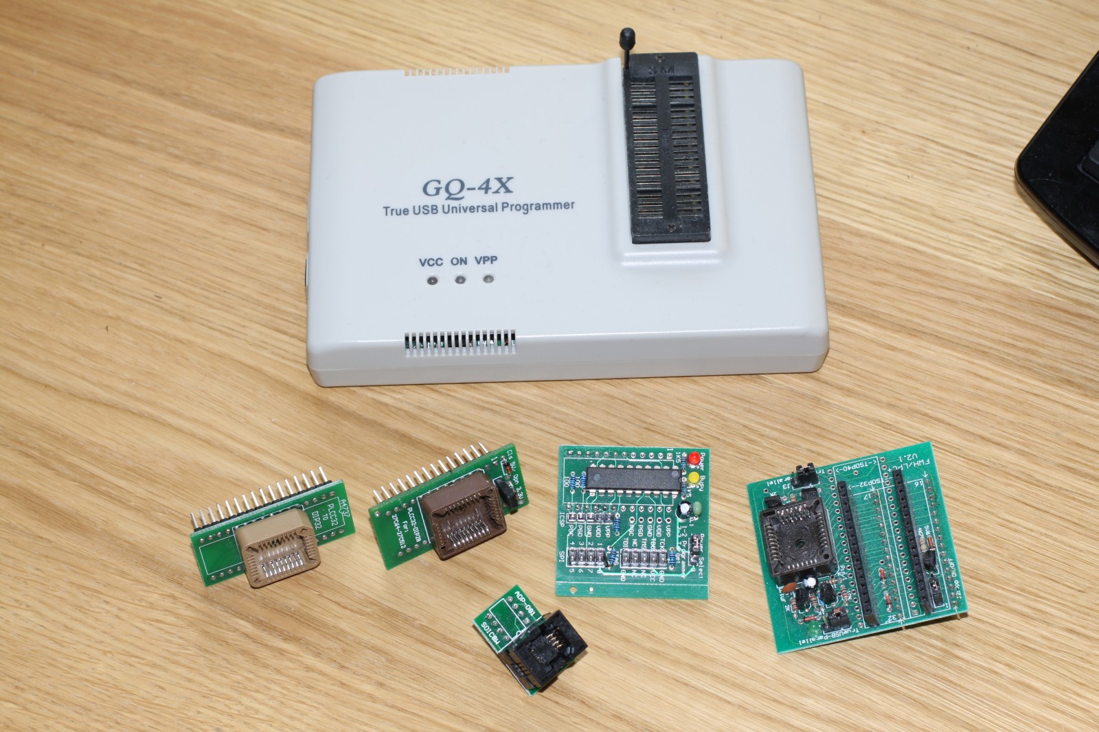

                                I'll vouch for the Willem True-USB PRO GQ-4X programmer aswell.
                                I have it plus allot of adapters, it works really great.
                                With the correct adapter it can also do SPI flashing, very useful for modern boards...
