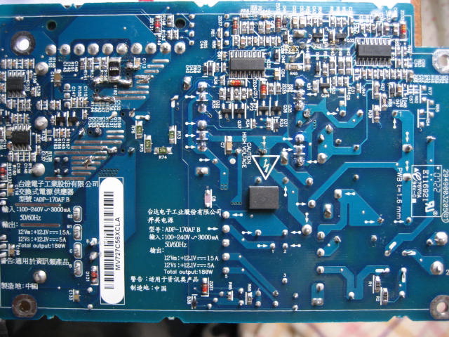

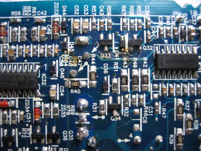

    Basically, I have one of the aluminium intel iMac 7,1 (mid 2007) 20' 2.4ghz models, with a 614-0403 power supply.
    The imac has a problem where 90% of the time, it will power up (3 of the 4 diag LED's light up on the motherboard), with no chime, DVD and HD spins can be heard, and fan's power on, then it will shut down (usually after only 3 or 4 seconds), (diag LED's will return to just LED#1 on, others off), and then it starts up again, (same symptoms, DVD and HD spins, fans spin), and remain in that state with no change, no chime, no boot, no display.
    Having repaired iMac G5's before, I immediately checked the PSU for cap issues, and they look fine, and measure fairly close to their specs.
    Going over the board, the only thing noticeable is a yellow "burnout" looking flux residue on the underside, by Q33, D41 and D45.
    I've checked the voltages on the PSU pinouts, and the only strange one that jumps out at me, is a 2.6v reading when in "standby-power off" mode, on PIN 5.
    However, the voltages specified by a post over at ifixit.com:
    (http://www.ifixit.com/Guide/Repair/i.../2740/2#s13220)
    state that it should be reading 3.8v, and that it is acting as the PSU-enable pin?
    Does anyone have any ideas, or experience with these PS units?,
    I've replaced the caps that connect directly to PIN 5 from the 12v source, but the voltage has stayed at around 2.6v?

        The underside of the board is alright, but the topside of the board would be even more helpful. That's the only way we can see if there are bad capacitors, other components. Usually it won't be the solder traces, unless you've recently dropped it off a cliff or something...

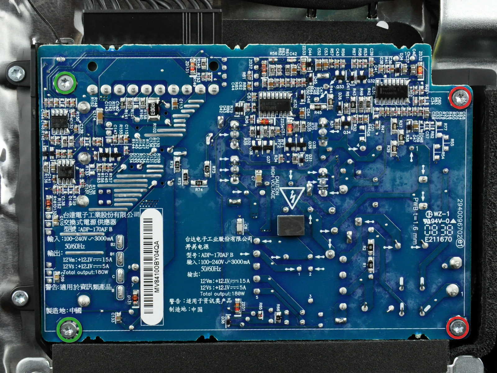

          Found a *HUGE* clear pic on ifixit of the back (attached).
          The markings indicate only 2 - 12.1v sources.
          The picture appears "clean" around the components you indicated "Q33, D41 and D45". If the -board- is actually discolored, I would be concerned.
          The 2007 date puts it past the "bad cap formula" period, but certainly does not exclude it, as the problems continue to the present.
          You say you've tested the PSU caps? By what method? On the board or off?
          Monitor the voltages closely on the 12v lines when the unit cycles. Results?

            In terms of comparing the brown/discolouring of Q33, D41, D45 + Q32 (I took another look over the area, and realised that Q32 was also affected), on my board, there is a very obvious distinct burnt flux/brown residue on the "south side" of all the components, so: looking at the board as it is in the picture, with the Pin rail at the top, and the sticker at the bottom, the bottom left leg of Q32, the bottom of D41, the bottom of Q33 and the bottom of D45 are all brown / discoloured.
            I'll get some high quality close up photos of my board tomorrow, and post them up for comparison, =p

                Ok, Hey again everyone,
                I've managed to get some photos close up of my PSU, but unfortunately it seems that my camera just isn't able to get a detailed photo of the whole board, so there's both the wide photo, and a close up photo of the top right hand side components which have the burnt flux colour residue on them.
                On the close up photo, you can clearly see the burn out colourings on Q33, D41, Q32 and D45.
                What do you guy think?, i've gone over the board and re-soldered any "cold-solder" looking joints, and have also lightly resoldered the legs of the components mentioned above.
                Note: the terrible, terrible soldering job on the top left corner of the board, re-soldering the new caps after testing the old removed ones, =p
                still, I checked the continuity of them, and everything is attached to where it's supposed to, =p

                  Re: Aluminium intel iMac (2007 model), wont POST, no chime, bad PSU?
                  Nothing wrong there. Just factory sloppiness.
                  Some alcohol on a toothbrush or similar will clean that flux up.
                  Burnt would appear as a dark color -in- the board, not the flux.

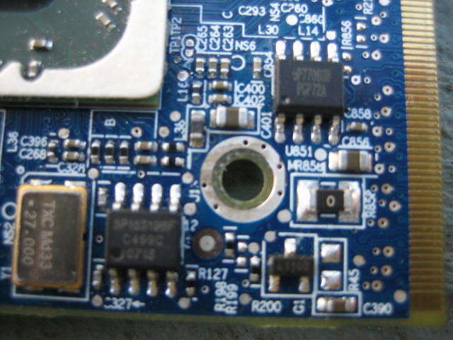

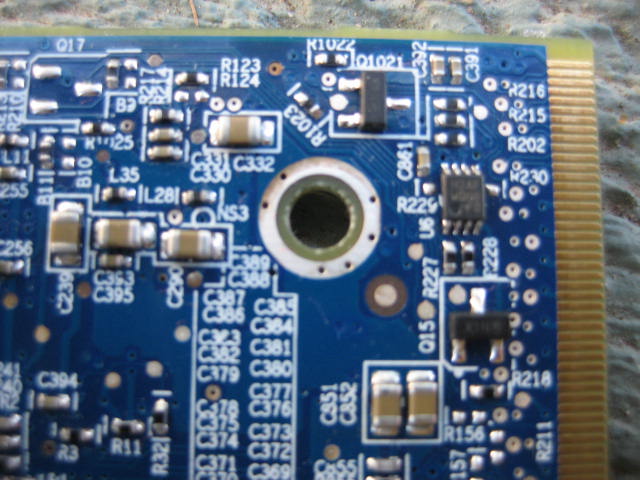

                      (See the attached photos of the GPU card below. The bits of white spongy thermal pad goo were still lodged among various components around C718, on picture#2 (named: "power-in section?.jpg)
                      and I traced the burnt smell to around L36 on picture#3 named "burnt smell - L36?.jpg", but it could be any of those components?
                      After cleaning it up, and using a thermal paste solvent to remove everything off the board properly, I put it back in, and the LED diag situation had changed.

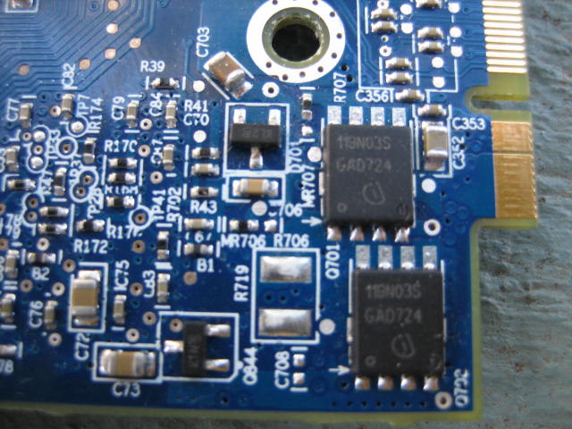

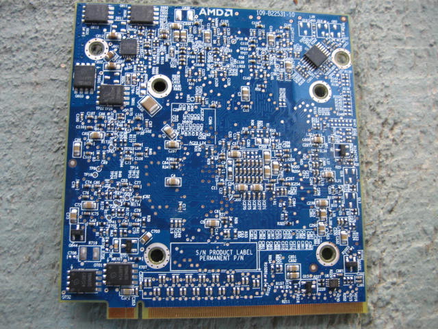

                      I've attached a photo of the GPU board (top and underside), and pointed out where I pin-pointed the burning smell on the board.
                      Do you think that maybe it's just a transistor that's blown? (there's no obvious burn or blown marks on any of the components that I can see), or maybe has broken down, and now isn't switching correctly?
                        congrats. sounds like you've successfully killed that HD2600.
                        those white thermal pads are there for a reason. removing them and just applying thermal paste results in no proper contact to the heatsink..
                        but even with the heatsink removed, and just the bare GPU installed, the same problem occurs.
