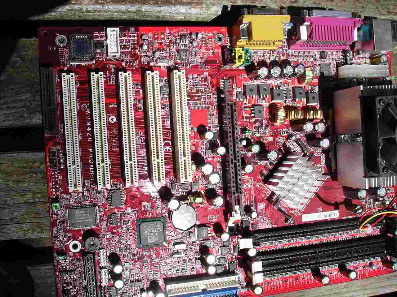

                        • pfrcom
                          Oldbie
                          • Jun 2006
                          • 1230
                          #52
                          Re: Which nVidia mobo chipsets are bad?
                          Originally posted by hardwareguy
                          nForce 1...the original socket A nForce. Meh....NF2 was way faster due to a dual channel memory interface, but it did work reasonably well. It's not common, I've seen exactly ONE board in the wild. You were better of with a KT400 and a GeForce 2MX....it didn't cost much more either.
                          Here's one, using the nForce 420D chipset - given to me because of bad caps
                          Also has "Twinbank Memory Architecture/128-bit DDR memory controller"

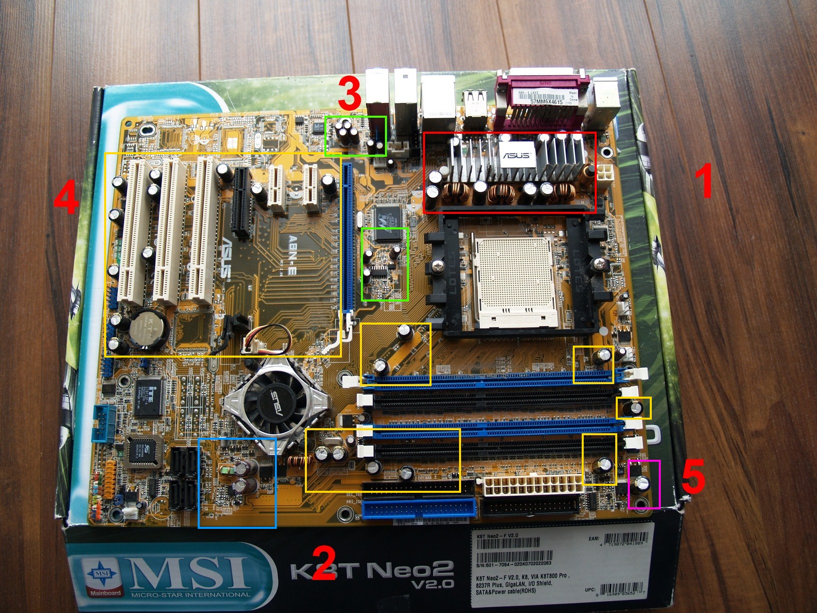

                              • gixie
                                • Feb 2011
                                • 14
                                #55
                                Here's the image:
                                Uploaded with *************
                                Now, the caps are as follows:
                                1 - KZG 1500uf, 6.3V, the red rectangle
                                2 - KZG 1000uf, 16V, the blue rectangle
                                3 - looks like KZG too, 100uf, 16v, the green rectangles
                                4 - no clue about the manufacturer, 820uf, 8.3V, the yellow rectangles
                                5 - no clue about the manufacturer, looks like #4, but different specs, like #1, 1500uf, 6.3V, the purple rectangle.
                                Let me know if you can understand everything properly. And also, which ones I have to change...Looks like, from what I've read, the culprits are the #1's.
                                ...And thanks for your support!
                                • yyonline
                                  • Jul 2009
                                  • 692
                                  #56
                                  Your unknown capacitors appear to be Panasonic, which are very reliable.
                                  Replace all your KZG capacitors and your board should be good. As for the KZG-like capacitors, only KZG and KZJ are bad. KZE and the other series by the same manufacturer are reliable.
                                  I'd also check the small fan while you have the board out of the case. They like to seize up. Replacing it while its apart would be pretty easy.
                                  • Scenic

                                    • delaware74b
                                      • Apr 2009
                                      • 628
                                      #58
                                      I had an A8N-E board (still in use) where the fan started to scream when the so-called bearings dried up. Put a drop of 3-in-1 oil in it until the replacement fan arrived. I also have an A8N-SLI Deluxe, which is actually older and the fan started to fail last August. I also did the 3-in-1 trick until I got the new fan.
                                      I've rescued a couple of 120mm fans the same way and they're still in use.
                                      Stupidity should be a crime, especially for drivers. I have NO patience for them.
                                      • gixie
                                        • Feb 2011
                                        • 14
                                        #59
                                        Thanks for the tip...BTW what is 3-in-1 oil? Will jig-a-loo work?

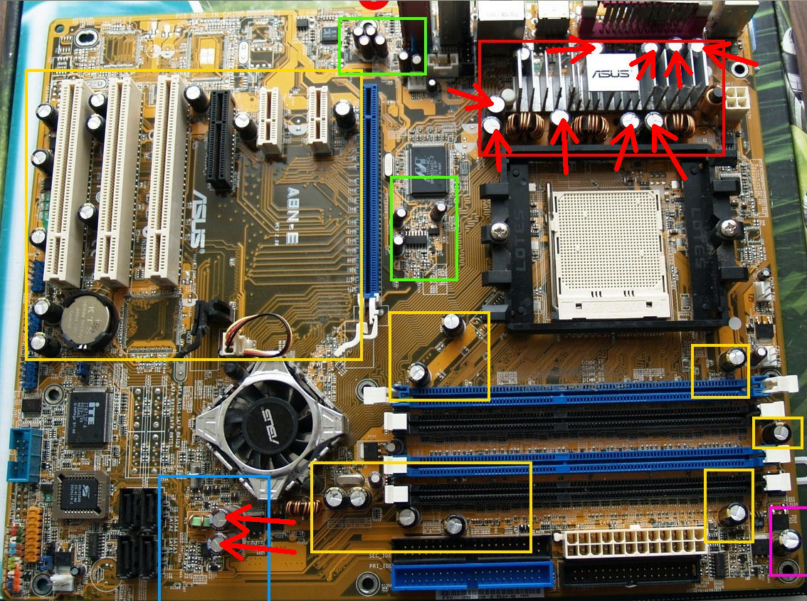

                                        • mockingbird
                                          • Dec 2008
                                          • 5484
                                          #60
                                          I indicated with an arrow what needs to be replaced. Please confirm that they are all 8mm in width. They should be either 16V 1000uF or 6.3V 1500uF.
                                          For the 16V 1000uF:
                                          http://www.mouser.com/ProductDetail/...E4E2mSMph7c%3d
                                          For the 6.3V 1500uF:
                                          http://www.mouser.com/ProductDetail/...LJ%252bKVJk%3d
