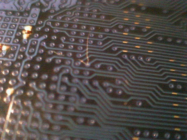

Think this is enough to destroy a MB?
  • Brandon
    • Dec 2005
    • 51
    yes no? The scratch isn't even NEAR a mount... Wonder how it got there?

    Re: Think this is enough to destroy a MB?
    Simple answer is to check for continuity across each of those scratched areas.
    Find an opening, scrape and bridge with solder, reasemble, boot.
    Picture is a little fuzzy to tell, but under magnification you should see it better.
    Jim

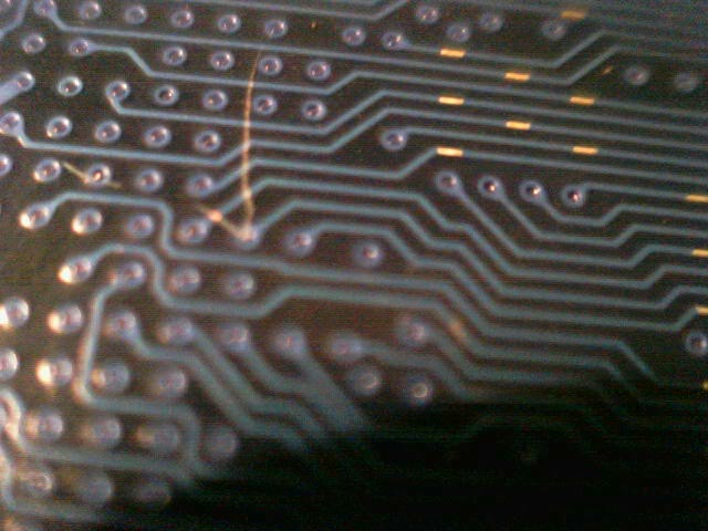

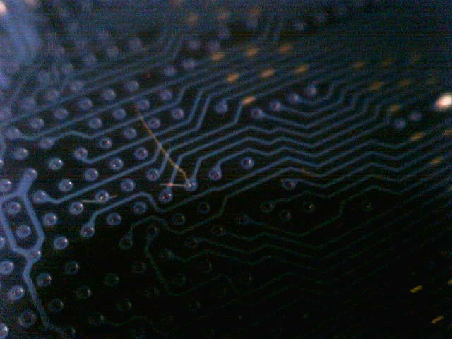

      Hope these pics help, my camera sucks.
      I wasn't aware you could fix a board with a "trace" scratch. Can you tell me what I would need, and other information you see fit for the beginner?
      Thanks!
        It doesn't look deep. I'd say it should work but you never know until you check the continuity. Sometimes it looks only a very small scratch but the trace is open.
              looks like rather large traces and tinned traces.
              looks to be an easy fix.
                The scratch is around dime size, the traces are rather large and seperated quite well.
                  Well....I'll just chime in for my 2 cents.
                  Easy fix. Even if it did open the trace(s), its easy to fix. You've gotten a lot of good suggestions above.
                  One other thing we used to do back in the day was to get a thin piece of wire. Solder one end to one side of the break and then solder the wire to the other side of the break. Then cut away excess wire on either end.
                    I'll second this, and add another recommendation. After finishing and checking for continuity and shorts, apply a thin layer of super-glue over the wires to encapsulate and insulate them. They won't easily dislodge after that.
                          I don't think you have to worry about any delay, in the area of those scratches there is nothing that looks like a delay line, the only thing that catch my eyes is something that looks like a guarding trace but it might be the autorouter that went crazy
                              Sorry Brandon not my meaning to be technical it just went out
                              If you fix a crack on a board with a piece of wire that is to long it might make a delay and affect the moderboard somehow.
                              When I fix scratches that are not to deep on thin traces I usually clean the trace with a small knife to get rid of the lacquer and then solder right over the scratch, remeber don't use to much heat.
