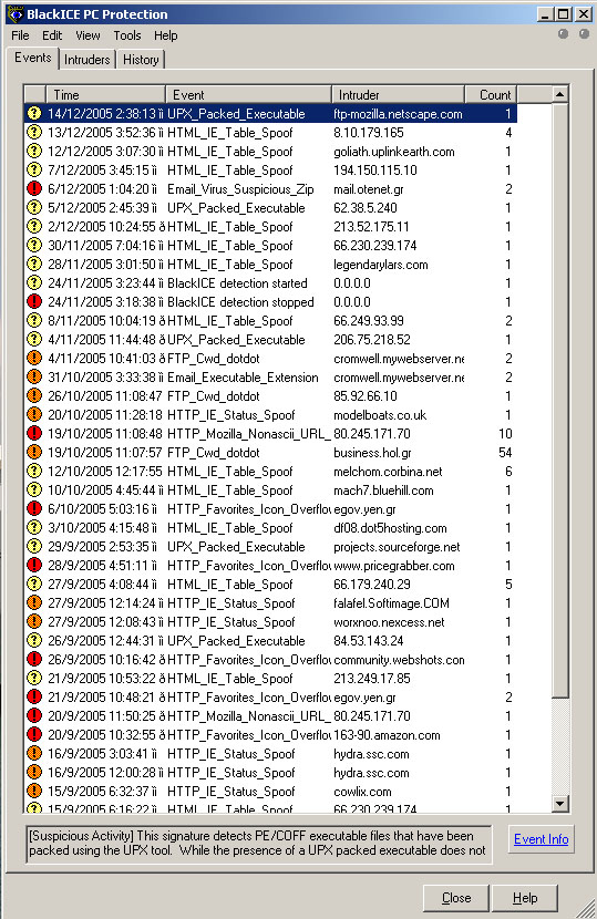

    AVG detected the Trojan Dowloader.Small.54.2 having infected \system32\wsock32.dll on one of my pcs.
    pretty admirable to have got passed zyxel router firewall, AVG and BlackIce.
    i chose to clean the file in AVG and it advised to reboot. now pc bluescreens on login. i did some safe mode checking of the registry and searched for files recently modified but did not find anything abnormal.
    its kinda late for troubleshooting so i will check it on the weekend.
    time to re-evaluate security here.

      blackice has some issues for instance if win2k is connecting to samba server, i had to add the server ip to trusted otherwise problems would occur. (have to figure out the ports sometime)
      Yesterday i found our accounting software Sage Line 50 gives slow performance when blackice is enabled. I had been troubleshooting that for a while. that is from a win2k pc with the data hosted on samba. i am guessing that the accounts software makes many small packets and blackice inspecting them slows it down. it also occasionally doesnt enable itself on boot, i find that on some client pcs.
      i would say that if the router has a good firewall then a local firewall is not really needed anymore. however on dial up at major ISPs here in Greece a firewall is a must, trojans trying to connect every few seconds. It was an eye opener for many clients when i first installed blackice on their pcs.
      here is my office pc's log from blackice. doesnt look bad.
