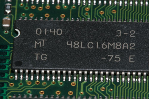

      micron looks like above.

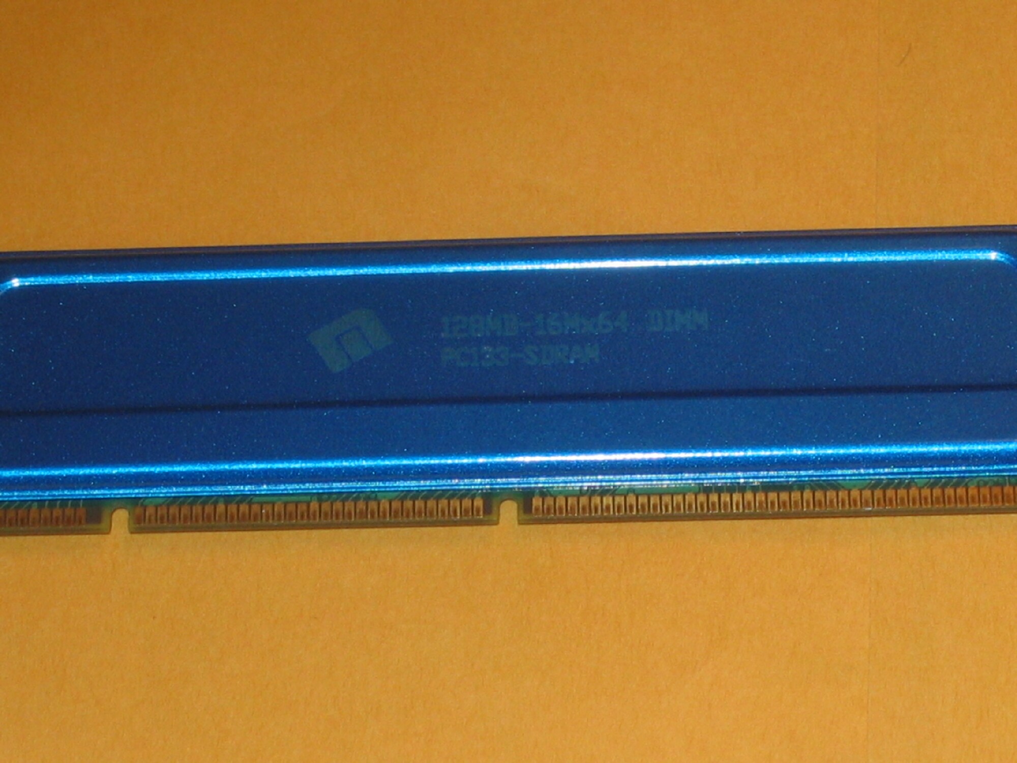

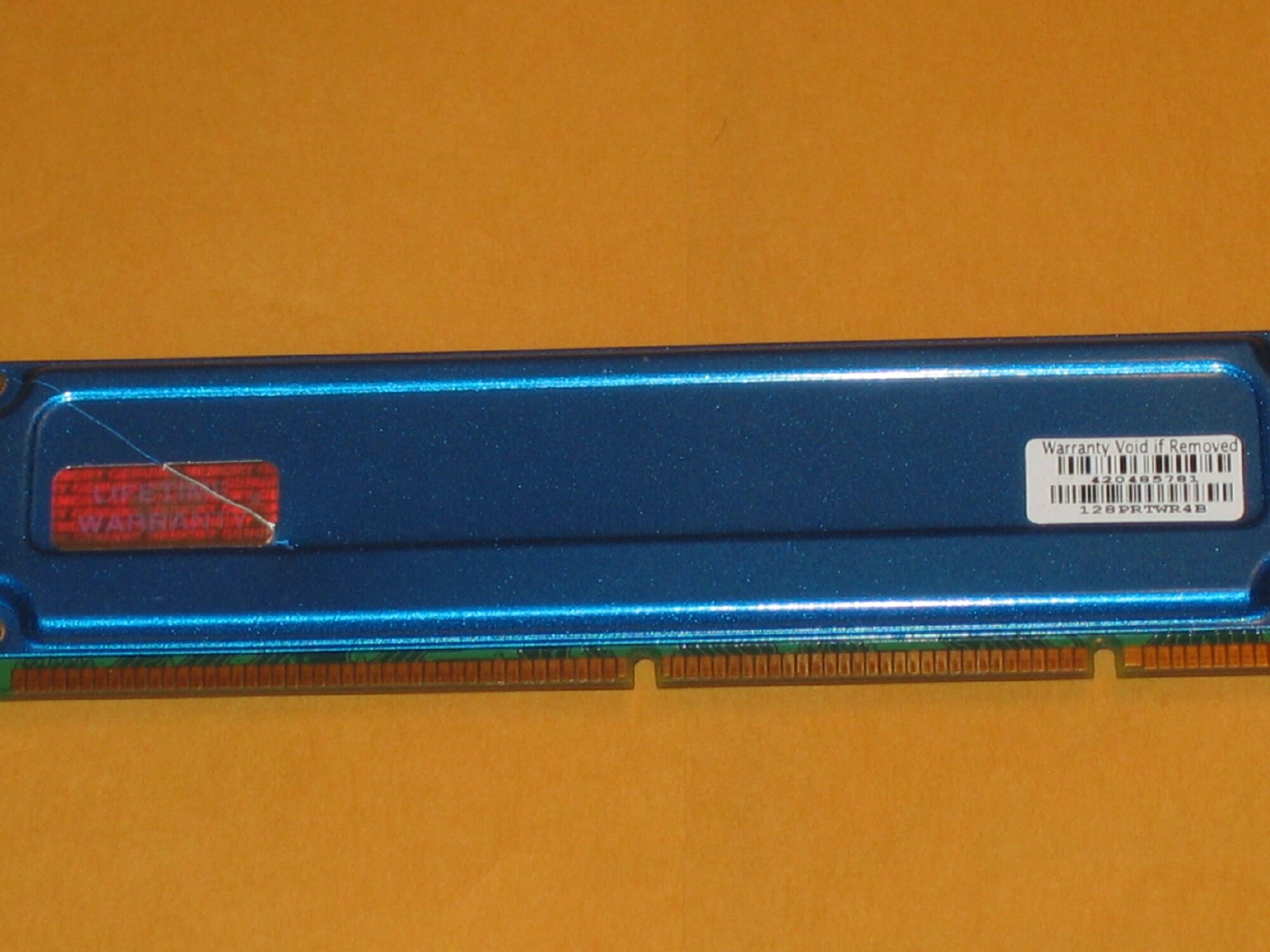

        Pictures of this memory stick:
        As you can see, the chips and all components are hidden under the heat shields or whatever they are. So, the only clue I have is that logo.

                Well....I tried everything I could. Looked up 420485871 and got nothing. Tried 128PRTWR4B and still nothing. I did get a bit on 128PRTWR4 though. Went to a dead end though. Needed to contact someone if I wanted to order.
                Even did an image search on PC133 to see if I could match a pic. (yes...I am bored) I did run across a nice site full of Penelope Cruz pics. (spent a bit of time there )
                My guess is you'd have to take off the covers to see who made the chips. Who knows. I'm getting into a place where someone else has more experience I'm sure.

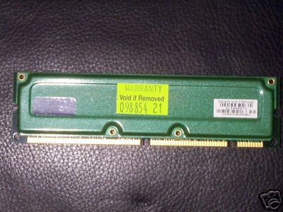

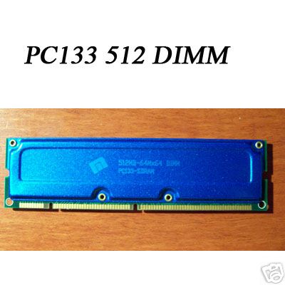

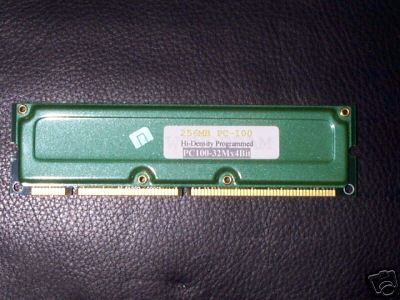

                      here's more sticks
                      http://cgi.ebay.com/SDRAM-256-PC-100...QQcmdZViewItem
                      http://cgi.ebay.com/NEW-PC133-SDRAM-...QQcmdZViewItem

                              its manufactured by celetronix memory group. for who exactly still dunno...
                              http://1006.tchosts.net/home.asp
                              http://www.celetronix.com/
                              i my search i came accross m-systems (not related) which have "Flash Disk Pioneers" under their logo. i remembered an unfortunate spelling in a greek computer magazine had their ad with the mispelling "Flash Dick Pioneers" wherever their logo was. excellent.
