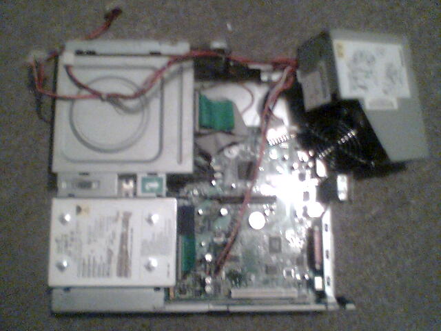

    Hello guys,
    my compaq system won't turn on. it simply shut off while working with the two led lights in the front full on. the processor fan and the power supply unit fan are constantly running.
    i already did some troubleshooting on the system, but no success.
    i suspect the power supply unit, but need guide on how to fix it. am average electrical electronics engineer, and would appreciate any help that can confirm the PSU good or bad

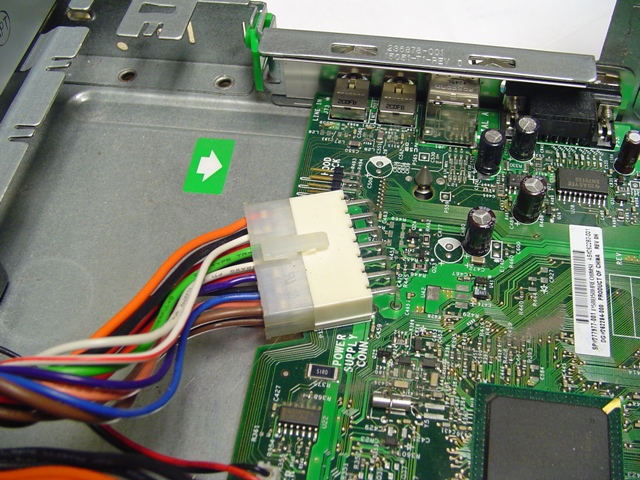

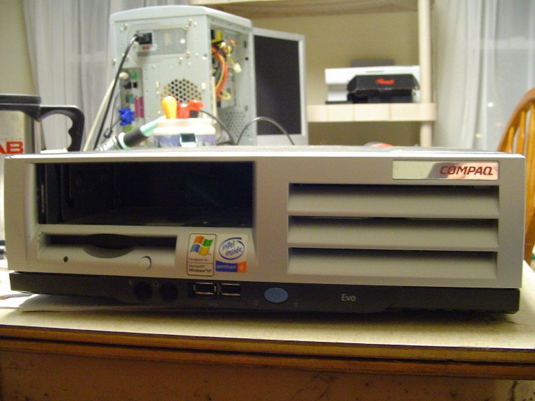

      Is the D510 a SFF (small form factor) or the mid-ATX form factor. Good clear photos can help us to help you.
      I have a couple of the D510's in small form factor and -can- spare a power supply, but I haven't seen a power supply failure.
      Most of the failures I've seen in the D510's is bad caps due to heat build-up and bad Nichicon HM's dated '02 to '04.

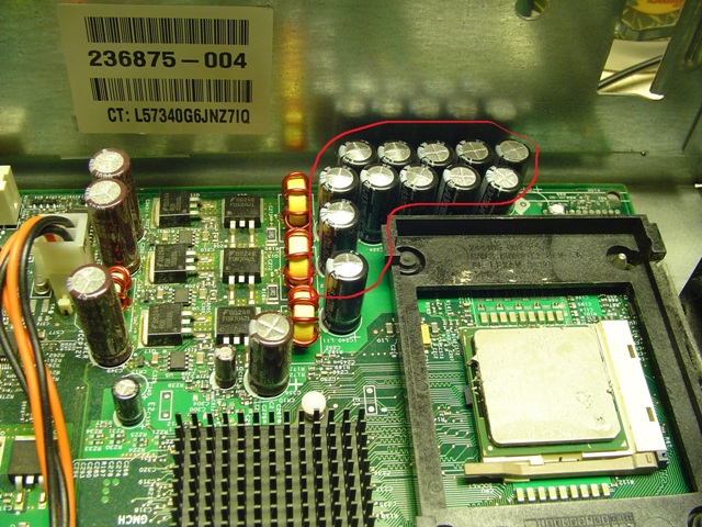

        I've attached photo's of a D510 SFF (small form factor). This particular model uses a nonstandard power supply connector although it does have the 4-pin 'P-4' connector.
        As you can see, this mobo needs a re-cap especially in the VRM section. It won't even boot, I've resurrected 2 in worse shape than this one by recapping it.

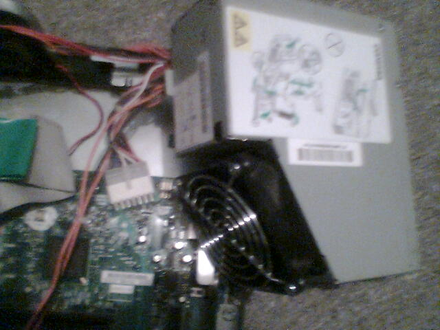

          i have attached two photos, i hope its clear enough.
          its Compaq d510 SFF p 2.4 GHz.
          the problems is that the two small green light remains on immediately i power it on for ever until i power it off. it doesn't boot at all

            ok can you give me step by step guide as to how to recap my cpu

                    Here is the pinout for the power supply in the EVO D510 SFF:
                    http://pinouts.ru/Power/compaq_pdp_power_pinout.shtml
                    I hope this helps

                                    What brand/series caps are around your VRM/CPU socket? If they're Nichicon HM's, blanket recap the board as a starting point. I know all 4 D510's that were given to me had HM's that are in the 'bad' date codes and are swollen.

                                      the brands are RUBYCON CAPs although i have three Nichicon HM's 1000uF 25v close the the four pin socket from the PSU
