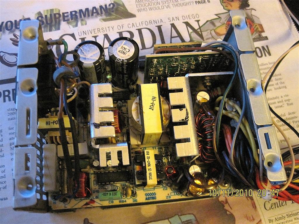

    I just got a smokeputer. It's not too bad in terms of nicotine but it has a lot of dust everywhere. I ripped the PSU apart and I couldn't even tell what kind of caps it had in it! (It was an old Astec PSU, so it had Rubycon and NCC in it)

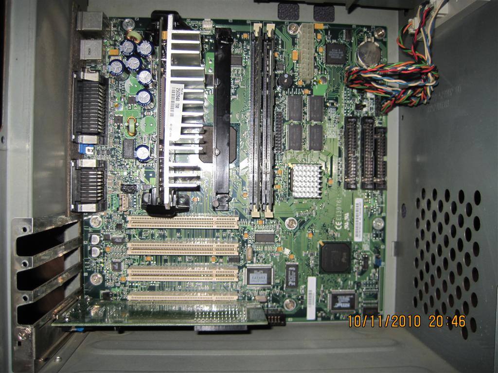

    I took the PSU board and the motherboard and drenched them with mean green, let them sit for a bit, flooded them with hot water, and threw them in the oven @ 170 F for ten minutes. Now I will let them sit for a few days to fully dry out. I was inspired by topcat's mobo cleaning guide and I've done it to a few boards. So far, the results have been great!
    That takes care of the electronics. All the drives in the computer are going to get replaced. That leaves the case.
    How can I clean the steel case? Hose it down and dry it?

    Use the same method on the case as the mainboard and PSU. Mean Green + garden hose = cleaned! Toss the opticals, I'm sure they're shot....if not, they're not far from it. I've cleaned many nicotine sludged cases this way!

                        Oh man... it came out so good I just have to show you guys.
                        I don't have any before pictures but believe me, the PSU was BAD. I could not tell what kind of caps the primaries were and I could not see where the rest of the caps were physically located because of how much tar dirt was in there. Here is the result after TC's mean green method:
                        Looks brand new!
                        The motherboard, particularly the area around the CPU, was also covered in crap and the whole thing just looked generally murky. Now it looks brand new!
                        TC's mean green method works wonders and makes 11-year-old components look new. I did the guts of the PSU, the motherboard, the RAM, the CPU, and the PSU fan. They all came out looking brand new and, after a 10 minute bake in the oven followed by a 24 hour drying session, they still work just fine.
