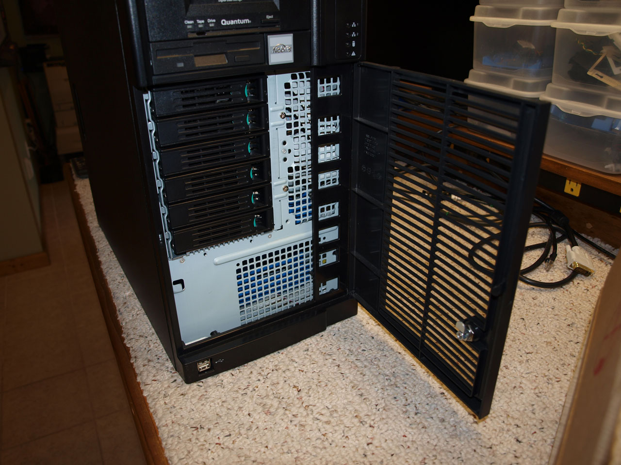

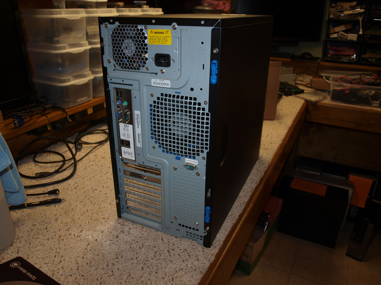

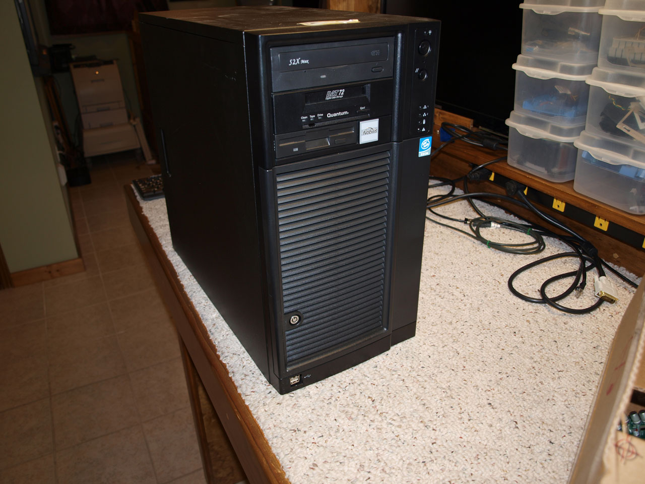

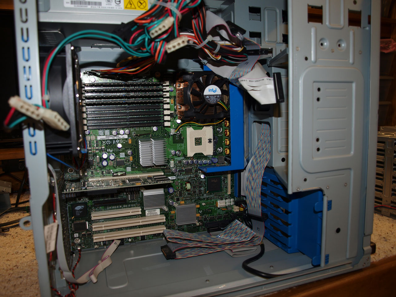

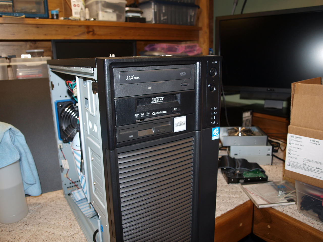

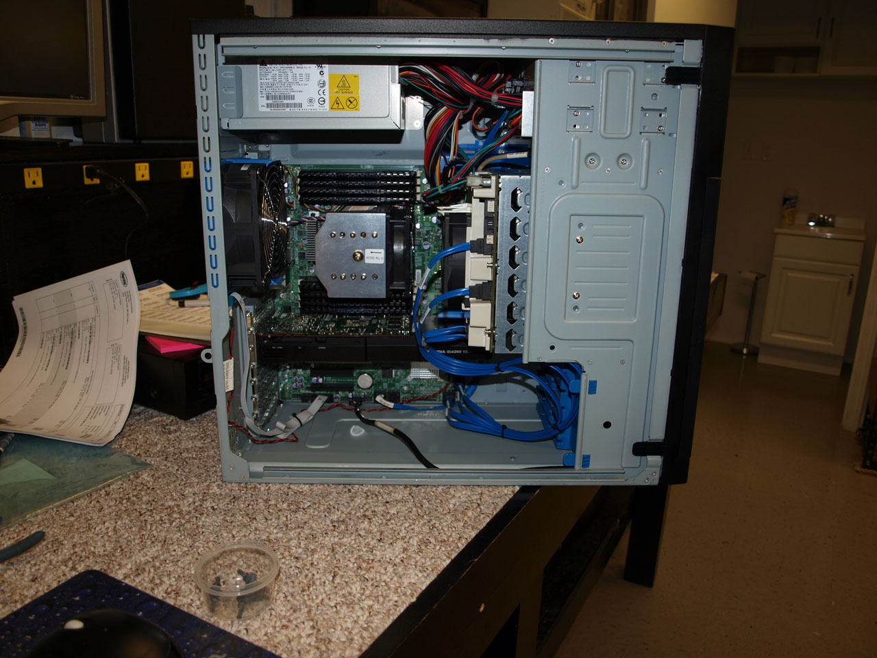

    First up is the case.....this came from the shop I cleaned out last October. This is an Enlight built server case OEM'd for Intel....and rebadged by Nobilis.
    This is a magnificent eATX case, very thick steel and very heavy old iron server case from 2005.

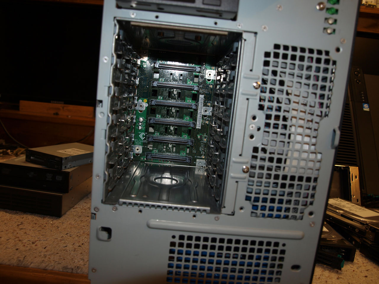

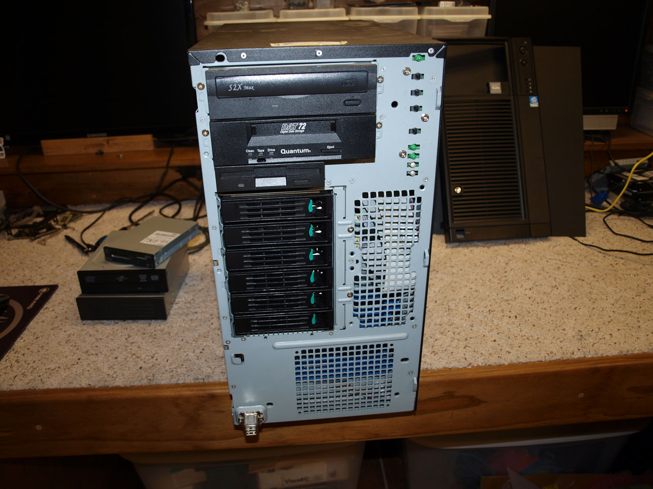

    6 bay hotswap bays...SCSI for now.
    Rear shot.

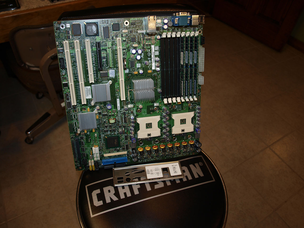

    Some intel dual skt604 server board...

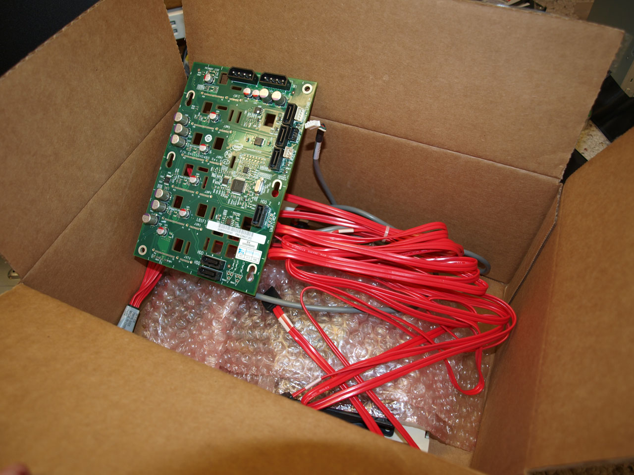

    Found in another box from the same shop....containing the SATA/SAS backplane needed to make the hotswap bays compatible with such. Lucky me!!

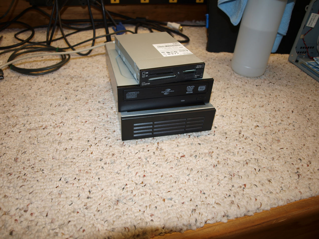

    What will replace the IDE CDROM, the floppy, and the SCSI DAT drive.

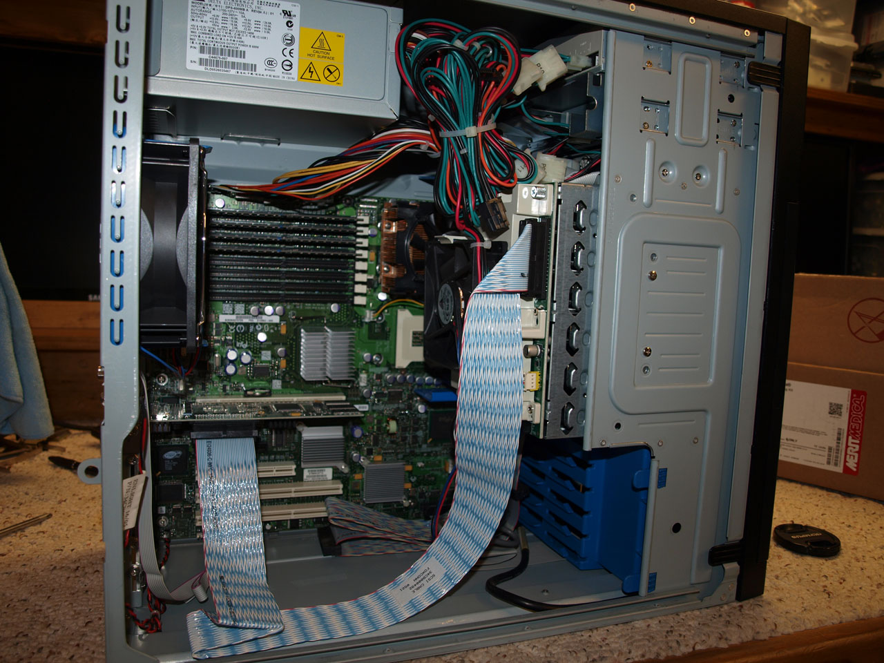

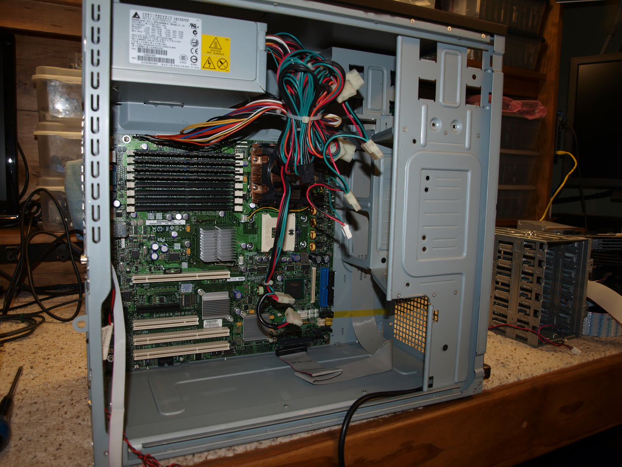

    Dismantling the case.

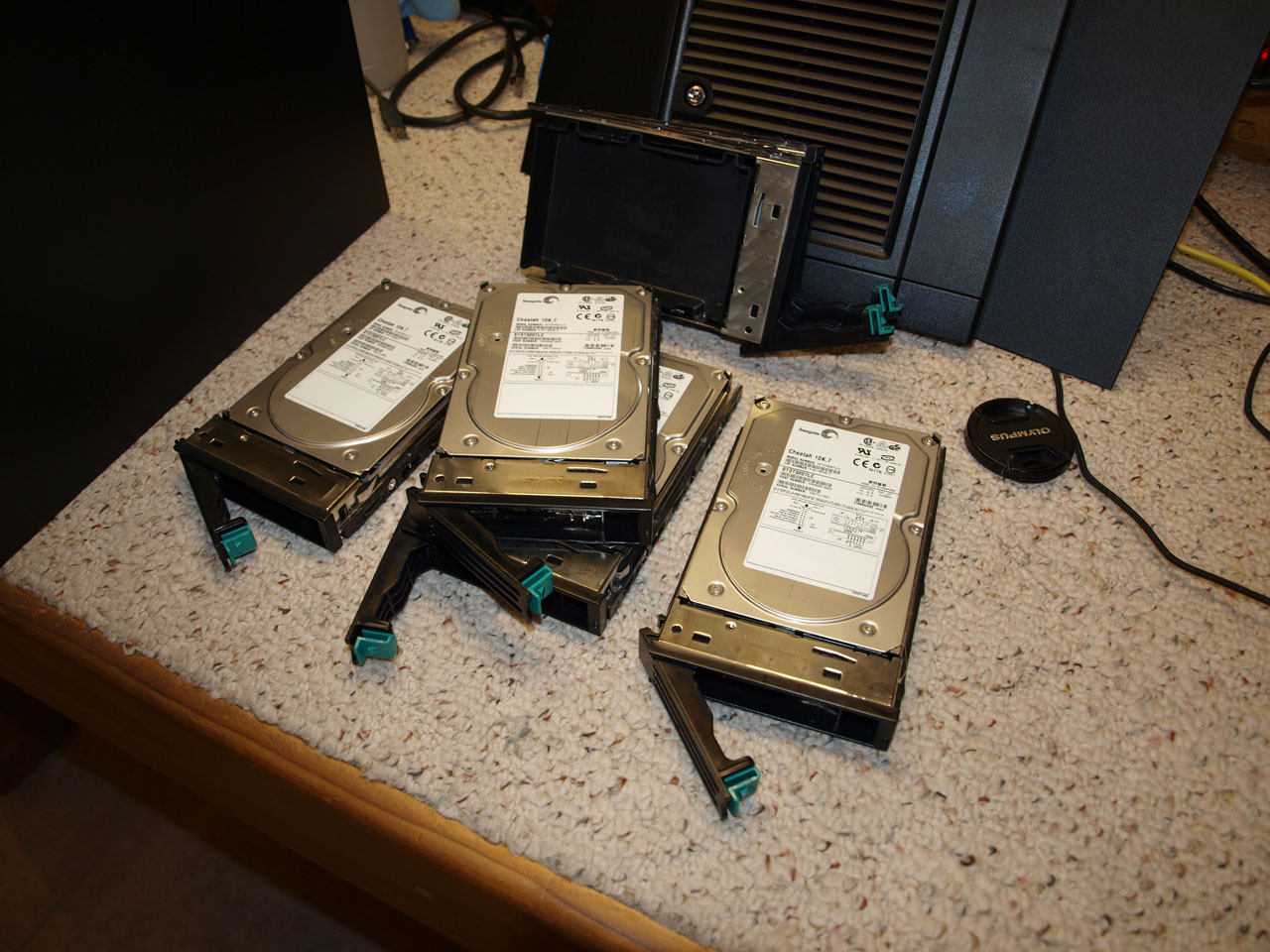

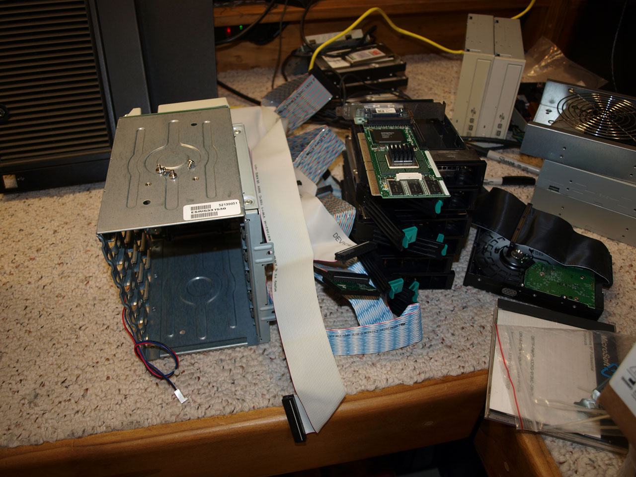

    4x 73gb SCA drives and 2 with the dummy trays.
    SCA backplane to be removed & replaced with the SATA one.
    Motherboard coming out....
    hotswap cage out first...
    Air guides removed.
    Pile growing...
    The big worthless board....

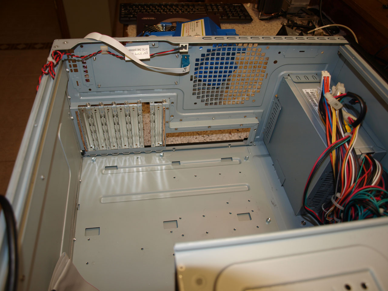

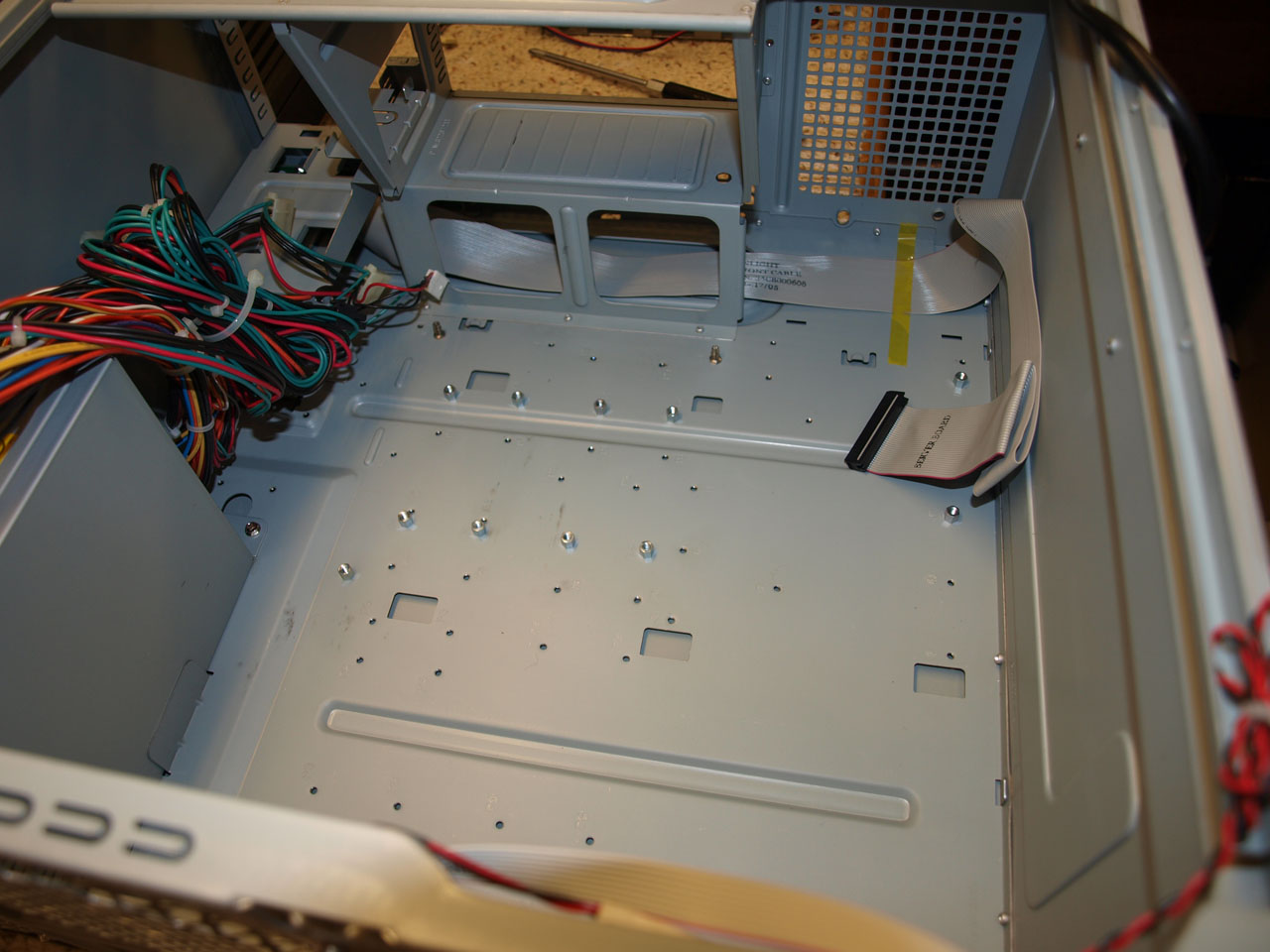

    Case empty.

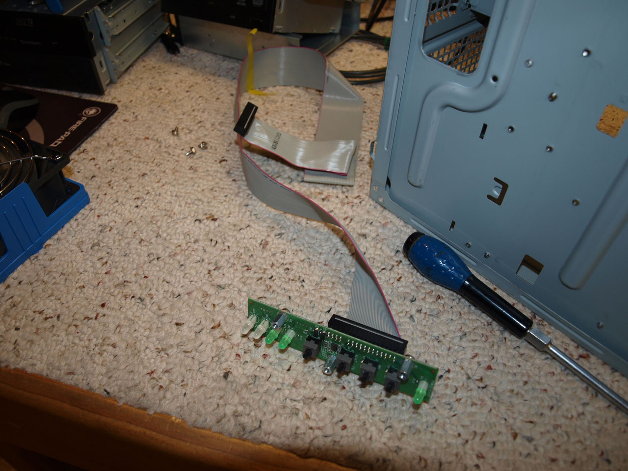

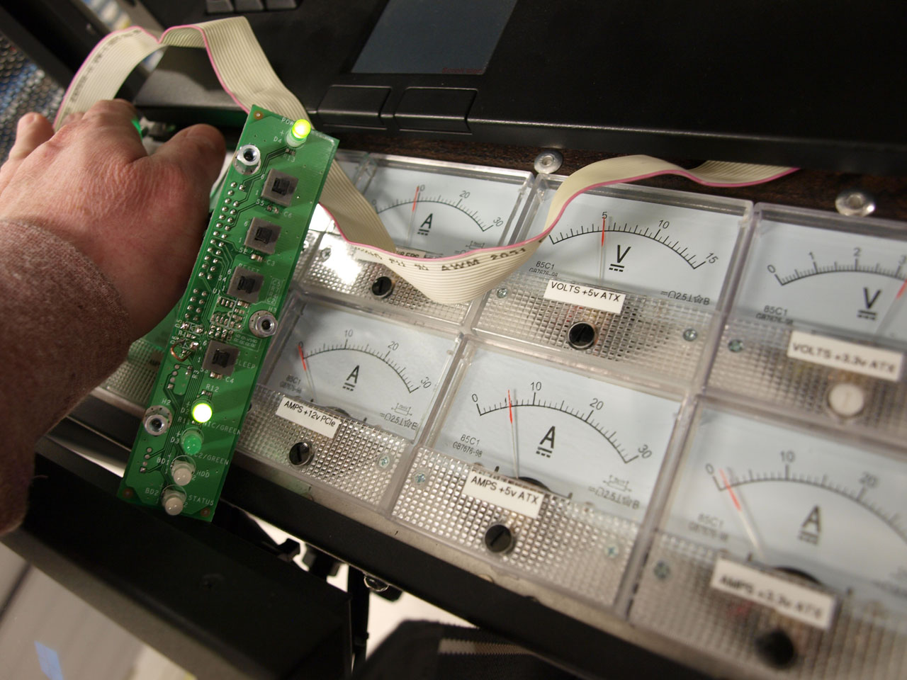

    The power LED & switch panel. This uses a flat ribbon cable proprietary to the board. I'll have to re-engineer this for use with standard wires....no problem.

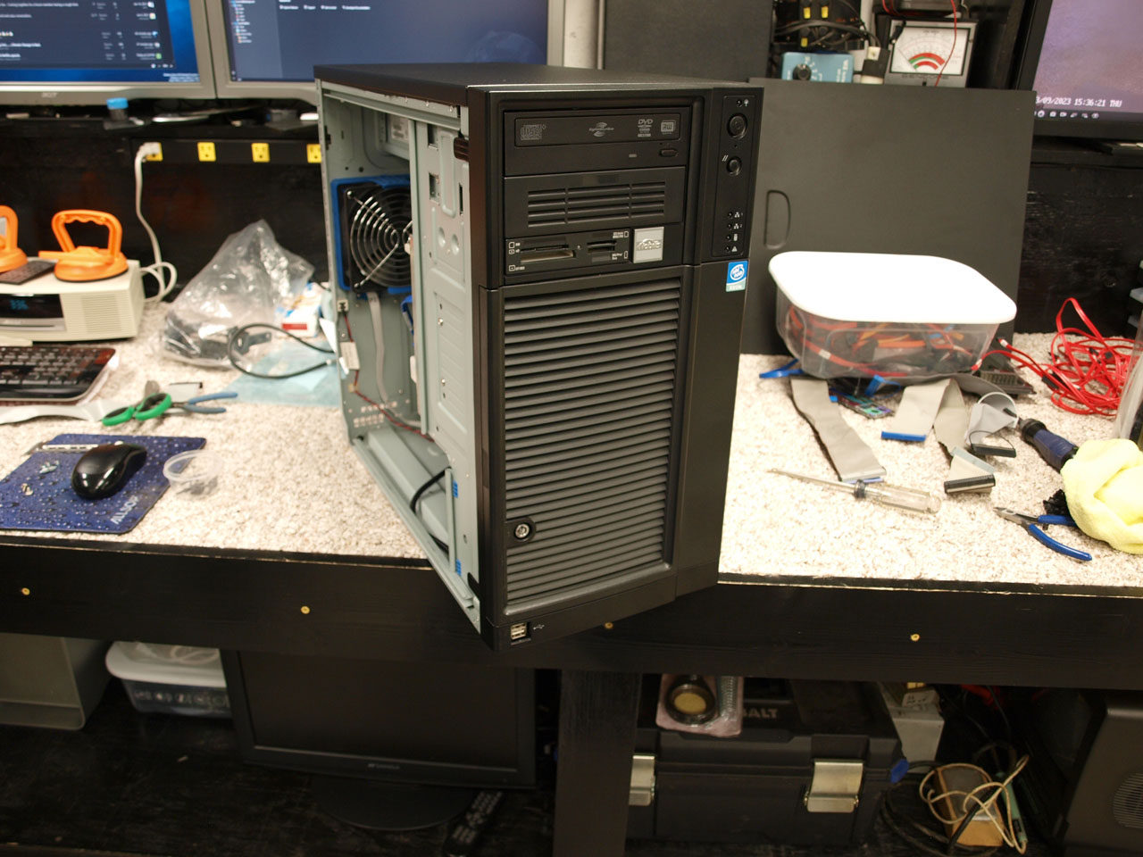

    Day 2 (and completion) of case prep.
    The SCA backplane removed from the housing. I have to give enlight (or Intel) credit, this was very well designed. I have to say it's on par with the quality of Supermicro.
    Now the cage supports SATA & SAS.
    Buttoned back up. The board to be used is on "Pat's Oven" cooking. I am also waiting for the IO shield to get here from China....so I just got the case ready.
    Next I'll modify the front panel button PCB for use with standard ATX front panel wires/connectors.

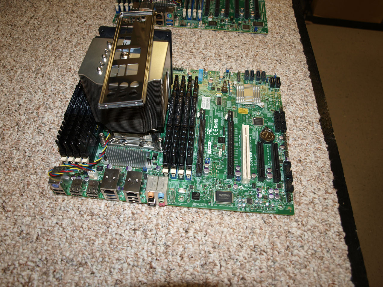

            The motherboard to be used in this build has completed testing and has been removed from the oven. I won't reveal it quite yet, but I will say it's only a single socket 2011... Yea, I still run lower cost 'trailing edge' hardware these days. I'll let someone else pay the depreciation. It will run the V2 Xeon; which IIRC is 4th gen I-series with big caches and more cores....but yea...I'm just now reaching the SKT2011 era. Of course it's a Supermicro....the only real hold-up now is waiting for the IO shield to get here...and the deciding on HDD's; do I want to run SAS SSD's or just plain SATA SSD's...I can do either one. Right now I'm leaning toward standard SATA; this way there's one less controller to wait to init upon boot and less complication configuring/installing.

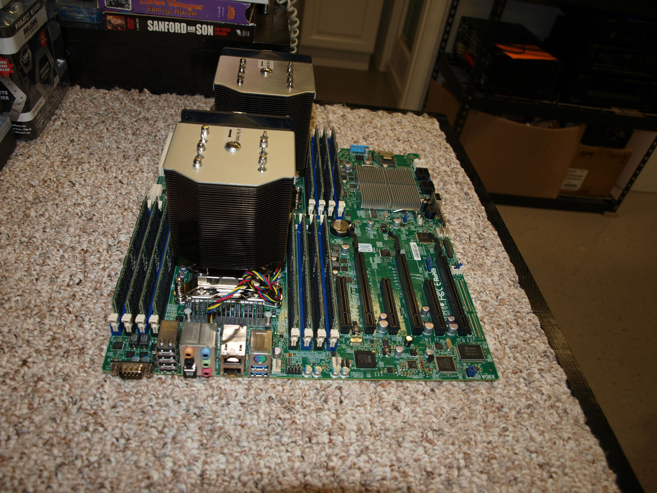

              Ok, I'll have to spill some of her secrets here; as this plan is starting to shape-up. I was originally considering this little beast.......
              ...but I quickly ruled that out. It's 16 cores 32 threads 2x E5-2667 v2 CPU's@ 3.3GHz and 256gb RAM. What a waste for what I do with my home system....so I decided to run with a single socket 2011 (supermicro X9SRA); 8 core 16 thread Xeon E5-2687W v2 @ 3.4GHz. I chose this CPU as it's the fastest OCTA-core for this platform. These can be had with more cores and less clock or less cores and more clock....but this one was a nice balance of cores versus clock speed. The board came with the cooler, which was worth better than half what I gave for the board with teh cooler. I added the 64GB of Corsair Vengeance RAM that originally came in the dual board shown above.
              Now back to the case.
              The next trick is making this:
              Use the interface cable for this:
              ...so I have to remap the ribbon... Not the first time I've had to do this, I'm sure it won't be the last. It's the front panel LED's & buttons obviously....being converted from Intel's proprietary interface to Supermicro's proprietary interface. The beauty of Supermicro's proprietary interface is that they make an adapter harness of normal wires for a standard motherboard as well....that is if I ever run a non-supermicro board in it....which is doubtful....but possible.
              More as it progresses.

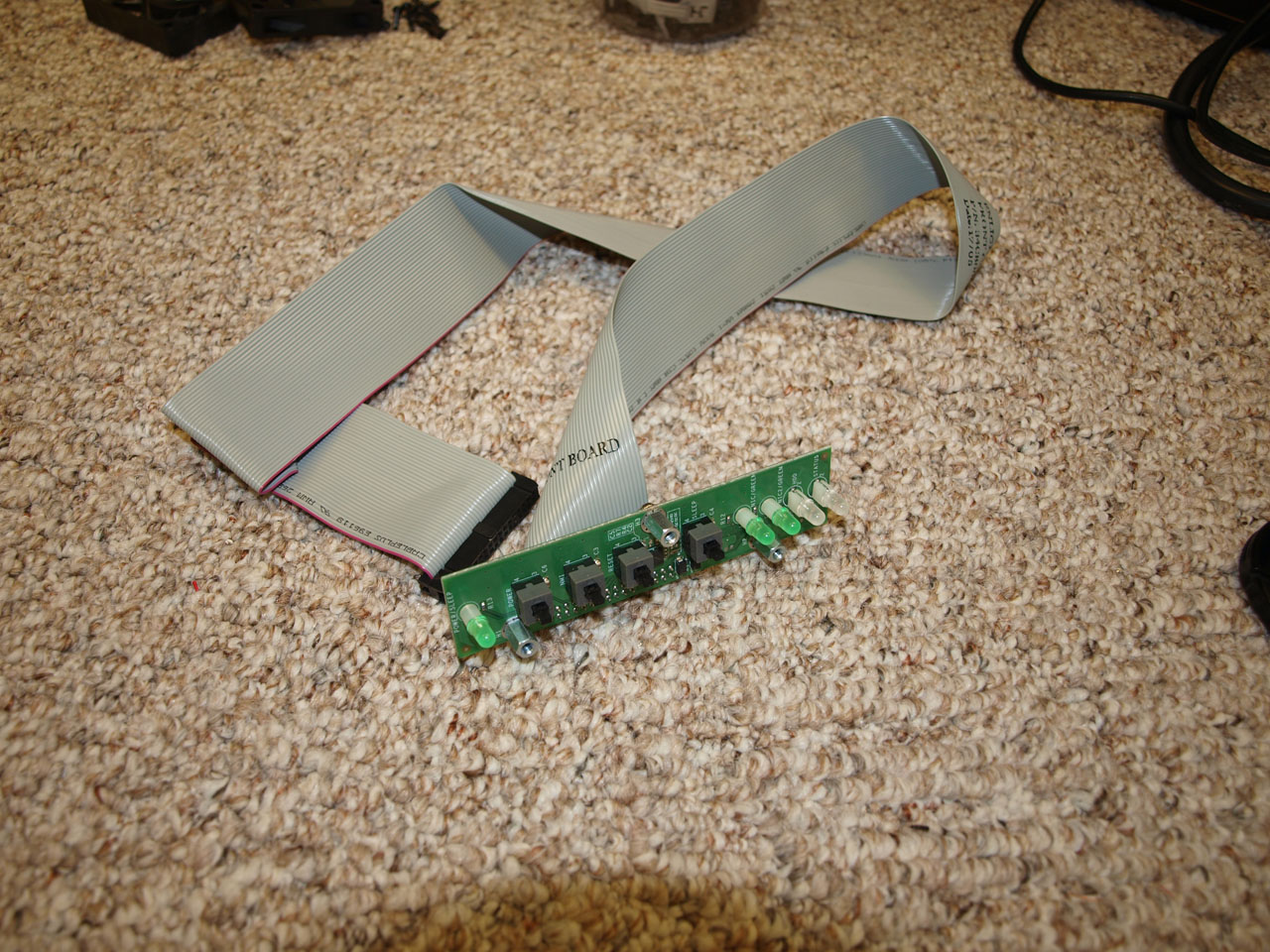

                Today's fun was mapping the front panel button & LED board....then it dawned on me.... Supermicro made an adapter harness to convert their proprietary ribbon to work with a non-supermicro board.....hmmm, lets just do that in reverse!
                I pinned out what goes to what on the panel itself and as if by some miracle everything was right next to eachotehr.....to even include the PWR LED being a 3-pin! Ok, sounds easy....and to just plug things in it was....but... There was some circuitry on this board, not sure what it was for....but it's no longer needed....so I removed and bypassed where necessary.
                The ends of the proprietary SM ribbon. This ribbon came with a SM board I rescued for peanuts off ebay....as a matter of fact, it will be used as the test bed for this modified panel....incase something goes wrong, it wouldn't be much of a loss. All these connectors are the same on SM boards.....so if it works on this one, it'll work on any.
                Plugged in...
                Everything is working. Top LED is PWR ON. The top of the four lower ones is NIC1, the green one right below it is NIC2. The one below that is HDD activity. The last one *WAS* a 'status' LED, but will be using it for the OVH warn.
                Reinstalled back in the case.
                Now installing the board...or starting to anyway....
                Slid the SAS cage back in, wanted to see what clearances were like. Very nice fit. I could have gotten another eATX in there, but would have had to use lower profile heatsinks; especially on the front-most CPU....but being a single socket, there were no clearance issues at all. Nice fit actually!
                That was as far as I got.....

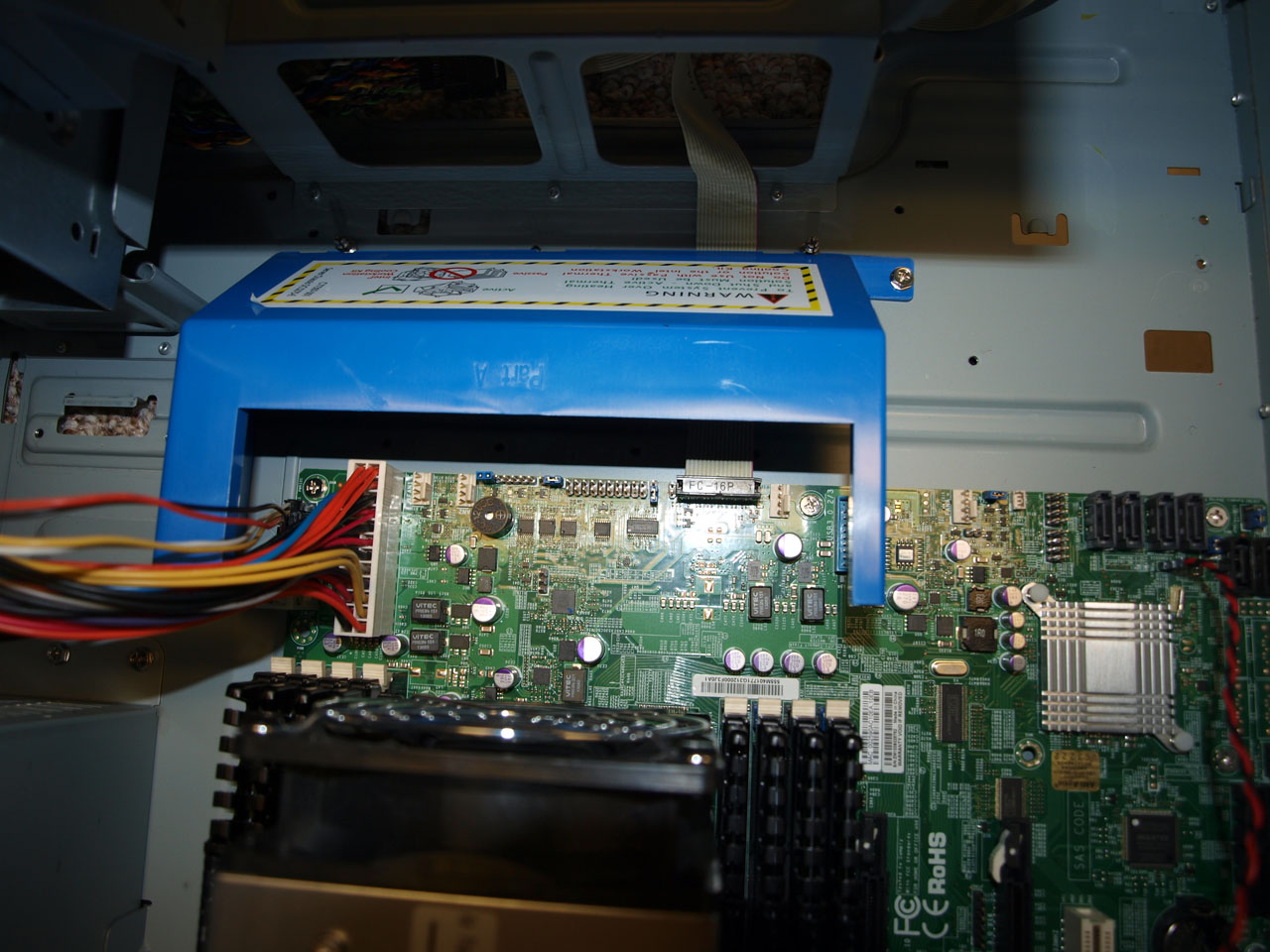

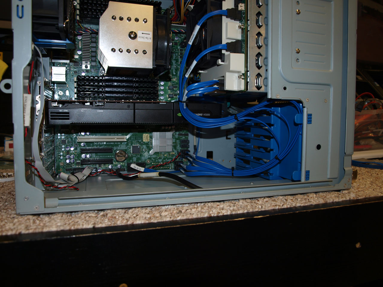

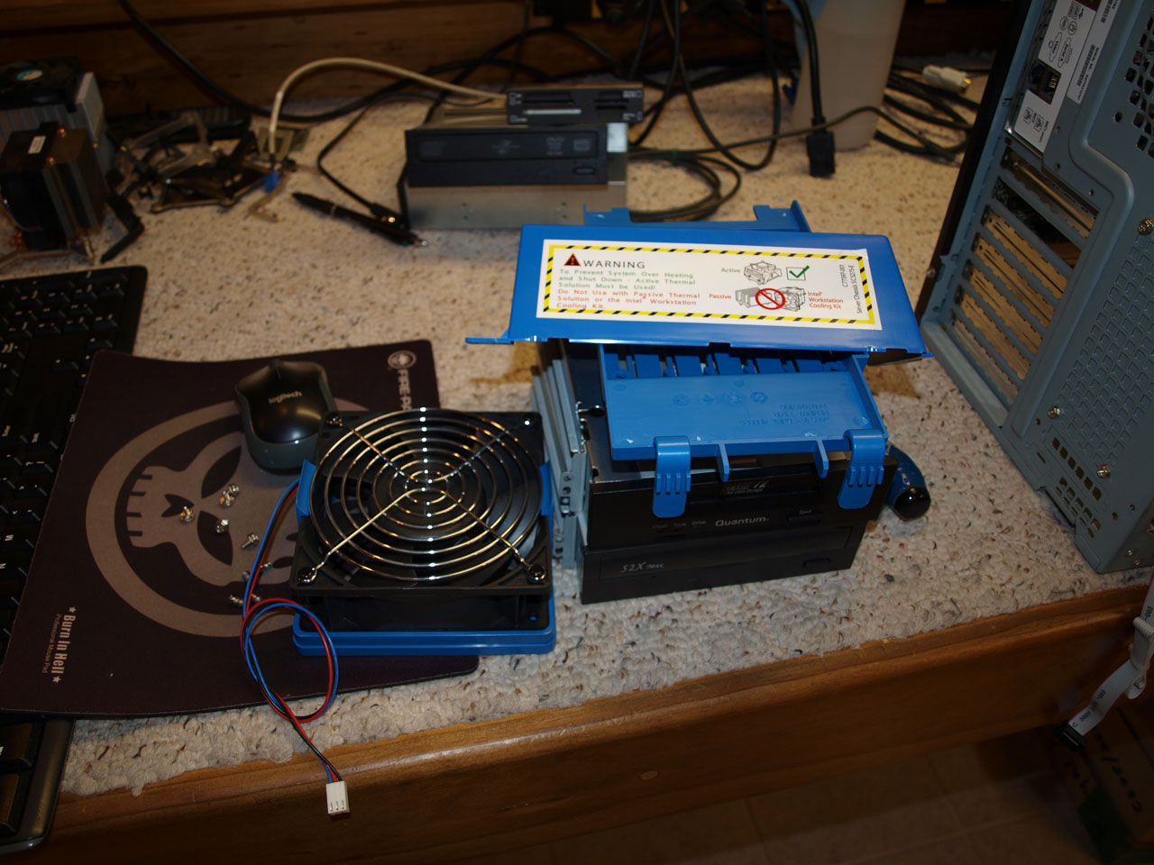

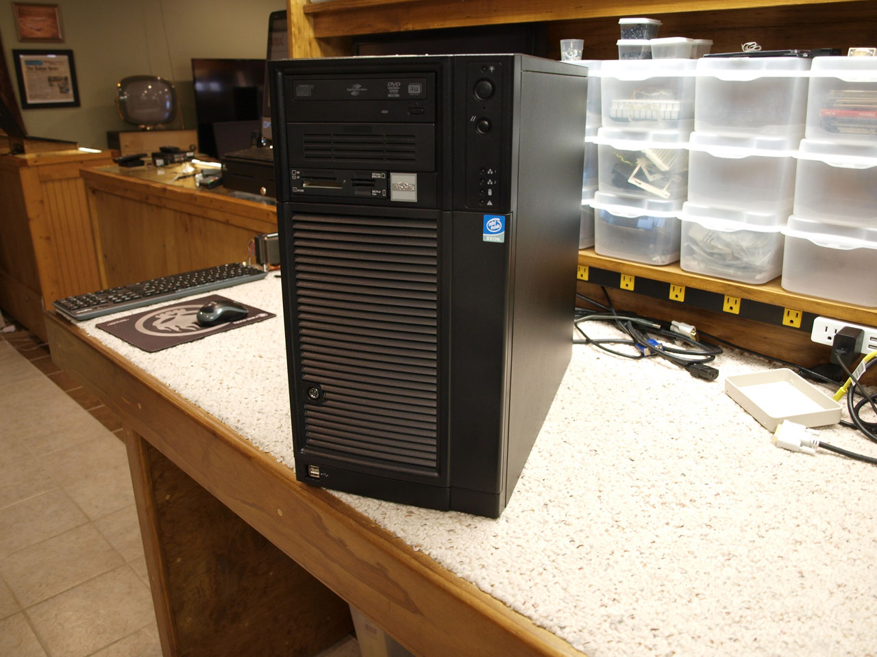

                  Got this one buttoned up....not a bad one for as cheap as it was done...but it seems anything DDR3 these days is pretty cheap.
                  Air guide back in place & PSU connected. You'll also note the nice clean ribbon interface for the front panel.

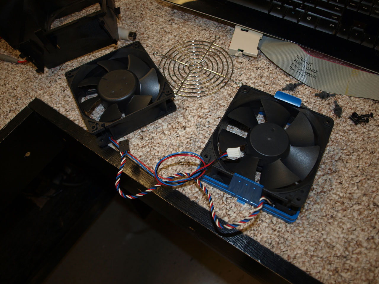

                  Next up is a re-pinned 120mm PWM fan to replace the 3-pin 12v fan. It had to be re-pinned, as it was wired for a Dell connector...pulled from an Optiplex 330....I still have quite a few of those.
                  The old one and the new used one. The old one is a good air mover....but really loud!
                  Wired up....even has an external COM connector. Connector was original to the old Intel board....but the X9SRA has 2x COM port headers....and they're pinned the same.

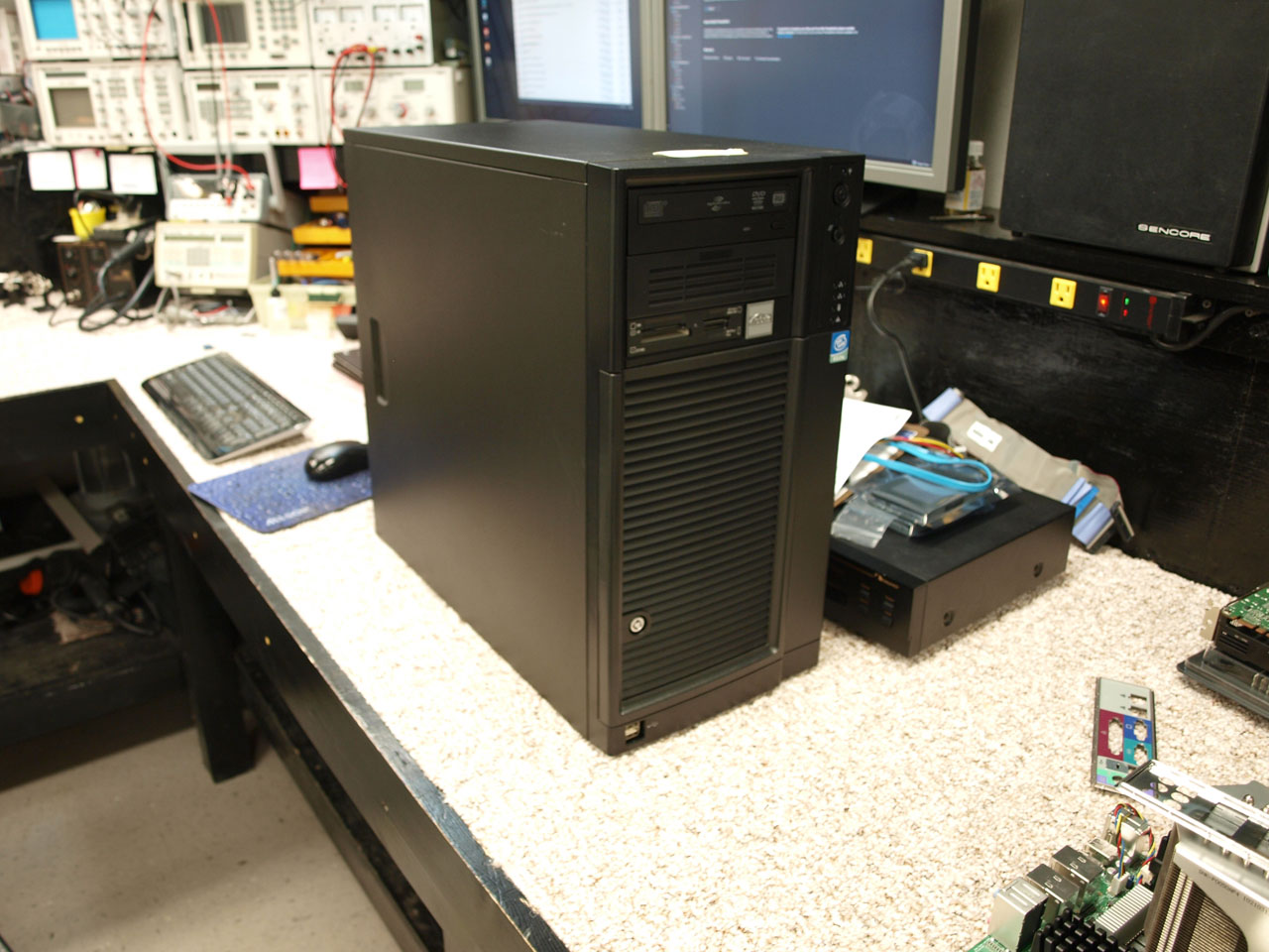

                  I still think it's a nice looking case! I removed the Server 2003 COA from the top of the case....not easy to remove after nearly 2 decades stuck on there...but its done and not a bit of damage to the case. Soften it with mineral spirits and then careful plucking at it with soft plastic edge. Won't harm the case finish, but you do have to be patient.

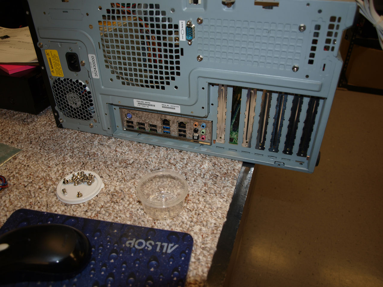

                  Overall, went together nice. Good fit of hardware.
                  Butt shot of course.
                  Fired up!
                  This was part of the Enterprise experiment from THIS THREAD.
                  I am still tweaking this a bit....but it'll be deployed over the weekend most likely.

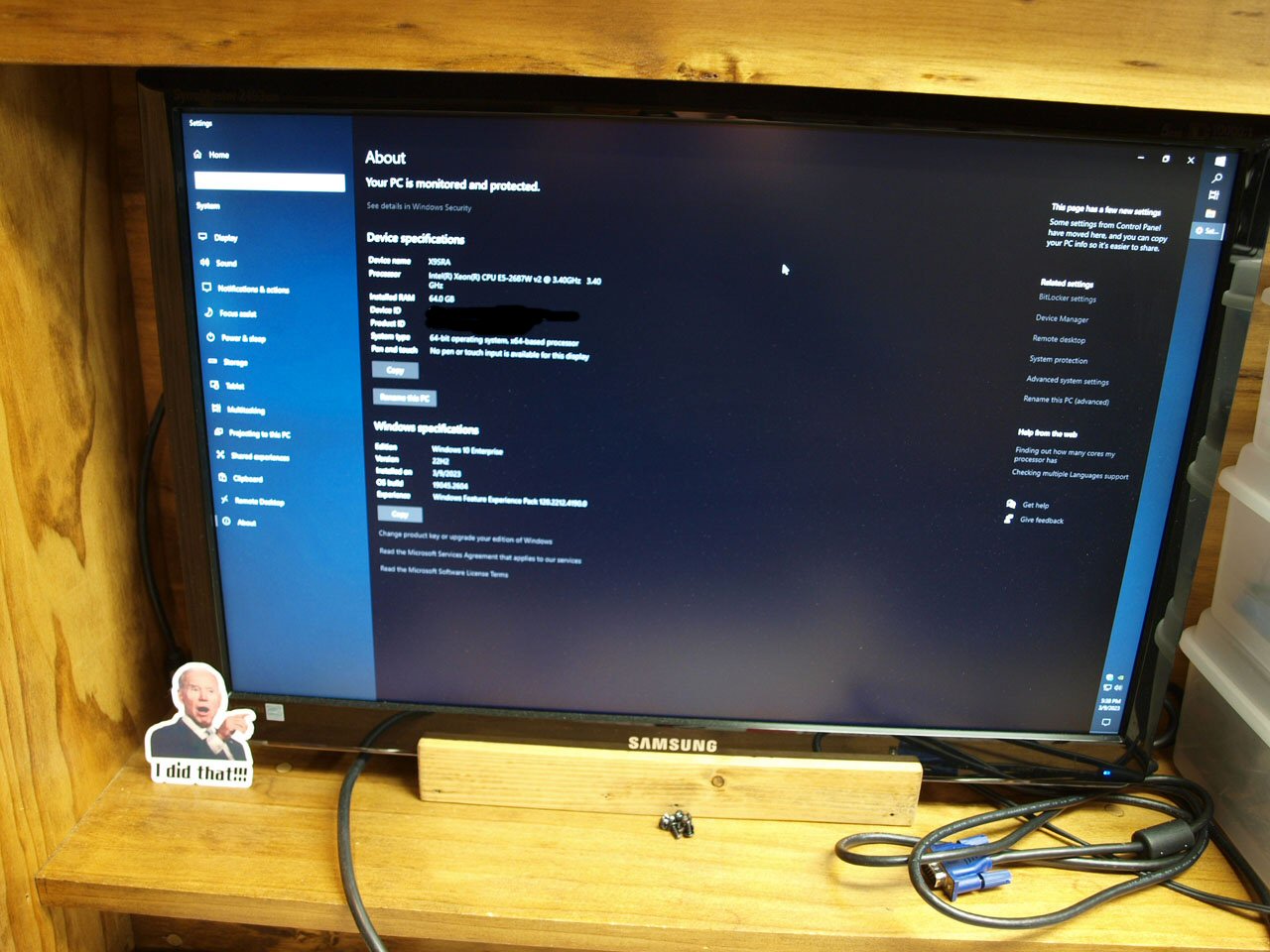

                  Specs:
                  Supermicro X9SRA Motherboard
                  Xeon E5-2687W V2 8-Core @ 3.4GHz
                  64gb PC3-12800
                  Quadro M5000 8gb GPU
                  960gb Kingston SSD

                    Deployed without issue. The one thing I change was pulling the Audigy FX out of the decommissioned system and adding it to this one. I forgot how crappy an onboard realtek is in comparison!
                    Had to say goodbye to Server 2012 R2 on the home system (what was on the old one)... It's the 8.1 interface, like Win7, browser support is going to be drying up up and security updates end this year. Moment of silence for a great run with that OS.

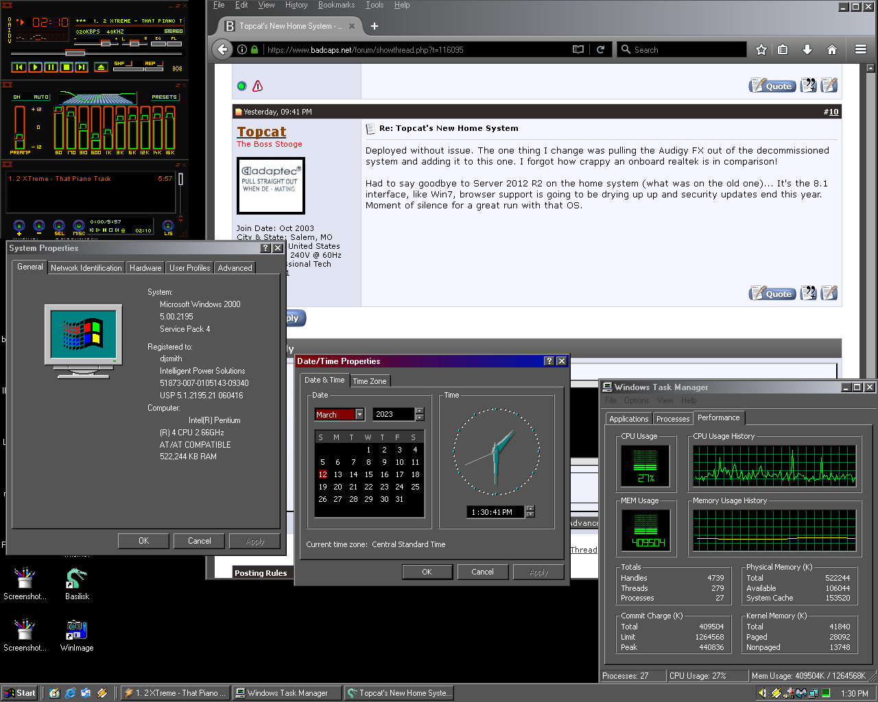

                      Checking in from Windows 2000! The run's still going on this OS for me. Dell Dimension 2400 with a Northwood P4 + 512MB DDR + Soundblaster Live! running Windows 2000 USP5.1 and Extended Kernel 3.0e.
                      I may or may not pull the SB Live! and drop it into my main workstation, as its onboard Realtek audio has gotten to be rather noisy and hissy over the years.

                          Thanks! I've attached the registry file to import it. You'll need to rename the file (delete the .txt) and manually edit it and add your own SID (from HKEY_USERS) to get it to import properly.
