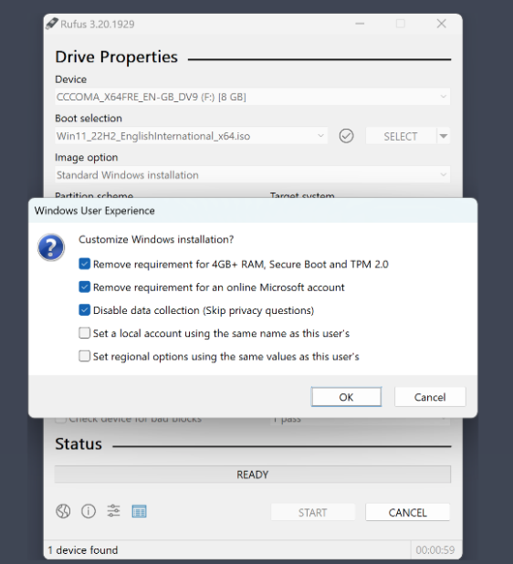

            Re: Company Locked Laptops
            Originally posted by brethin
            You have to change the windows hardware I'd period.
            or you can make a bootable USB stick with rufus 3.20, check "Disable data collection" and skip connecting to internet by clickíng "I don't have internet"
            Other thing it worked to some HP and Lenovo models was to put laptop in setup mode instead of user mode in security boot.
                  None want a computer that can never connect to the internet, so what I said or make a bookend.
                  lol, who said you can't connect to internet? If you skip data collection win install doesn't check if device is managed by an organisation so it allows to setup device without internet. Once setup is finished you can use device without problems connected to internet. Others install windows on ssd in another computer and put ssd to the managed device and can use it with no problems, it's another way to skip data collection of the managed device.

                                  #36
                                  You clearly have no clue what we are talking about here.
                                  you clearly have tunnel view , "You have to change the windows hardware I'd period." "do what i said", well, I didn't do what you said and I did it my way in tens of laptops and miracle! they are working without problems.

                                        #39
                                        Originally posted by sam_sam_sam
                                        How do you override the data collection on widows 11 because there is no way that I have found that works consistently
                                        same way, make a install usb stick with rufus 3.21 and check boxes as in picture
                                        • Per Hansson
                                          • Jul 2005
                                          • 5895
                                          • Sweden
                                          #40
                                          I think the above option just does what you can do yourself in Windows, i.e. set it to the lowest setting (that means data collection is still active)
