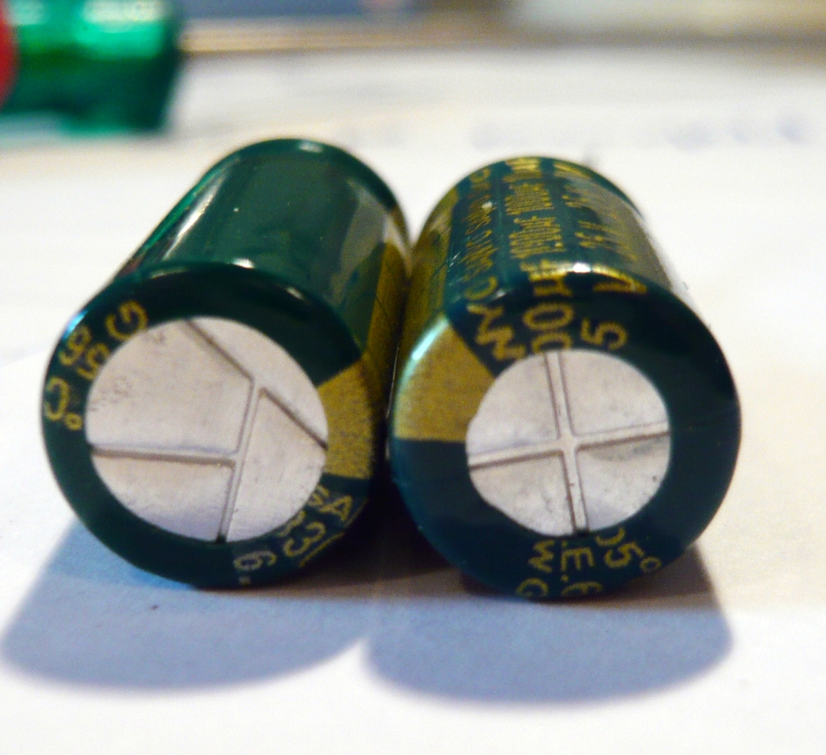

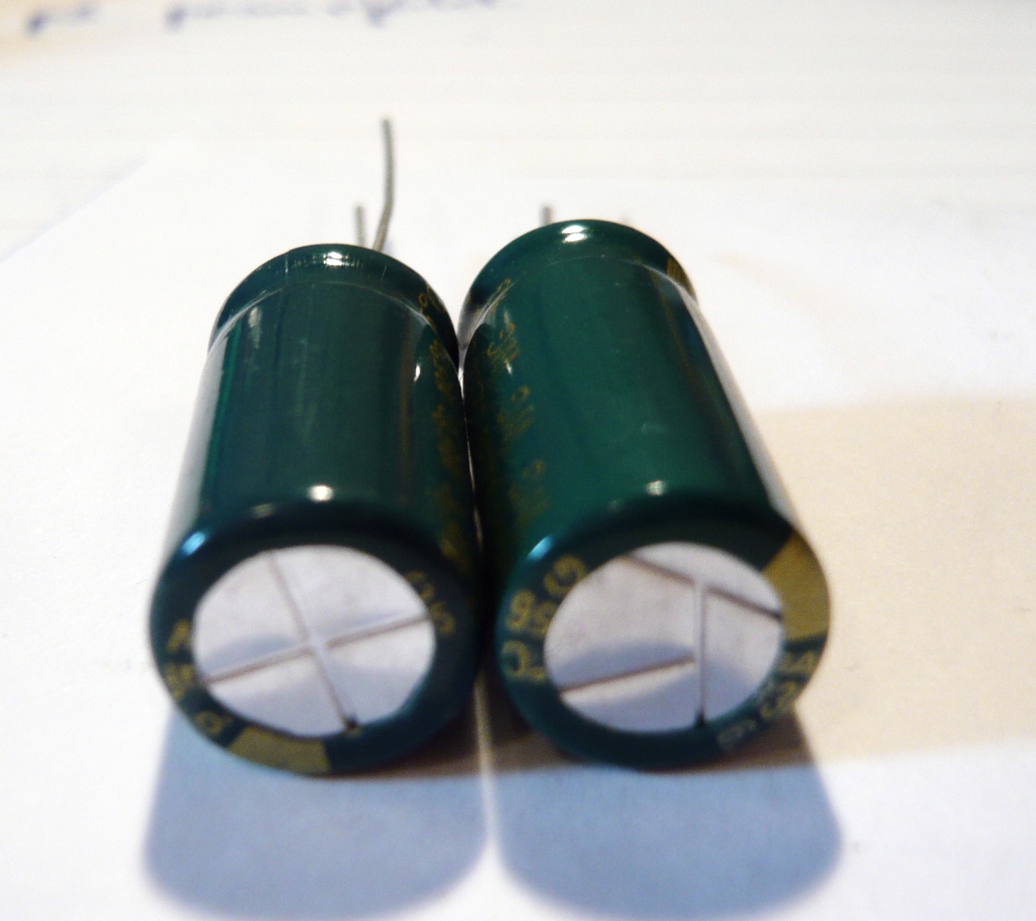

    Sanyo WG fake
    Aware of the ebay seller: goodbuy711 - ALLPARTSPIPE but I guess that you all know that.
    One is Sanyo WG 6.3V 3300uf.
    The other "sanyo WG 25v 1000uf". from allpartspipe.
    10x23mm.
    Slighty different colour tone. Wierd bottom, X at the top.

    Re: Sanyo WG fake
    Looks like a Teapo capacitor...

      Re: Sanyo WG fake
      Even good fakes will always have the sleeving pulled too far over the vent.

        Re: Sanyo WG fake
        Teapo don't have "X" vents.

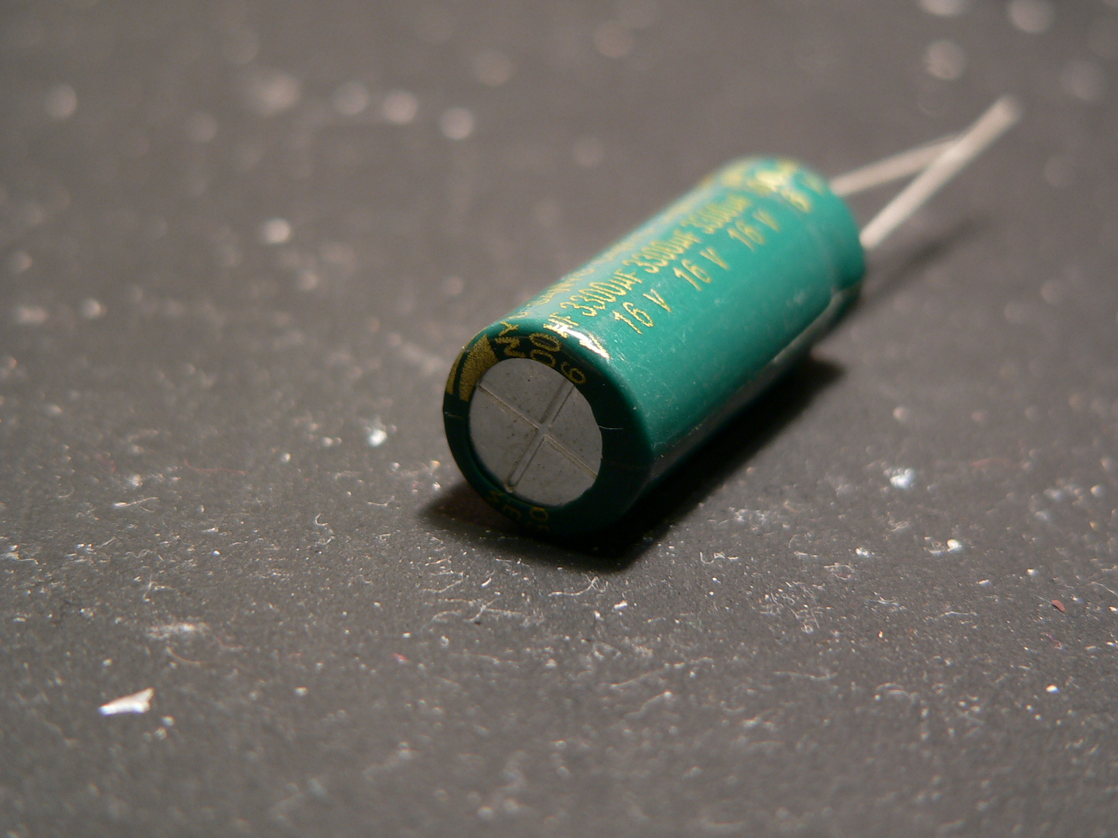

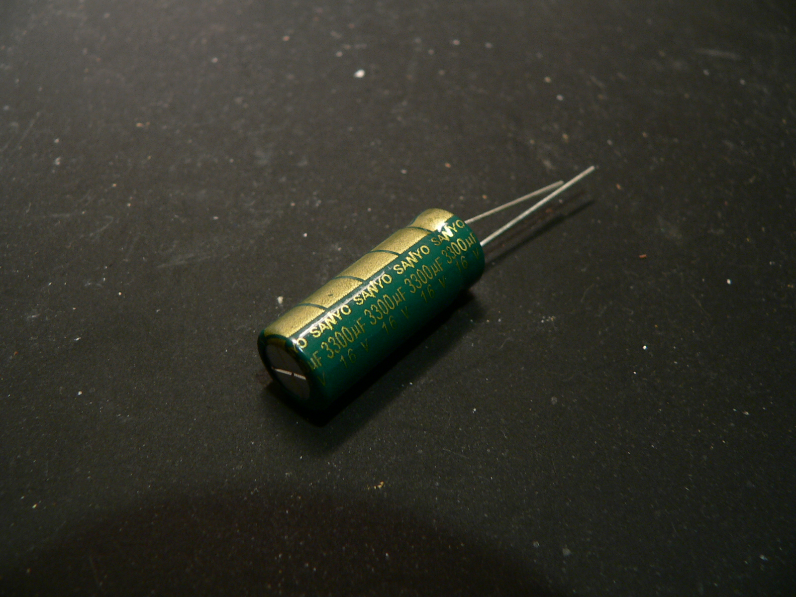

          I just bought some Sanyo WG 3300uF 16v 10mm caps from eBay seller may139188, and they look like they may be fakes. I'd like a little confirmation before I confront the seller about this - can someone take a look at these caps and let me know if they're likely fake?
          • mockingbird
            • Dec 2008
            • 5484
            Re: Sanyo WG fake
            Steven - those are most certainly fakes.
            • c_hegge
              • Sep 2009
              • 5219
              Re: Sanyo WG fake
              Yup, the + shaped vent gives it away. It should have a K shaped vent. Throw them in a fire and watch them explode.

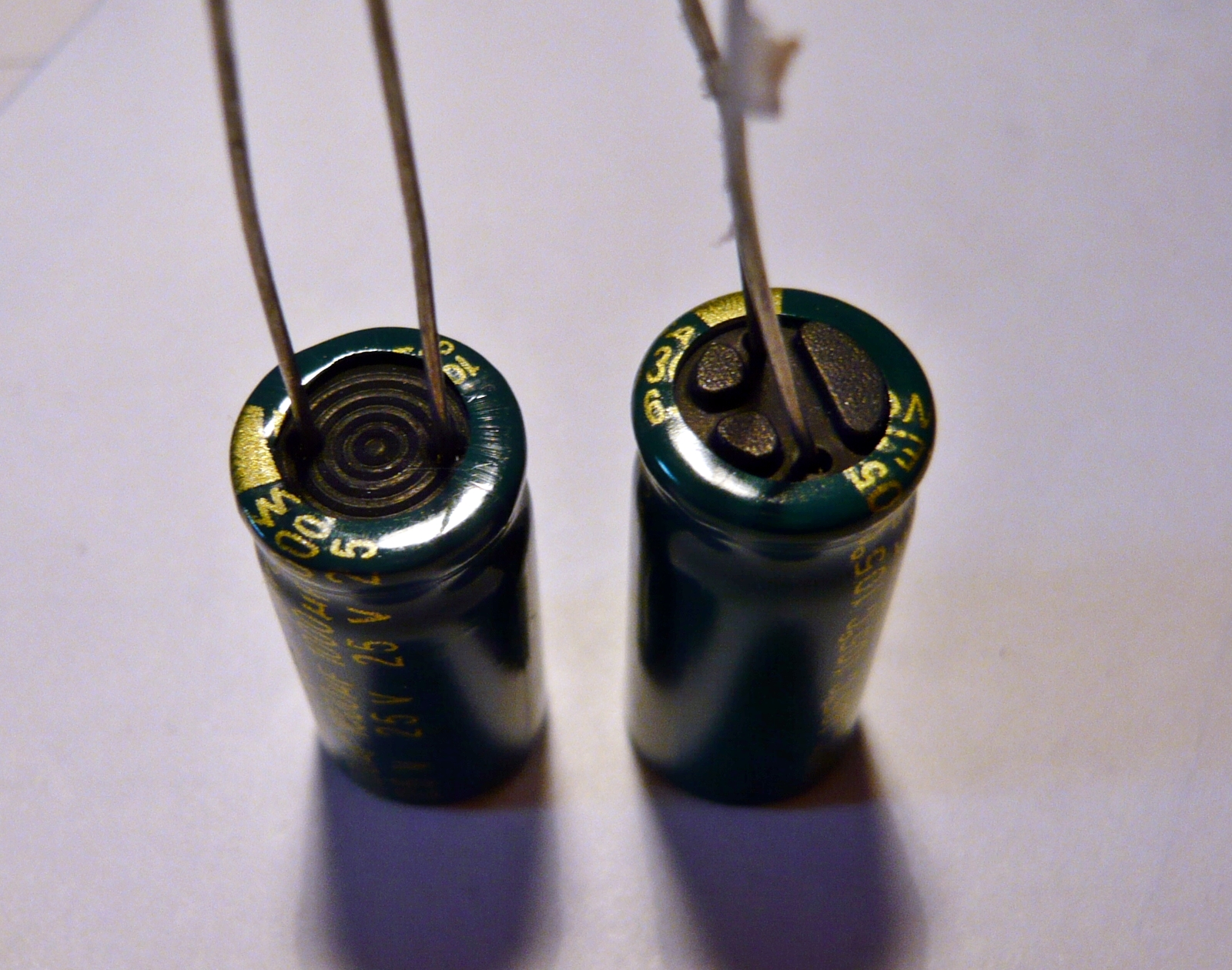

                • Per Hansson
                  • Jul 2005
                  • 5895
                  • Sweden
                  Re: Sanyo WG fake
                  The bung also gives it away, it should have an elaborate bung, not just a flat bottom with some circles (on some of the caps? lol)
                  If you search for my forum name and Sanyo you should be able to find a post where I posted pics of some genuine Sanyos...
