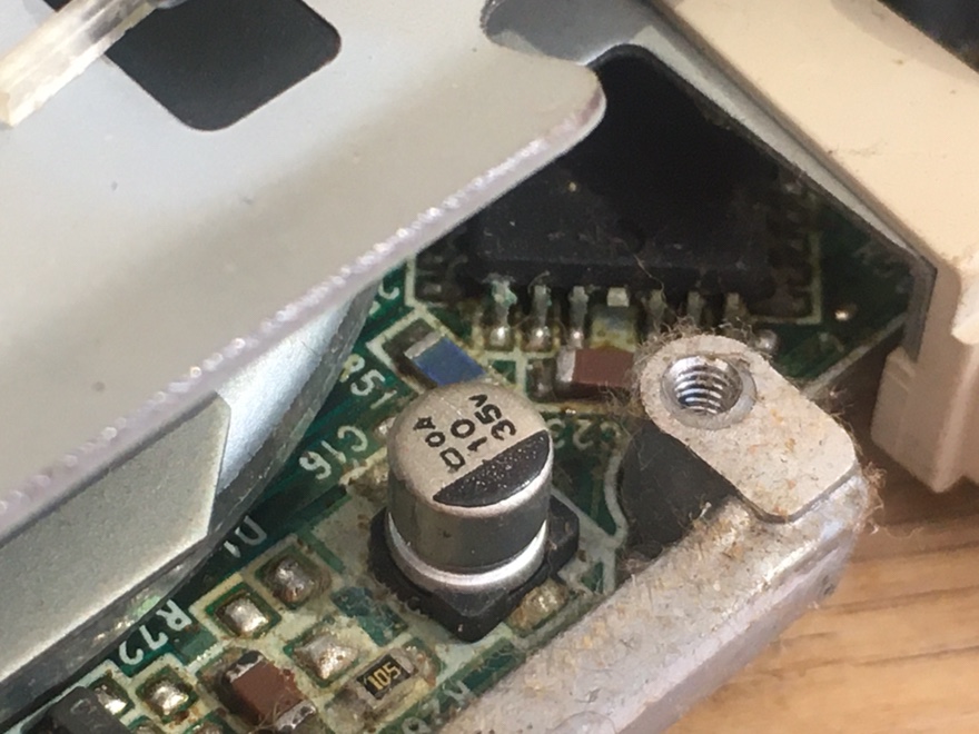

    Want to repair some broken floppy disk drives. I need help to identify the brand of this capacitor to find a suitable replacement.
    Did someone know the brand of the capacitor or a suitable replacement in terms of esr / ripple?

    it's 35v rated, but it cant be seeing more than 12.
    i personally would use a 25v tantalum cap.
    no point trying to fit another smd electrolytic - they are all junk and unless you have hot-tweezers you will probably damage the replacement anyway.

      It´s not a thing how to replace the cap, I have all these nice tools and know how to use them. I am just searching a cap with same spec in terms of esr and ripple. I knew that the one on the picture has 10uf and is 35v rated, but can´t see any other spec.
      Don´t want to solder mlcc or tantalum cap.

        well it looks like a nippon-chemicon symbol on it.

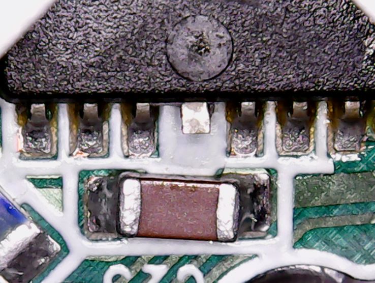

          It looks like there`s some corrosion as well on the IC above that cap .

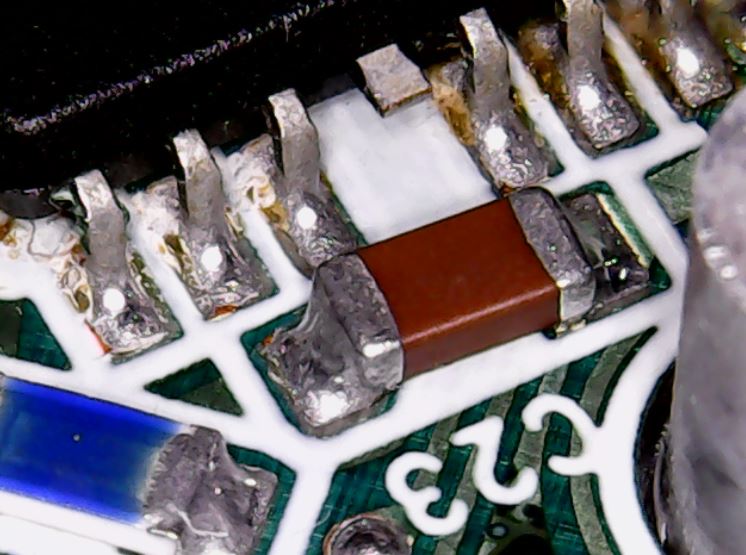

            actually it looks like the ceramic cap infront of the chip has been broken away from the board on one end.
              thank you very much.
              there is some dirt and corrosion, but nothing thats not fixable. but the mlcc is fine as you can see after cleaning the area a bit.

                It may be an ordinary surface mount electrolytic cap rather than a polymer. If so, a good quality 105C general purpose part would probably suffice.

                  Sorry for missing information. It´s a panasonic floppy from 1991.

                    The electrolytic cap is close to the motor H-bridge IC, and likely for local decoupling.
                    Note that the PCB will accomodate a larger cap there, the footprint is larger. The 10uF is likely not critical at all, for ESR.
