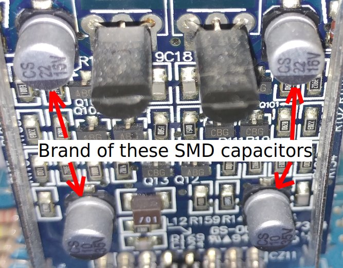

    Trying to identify some SMD capacitors in a NAD audio amplifier. The markings have the value and working voltage and possibly the brand/series:
    CS 22 16V
    CS 10 35V
    (see attached image)
    The best I found for this "CS" item is YTF capacitor.
    Any other thoughts? I have no experience with this YTF brand, if it is correct.
    Thanks,
    Joe
