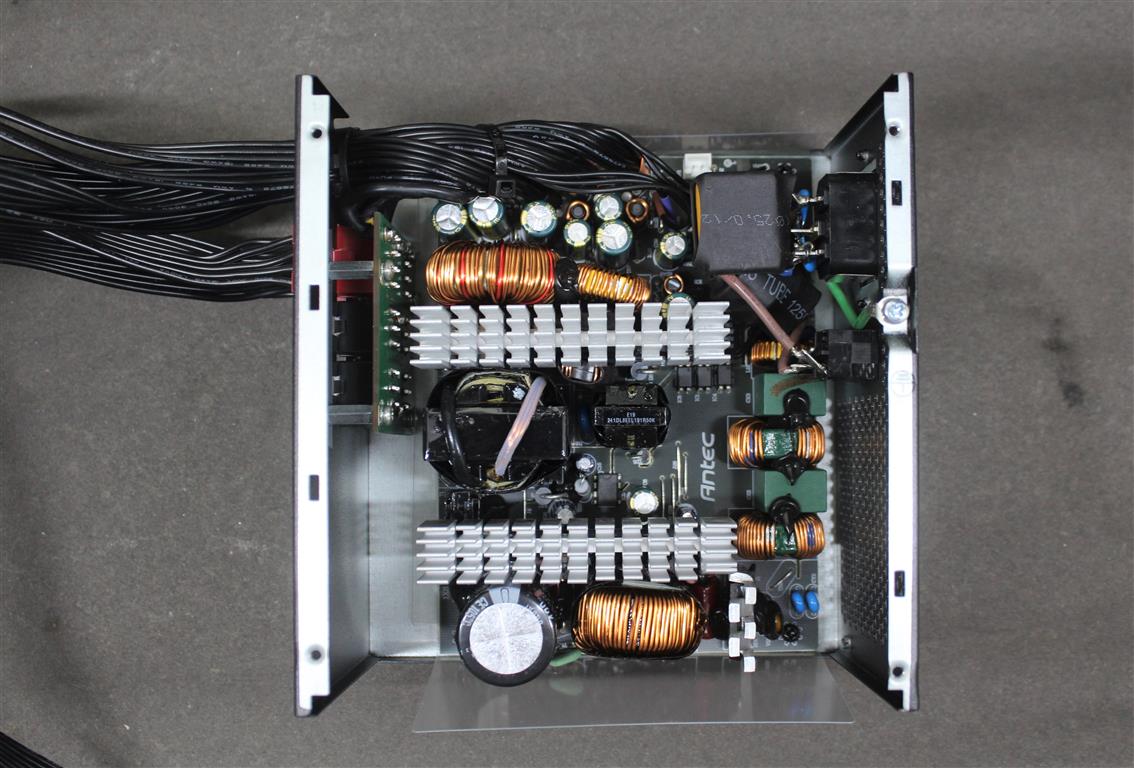

                                        I also had an Antec Truepower "New" up until a couple or so weeks ago in my optical drive tower (an Antec 900 fitted with 8 optical drives and 1 floppy -- used for my media testing... see my posts at myce.com).
                                        This PSU was a classifieds purchase, and it's an all-Japanese cap, early Seasonic DC-DC design from 2011 or so. It developed an odd intermittent condition where my HDD started spinning up and down on power up. It was immediately decomissioned and replaced with an Antec "Neo Eco V2" 650W PSU:
                                        Besides the primary, all Cheapo Teapo SC, save for 1 Teapo SY and two Jun Fu WG.
                                        I liked the price of this PSU though, and I liked that it doesn't use the new fancy DC-DC design. I'm just powering some dumb optical drives with it, not an RTX 3070... And the lack of complexity meant that this thing was extraordinarily easy to preemptively re-cap. The soldering on the bottom was beautiful and the alloy was very good and almost fooled me into thinking it was leaded. I think this is an Delta OEM but I can't be sure. The cap dates were mid-2020.
                                        But at least I won't have odd issues like that overly complex Truepower New... Sure it's all very nice... But one little tin whisker can ruin all the fun. This TruePower goes in my "old, expensive PSUs that need to be scrapped, because they are impossible to diagnose and repair due to their complexity" pile.
