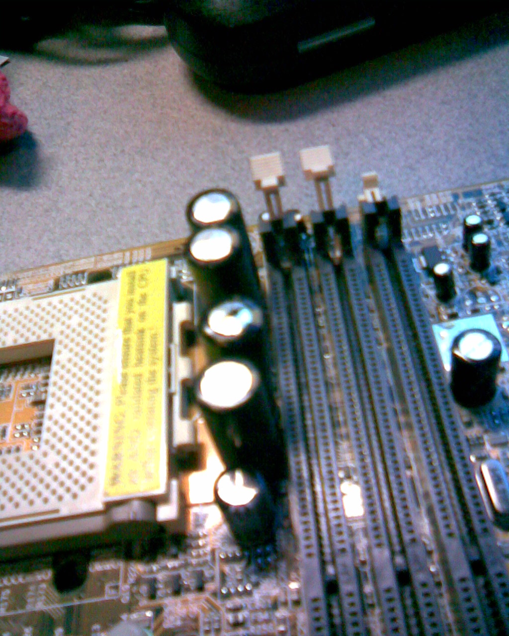

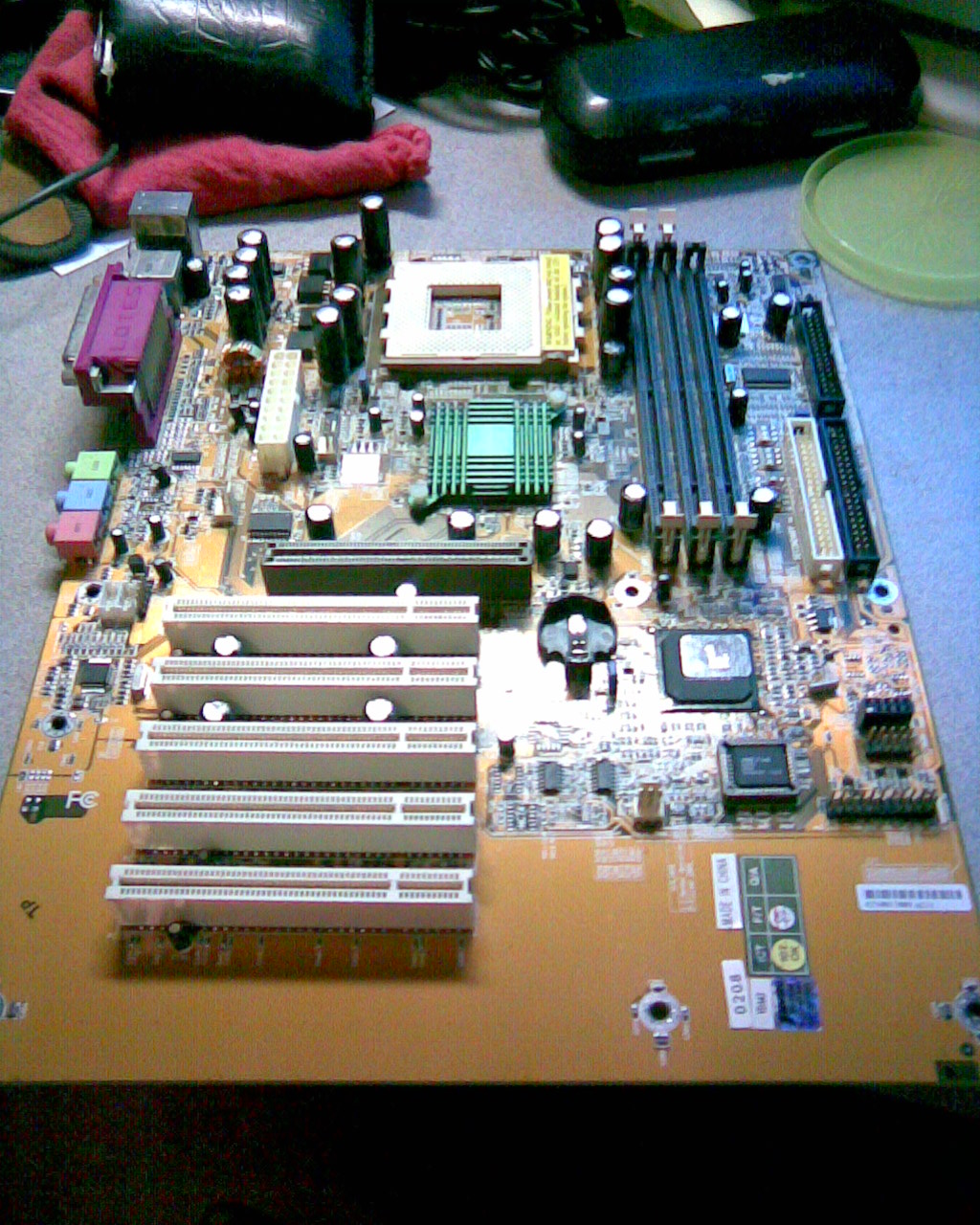

    I got a board here that i wanted to get up and working. It is a 1st mainboard brand or something like that.. model AZ11.. I know that it has some bad caps... 11 to be exact.. all from a brand on the list of bad manufacturers.. choyo brand if you need to know.. all are 2200uf 10v caps.. and all are getting bloated just like i feel after thanksgiving dinner.. 2 are even leaking.. The PC has froze up a few times after being on a bit.. I know bad caps can do that and was looking into replacing them..
    My question is, I ran Everest on it (newer version of aida32) and when i started watching the voltage from the power supply, it was saying that the +12v rail was running at 15.29v I have seen computers that ran the 12v rail at around 13v with no problems, but could the bad caps on the board be causing the 15v reading or is it more like a bad sensor or power supply? almost all the readings are a little high on the utility, but the 12v one is the worst.. 2.5v is 3.04, 3.3v is 3.17, 5v is 6.31 and 12v is reading 15.29. the readings do very little fluctuating like when a power supply goes bad and the PC does not reboot, just freezes and only freezes after being on a bit. also, you can not check the power through the bios.. no setting to check in there for power, only fans.. that is why i checked with everest.
    I hate to give up on the PC. it is a decent little PC.. 1 gig processor, 1.5 gigs of ram, 2 roms (1 burner and 1 DVD rom), sound blaster 5.1 sound card, d-link 530tx+ network and a g-force 5200 vid card. power supply is a 300 watt.
    I am going to replace the caps, but have never seen a power supply with such high readings and was wondering if anyone else has run into that too?
    thanks

    the bad caps can give false readings. replace ALL bad brand caps on it!
    what brand (seriesif applicable) power supply are you using?
    some brands are gutless and not even safe...

        1st mainboard is aka FIC.
        Usually good boards after a recap.

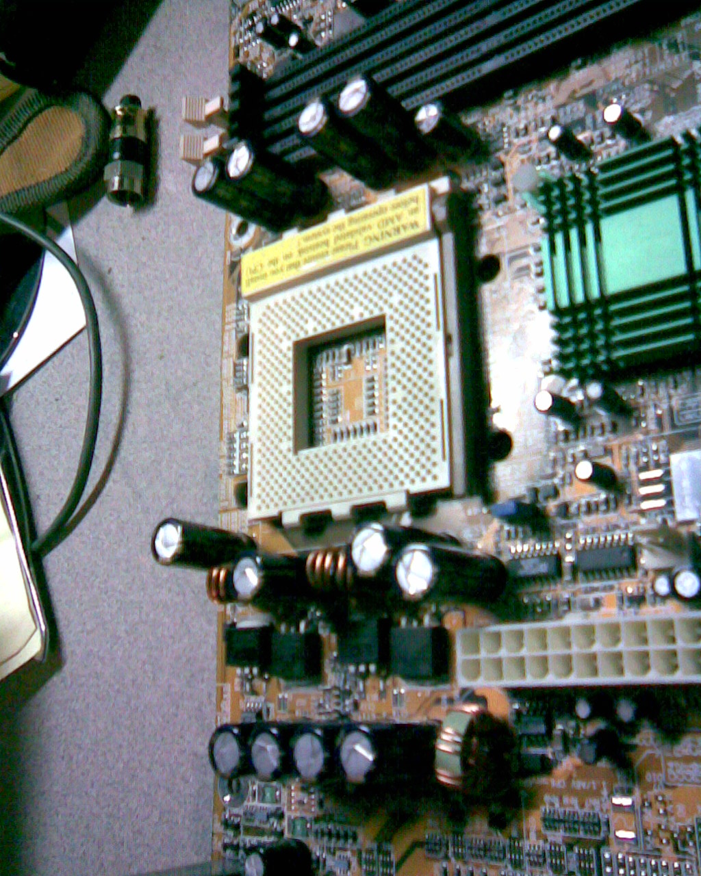

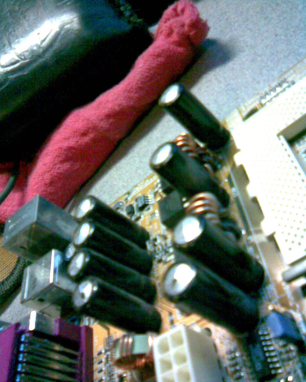

                        well. i guess you dont need to answer that now.. i got some caps ordered.. they are Rubycon MBZ 2200uF 10v 10mm. and are coming from about 2 hour drive from my house.. I ordered 20 of them.. cant hurt to have a few extras just in case.. thanks for the help all.. now lets just hope there are no other problems..
                        • kaniki
                          • 514
                          Re: bad caps or power supply?

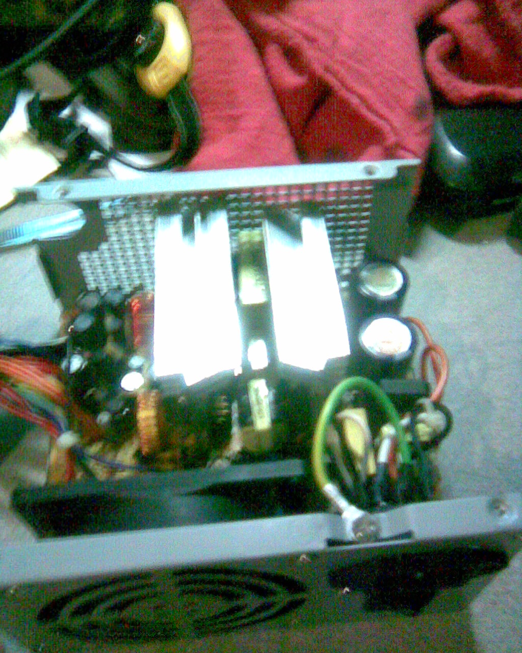

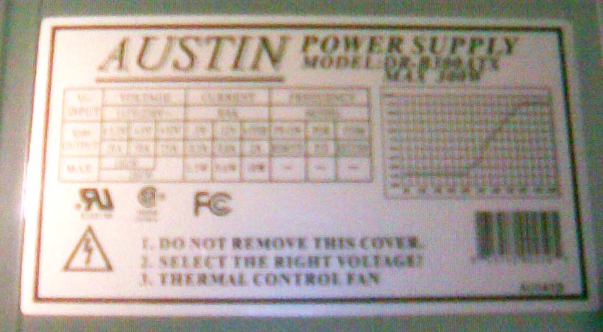

                          well.. I got the new caps in.. I got Rubycon MBZ 2200 Uf 10v caps.. and for some reason.. things work.. have not left it run long enough yet to make sure that it will not freeze up still, but so far.. signs are good.. So far, it has been loaded and rebooted 3 times and then run about 20 minutes.. not being used but on and so far no freezing. I found one thing out though.. thought that there was only 11 of the Choyo 22oouf caps.. i was wrong.. there was 12.. one did not look bad, but still replaced it.. thought that there was only 11 because the one row of 4, 3 were something like 3 mm from being flat on the board and since i knew that the 3 high ones were 2200's, i thought that the other one was not.. found out after i took the board out that i was wrong. also found that that 4th that was in all the way in that row was the only that looked fine.. Hmm.. 1 out of 12 isnt bad, is it???
                          I was asked about what power supply i had.. it is an "Austin dr-b300atx" 300 watt power supply.. according to everest, it still shows 15.29 on the +12v and 6.31v on the +5v... so pretty much no change there. in fast, they all still show the same. Not sure if it is a bad sensor, reading, or power supply.. check it later..
                          PS.. for the record, who eve was the one that designed this board was an idiot... they put one of those 2200 caps about 1/8" or like 2 or 3 mm away from where the heat sink is for the processor.. not to meantion that one of the soldered leads for one of those cps i replaced had something like 1mm spaceing between that and another soldered connecion.. not sure what it is but it is a circuit that sits flat of the board, is something like 2 mm wide, 2 mm high and 2 or 3 mm long.. little tiny thing.. and not fun soldering with 1 mm of space to spare..
                            That would be a Deer/Allied PSU (at least according to the model number).
                            Some of their units are ok, some aren't that great. They usually do okay in low-power systems such as PII/PIII and low-end P4. They do employ crappy caps, though, so it's probably not a bad idea to open it and check for bad caps (warning: PSU contains high voltages - turn it off before removing the lid and do not touch the heatsink near the two big primary caps). Post pictures if you can too. Some Deer/Allied PSUs are not worth recaping.
                            If all the caps look ok, at least see what brand and series they are and post them here. Some brands such as Rulycon (not to be confused with Rubycon, a top-grade capacitor) are total crap and should be replaced on sight.
                            You definitely don't want to leave bad caps in the PSU as that will overwork the new caps you installed on the motherboard, which may in turn shorten their life.
                            Congrats on fixing the board by the way .

                              the power supply has 2 big caps that are 470 uf 200v and are not sure about brand, but they have the symbol of like a planet with a ring around it and a Y in the middle, the others are koshin and luxon brand.. never heard of any of them before.. here is a couple pics i took.. sorry the pics are not that good... came from camera on my cell..

                                      Austin is rebranded deer. May be worth a recap, would have to see pics of the internals. Austin are generally the low-end of deer units.
