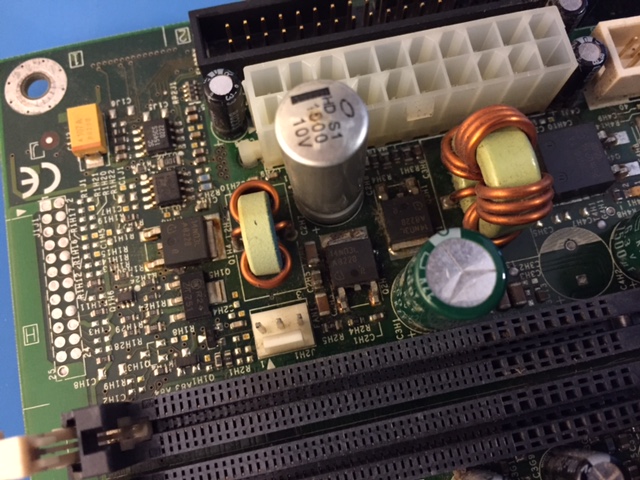

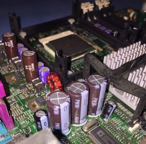

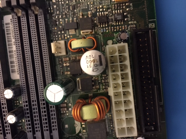

    Hello all. First post on this forum. Am resurrecting an Alienware tower I acquired at an estate sale. This is the first time changing out caps, and need some guidance.
    The mobo is an Intel D850MV/D850EMV2 with a few bulging caps. A couple are 3300uF/6.3v KZG series, which I plan to swap for Panasonic EEU-FM0J332.
    However, this silver one is a mystery. The logo sort of matches an old G-Luxon, but I can't find the series anywhere. Was thinking about swapping for EEU-FM1A152L, which has similar ESR/Ripple specs as the KZG replacement above. Thoughts?
    Also, if some of the caps are bulging, should I be replacing all of the other caps even though they look ok?

    silver one is HD series, cant remember the make but i'v seen them in playstation2's a lot.
    • lti
      • May 2011
      • 2555
      Re: First Timer - Mystery capacitor identification
      They're made by Nichicon, and you can probably get an exact replacement.

              Never mind on the Nichicon HD series. I found this:
              Alternatively, was thinking of replacing it with this Panasonic instead: https://www.mouser.com/ProductDetail/667-EEU-FM1A152L
              However, this one has a higher ripple current spec than the Nichicon. Is it ok to replace cap with one that has a higher ripple?
              Still have question about replacing all caps or just bad ones.
                higher ripple rating is better so no issue.
                anyway, the problem is that u have picked caps that wont fit because of inappropriate dimensions. the panasonic fm EEU-FM0J332 cap u picked wont fit because its 12.5x20mm in size. the original kzg 3300uF 6.3v cap is 10x25mm in size. it wont fit because the cpu vrm area or the chipset vrm area has the caps pushed close together side by side so the caps must be the correct size to fit in there. use panasonic fr series EEUFR0J332L as the correct sized replacement.
                same thing with the EEU-FM1A152L. its a 10x25mm cap and the nichicon hd 1000uF 10v cap is 8x20mm in size. it wont fit because the cap is right up against the main atx connector so it has to be the right size or it wont fit. again, use panasonic fr series EEUFR1A102L as the correct sized replacement.
                lastly, tell us or show photos of what types of caps are on the board if u wanna know if u should replace all caps or just bad ones. all caps with the series kzg, kzj from chemicon are replace on sight; nichicon hm, hn and hz caps with 2002-2004 datecodes are also replace on sight.
                also check the psu in that alienware tower. most likely the psu failed and took out some of the caps on the motherboard.

                  You can use a 6.3v rated polymer capacitor instead..
                  Cap filters 5v or 3.3v from psu.. they probably used 10v rated for better specs or because there was room (same diameter for 6.3v or 10v).
                  took liberty of filtering list: https://www.digikey.com/short/p95twp
                  All 820..1200 uF 6.3v or 10v polymer caps in 8mm diameter, in stock

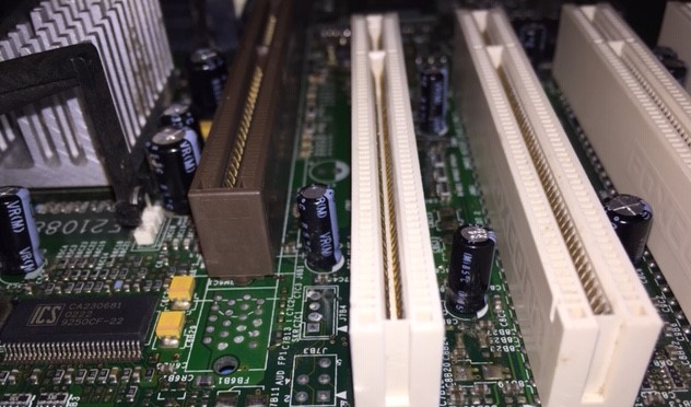

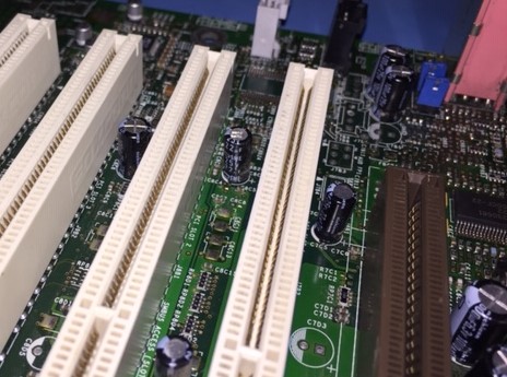

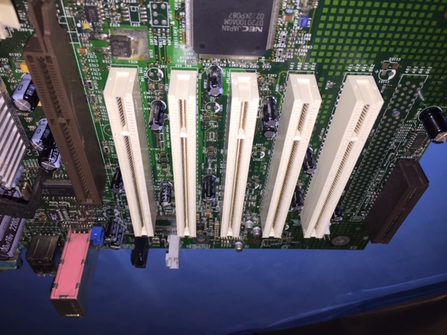

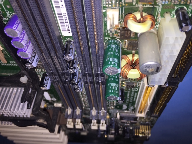

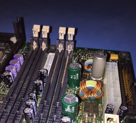

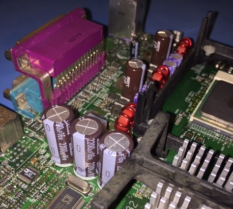

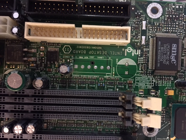

                                Sorry it's taken me a while to get back to this project. Attached are pics of the other caps on the board. They all appear to be Nichicon's except...
                                The previously mentioned KZG's next to the CPU.
                                These KZE's and the previously mentioned HD near mobo power socket.
                                This one Chemicon 25v 22uf SME series in the PCI rails (it's the only SME on the board)
                                Some Nichicon PW's next to the CPU power(?) socket:
                                The rest of the black caps are Nichicon VR's sprinkled around the board that appear to look ok:
                                I'm thinking just the KZG and HD need replaced, and leave the others alone?

                                • Stefan Payne
                                  • 1267
                                  Can you get 12,5mm diametre caps in that position or is it too cramped there?
                                  If so -> 16V/3300uF Pana FM. Those are perfect replacemens for the 6,3V/3300uF
                                  It might be that those are just there because of capacity, so a 6,3V/3300uF Pana FM might be fine as well...
                                  For the big 1500(?)uF/10V (or was it just 1000uF??), I'd use a "shitty" Polymer such as Kemet A750, for example:
