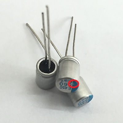

unknown (solid?) caps on MSI "military class" graphics card?

                        Originally posted by CapPun
                        ok thx but so you sure about it? (how did you figure the brand when there's no logo???)
                        btw I've never seen or read about a GPU failing (or an intel CPU for that matter) hope that dont happen :/
                        from 2011 to 2017 I used a GTX 580 these things heat up like crazy like above 80°C in gaming (even in well-cooled giant Cooler Master HAF case with 4 fans including 20mm top fan)
                        plus it was a single-fan with a tiny fan, brand was EVGA but the card looked like a basic generic card yet it worked without a problem for all those years till I finally sold it after upgrade
                        here for the MSI 1070 Aero (ITX version) reviews show temps go up to the mid-70's in Furmark tops & they say those are good temps for a 1070
                        In nippon chemicon they are easy to identify, when there is no logo, what nippon chemicon does instead is that in the blue strip they leave an unpainted line. This feature only has nippon chemicon in solid caps without logo.
                        with this photo I will solve your doubts.
                        MSI always mounts genuine nippon chemicon, so do not worry, they are 100% original nippon chemicon.
