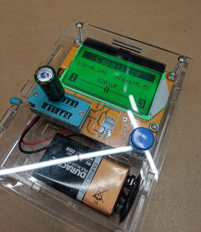

    I have a swollen Sanyo WG 2200uf cap removed from the board and reading 8000uf with an LCR meter and a DMM. I always thought bad caps capacitance goes way down when swollen or leaking.

        Re: Bad cap reading 4x high?
        Originally posted by budm
        What resistance do you get when tested it in Ohm mode? What ESR do you get when tested with ESR meter?
        Starts around 1k ohms then climbs and climbs then, in a split second, goes up to 30k.
          I've seen some LCR meters report incorrect numbers on leaky capacitors. The number is wrong.
            First off the ESR 0.24 ohms is a give away any way
            It should be .02 anyway and the UF reading is way off to

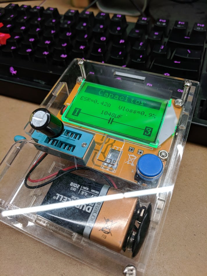

              I'm not too sure about the ESR accuracy on that cheap test kit. I have thrown brand new low esr caps in there and it's shown way too high esr as well.
                  Originally posted by jayjr1105
                  IBrand new 1000uf Panasonic FM
                  Electrolytic caps are usually +/- 20% of their uF rating. So a 1000uF cap reading 1048uF is okay.
                  The ESR might be a bit high depending on which exact 1000uF cap you have. Check it against

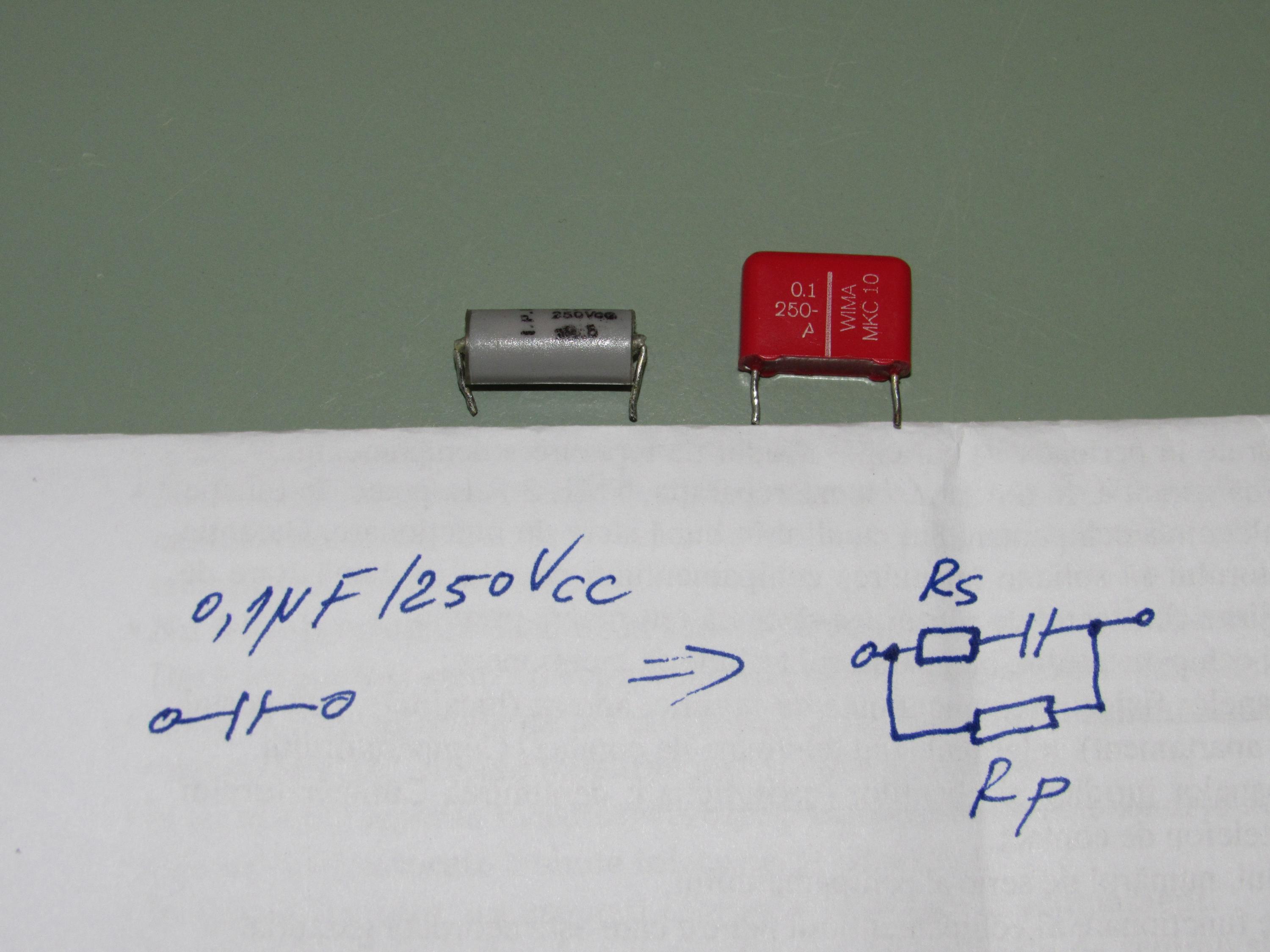

                    I just ordered a .1uf cap to calibrate it. I don't have anything close sadly.
                    https://cdn.badcaps-static.com/pdfs/...404c12c252.pdf
                    I didn't mean the capacitance. I meant the ESR is way too high for a brand new low ESR cap.
                      Yes, smaller ones are usually a bit over that.
                      Bigger ones (=High Voltage) usually are a bit under the specified value.
                      ie for a 470uF capacitor you can assume something around 440uF or something like that...

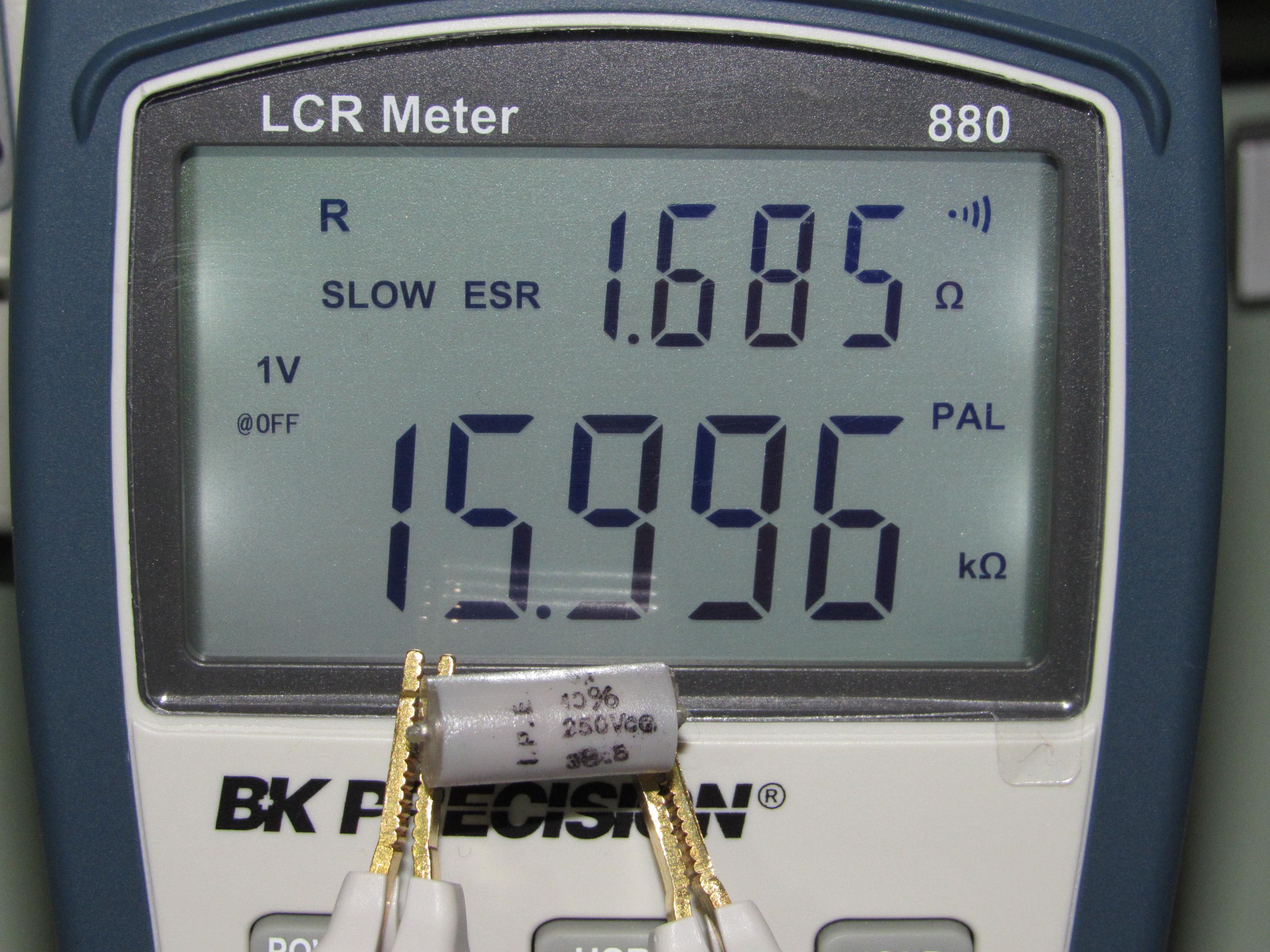

                        i recommend a 0.22uf film cap for calibrating.
                        if a .1uf cap is actually 0.099uf the tester wont like it.
                          It looks like the leakage resistance causes the fault capacitance reading.
                          If you put 100K, 47K resistor in parallel with that Panasonic cap, what will it show on your cap meter?
                            Figures, I knew I should have just ordered a kit like this. http://a.co/3KgqGtE
                            Do you think my ESR readings will improve that much once calibrated? I have tested a ton of low esr caps, never once seeing anything .0X or lower. I thought that LCR tester is just junk.
                            Edit: I can put two .1uf's in parallel can't I?

                              • 31213
                              the parallel method should work.
                              you should read my very long tester thread!!

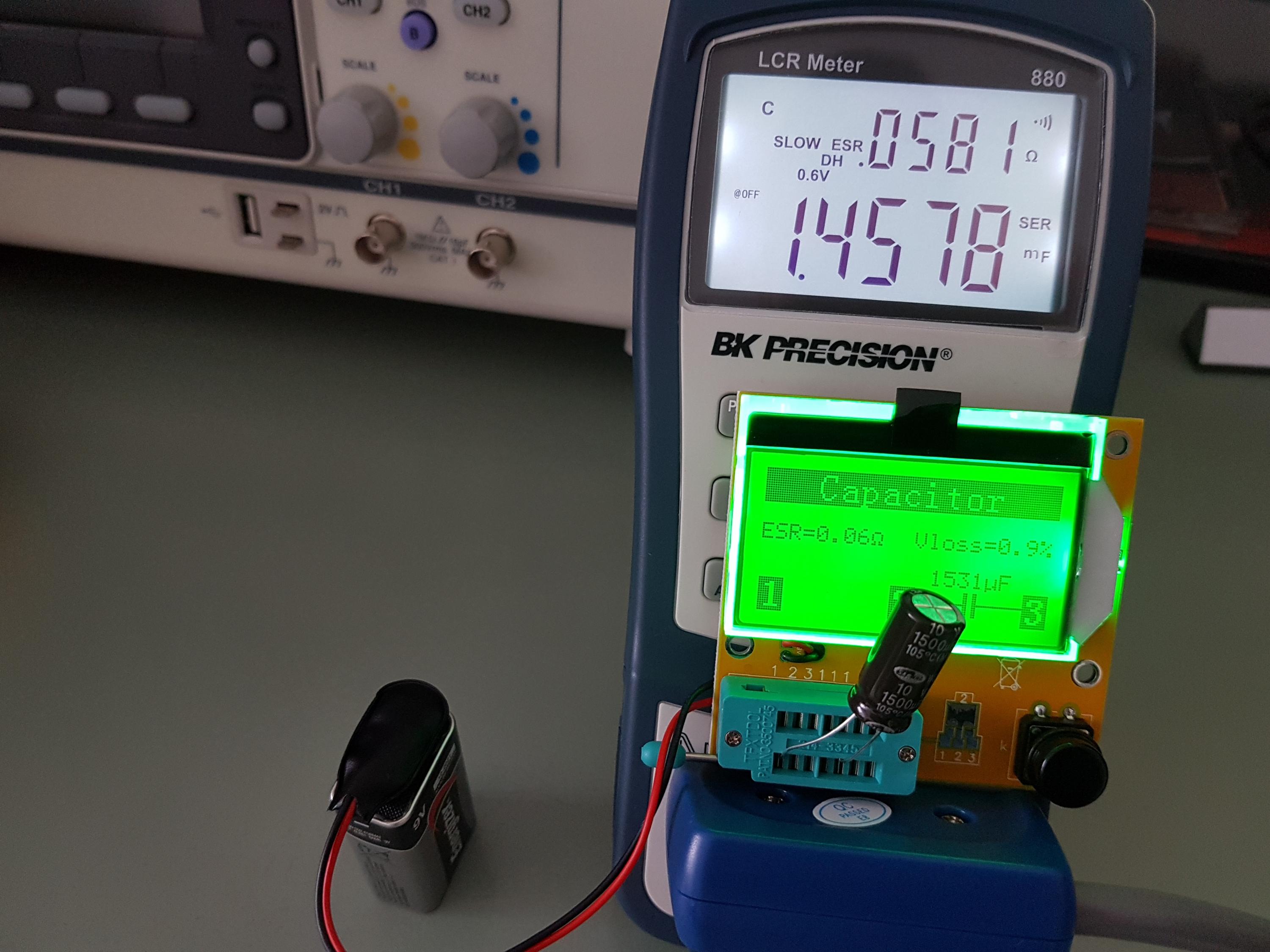

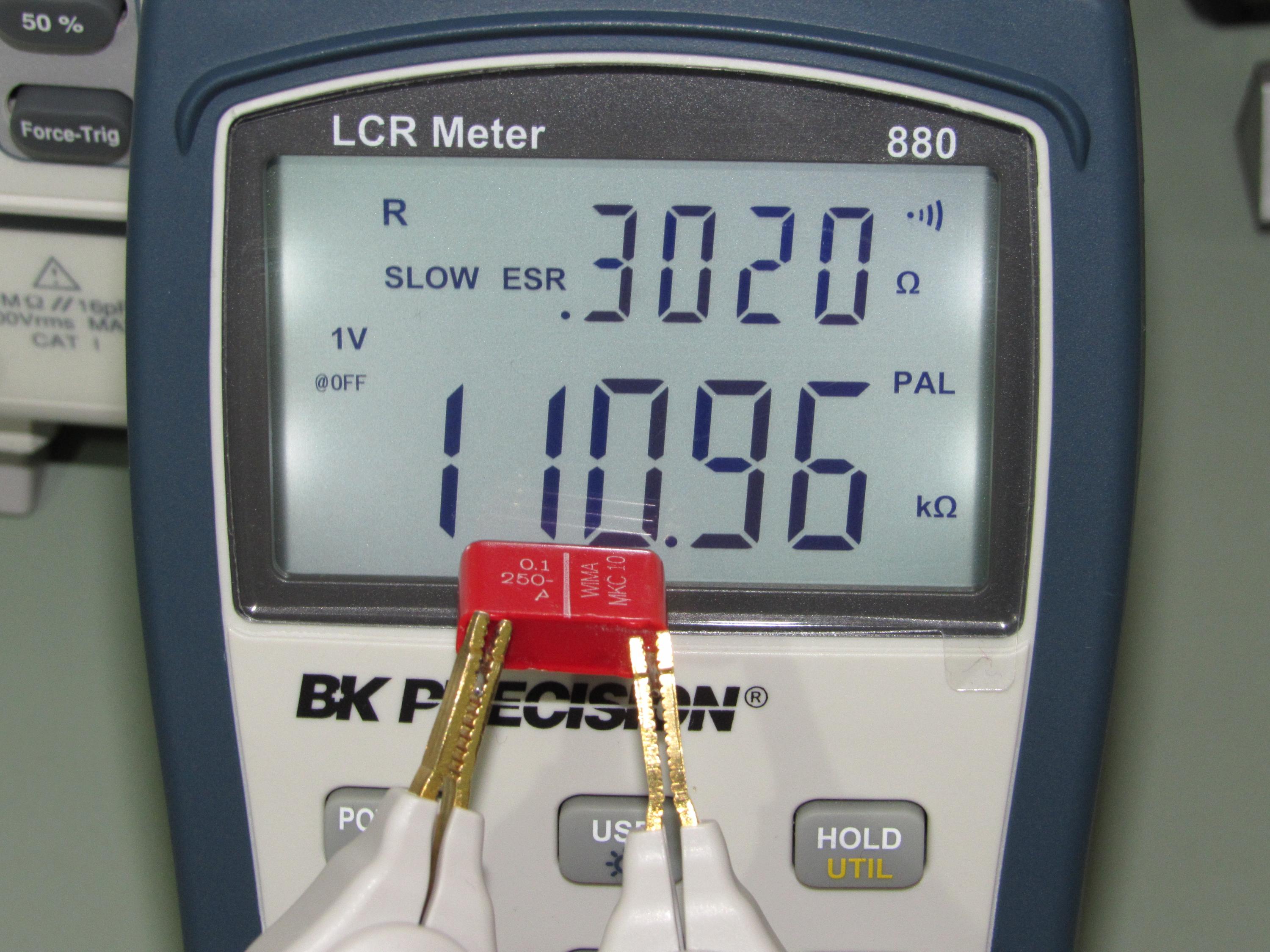

                                they are very accurate if they are calibrated.
                                LCR-T4 versus BK 880
                                https://streamable.com/acx9m
                                The art of fighting without fighting
                                • victor_cj
                                  • May 2015

                                    • jayjr1105
                                      • 281
                                      I have never from day 1 of owning the LCR-T4 seen a cap ESR that low. Even with brand new caps. I wonder if there's firmware or something to update. I still have some caps coming tomorrow for calibration.

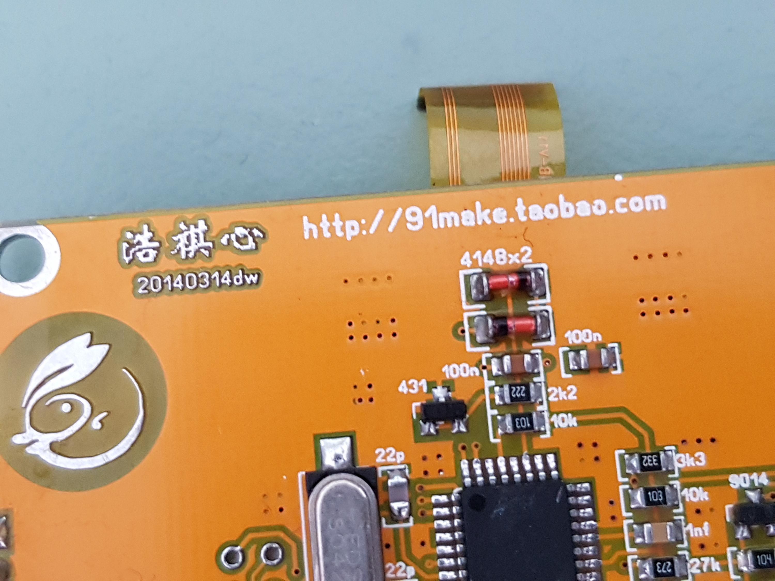

                                        >0.1uF capacitor for calibration is the reference, Rp and Rs may make a difference.
                                        On the LCR-T4 PCB, 431(TL431) is the reference for ATMEGA328P-AU.
