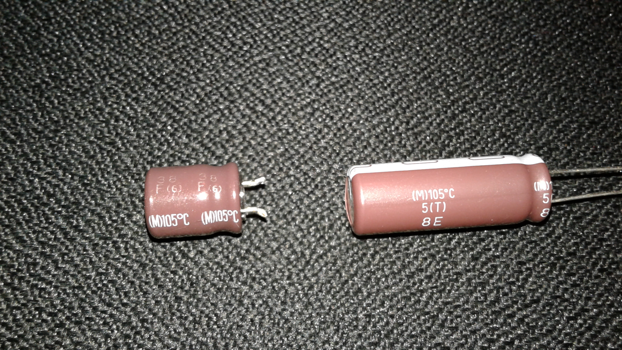

    Hello, i'm making this thread about some NCC KME capacitors i salvaged recently.
    Here's the first photo of one of the capacitor....
    notice how the datecode on the one to the left is in gold print but the temperature and tolerance label looks a bit bigger then the one on the right. [The one on the right is a NCC KYB capacitor.]

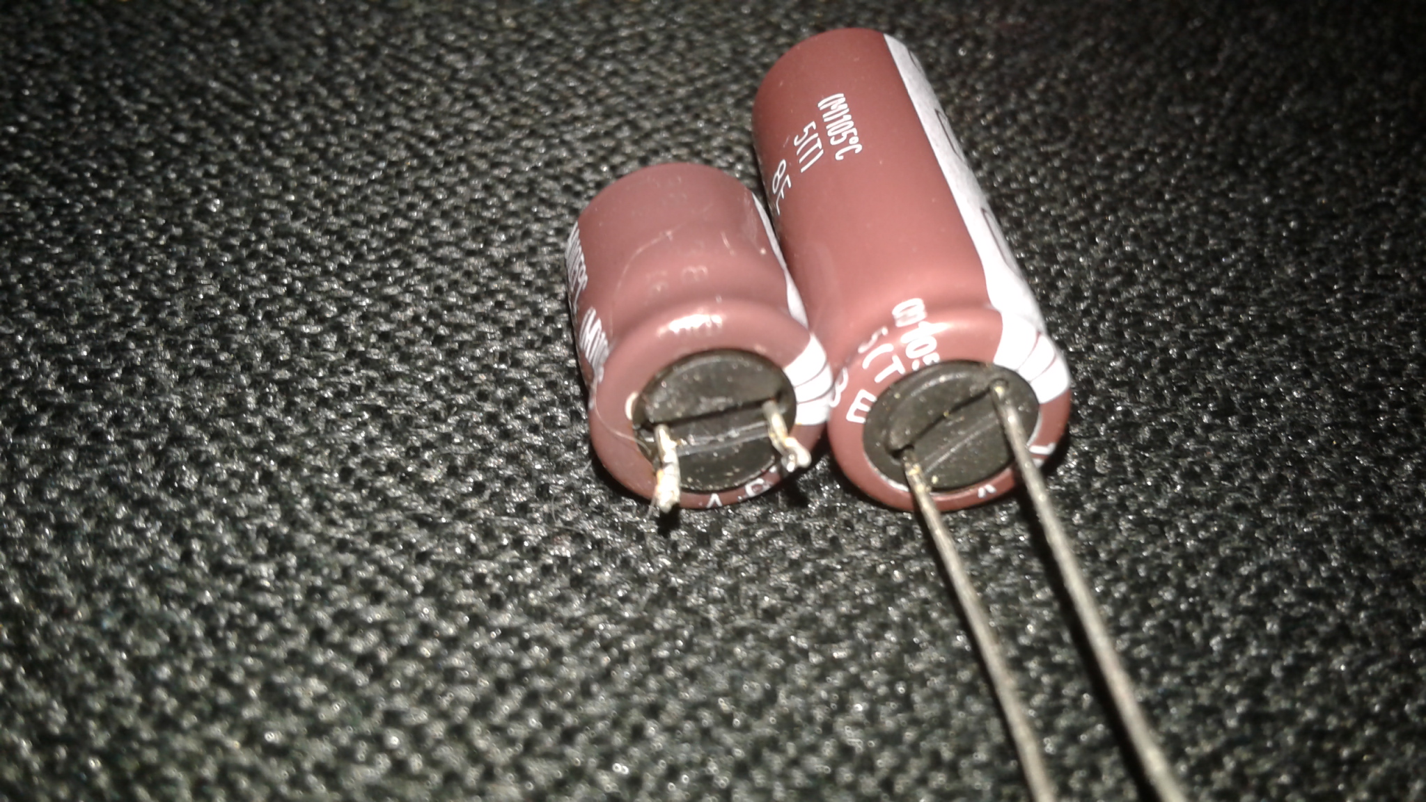

    I'ts a bit hard to tell, but the one to the left [NCC KME] has a cheaper looking rubber plug then the one to the right [NCC KYB].

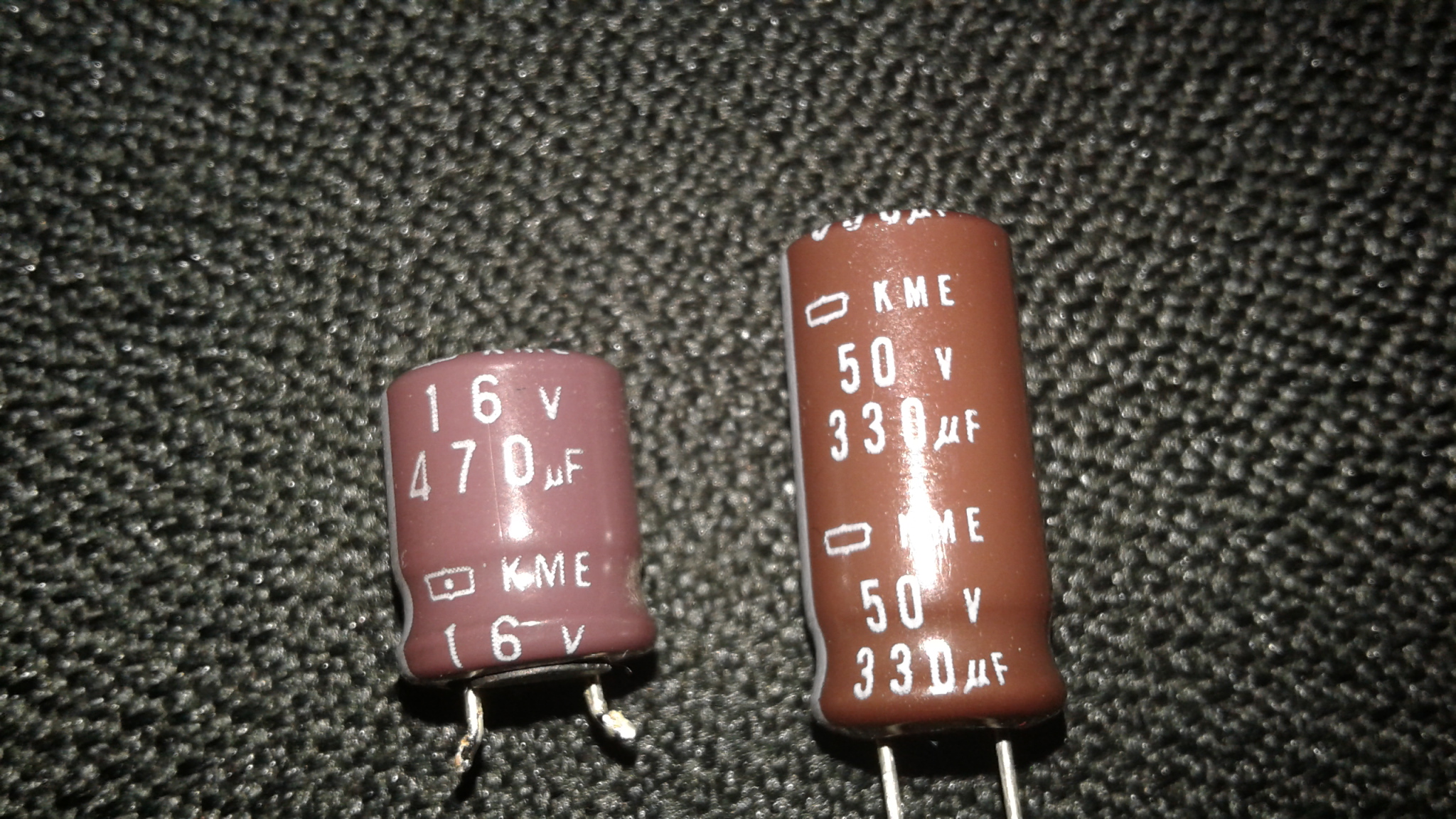

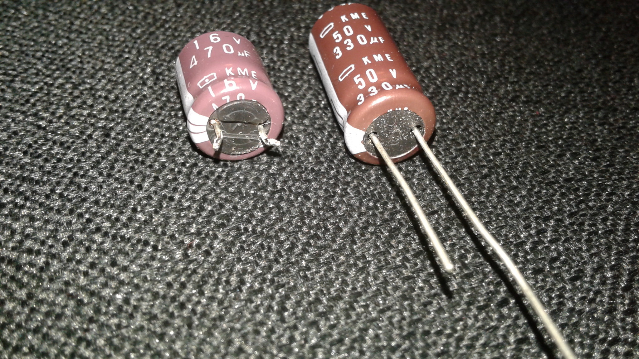

    To the left is the [possibly fake] KME cap next to a KME capacitor i got from a surplus store. [which i'm pretty sure is real.] Notice how the color of the one to the left is lighter then the one to the right and the font is different.

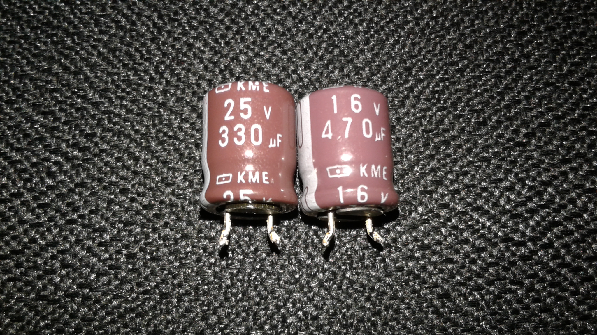

    Here it is next to another [possibly fake] one.
    Do you think it could be fake? I'd love to know.

    Not counterfeit, but probably rather old with that August 6th? 2003 or 1993 datecode? The dot in the crown, or logo, denotes Korea Chemi-con (their Korean subsidiary), or Samyoung.

      Okay, i was just a bit suspicious because i thought it was fake because of the gold print and lighter brown heatshrink. I guess now i know for the future.
