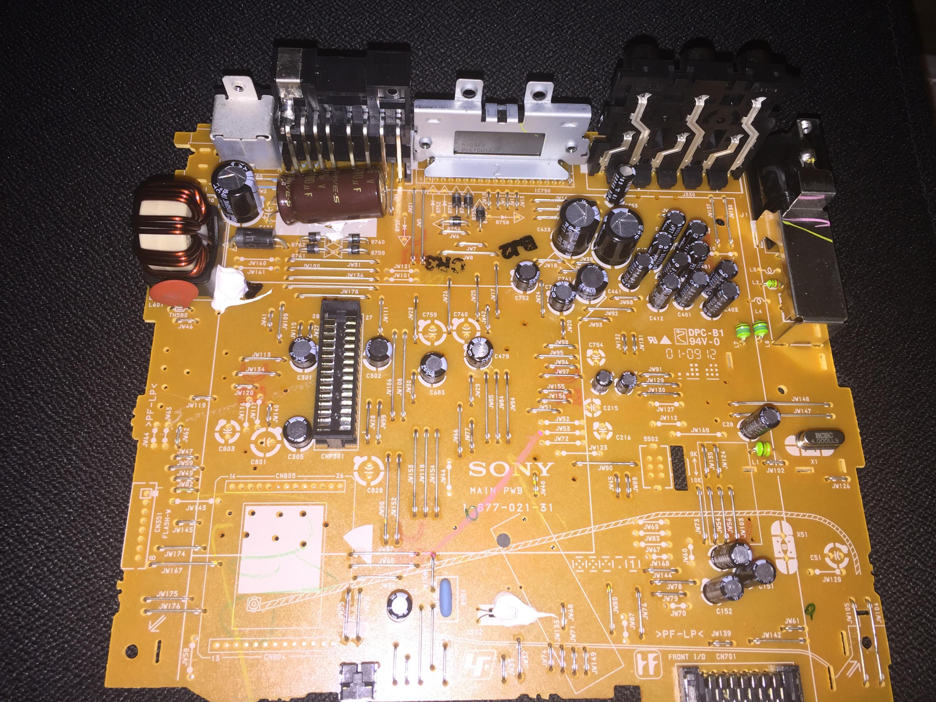

    hello
    i opened up a broken sony car radio which i'm going to be using for parts and i'm wondering what caps i should salvage from it
    now i am going to save the rubycon and nichicon caps from it but there are 2 other brands that i need to know if they are good or not

    Re: weird caps from a broken car radio
    forgot to fix some typos and i did some edits aswell
    hello
    picture of the board
    brands

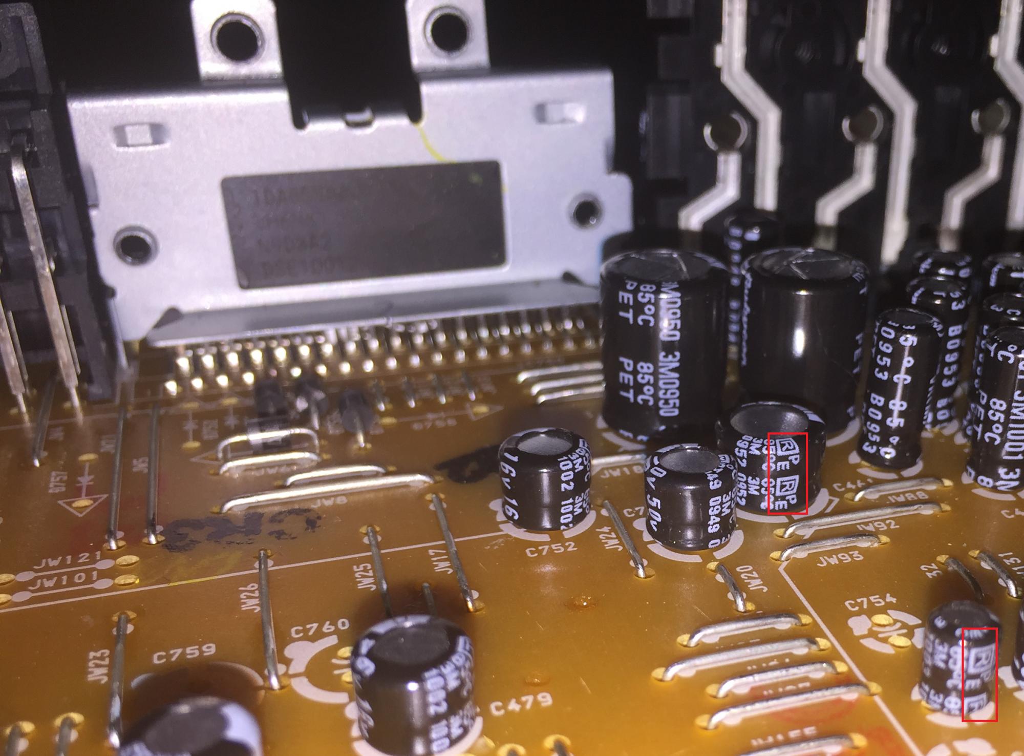

    Rpe [the R is in a box kanda like the M on the panny caps and i've seen them in some DVD players and VCR's]

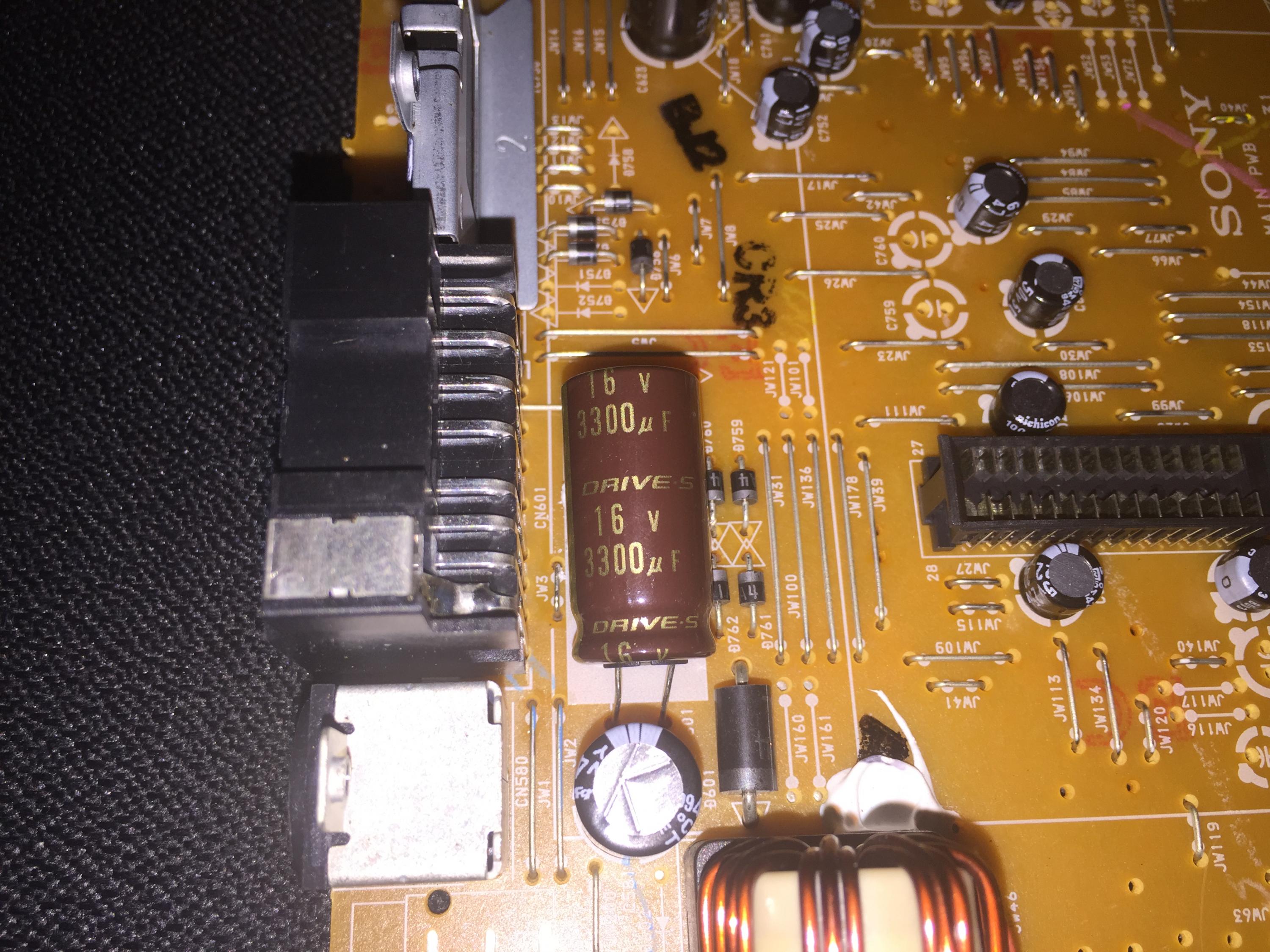

    DRIVE.S [looks a lot like a UCC cap. it has a brown heatshrink with gold colored text and neg stripe seen here]
    I'm not a expert, I'm just doing my best.
      It's possible that that's some custom sleeve for Sony.
      If you order enough caps, you can ask the cap manufacturer to do some custom sleeves, as does in some lower end Super Flower designs with reddish/brownish Teapo sleeved caps or CapXon GF....
          ^This, I would suspect it is a Chemi-Con based on the vent, sleeve color, and the fact that I've seen custom sleeved Chemi-Cons in Sony receivers before (and I've seen custom sleeved Panasonics in Kenwood receivers/amps, custom sleeving appears to be fairly common for audio caps).
            I wonder if it's one certified for automotive use, considering the name.

              ok so the DRIVE.S cap could be a NCC/UCC cap
              but i still don't know if the Rpe caps are good or if they are a bad brand
              i've seen the Rpe caps it some DVD players and some VCR's tho i've never seen a dead one nor have i seen one over 220uf
              they could be a cheap chinese cap
              tho i've never seen chinese caps in any sony product i've mostly see brands like rubycon UCC and nichicon [and in older sony product's i've seen some elna caps]

                here is a Rpe cap
                  R = Tiny Rubycon. See here. That tiny 85ºC cap was made in Indonesia, during the 52nd week of 2009 (December 2009). Newer Sony products are known to have Lelon in them, in "less" critical areas. The font on that "DRIVE.S" capacitor, beneath the logo, matches that of a Chemi-con.
                    Yep, genuine Rubycon caps have an R in a square as the logo on the really small caps, where Rubycon wouldn't fit.
                      so the Rpe caps are rubycon ok cool
                      now i'm more likely to save them
                      and i did not know sony now uses Lelon cap sometime in less critical areas
