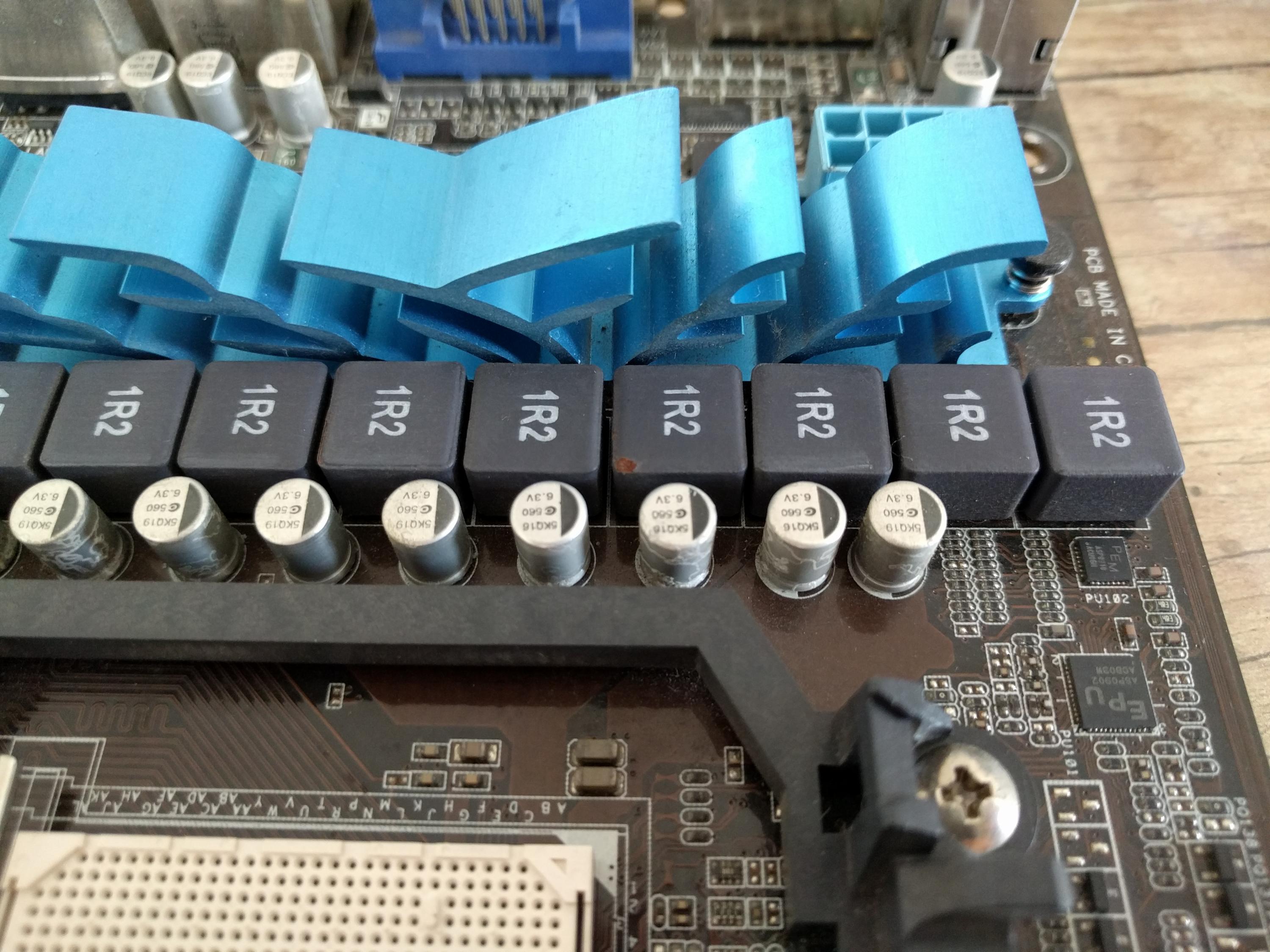

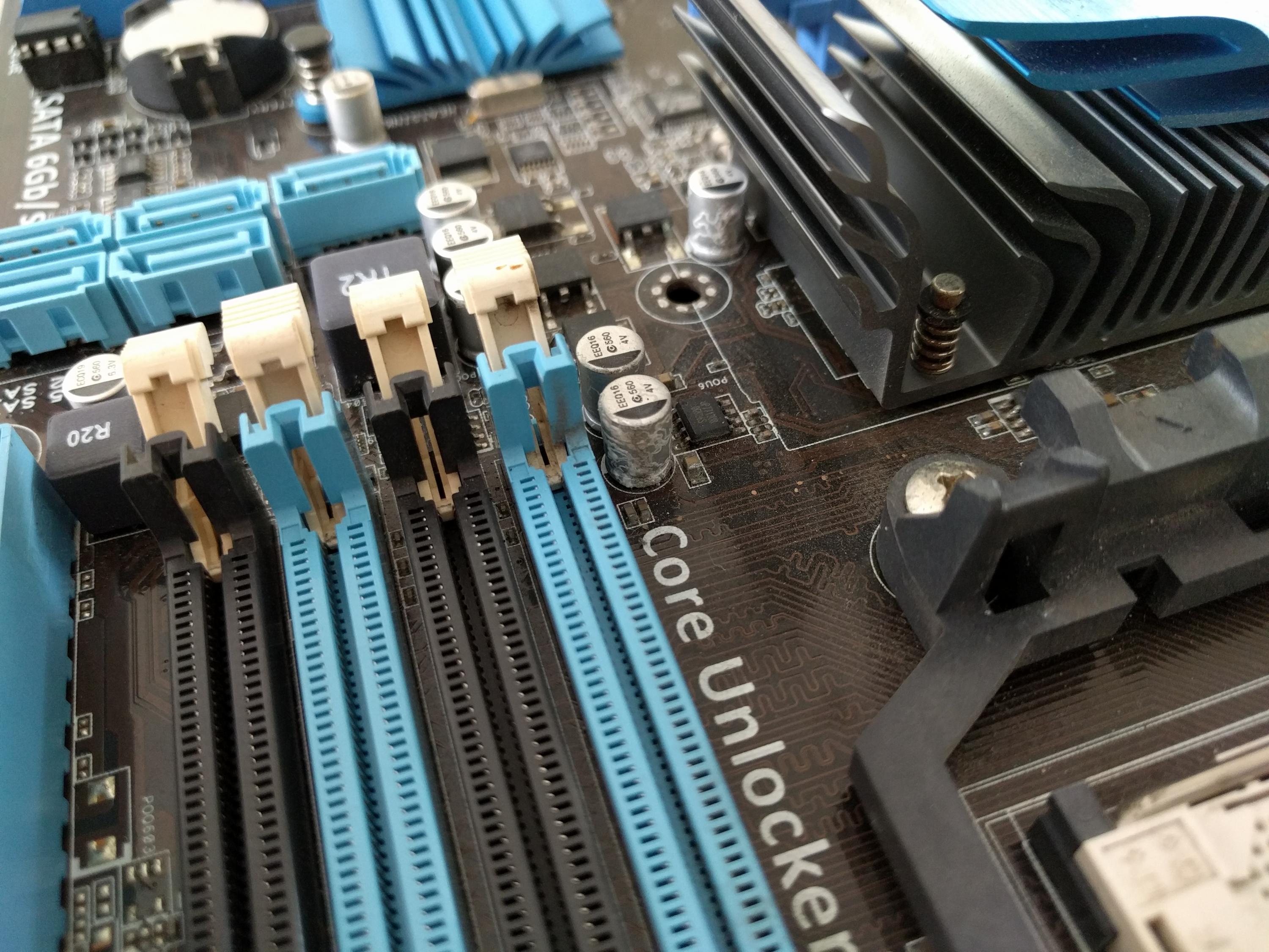

    Could I get a hand on identifying those caps? This is a 5 year old M4A88TD-V Asus motherboard. Even though the board IS working and I can work on this PC, its PCI-e lanes are busted and no external VGA works in it.
    The PSU is a pretty decent Antec with 80 plus. Anyways, here's some pics on the caps. All of them exhibit this strange pattern on their sides, some more, some less. Also, I seem to get some corrosion on a ferrite resistor near the CPU socket.

    a DECENT Antec is 50/50 - what model is it?
    some have poor soldering or crappy caps.
    the side of the caps may be aluminium oxidisation, and the inductor has surface rust.
    neither should cause a problem.
    so what's the history of this board, where did the moisture come from??

                Re: Identify bad caps and ferrite resistor
                you need to check inside the psu,
                the caps on the motherboard are solid polymer, there is nothing to leak out.

                    looking at the motherboard again, if it was mine i would strip & wash it.
                    you dont know what corrosion may be hiding under the heatsinks or between chip pins.

                      I think you have bigger problems than the capacitors. Probably there is corrosion elsewhere, in critical areas. The PCI-E slot itself may be corroded inside or underneath.
                      The white stuff on the last capacitor photo might be some kind of reaction between the corrosion and the capacitor innards. Or just the capacitor body. Scrape it off and see if you find any holes underneath?
                      I agree with stj though, it needs a good bath, for starters. But I am not sure that it will help.

                          remove battery, cpu and all heatsinks & frames etc,
                          then throw it in the sink with boiling water & dish washing liquid and clean it with a paintbrush.
                          that's my method.
                          then rinse it well and shake off as much water as possible - specially out of the cpu socket.
                          then dry it completely - i use a fan heater, but a hair dryer or similar would work.
                          the trick is to dry it in an hour or less - not over several days, that way corrosion cant set in.
