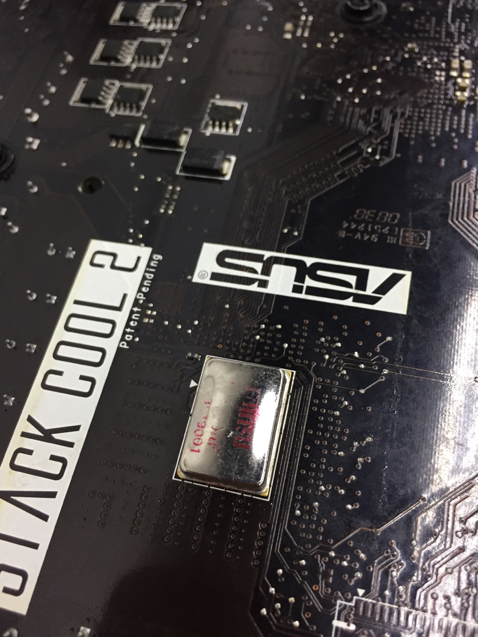

      Asus Extreme Rampage x48 fujitsu 3v-1000uf caps
      Hi, would like to ask if anyone know the silver flat Fujitsu 3v-1000uf cap can be replace? Just bought an used board but found it the cap is damage. Any reference where can i get those if it can be replace. Thank you

          Re: Need Help identifying a capacitor...
          that's new - never seen a low profile cap like that before!!

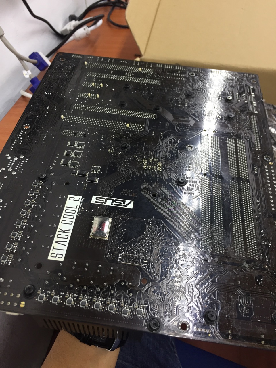

              what's on the other side, is it 2 wires going though or something else?
                Located exectly behind the processor pin.
                  how do you know it's bad?
                    The first photo I attach the cap is puffed-up

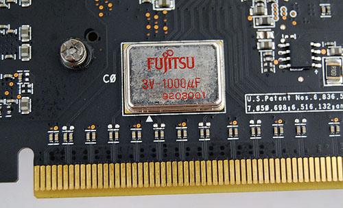

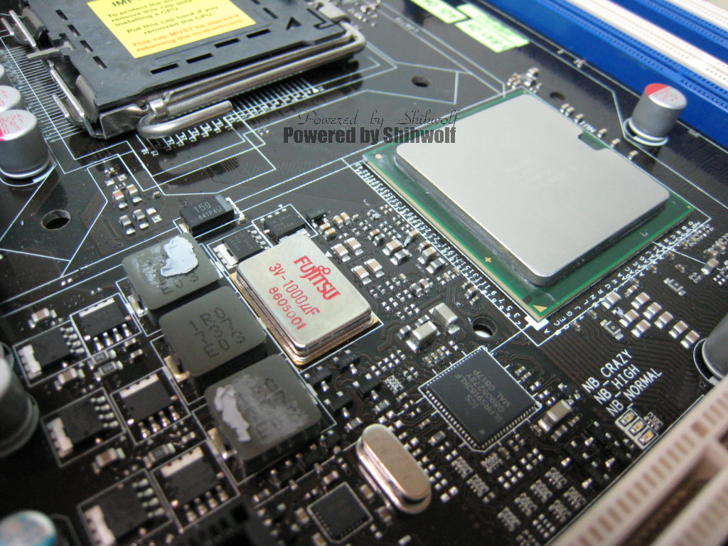

                      Re: Where to find Fujitsu low profile "Super ML" capacitor?
                      I created a new thread for you because it did not belong in the other one.
                      It's a Fujitsu Super ML capacitor.

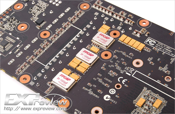

                          They also exist with the branding "FPCAP" but that quickly gets confusing because Fujitsu also has a range of regular polymer caps named that...

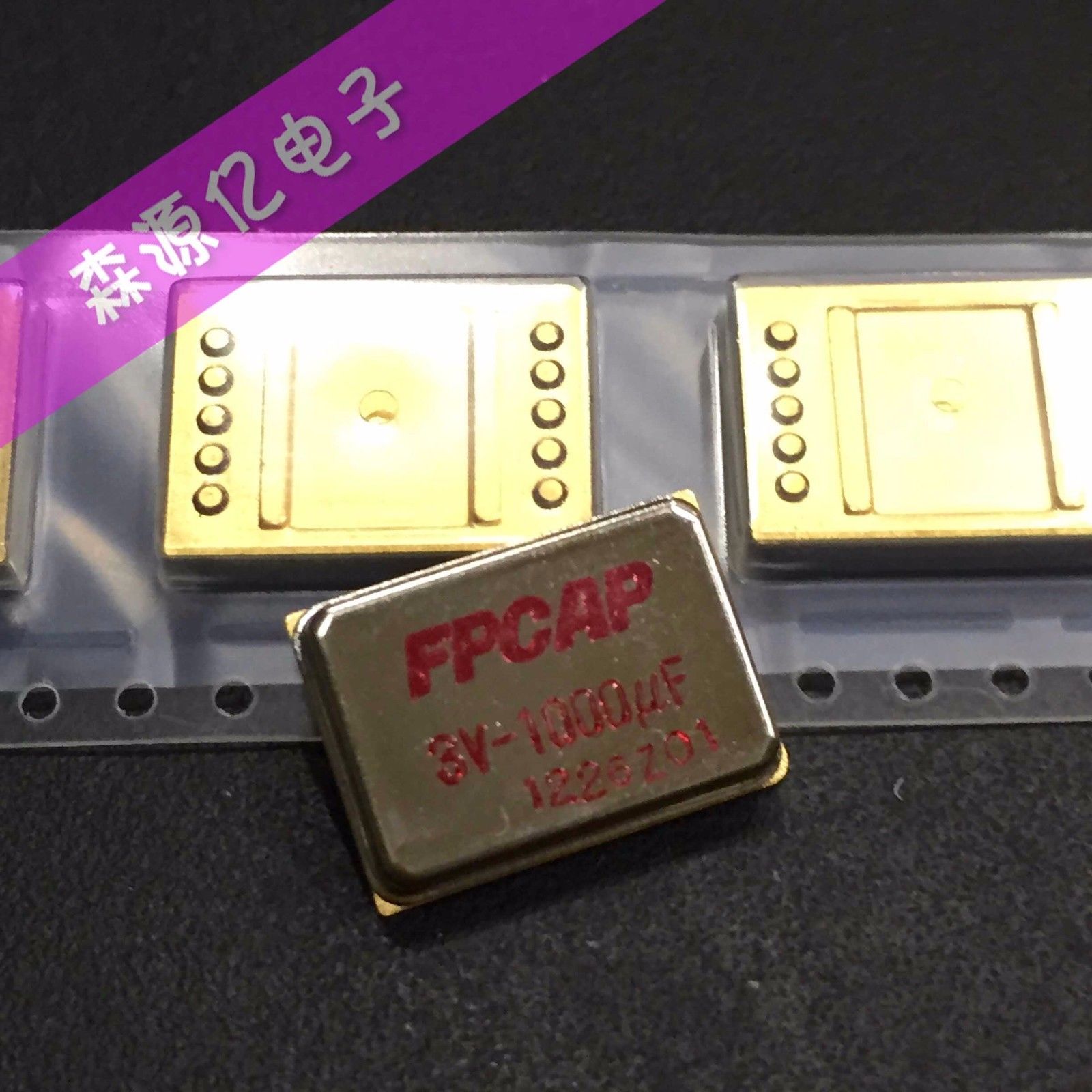

                              I found this http://www.ebay.com/itm/FPCAP-decoup...v#ht_720wt_955
                                  Finally found what Im looking after been searching for so long. Thanks alot R_J Will post up some photo when those cap is lifted off from the board.
