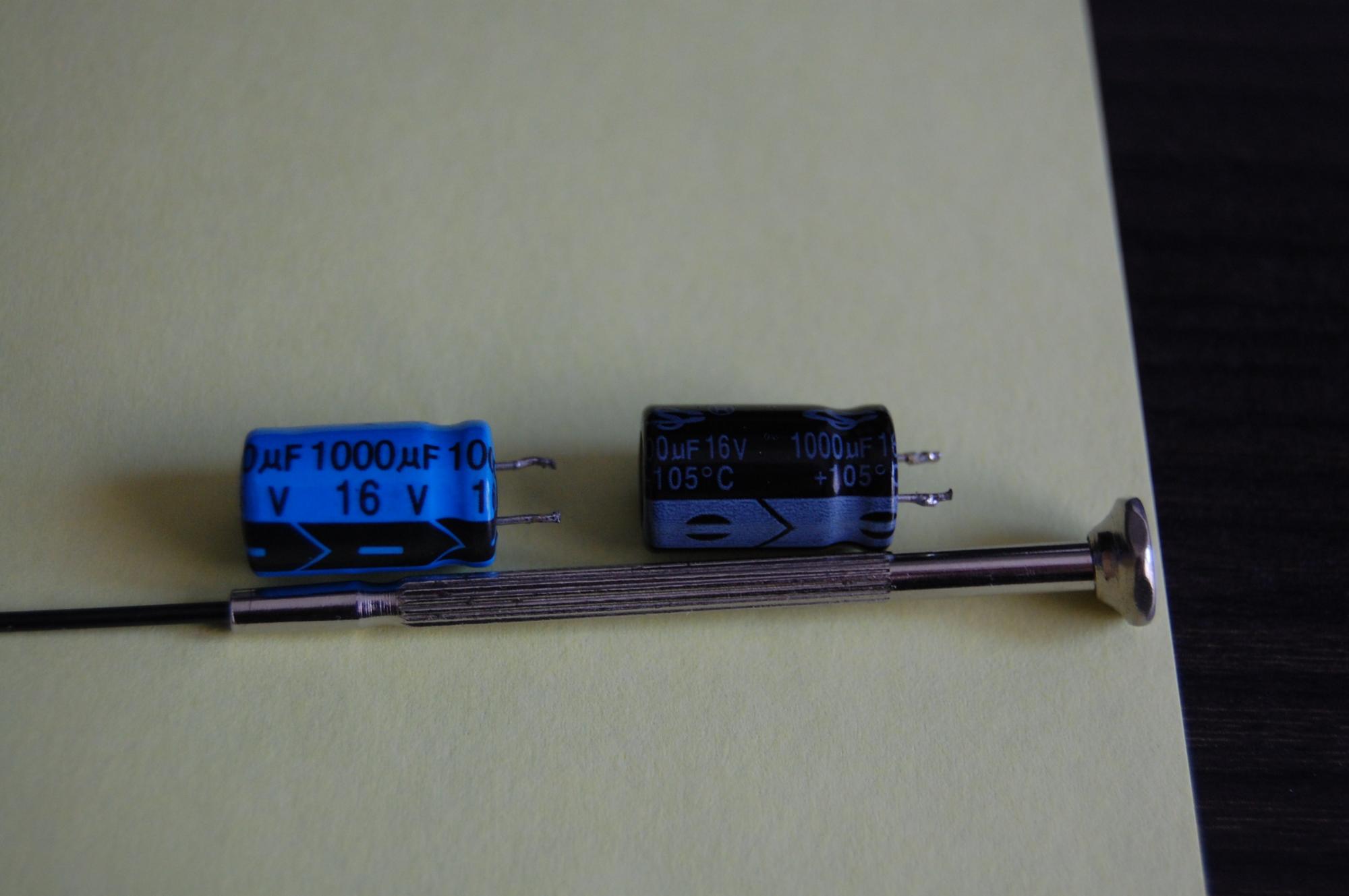

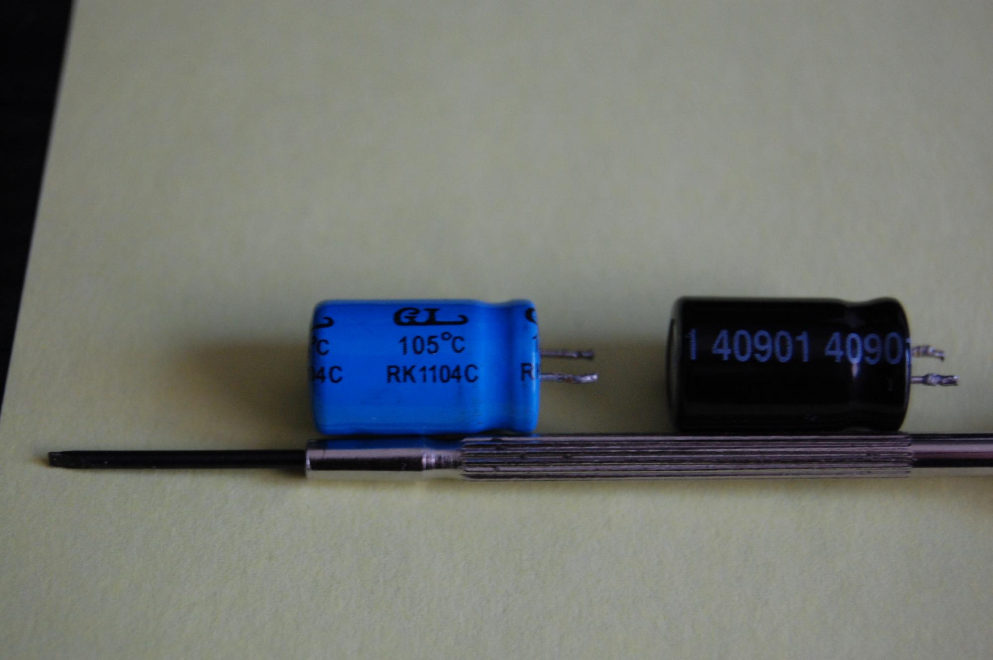

    I am trying to resurrect some PSU:
    In one of these I found a bulging GL (?) 1000microfarad 16V capacitor, in another PSU I found an identical in these specs and dimensions CS capacitor in visually good shape, you can see in the attached photos.
    I don't have an ESR tester, can I try to solder the CS capacitor in place of the GL one?
    Thanks for the help
    Leonardo
    • 31293
    Re: PSU bad capacitor 1000microF 16V
    the GL is RK series.
    https://cdn.badcaps-static.com/pdfs/...baf605f4b2.pdf
    the CS should have a 2 letter code on it somewhere.
    find it and then get the correct datasheet
    http://www.paullinebarger.net/DS/CS%...uang%20Jin%5d/
    • 250gto
      • May 2016
      • 6
      • Italy
      I didn't find any code on the CS capacitor, but I bought an equivalent capacitor at a local store and I soldered to the PSU:
      it is functioning again.
      I spent a fraction of what I could spend to buy a new PSU and I also made a fraction of garbage that I could produce.
      I am very satisfied.
