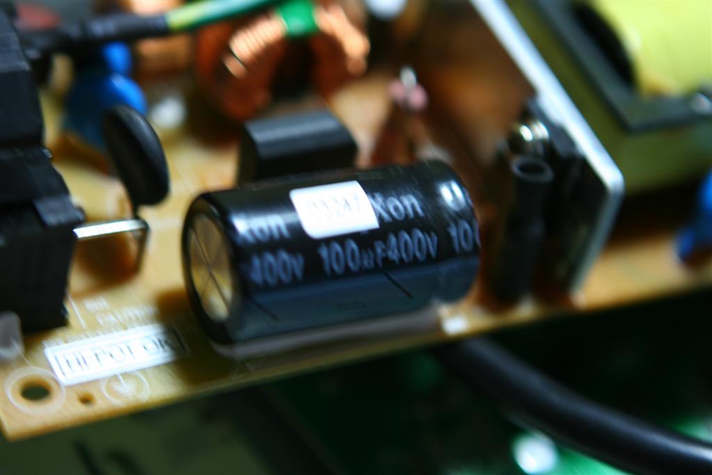

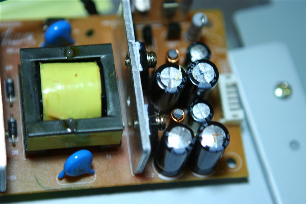

    I have an LCD whose power will not turn on. There is a cricket sound coming from the transformer on the power supply.
    Is the cricket sound caused by bad caps?
    I attached two images of the caps on the board, they are made by CapXon
    I apologize for the blurry pictures, I can take better pictures if needed.
    Info on the caps
    First Image:
    _ 1
    2 3
    _ 4
    5 6
    1&4 = 220uF 25v
    2&3 = 470uF 35V
    5&6 = 1000uF 16V
    Second Image:
    100uF 400v

      Viewsonic, I can get the model when I am home.
        Re: Bad Caps causing power outage in LCD?
        ViewSonic
        VP930b

          Should I just replace them and see what happens?
            Could someone recommend caps to use? I am a noob at knowing what cap manufactures are good/bad
              I would use Panasonic FCs they can be ordered from Digikey.
              In any case you MUST use low ESR caps on this supply.
              I use the FC series on computer PSUs and LCD inverters because they can take the heat that these supplies naturally generate.
              Caps made by Nippon Chemi-con, Nichicon, Rubycon, Samxon, or Panasonic as mentioned above will be fine.
              Crapxon caps are a hit or miss in some environments they perform well while in others they go belly up.
              The noise is a good sign it probably means that the switching FET and the PWM circuitry is operating.
              I've heard all types of wierd transformer noises from bad caps.

                    i'd replace them all
