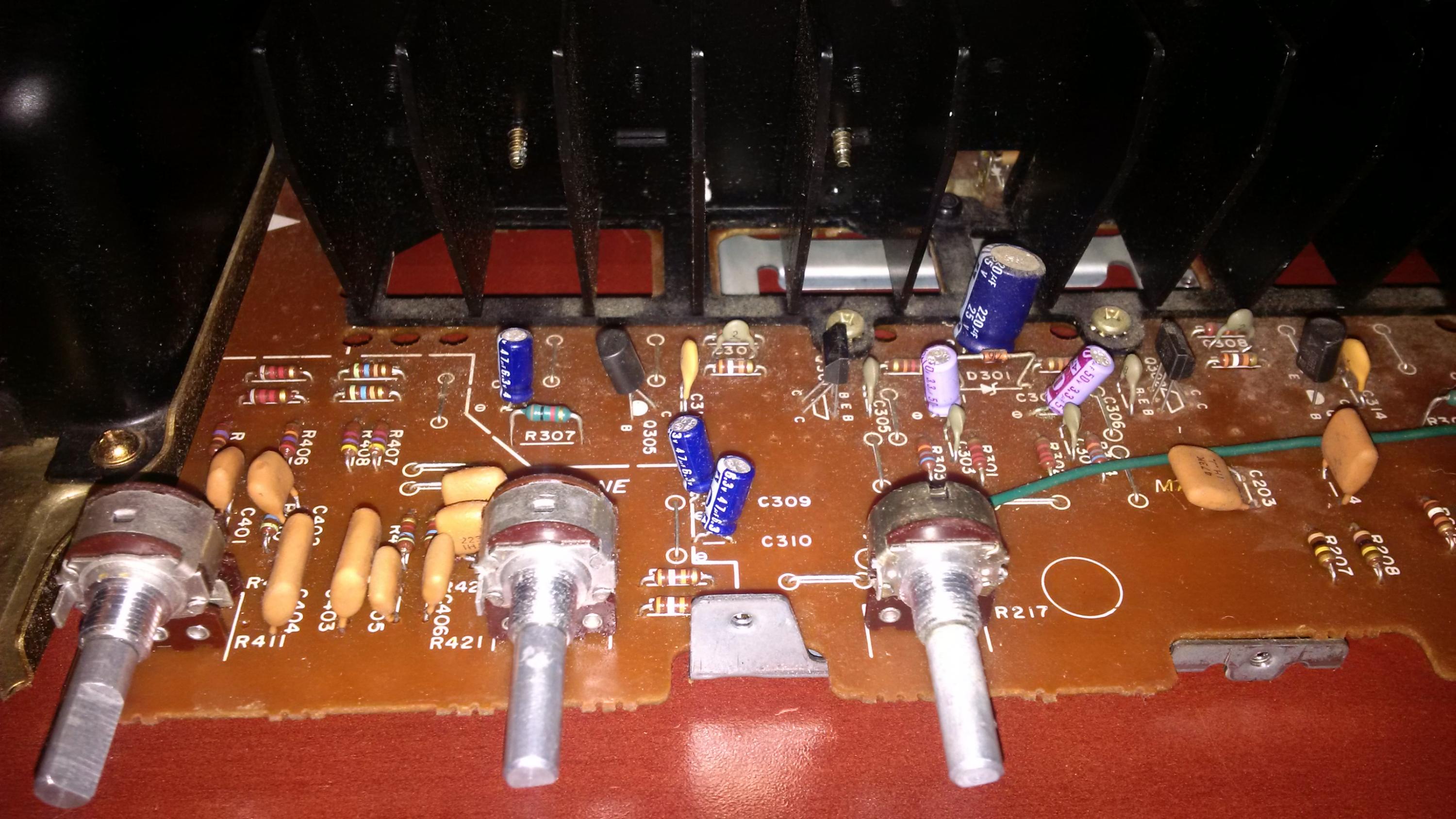

    Hi Guys.
    I just got this receiver for $30. the function switch was buggered up but I think I have that sorted out. (Testing shortly)
    I've read that recapping this unit does it justice and I'm wondering which caps I should be looking at using for the replacements. There is a local electronics store around the corner but the stuff that's there is cheap Chinese stuff... in a pinch it works. But I don't really want to go that route on this restoration.
    This amp was assembled in 1979.
    I'm not looking to use the best of the best considering on what I paid and overall what this is worth ($75-$100). But I am out of touch on what brands are the cheap, average and what the high end units are.
    Here is a link to the specs if you are wondering; http://www.hifiengine.com/manual_lib.../su-8011.shtml
    Looking forward to your recommendations.
    Vin
    EDIT: I've tabulated a caps list.
    Value - Voltage - Quantity
    6800uf - 42v - 2
    220uf - 50v - 1
    47uf - 35v - 2
    100uf - 50v - 1
    100uf - 35v - 2
    220uf - 35v - 1
    220uf - 25v - 1
    47uf - 6.3v - 6
    3.3uf - 50v - 2
    100uf - 6.3v - 2
    47uf - 50v - 2
    3.3uf - 50v - 2
    24 in total.

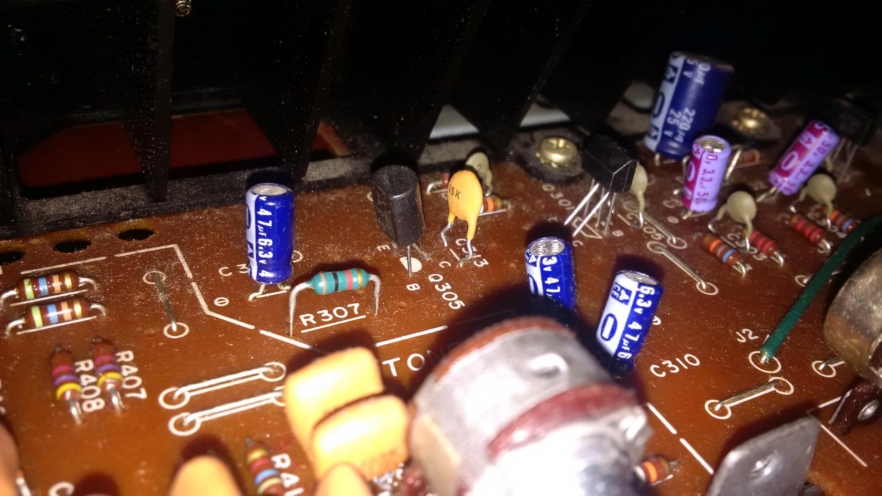

              here are a few questions, I know the voltage on a cap is what it's rated for. But in an audio circuit. bumping up to the next available voltage cause any changes to the circuit?
              1)
              One cap thats in there is a 47uf @ 6.3v, on mouser they only start at 10v. I know that electrically isn't an issue. but again, what about an audio circuit?
              2)
              and any recommendations on power caps?
              Vin

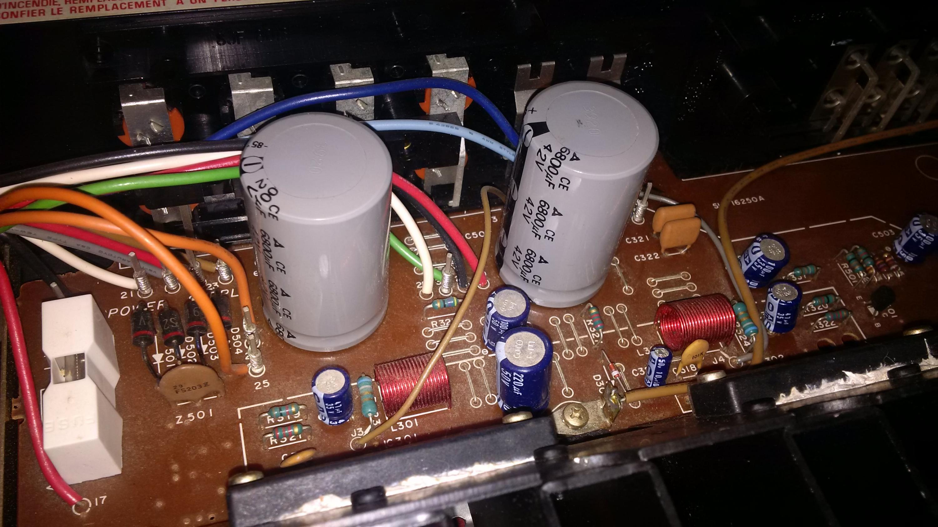

                • 31214
                Re: Technics SU-8011 Receiver - Looking to recap it
                the power caps are 10mm pin-pitch snap-in type.
                rubycon has a good range of those - but they co$t.
                the 47uf will be fine at 10v or 16v / 35v (if it's cheaper)

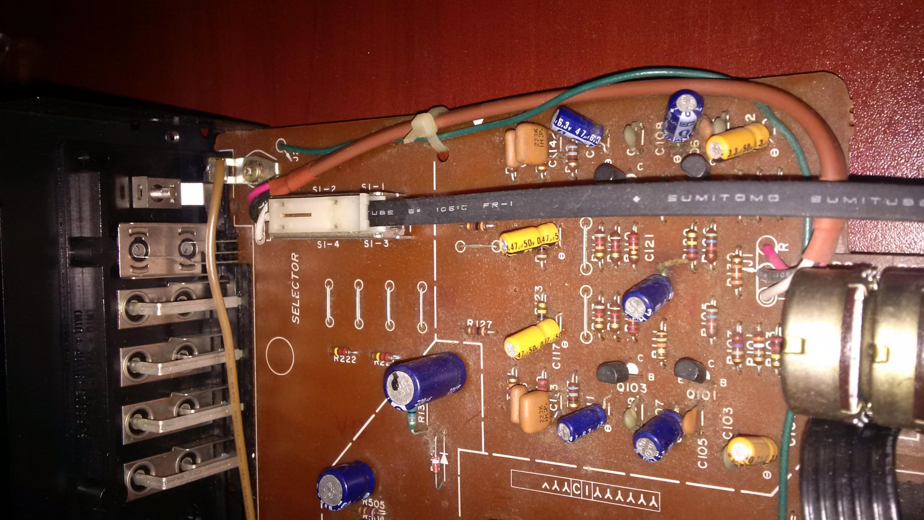

                  Bumping it up to 10v will make no difference. Just keep an eye out for bi-polars. I usually make a drawing of each board showing each component and polarity in reference to each other so I don't make a mistake. Get a cheap meter with Hfe if you change transistors because sometimes you'll get some with the same number but the legs will be swapped. Instead of ECB the new ones will be EBC. It can get more confusing if your substituting transistors.
                  For the large power filters I have always used Panasonic T HA series but they recently started discontinuing the ones I used.
                  This will work I think. Measure the originals and see if it's too big around. http://ca.mouser.com/ProductDetail/N...qbmxvr0mMJ4%3d .I'll tell you one thing, if you lose that double transistor in picture 4 you'll have a time finding a replacement. I bought the last Pioneer had a few years ago I got a few more from little diode but that was the last as far as I could find. A sub can be made but it's more trouble.

                      I didn't realize that they were snap-in type. I was thinking of getting these
                      http://ca.mouser.com/ProductDetail/N...aX95u8F7QVc%3d
                      but the ones you recommend has a lower leakage current and 3x the life.
                      it's worth the extra buck.
