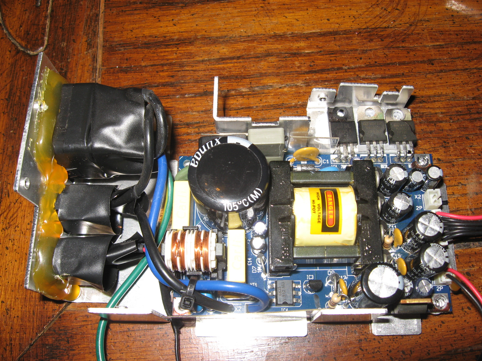

    Behringer eurorack UB222FX-PRO power supply
    Hi guys I have a behringer sound board that has a bad Power Supply. I have narrowed it down to bad capacitors. Take a look at these pictures.
    This is a broad shot of the whole Power Supply.

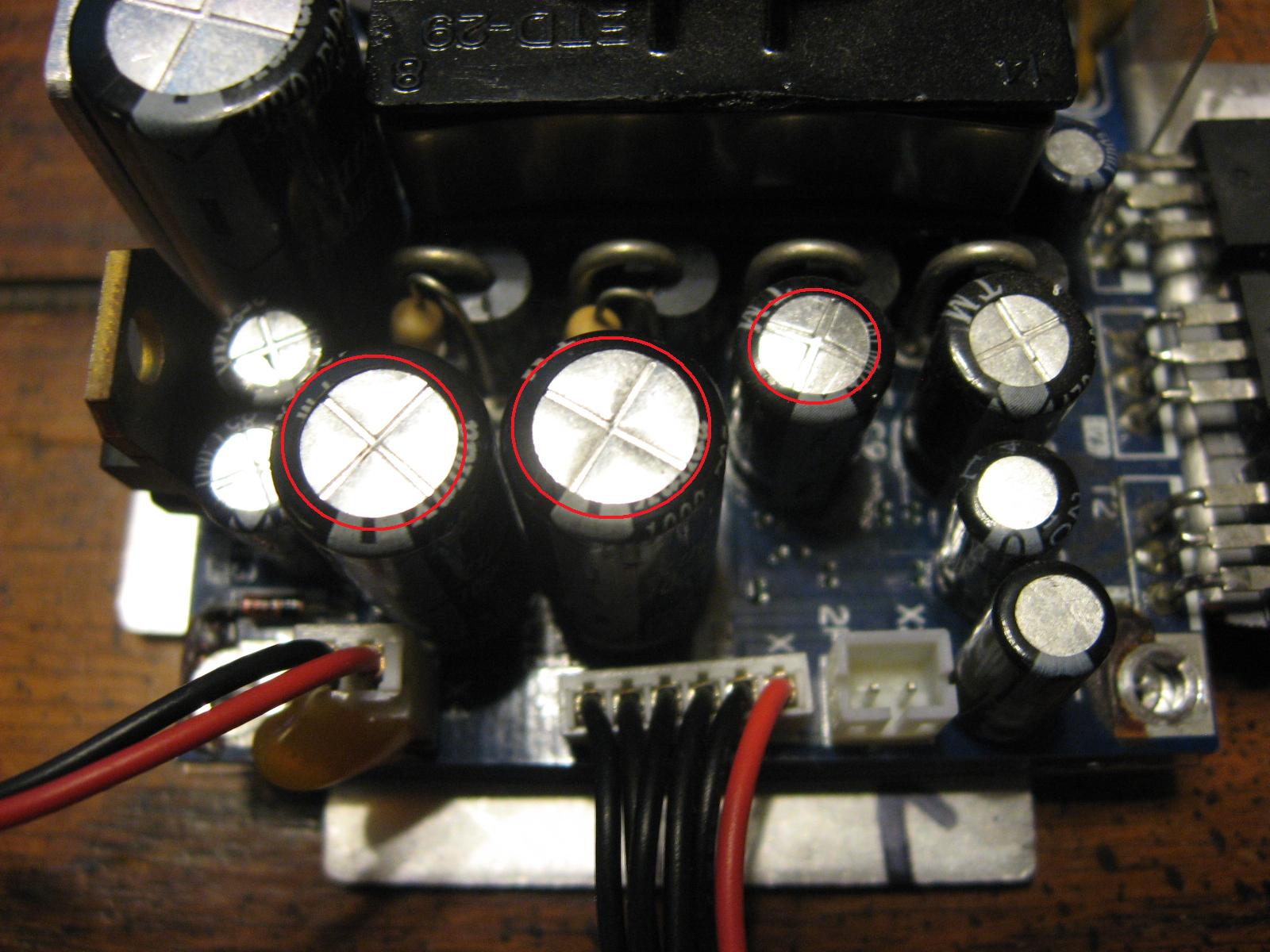

    This is where the bad capacitors are. They are circled in red. The two larger caps I pushed down with my thumb, they were more swollen than this.

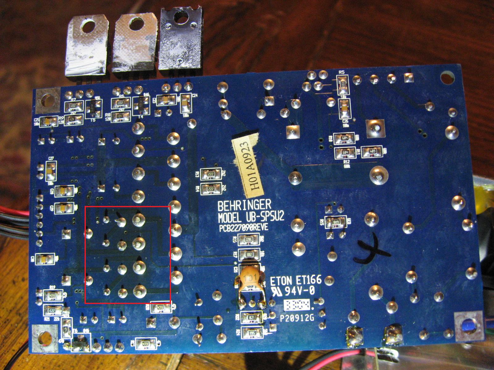

    This is a picture of the bottom of the Power Supply. Notice the area boxed in red got a little hot.
    The story behind this sound board was it was left on all the time. What it would do is its internal synthesizer would turn on, and the 48V phantom power would come on, but the actual mixer would not get power unless the power supply was hot. After it warmed up, the sound board functioned normally. All of the capacitors are of an unknown brand, " Xunda" . I am going to go ahead and replace all of the capacitors inside this power supply, since I know that some of them are bad. We shall see what happens!

    Re: Behringer eurorack UB222FX-PRO power supply
    If the supply still works after it is warmed up, then chances are excellent that the it work great after replacing the capacitors. My old 17inch monitor was the same, power supply was still operational once it had warmed up, but the caps were cactus and replacing them immediately got it working properly again. I should start a thread and show pictures.
    Just make sure you use low ESR capacitors.
      That would be the best course of action. Let us know how it works out.
      Also, Behringer uses crappy capacitors in a lot of their equipment. Therefore, if you have any other Behringer stuff, I strongly suggest you take a look inside them as well before finalizing your capacitor order. Might be a few more "rotten eggs" in there.
      As for cap replacements, I think the list below pretty much covers what you can use as a suitable replacement. There may be other choices too, but these are the known good here for power supply use.
      Manufacturer...............................Series
      Nichicon ................................ PW, PM, PS, PJ, PV, HE, HD, HW
      United Chemicon (UCC) ............ KY, KYA, KYB, KZE, LXV, LXY, LXZ, KZH, KZM
      Panasonic .............................. FC, FK, HFQ (old stock only), FR, FM
      Samxon ................................. RS
      Rubycon ................................ YXJ, YXG, ZL, ZLJ, ZLK
      Lastly: AVOID EBAY FOR CAPS - especially anyone from China or Hong Kong. There are some legit sellers, but they are very few. Chances of getting counterfeit Japanese capacitors is very high.
                Sorry for taking so long to reply, but I want to get this right... I took the power supply and pulled all of the caps off (couldn't read some of them, too crowded) and now I am looking for replacements. There are only 13, most of them small, but I want to be sure to order the right thing. I Know how to match capacitance and voltage, but what about all of this "series" mess? I know I need to find low ESR caps, but I can't find info on the original caps, so I don't know what to order. Also, in a SMPS, which caps are critical when it comes to low ESR? The output/low side caps, or caps on the high side (filter cap?). Here are the specs of the caps I removed, hopefully you guys can suggest replacements.
                XUNDA 150uf 400v x1
                XUNDA 330uf 100v x1
                XUNDA 1000uf 25v x2 (these were both bulged)
                XUNDA 470uf 16v x2 (one was bulged, the other wasn't)
                XUNDA 47uf 63v x2
                TEC 100uf 25v x2
                XUNDA 47uf 25v x1
                XUNDA 10uf 25v x1
                BH 1uf 50v x1
                Just trying to make these stupid electrons behave!
                  See post #3 above. Any of the series listed there should work (though, the first 2 to 3 series on the left that are listed for each manufacturer are the more preferable choices). In fact, XUNDA caps are so crappy that even 105C general purpose series from any of the manufacturers above will do better and last longer than XUNDA.
                  So just get a reputable Japanese brand (preferably from the series I listed), and all should work well.
                  Output side caps are somewhat critical. That said, many PSUs will accept quite a wide range of low ESR. It all depends on the design, of course.
                  In general though, motherboard-grade low ESR (such as Nichicon HM or better, Panasonic FL or better, and Rubycon MBZ or better) should be avoided. Some PSUs may work even with those, but the ripple and noise on the output will be higher.
                  For the output caps, also make sure to always match the capacitance. Exceeding it by a notch or two is generally okay too (i.e. 1200 uF in place of 1000 uF cap is fine, and even 1500 uF in a spot with 1000 uF likely won't cause issues).
                  The rest of the caps are not critical ESR-wire at all. Just need to be 105C caps, that is all.

                      So I did some looking around and found the part numbers I want to buy. Please review these and see if they will work.
                      Nichicon LGU2G151MELA
                      replaces
                      XUNDA 150uf 400v x1
                      Nichicon UVY2A331MHD
                      replaces
                      XUNDA 330uf 100v x1
                      Panasonic EEU-FR1E102
                      replaces
                      XUNDA 1000uf 25v x2
                      Panasonic EEU-FC1C471L
                      replaces
                      XUNDA 470uf 16v x2
                      Panasonic EEU-FR1J470
                      replaces
                      XUNDA 47uf 63v x2
                      Panasonic EEU-FM1E101
                      replaces
                      TEC 100uf 25v x2
                      Panasonic EEU-FM1E470
                      replaces
                      XUNDA 47uf 25v x1
                      Panasonic EEA-FC1E100
                      replaces
                      XUNDA 10uf 25v x1
                      Nichicon UVZ1H010MDD1TD
                      replaces
                      BH 1uf 50v x1
                      Hopefully all the parts I picked will be suitable for the purpose.
                        ^ That list looks good to me.
