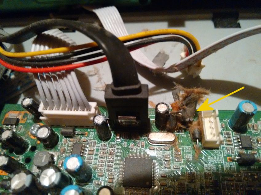

    Approaching my elderly mothers door recently I heard a crack which sounded like a .22lr rifle, on entering she informed me that it had come from the TV or the digital recorder box, she had immediately switched both off at the power outlet so I took a look, the TV was fine but when sniffed the recorder box smelt odd, but not exactly a "burnt electrical" smell, on opening it up I saw that one of the 220uf 16v caps had literally exploded off the board leaving both wires in place, before I attempt a repair does anyone have any idea what could have caused this?

    clean up the mess and take another pic so we can see the area better.

      Usually never see that kind of catastrophic failure with caps unless it was abused (like reverse polarity)... Weird...

        I guess the cap must have not had a safety vent. Because, even with reverse polarity and severe over-voltage, most caps with vents still just gas out politely.

          Well I replaced the cap and it didn't fix it, all I was getting was the front panel led flashing I'm guessing that either the exploding cap caused some other damage or some other fault caused the cap to fail

            We need more pictures. You may have other bad caps in the box or perhaps something else wrong with the power supply.

              given the 4pin connector it's next to, i suspect it's related to the 5v or 12v rail
              maybe the hardrive is not being powered, a lot of newer cheap-ass pvr's store the firmware on the drive and only have the bootloader in flash.

                I took a look at the rest of the caps and several of them are swollen , I imagine it has had it's time but it hasn't done too badly lasting 5 or 6 years of daily use.

                  so new caps then

                    I don't see the images but did the caps have proper vents? If they were ventless, its actually quite common for the pressure to leak through the bung.

                      he had the pair of plates and balls of brown paper syndrome!
                      no idea where the can went!!!
