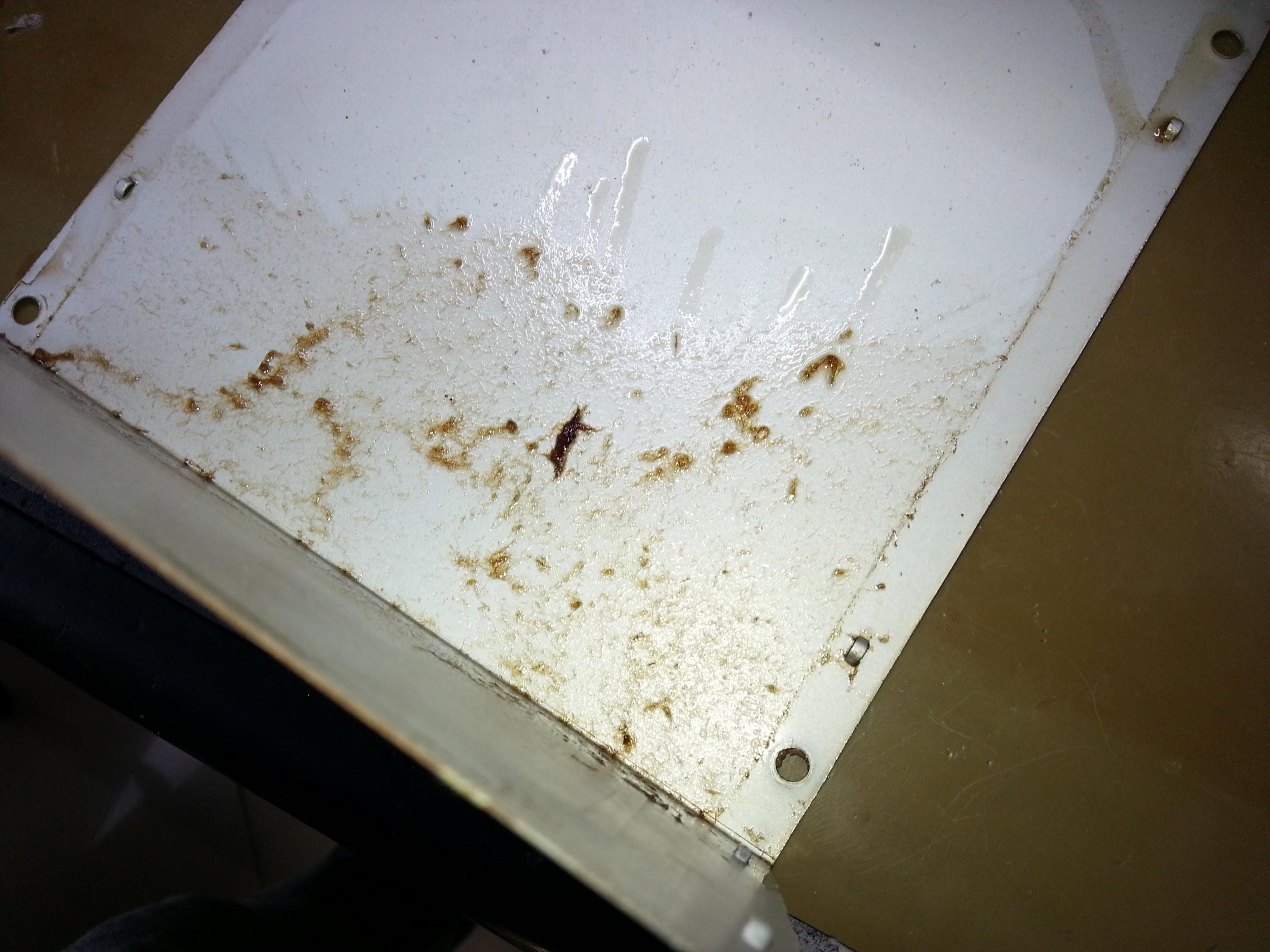

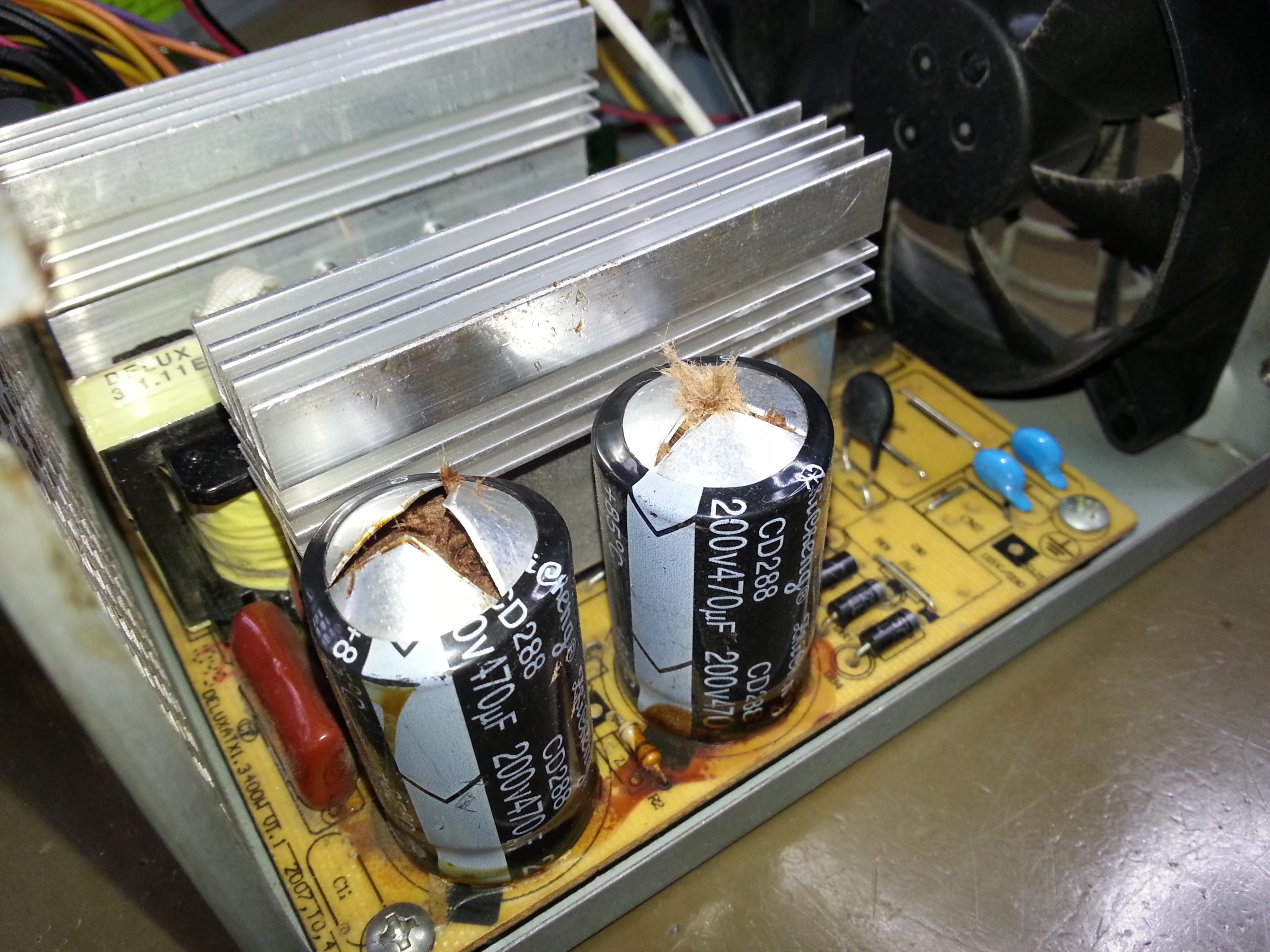

                      Here's my own little interesting encounter with faulty caps: two 470uF reservoir caps on an ATX power supply experienced catastrophic failure. The caps were installed by me about an year ago, as this is a refurbished junky 400w Delux PSU and of course it wasn't worth investing in quality caps which might've ended up costing more than 2-3 of these supplies together....looking at the damage, you'd think there's NO WAY the primary is still functional, but it's actually fine - not even the fuse went ! :|The story is even funnier (for an electronics nerd): the guy who tossed it said his daughter freaked out when she heard a loud bang from underneath the desk and saw some smoke coming out of the computer. I thought to myself "Ok, probably a FET shorted and took out the fuse and possibly some or all of the diodes", but then he followed saying he tried plugging the PC back in and ANOTHER pop accompanied by the obligatory magic smoke of course. I was pretty stumped myself at this point and thought maaaaybe someone somehow shunted the fuse or replaced it with one with too great a value in the meantime, but then I took the cover off and saw THIS The cause of failure was likely some liquid which spilled onto the back of the PC and into the supply, because there were dribbles of coke or perhaps coffee all over the inside of the PSU's case...that combined with the low quality caps resulted in this wonderful effect

                        Re: The Hall of Shame - Badcaps Photo Montage
                        Don't see any coke or coffee.
                          I do Though you're right, the liquid gathered on the cover of the PSU, because when installed in a PC it normally faces upside down, meaning the board was at the top and cover was at the bottom...some of it might've oozed under the board as well.
                          Wattevah...
                            I'd expect that to be electrolyte from the exploded caps.
                            Which do not seem to ever be replaced when the glue on them has same structure and color and continuity with the glue on the board. Maybe it just appears that way, after all, they usually apply the glue in same spots, but still…
                              Well I repaired many of these exact same PSUs and distinctly remember replacing the large caps on one of them, so I could be mistaking it for that one....you're right, I didn't even notice the glue...either way the damage's been done
                              Wattevah...
                                That looks like what I'd expect to see from a PSU set for 115VAC but plugged in to 230VAC, if there are no MOVs protecting the big caps.

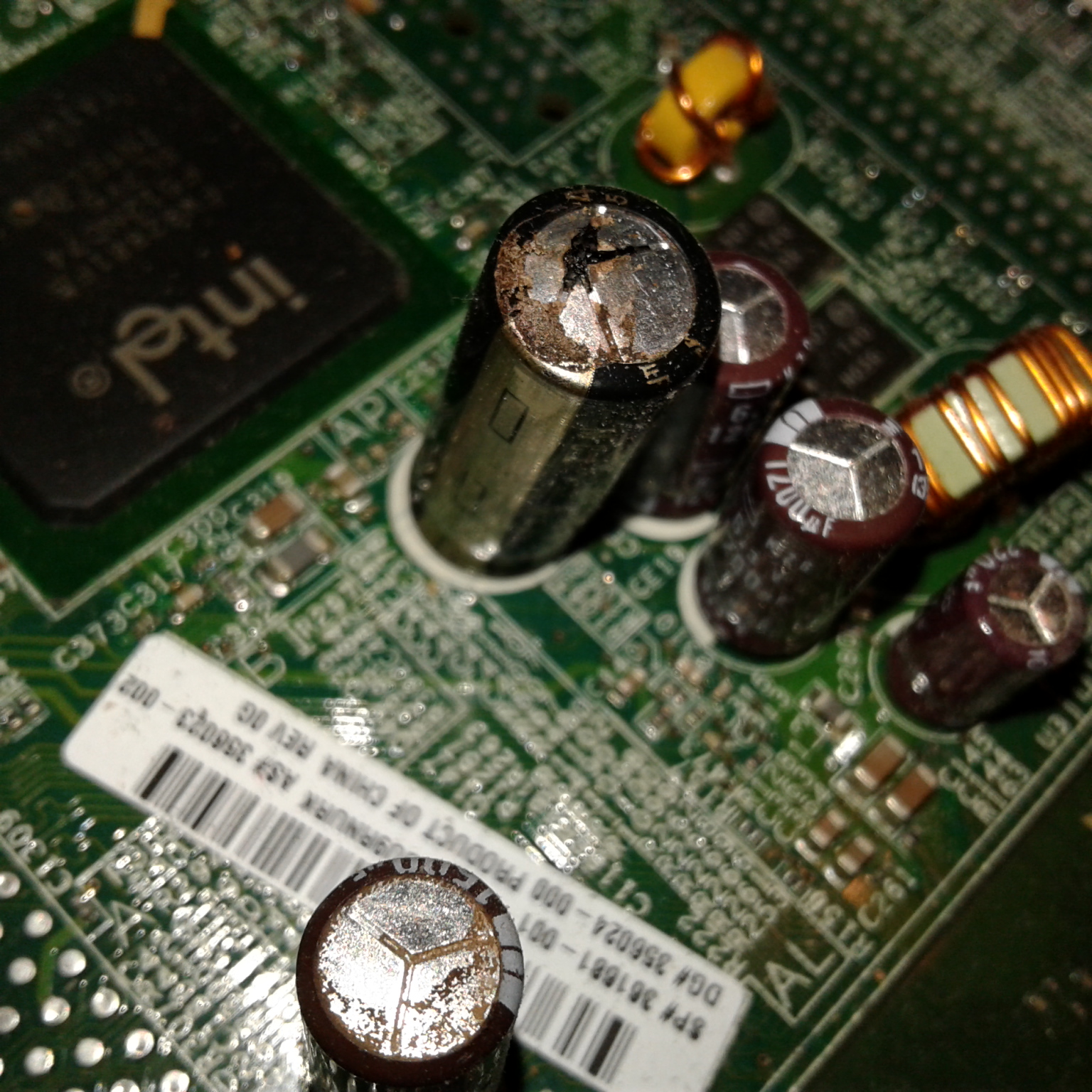

                                        I found what looks to be a server of some sort.
                                        I don't see why they threw it out on the curb.
                                        For those who failed to catch on, that was sarcasm.
                                        Poor rubycon capacitor.
                                        I'm not a expert, I'm just doing my best.
                                          Those KZG caps next to then don't look that much better either
                                          The server probably ran pretty hot to cook those Rubycon caps. I've only seen MCZ fail in locations where they were exposed to heat. That bare Intel chipset does typically run quite hot.
