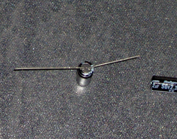

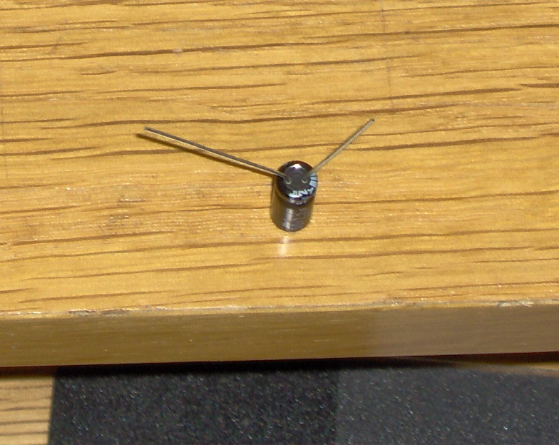

      Ah, the joys of eBay! :P This time the seller was 'lpfixparts310'.
      The item:
      http://www.ebay.com/itm/280680668117...84.m1497.l2649
      ...And you can see what I got in the attachments. Concentric bungs, slightly sloppy printing, you know what to expect. Kinda hard to see in the pics, my camera really sucks. I cut several open and they bubbled slightly. Wonderful, they're pre-pressurized.
      Raised a stink over it. They claimed they got their goods from a 'reliable seller'. Told them real Rubycons don't use these concentric bullseye bungs. They refunded my money with shipping. I agreed not to leave negative feedback (heh heh, _that's_ why they refunded my money) BUT I never said I'm not gonna roast them elsewhere...
      So yeah. Stay the he-double-toothpicks away from 'lpfixparts310'. In the meantime these "beauties" will be going into the goody bag, awaiting when I get a variac or at least a powerful enough DC power supply to make em pop.

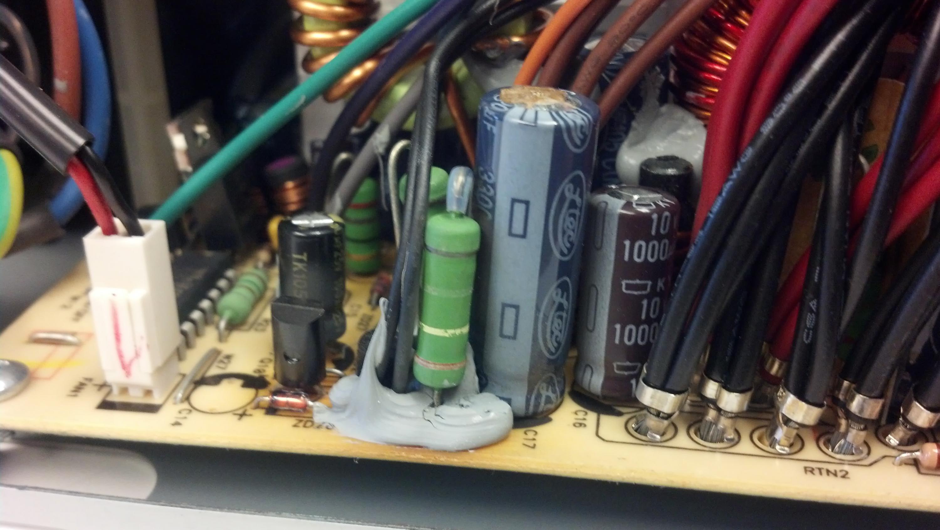

        Leaking Ltec, from an Ablecom server PSU. Surely that super hot resistor had nothing to do with it
          Re: The Hall of Shame - Badcaps Photo Montage
          And what's with mixing that Ltec turd with that nice 1000uF, 10V UCC/NCC KY series part? WTH?!
          PeteS in CA
            I know, what a shame. Lucky for this PSU i will recap it when i have time. won't let that cap go to waste!
              That resistors needs to go away. Any cap will have a rough life next to it regardless of brands.
                Replace it with a different one or just remove altogether? In my experience the 3.3V rail is the most sensitive to changing/removing minimum load resistors. Probably because it isn't heavily used in modern computers.
                  Either replace with a different one or actually physically move it somewhere else in the case where it won't be cooking caps. Or you can also try running without it. I usually try that first. Most PSUs won't care as long as you have a motherboard hooked to them.
                    My usual tactic with those hot resistors is to solder them onto wires and use some thermal epoxy to stick them to the secondary heatsink.
                      And they don't mind having such long leads? Can you post an example of what you're talking about?
                        Why would they mind? It's just a resistor, a load. Imagine it as a component inside your computer consuming power from 3.3v or whatever rail that resistor is connected to...
                        That's all that resistor is doing, faking a device consuming some power so that there's always something eating some power.
                        I was going to suggest soldering wires to the resistor, then covering the resistor and leads into heatshrink and gluing it or taping it to the metal case further away from the capacitors.
                        I'm against getting the resistors in contact with the secondary heatsink, for various reasons, but it should be fine.

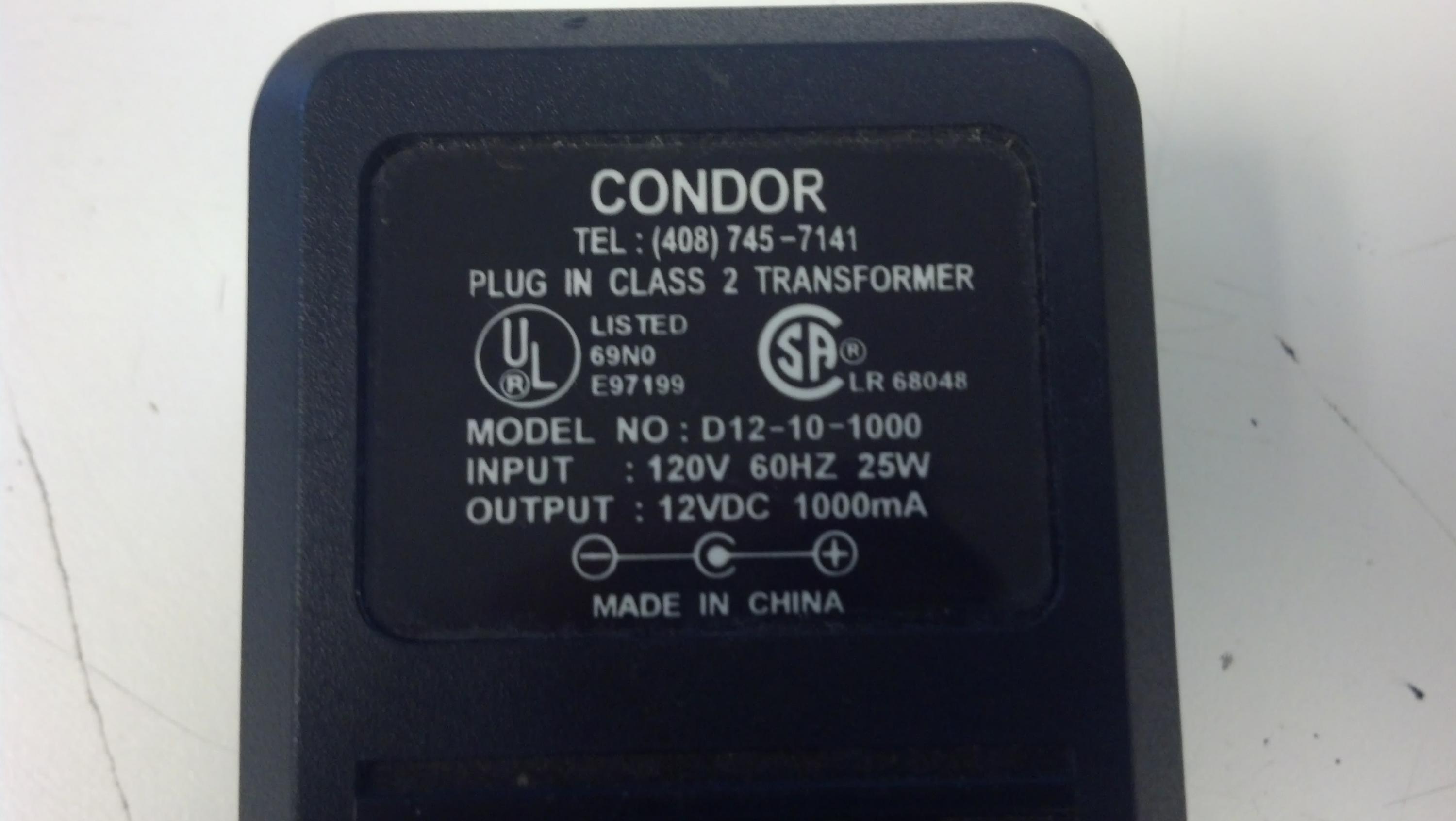

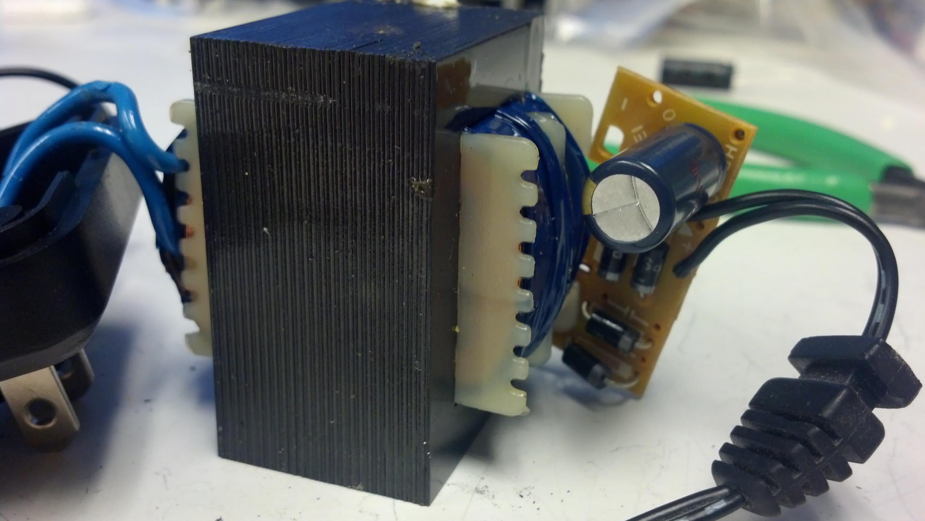

                            I think this brand is Sonjiu. It was in this little wall wart, it was going to power a modem 24/7 so I replaced it with a panny
                              That's actually a classic transformer with a bridge rectifier (made out of 4 diodes) and the capacitor to smooth out the ripple.
                              The output voltage will probably be about 13-15v with no load.
                              I would personally use that transformer for some projects and replace the adapter with a cheap switching power supply - those classic transformers are more expensive sometimes compared to switching power supplies.

                                      Okay, I'll switch it out with a cheap switching supply. That thing has a good sized transformer!
