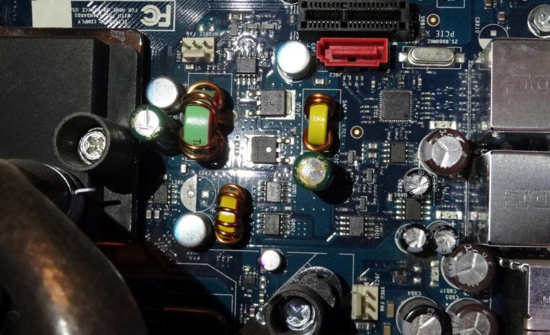

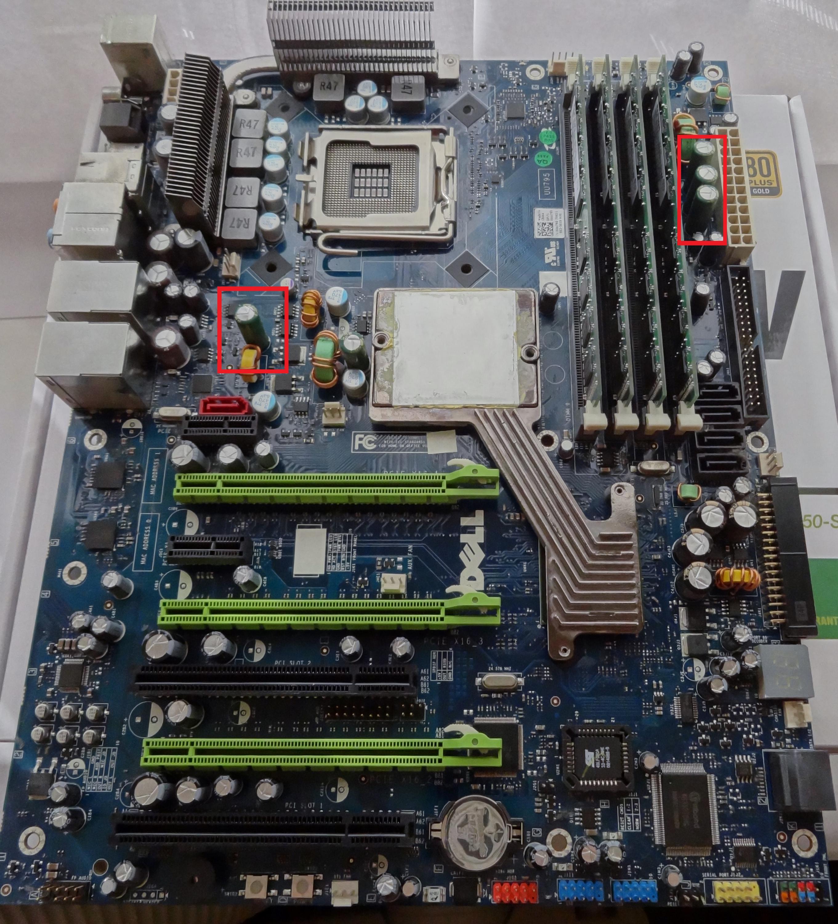

    Here are some pics of the of the caps I think are bad, are they?
    Slight bulge
    Then theres another 3 which look to be bulging, these are next to the end dim slot near the 24PIN ATX connector
    This one appears fine, nice and flat for comparison
    There are 4 caps in total that I think are bad, could these be having an affect on the DIMM slots and also making the boards stock auto volts low?
    The caps read Sanyo 1500uF 6.3v (10mm x 20mm)

    Re: Nvidia 790i Ultra Bad Caps Causing Problems?
    replacing what looks like maybe fake Sanyo with what is probably more fake sanyo.
    you should be using Rubycon MCZ series.
    or if you know the actual voltage going into each cap, use poly's - they dont leak.

                Those caps on amazon are very very very likely FAKE. Do NOT use them in anything you care about! Chances are, they will not last long at all and you will need to recap the board again (or worse, they could go so bad that they could kill a MOSFET).
                Buy caps only from Badcaps.net, Digikey, Mouser, or RScomponents to avoid fakes. Almost everything on eBay is fake too (only a handful of sellers that sell good REAL Japanese caps).

                Actually, those Sanyo's that are originally on his board right now could well be genuine. IIRC, it was mentioned on badcaps a few times that WG series aren't very stable.

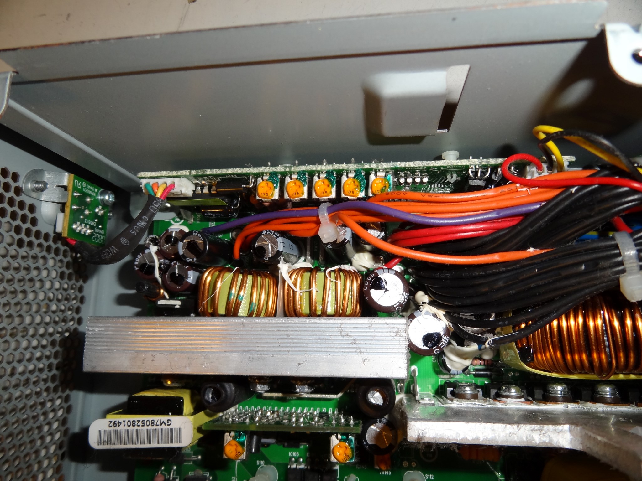

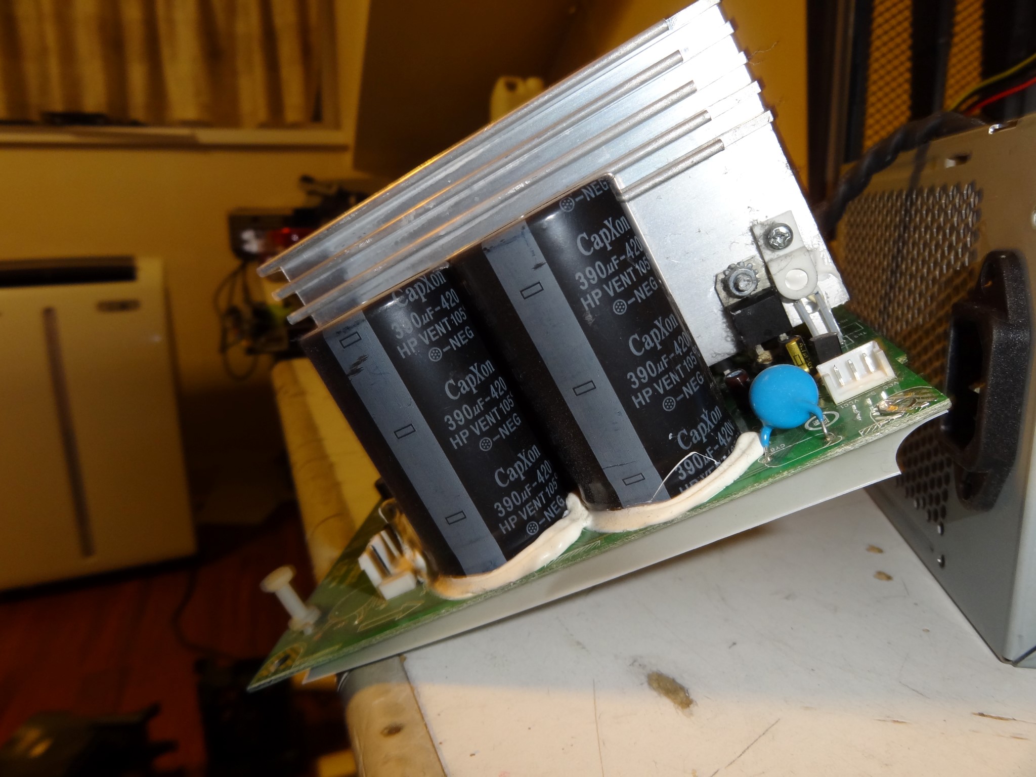

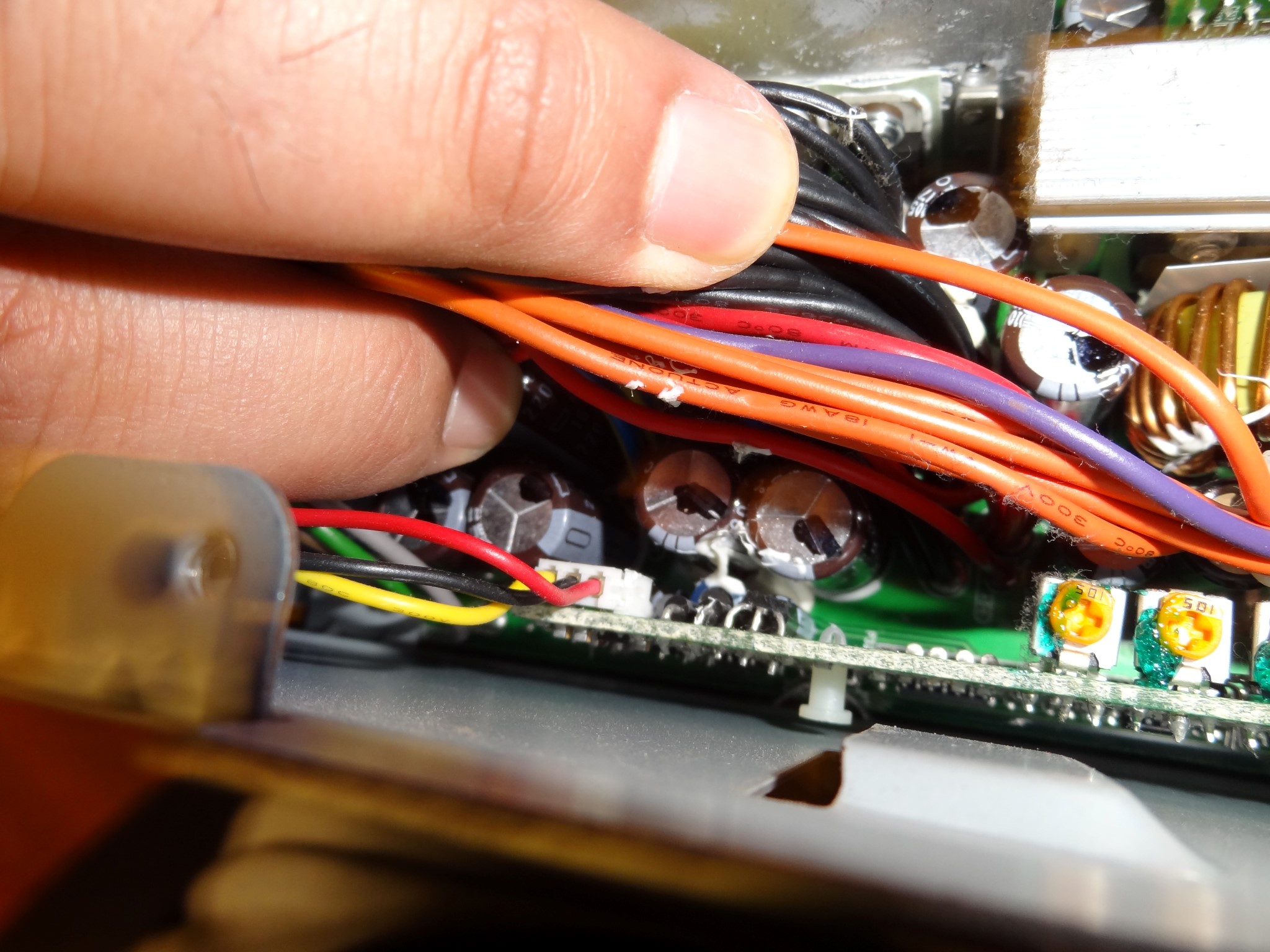

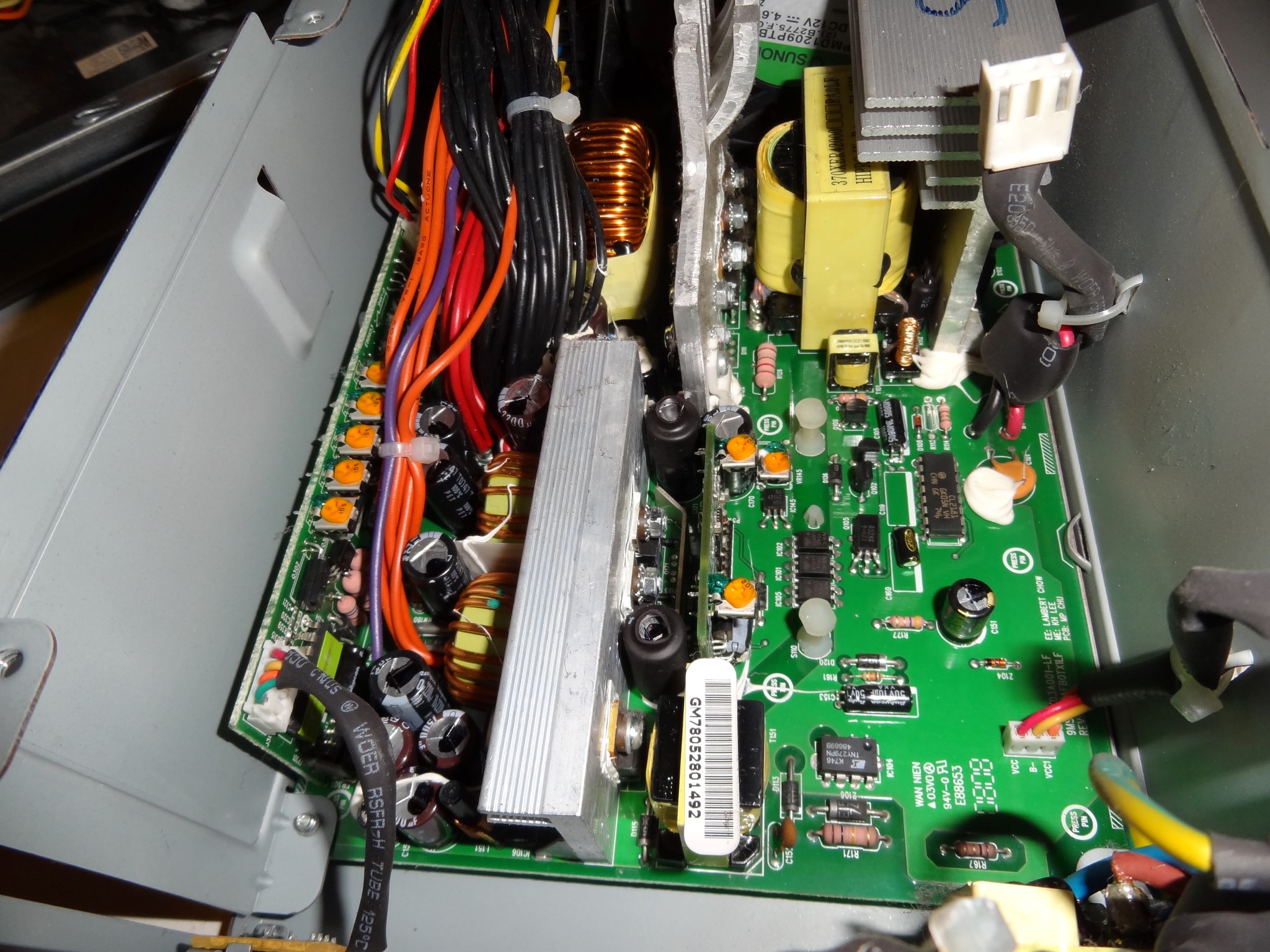

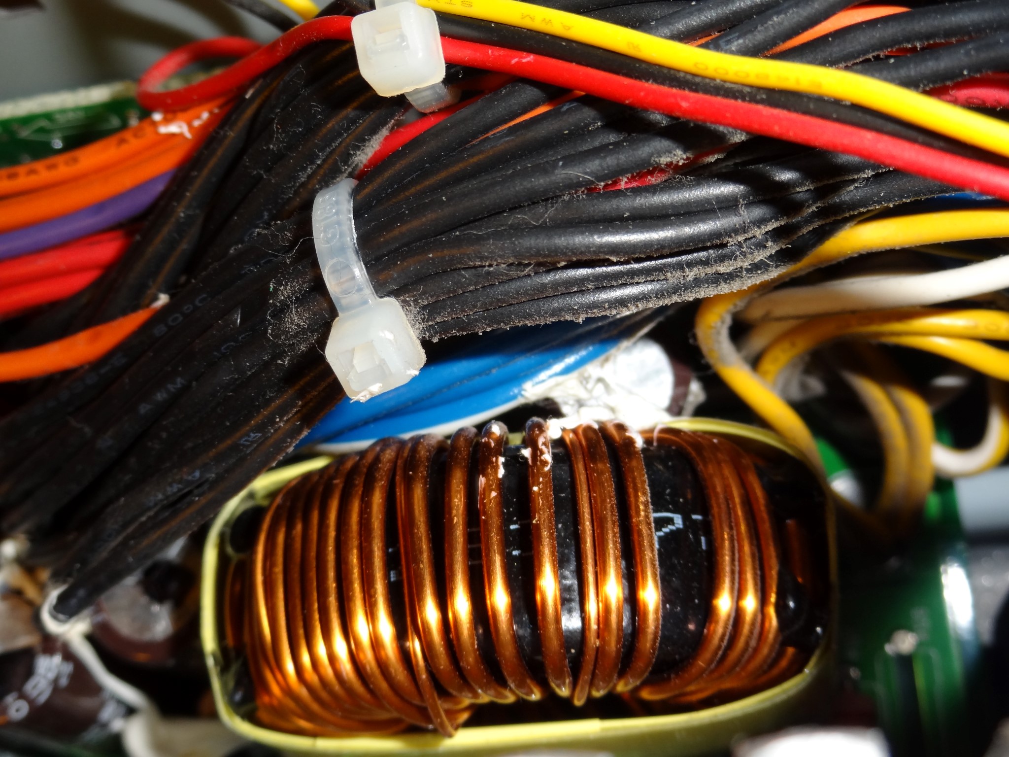

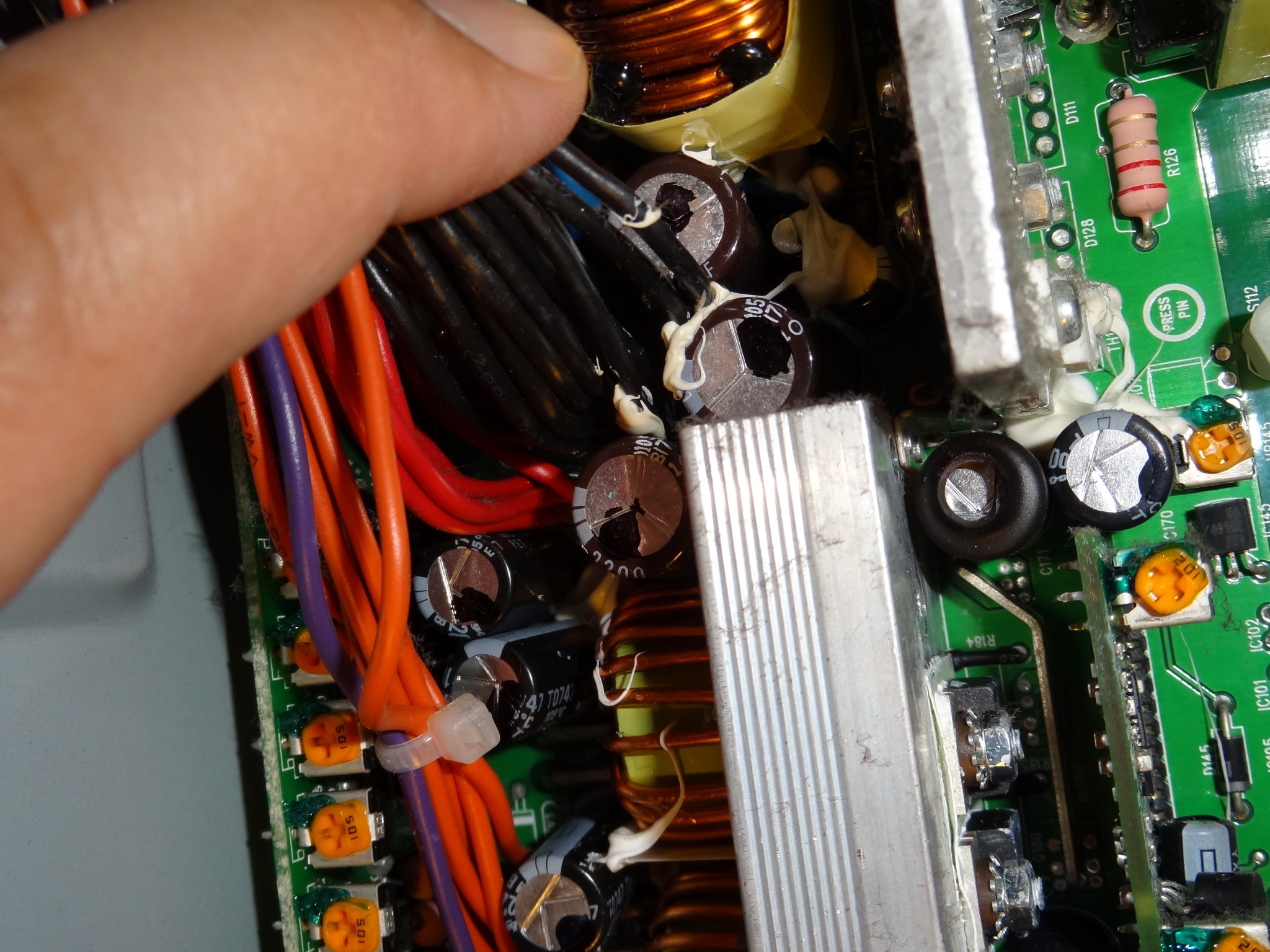

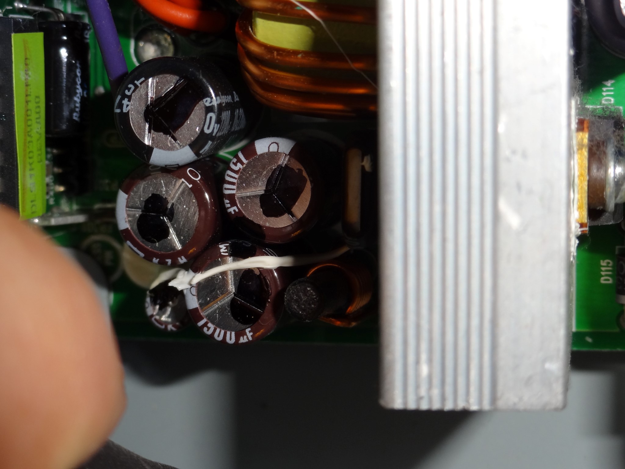

                      here are some pics of inside of PSU.
                      I assume these are the bad boys I should be wary off!?
                        Your PSU is fine. That thing is built like a tank. Certainly try replacing the caps on the motherboard, but there is a very good chance that your board has another problem. All socket 775 and AM2 boards with nvidia chipsets have known flaws with the chipsets, and a good portion of them are dead or unstable by now as a result. If your board does have a failed chipset, it's toast.

                          Seems nice and clean inside and all caps I can see look fine. I think chipset is fine as it works fine when I add a bit of volts, was hoping the bad caps were interfering with the power delivery hence having to give more volts.
                            The caps are probably the problem, then. The chipset issue is just something to bear in mind about boards from that era.
                                Yeah that's something that always irritated me. There's a lot of counterfeit products sold on amazon that sellers complain about stating 'this is not a good brand', but it's not the brand but the counterfeit product...
                                I actually think those are genuine sanyos. The covers have the faded printing that you see on genuine ones. And OEMs typically have sources to genuine parts.
                                --> it seems like there's a lot of blame for OEMs using fake capacitors, when this is simply not the case
