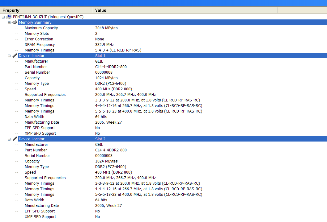

      So, you think this is the reason that when I put 1GB in place of the 521mb dimm it goes mad and refuses to post?
      The ram now runs in 667MHZ. Correct me if I am wrong please.

            I made it boot with 2x1GB DDR2! It wasn't easy at all though..
            I think the memory controller is terrible. Every time I chose "automatic configuration" in bios it failed to boot with more than 1 dimm installed!
            I had to select "manual - User defined" select the right timings and ddr2 speed and then save changes and reboot. Then, install the second identical dimm and press the power button and hope for the best. If the system did not boot I would remove the second dimm and try again... After many attempts it finally posted with both the dimms recognized. I was also able to select 667MHZ speed and aggressive latency settings and let it run memtest overnight to make sure I get no errors.
            It runs in single channel though. Maybe, when set to auto config it tries to run them dual channel and fails. I don't have a clue why it does that.
            I upload screenshots showing the fastest settings it can run without problem.
