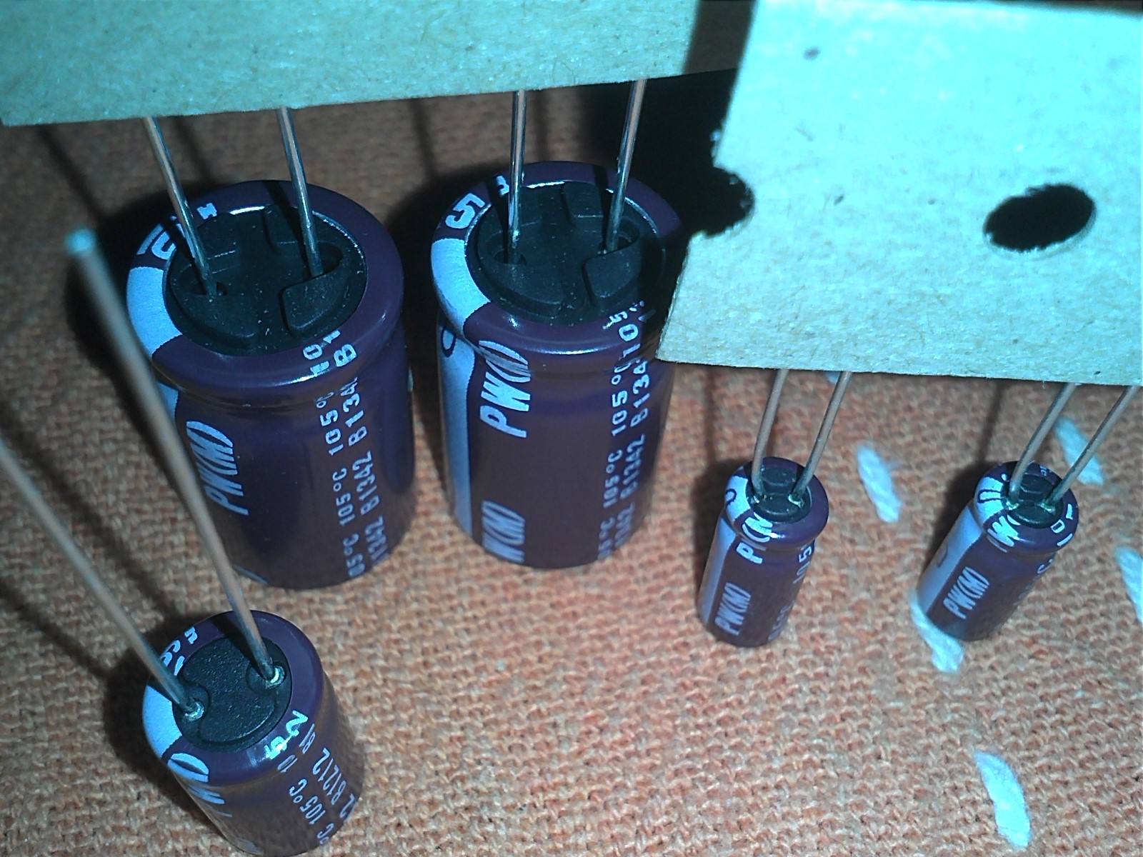

    I bought some Nichicon capacitor for a recapping project.
    I found that these capacitor , even if they are all from the same series (PW) , have different rubber seal.

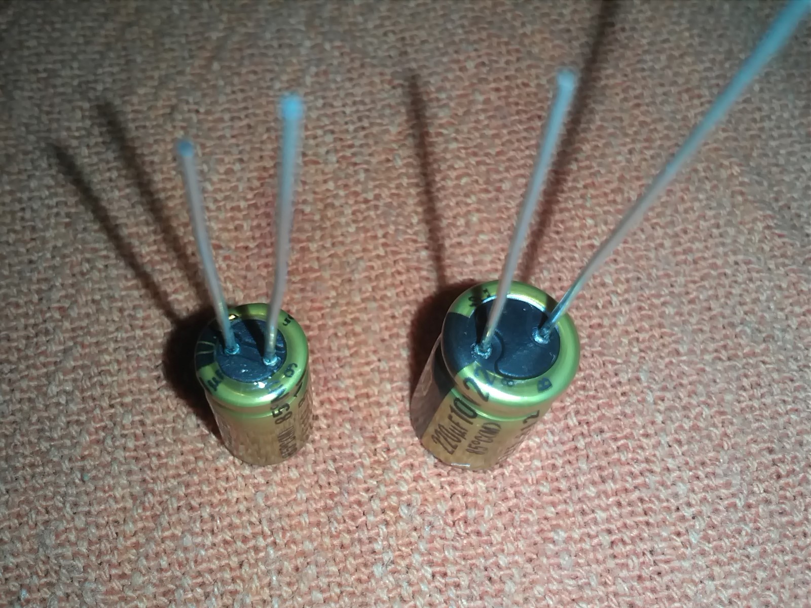

    I have a couple of Nichicon gold tune too , with different rubber seal.
    see the photos:
    For the PW series
    For the Gold Tune
    I just want to know if this is normal?

    Where did you buy the capacitors from? If eBay, most likely some, or all of them, are fakes.

      Thanks for the quick reply , they all come from Mouser.com.

        They shouldn't be fake.
        I haven't used Nichicon caps as large as the two largest, but the rest look correct.
        • mockingbird
          • Dec 2008
          • 5484
          Re: Nichicon PW series rubber seal variant
          They may be from within the same series, but they are different sizes, so that is quite normal...

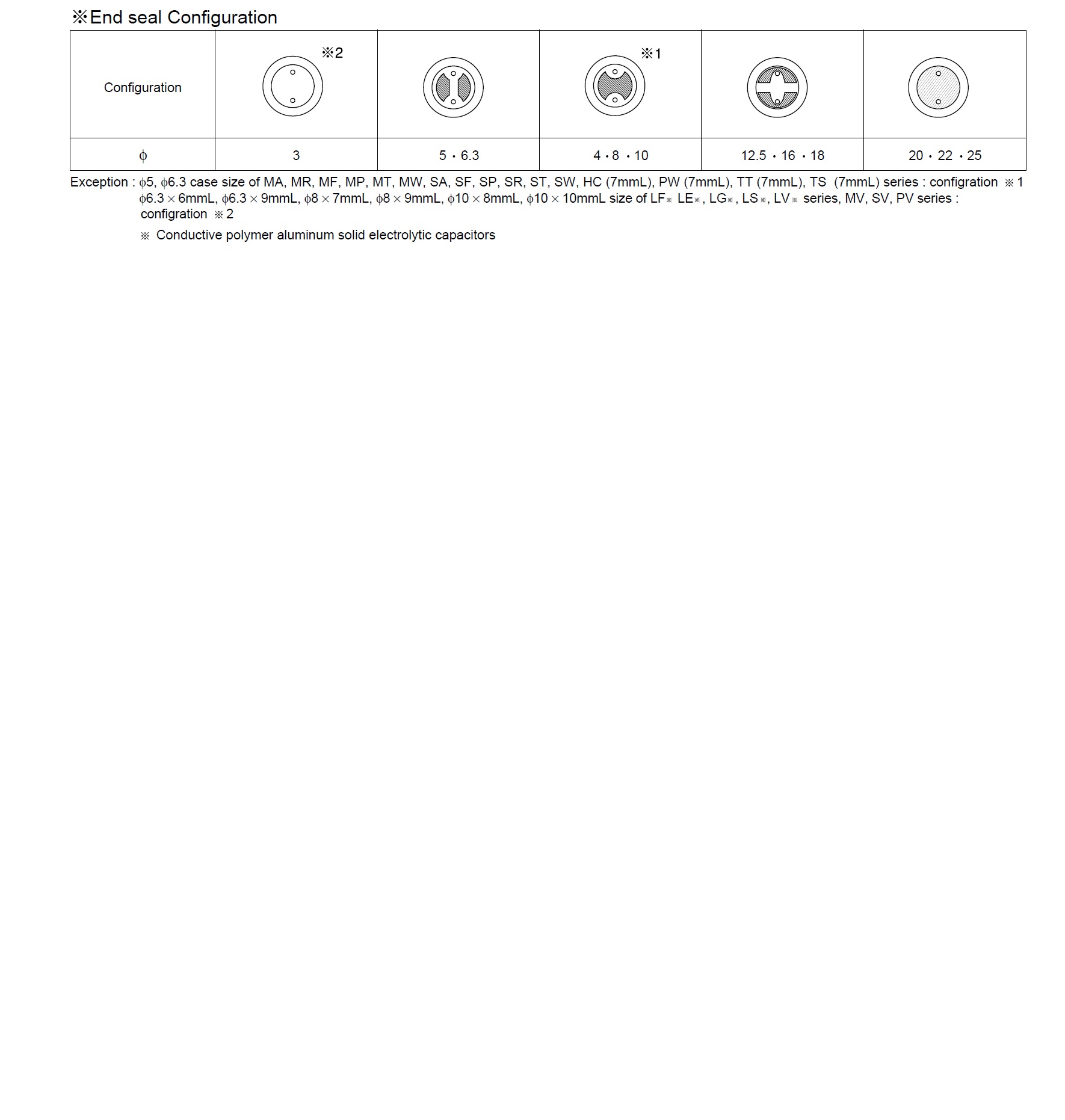

              I have sent some pictures directly to Nichicon because they told me to , after explained the difference i found on the rubber seal .
              i will keep you update .

                hey guys ,
                Nichicon sent me a very useful document, this document show that for different nichicon capacitor size , they have different rubber seal .
                So nothing to worry about it, this is normal, hope this will be useful for all nichicon users .

                  Exactly the same thing you were told in this thread...
                      Yes, but with this document you can see if the bung shape is correct for the size, or possibly a fake...
