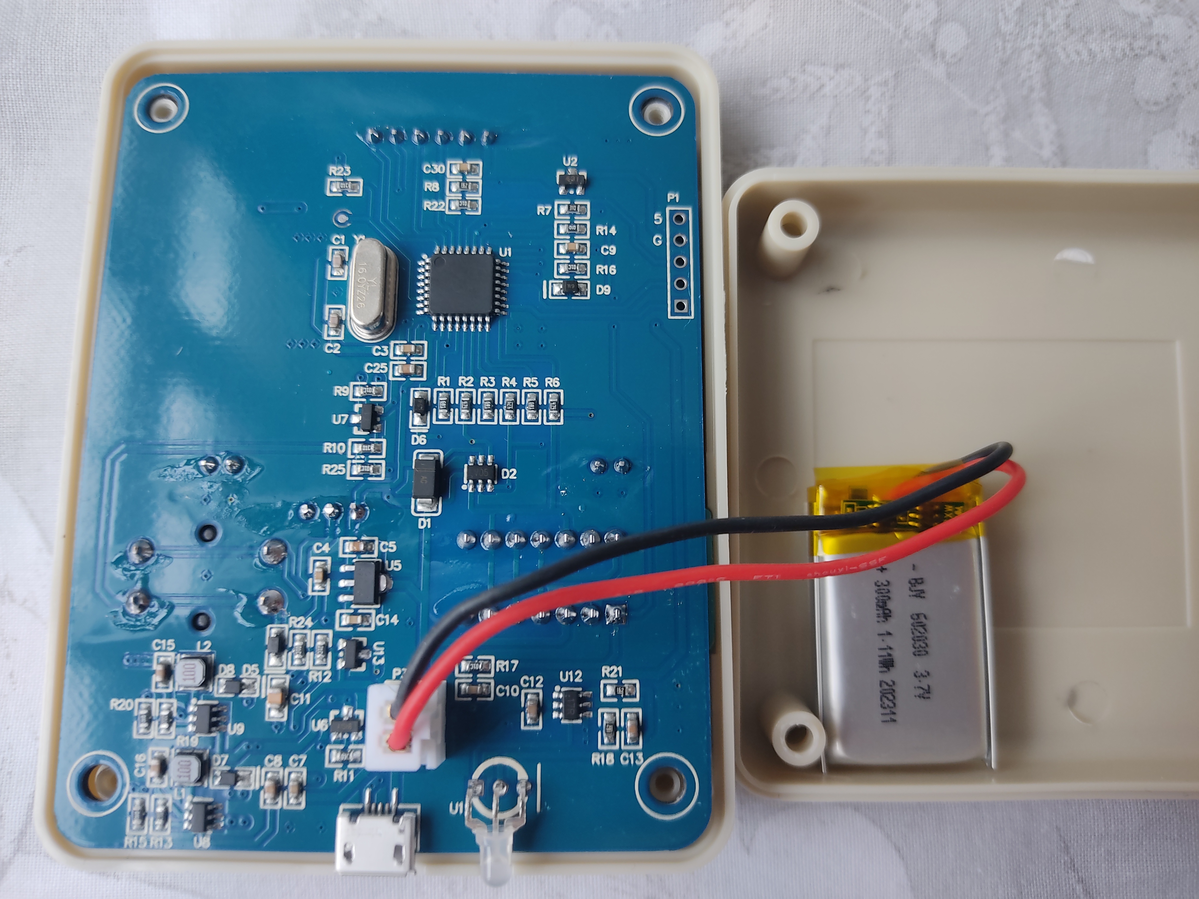

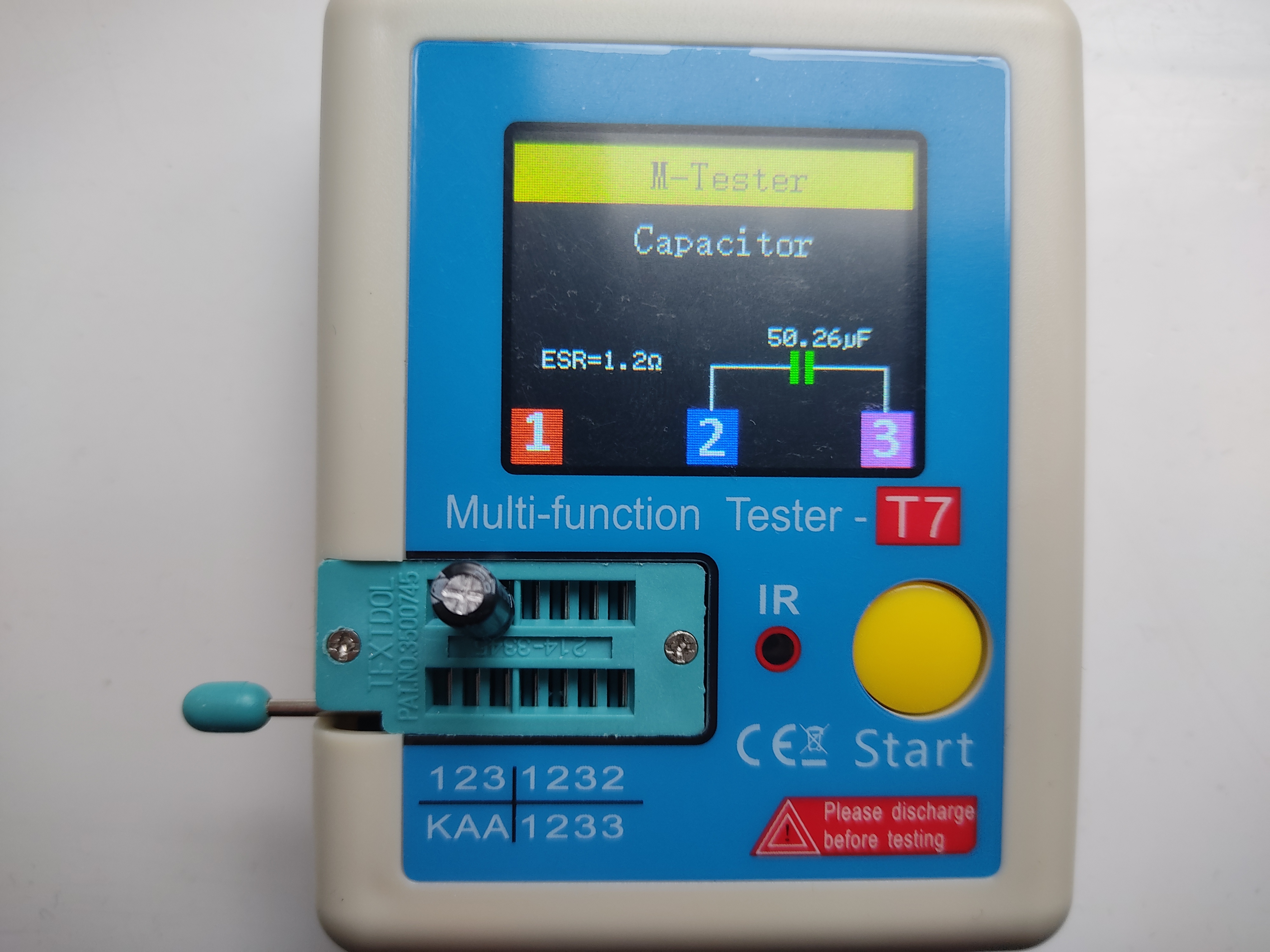

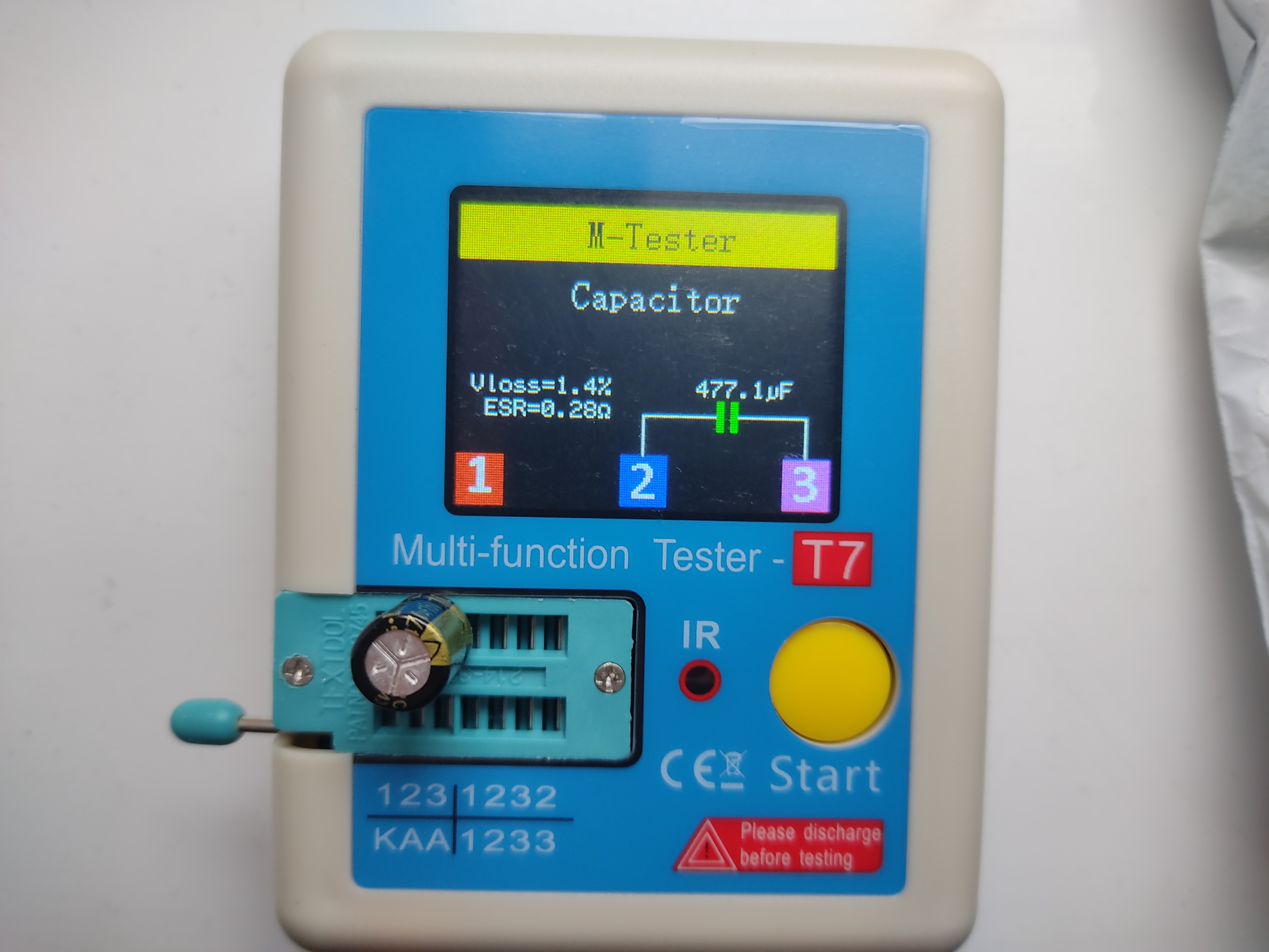

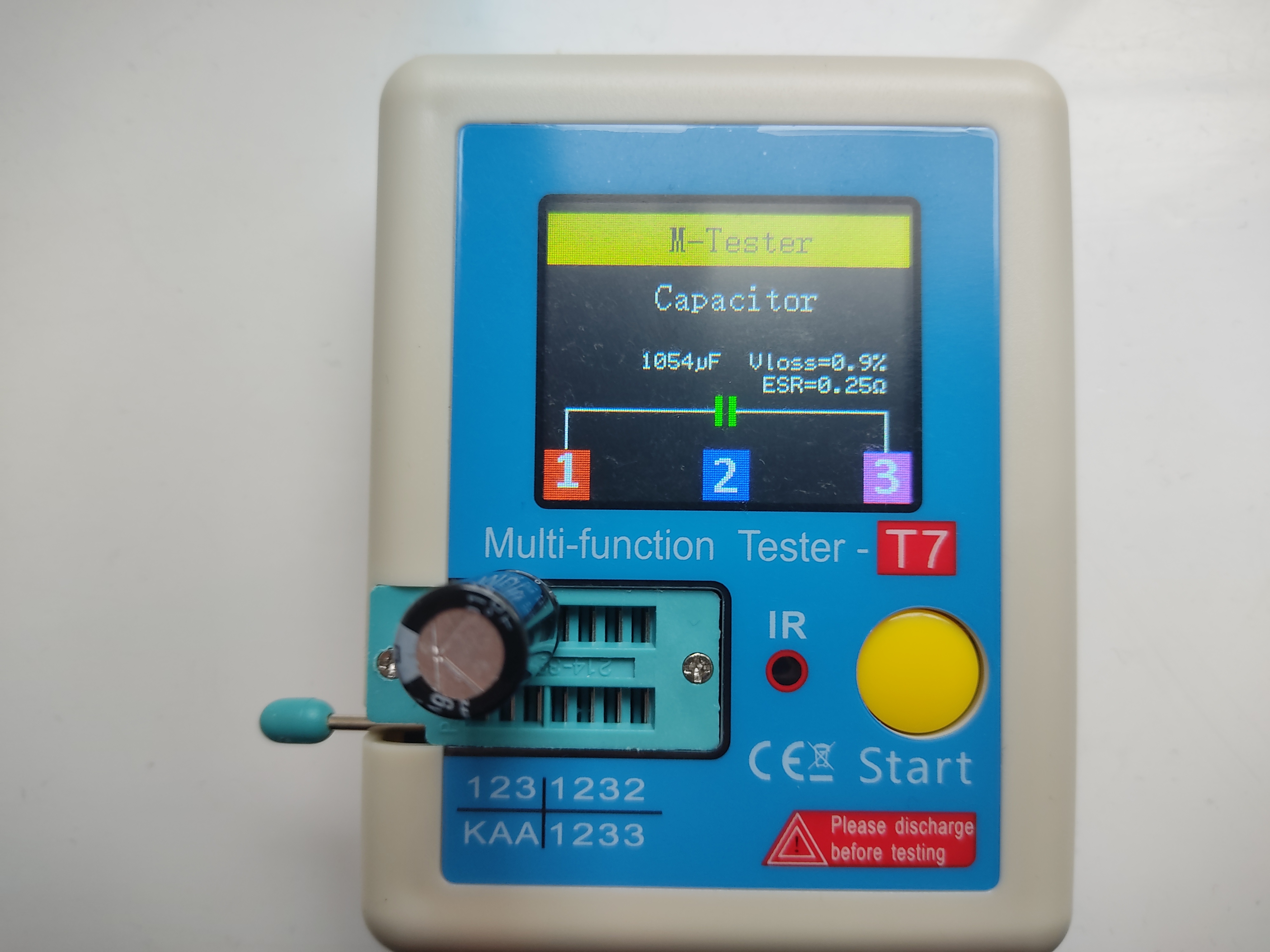

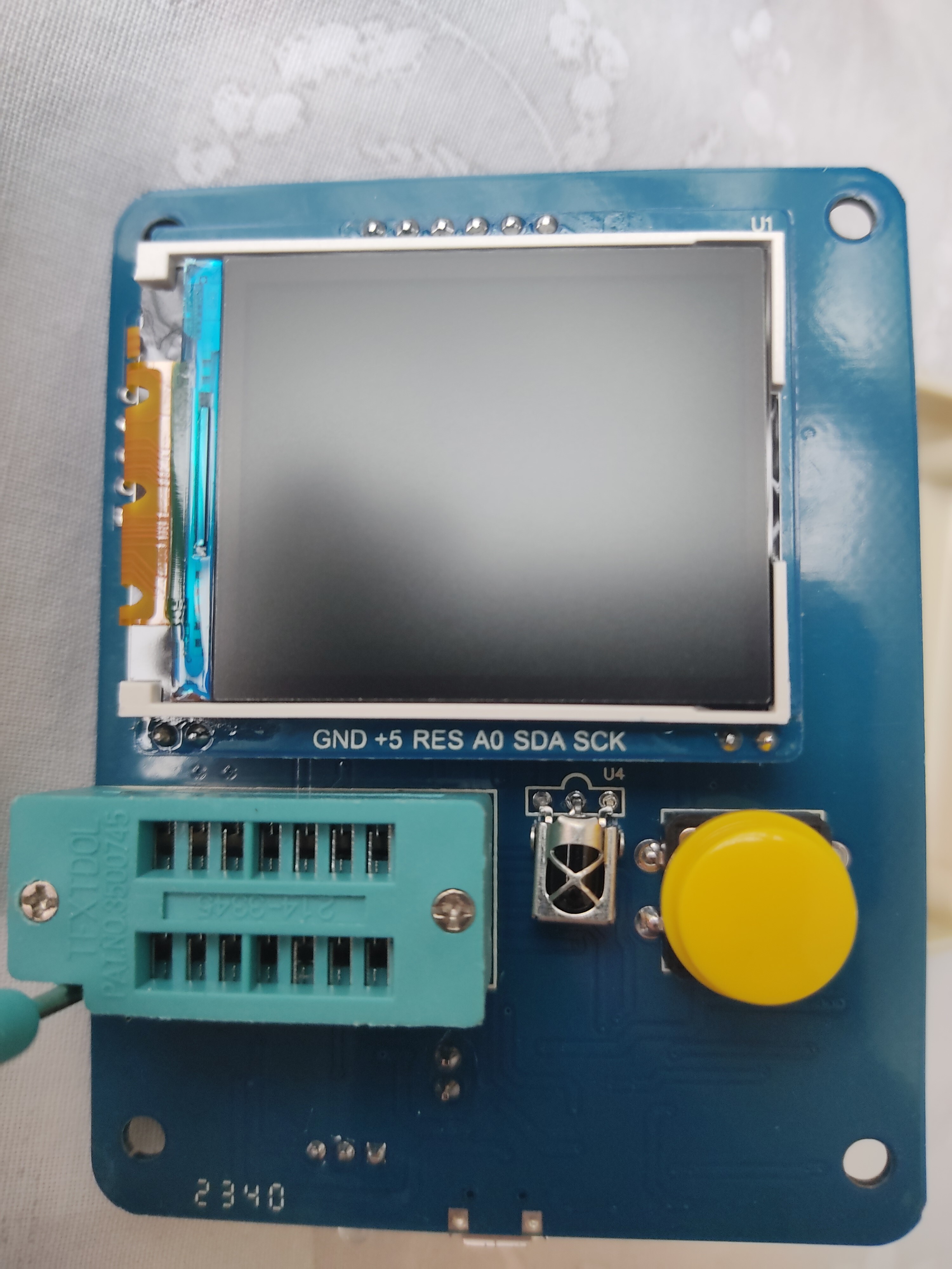

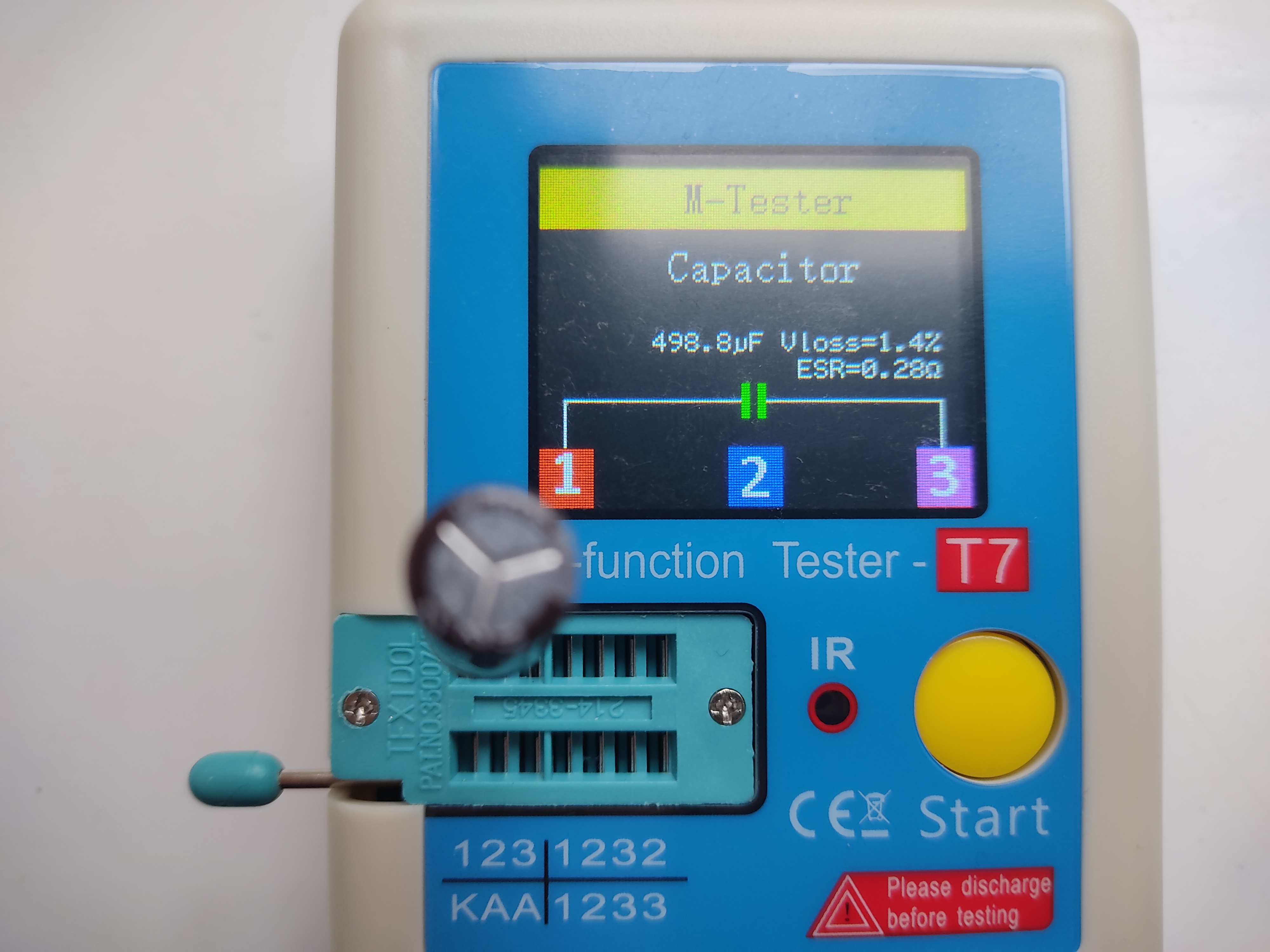

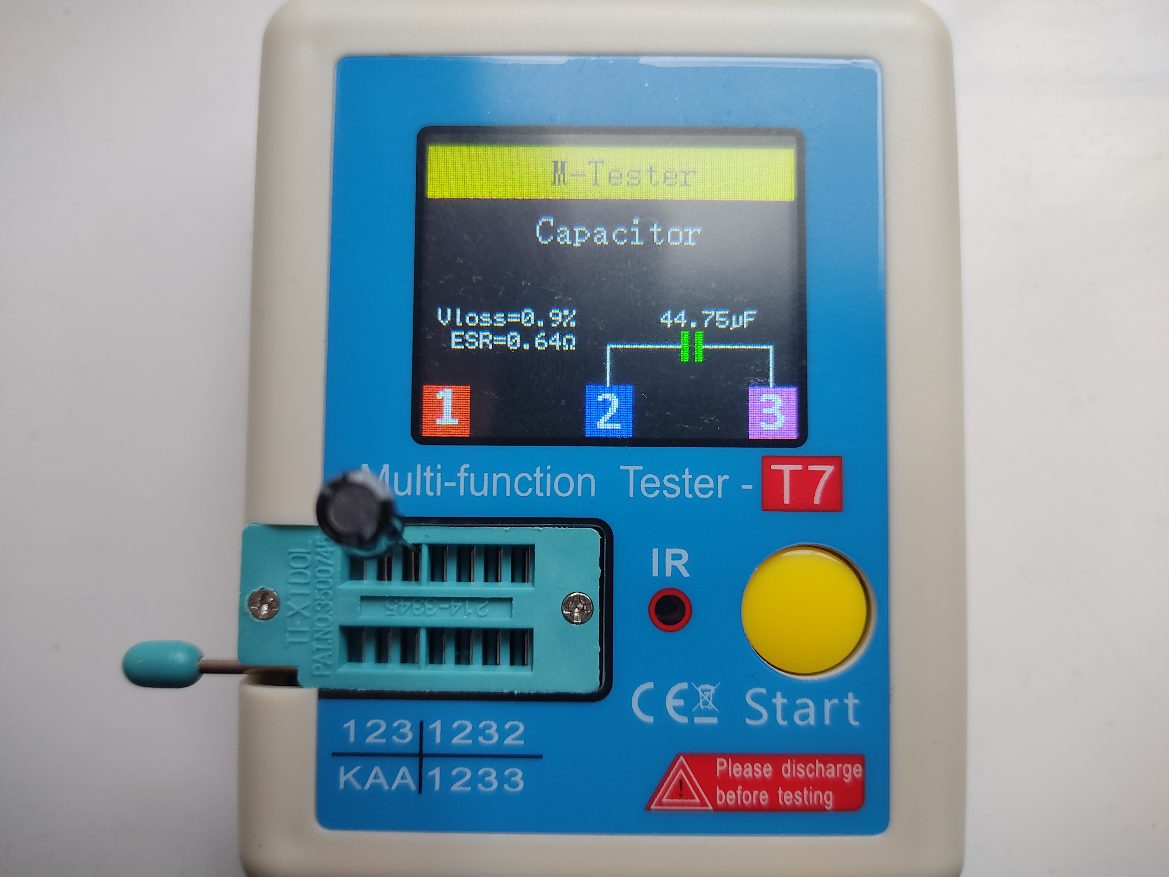

        its arrived, very slick looking device, tested 2 old caps i had and 3 new caps. shows esr which is what i was after. nice screen on this. iv taken some pics of the inside. main chip doesnt have any markings on it, a crystal oscillator is present. the battery is 300mah uses a jst xh connector and wires are silicone around 22awg. plenty of room inside for bigger battery or other mods but for my usage it should do fine as stock. came pre-charged so i didnt need to plug it in yet.
        the kit it came with had some hook leads and one led, one capacitor and 3 what s look like dupont pins on a rail.
        firmware is 3.12k
        for the price around £10 inc delivery from aliexpress i cant complain.
        check the pics attached.
        what are your thoughts?
        also to add, i dont see any sort of lithium charge controller on the board, does this thing just pump power into the battery and rely on the battery's protection board cutting off the power when full?
            It looks pretty nice, it probably is a LGT8F328 since the markings have been removed, hate that the Chinese muppets do that!

              i dont see any charge controller chip on the mainboard, i was expecting something like maybe a tp4056, i may have to disconnect the battery and then plug it in on charge and check voltage at the battery terminals on the board and see how high it gets.
                firmware is 3.12k
                The protection board is integrated in the battery. Look at the picture.
                  Yep the battery has its own protection board, was asking if the device itself had some sort of charge controller or if it just relied on the battery protection board cutting charge once it's at its limit.
                    • 31256
                    #29
                    rub the chip with IPA,
                    often they dont grind them - they paint them with ink
                    • slybunda
                      • Feb 2012
                      • 139
                      #30
                      Man thats some sly tactics painting over chips.
