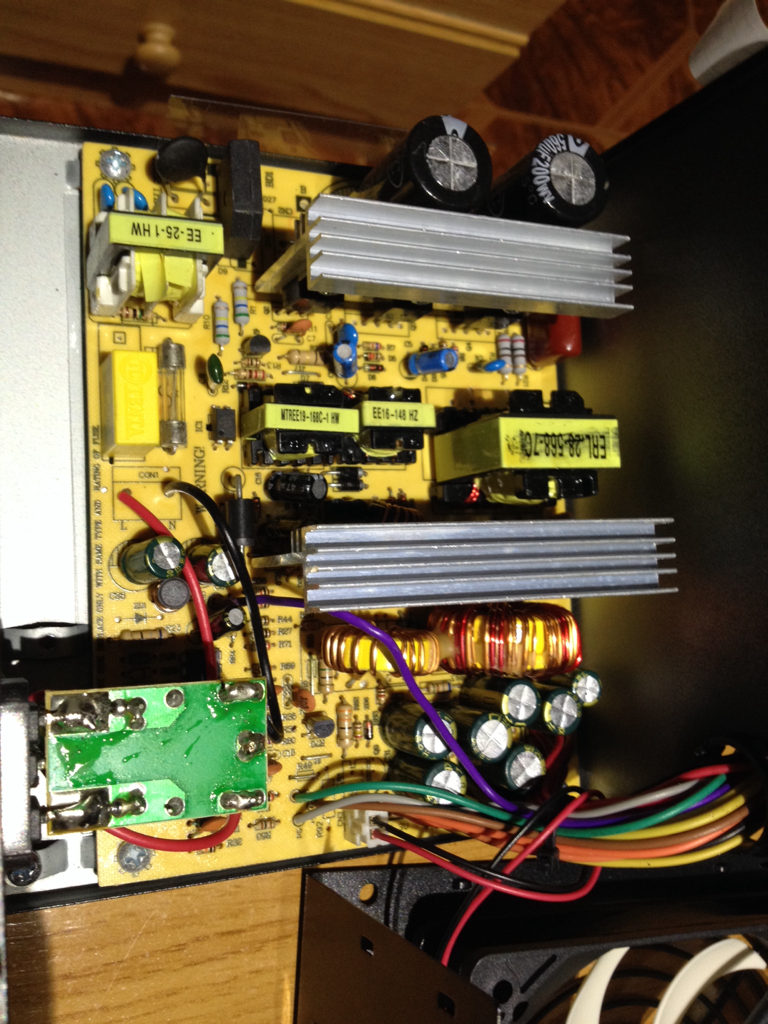

This is bad caps ?

    Re: This is bad caps ?
    That's not one of the good brands, but they're not visibly failed.
      I wanted to replace them with better, which should I buy? a greeting friends and thank you very much

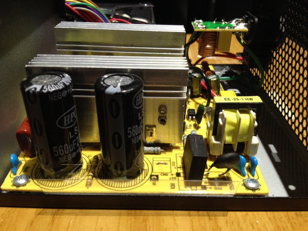

        What's the supposed power rating on that? Based on the heatsinks, I'd guess ~250w; based on the main transformer, I'd guess 200W. But I think 560uF input capacitors would suggest 300W-350W. I would recommend using whatever snap-in large can 105C series from Nichicon, Nippon (or United) Chemicon, Panasonic or Rubycon is available to you. Match the can size voltage rating and capacity (higher, e.g. 680uF, is OK).
          If you're running an old Pentium III then sure, why not? At least it should last longer.
          But you aren't going to run the latest Core i7 or Phenom II rig on it. If that is your intention, then spend the money on a better PSU.
            Big caps like that are expensive. Not worth changing - at least not for this power supply.
            I see the ones currently in there are rated for 560 uF. Probably fake ratings and close to 330 to 470 uF. That's still plenty for this gutless PSU, which is again why it's not worth changing them.
            If you really really want to improve it, change the caps on the secondary side with known good brands (Panasonic, Rubycon, Nichicon, or Chemicon) and replace the output diode rectifiers for bigger ones - this will improve the efficiency. If you do decide to change the caps, AVOID buying from eBay!!! Way too many fake caps on there.
            Other than that, don't bother doing anything else to it. Waste of time and money... unless you have all of the parts already and time is not an issue.
            This PSU would be okay for an old Pentium II or Pentium 3 -type of computer. But anything newer - forget it.
                All the other caps look like ChengX. aka garbage. The thing that truly makes that thing suck is the 28 transformer. If I was you, I would scrap it. Regarding the bulk caps, HEC (Guessing HPC is the same, they look soooo similar) is pretty inconsistent. I've seen quite a few input caps by them, seen 470's that read ~330, and some that read well within 5%. I've measured some of their 680uF and 820uF input caps and they were spot on. I would keep them if you are going to scrap it
