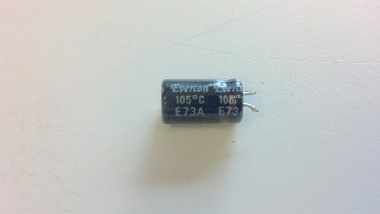

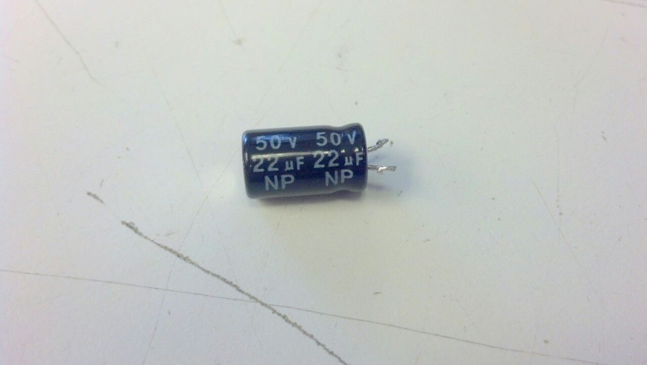

    Capacitor with no negative lead stripe
    Maybe I've just been more observant lately but this is the first time I can recall not seeing a negative stripe or indication of the negative lead on the capacitor. It's an Evercon off of an old US Robotics 56K modem. So of course its capacitance is in spec it didn't have to do much but the ESR is 0.70Ω
    It doesn't look like a mistake because a negative stripe on either side would overlap some of the other printing
    Am I missing something?

    Re: Capacitor with no negative lead stripe
    It's a bipolar electrolytic cap.
    The "NP" on it means "Non Polar".
      Thank you. I thought NP was the series of the capacitor
        Of course bipolar. However Evercon is a known bad cap also...
