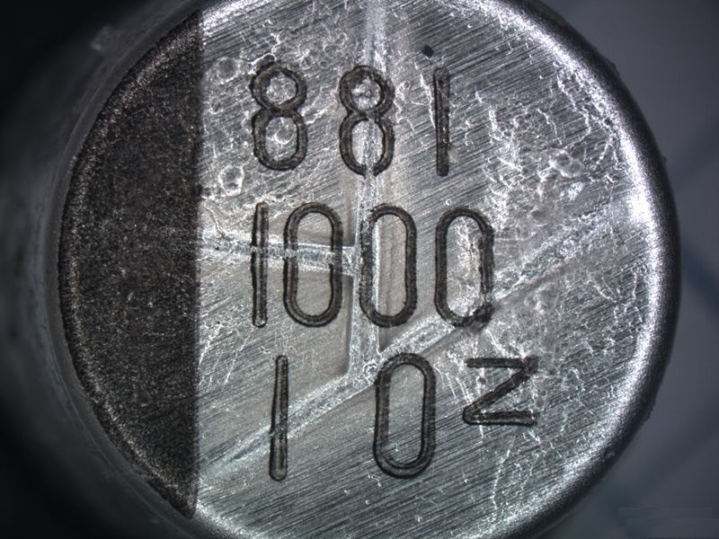

Can you help identify this cap?
  • MNTodd
    • Mar 2013
    Can you help identify this cap?
    Hi everyone. I'm new here and really glad to find this forum. I'm wondering if anyone can help identify this cap for me. I'm thinking Sanyo based on what I have seen from the vent configuration, but I know there are a lot of counterfeit parts out there. Any help greatly appreciated.
  • selldoor
    Slow Learner
    • Dec 2010
    • 7870
    Re: Can you help identify this cap?
    Anything on the sides /base is it through the hole or is it smd.
    What is it off? did you buy it on ebay? - link?
    • euromatlox
      • Mar 2013
      • 60
      • Finland
      Re: Can you help identify this cap?
      Please tell us if it's from a PC motherboard, and what size is it. There are also other components which might sometimes look like capacitors, inductors/coils for instance.
      In case of PC motherboard, it's probably 880uF 10V capacitor, perhaps 1000 hours, z is some kind of code for tolerance. You should be able to figure out if 10V or 1000V is closer the truth, don't use a 10V capacitor in a 1000V circuit (applies vice versa too).
      In PC motherboard very likely 820uF or 1000uF would do instead.
      • kc8adu
        • Nov 2003
        • 8832
        • U.S.A!
        Re: Can you help identify this cap?
        its a 1000mfd 10v cap.not much more to tell from the pic.
        • surferbum
          • Jun 2013
          • 69
          Re: Can you help identify this cap?
          I would agree with Kc 1000uF 10v .... but im a newbie ..
          I have a smd cap on my LG plasma TV board which looked like it had leaked which says:
          Y1352
          100
          16F
          I presume that this was a 100uF 16 volt and F is the tolerance
          Still not fixed my tv yet though ??
          • Duncanbest
            • Jul 2012
            • 81
            • Taiwan
            Re: Can you help identify this cap?
            NIC NACZ series
            http://www.futureelectronics.com/en/...10.5TR13F.aspx
            https://cdn.badcaps-static.com/pdfs/...8802052444.pdf
            • thesame
              DVR HIKVISION DS-7208HWI-E1/A BOARD DS-80104 REV 2.2 help identify burnt components
              by thesame
              Hy guys , i have a DVR board DS-80104 REV 2.2 that was powered wrong, i have some smds on the board that are blown and i can't identify them , maybe if someone has this board somehow and we can identify the smds', i have searched online and i can't find a schematic.
              The smds are SOT-23-6 , one of them i think it has the marking ADJF since i found another one on the board with this marking , but the other one it seems that it starts with AG or it looks like. I would really apreciate if someone could help me identify those IC's .
              02-27-2024, 04:31 AM
            • silver60618
              Lenovo Legion 7 - Help Identify IC
              by silver60618
              Hi gang, its a long shot, but working on Lenovo Legion Pro 7 motherboard NM-F091, and trying to identify this component near GPU with marking "eHFQH" that is burned and shorting the board. Looks like power management IC
              I couldnt find any schematic or boardview. The CPU side also has same chip. Any way to identify this chip? or take measurements from the good chip to determine what it is?
              Any help would be appreciated...
              07-02-2025, 12:16 PM
            • chth96
              How can I identify varistor which have been blew up?
              by chth96
              I mistakely pluged 100v japanese retro game console to 220v outlet.
              So It seems that glass fuse and varistor have been blew up.
              I can identify that voltage and ampere value of glass fuse(250V LF 1.6A),but It is impossible to identify varistor type in my sega saturn PSU(YAMAHA 35M07U XR258)
              Is there any way to identify varistor type in my sega saturn PSU?
              Any reply would be appreciated.
              EDIT:
              It seems that I finally found out what type this black varistor is. It is Panasonic ERZV05D221 “ZNR” Transient/Surge Absorbers (Type D) Varistor Voltage...
              11-26-2023, 08:52 AM
            • freakorio
              Need Help To Identify Component on Ymain LJ41-05120A
              by freakorio
              Hi guys , i hope this is the right place , i got Plasma Samsung PS-50Q91H and i need to repair Ymain LJ41-05120A , but those component are burn and i can not identify to replace those part , and the part are blue capacitor and the location are C5105 and C5106 and here i attach the part that need to identify , and one more thing , i also need to replace Zener Diode on location ZD5502 and the part are BZV55C because mine is short but i don't know the voltage because those parts are release with many type of voltage. Looking forward for your kindly reply
              05-21-2024, 02:32 AM
            • baiceanu_stefan
              nm-f251 Schematic, boardview or help identify componente
              by baiceanu_stefan
              Hello, I have a legion pro 5 16arx8 serial number pf4bf4aw mb code nm-f251 rev1.0 which was dissasembled by the client for cleaning. Now it does start but for 20 secs after that fans run at maximum and then shut down. Found PU8302 burned but cannot identify it the part. It is written eHFAA on it but didn't found any info, no boardview, nothing. Can anyone help identify the part so I can order it from somwhere? Ataching some pictures of the motherboard, serial number and part. Than\k you...
              04-24-2024, 12:49 AM
