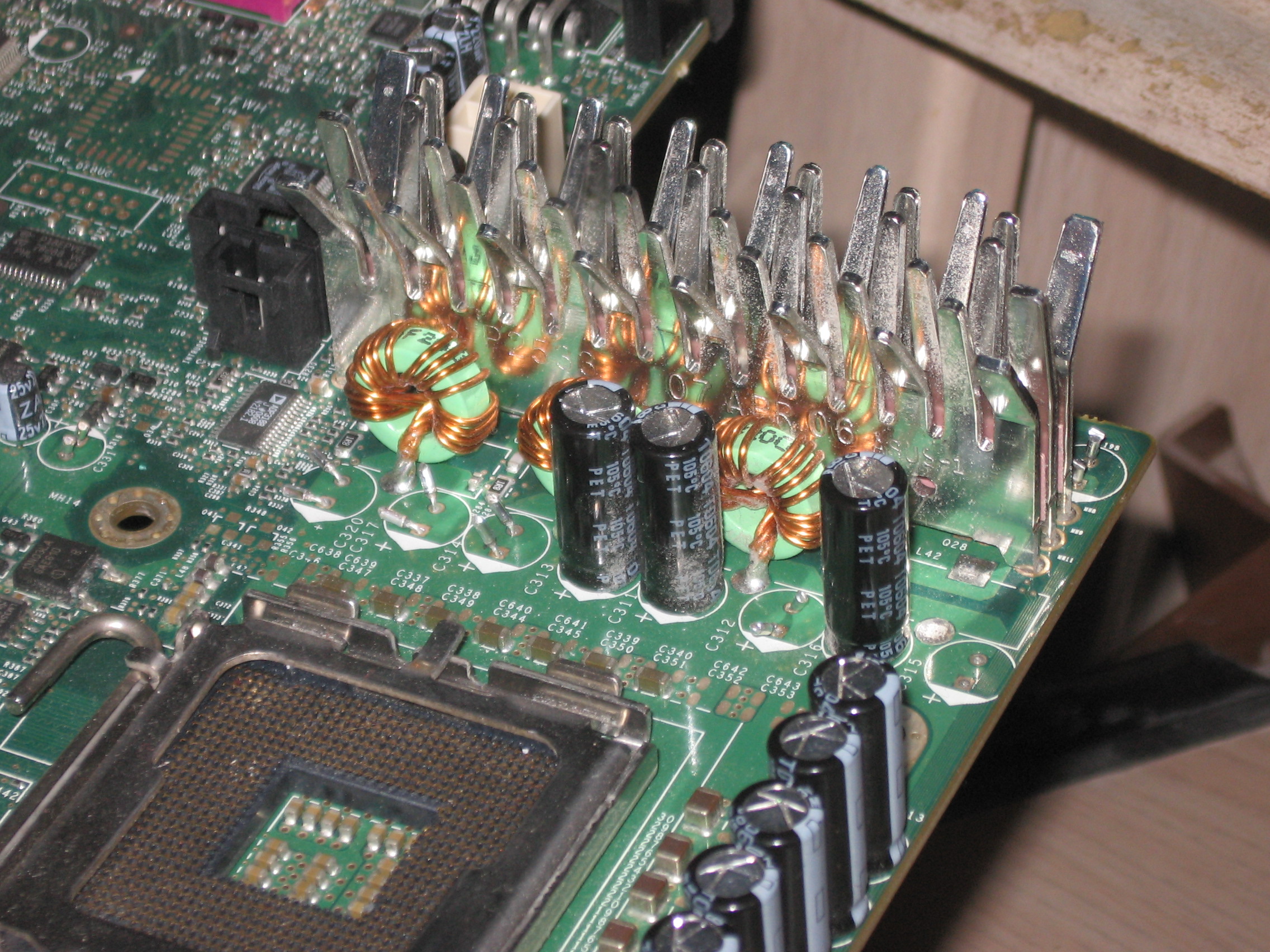

                Absent from the picture are all the KZJ I unceremoniously yanked off with my fingers. :P Also some suspect Ruby MCZ were pulled in the same manner.
                I got this board as a cap donor, little more. It had rubycons as well as some polymer caps of the value I was looking for, so I picked it up.

                  Nice. After you get the board working you should also measure the temperature of those inductor coils.
                  I wouldn't be surprised to see those coils hovering at 40-60c
                  And the caps behind that heatsink... I guess it depends on the case but it could be there's little airflow back there.

                    I have no plans on getting this board working again, I bought it just for the caps. :P
                    I wouldn't doubt, however, that the inductor coils would get searing hot.

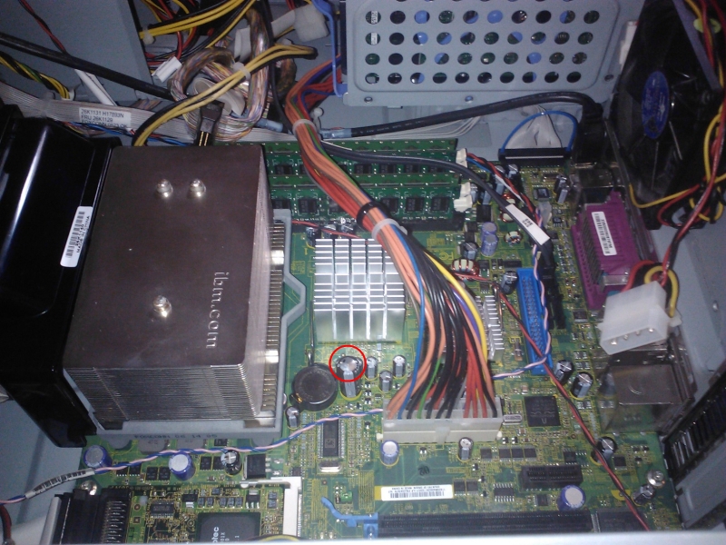

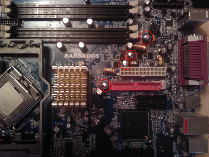

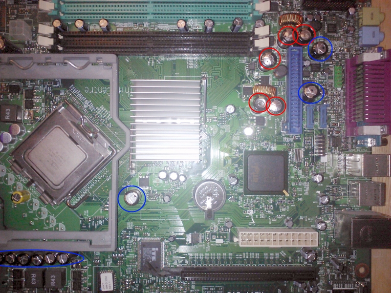

                                    Okay here are the images.
                                    In the first '06 thinkcentre, you'll notice the 1500uF MCZs have blown (it's more difficult to see the burnt electrolyte on the photo). The ones circled in blue show no physical signs of bursting. I've observed a multitude of these same machines with the same MCZs, and ALL of them exhibit exploding 10v @ 1500uF MCZs.
                                    In this '05 thinkcentre, a whole load of the KZGs are slowly dying... being a total of *28*, it'll be a pain to replace.
                                    Finally, in the 2005 intellistation, that one big KZG has shown signs of popping. The other KZGs are fine as I keep this thing cooled *very* well. The rest of the caps are nichicon HM(M), but they obviously must have been from a good batch. Oh, and a handful of oscons.
                                    --> so the conclusion. KZGs seem to pop intermittently, and MCZs seem to be affected by a certain farad range?
                                    Regarding MBZs, all five of those IBM machines contain MBZs and they are PERFECT. I do not have to replace them.
                                    Later *Lenovo* quality thinkcentres may have bad PSUs (I've seen some with bestec): and I did see many Lenovo-made computers with low quality components, including OST and G-Luxon capacitors.
                                    All of these machines in question are pre-2007.
