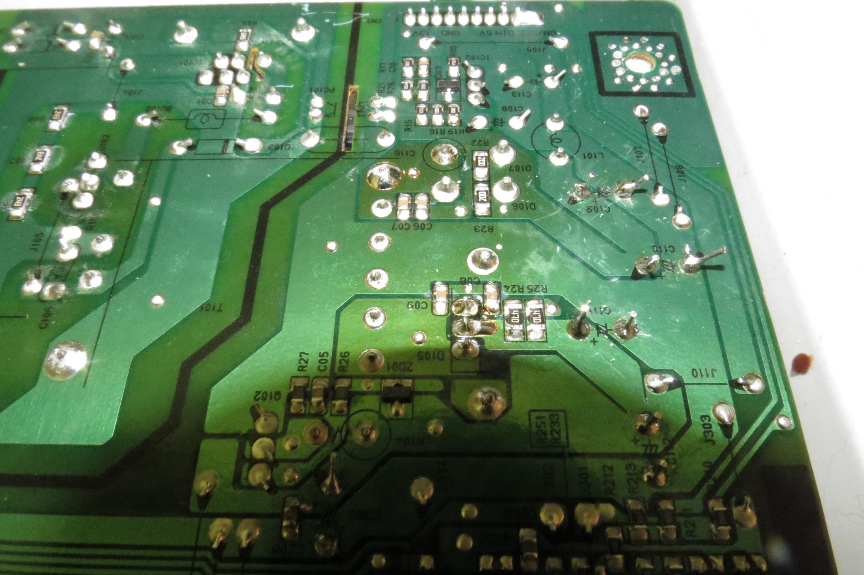

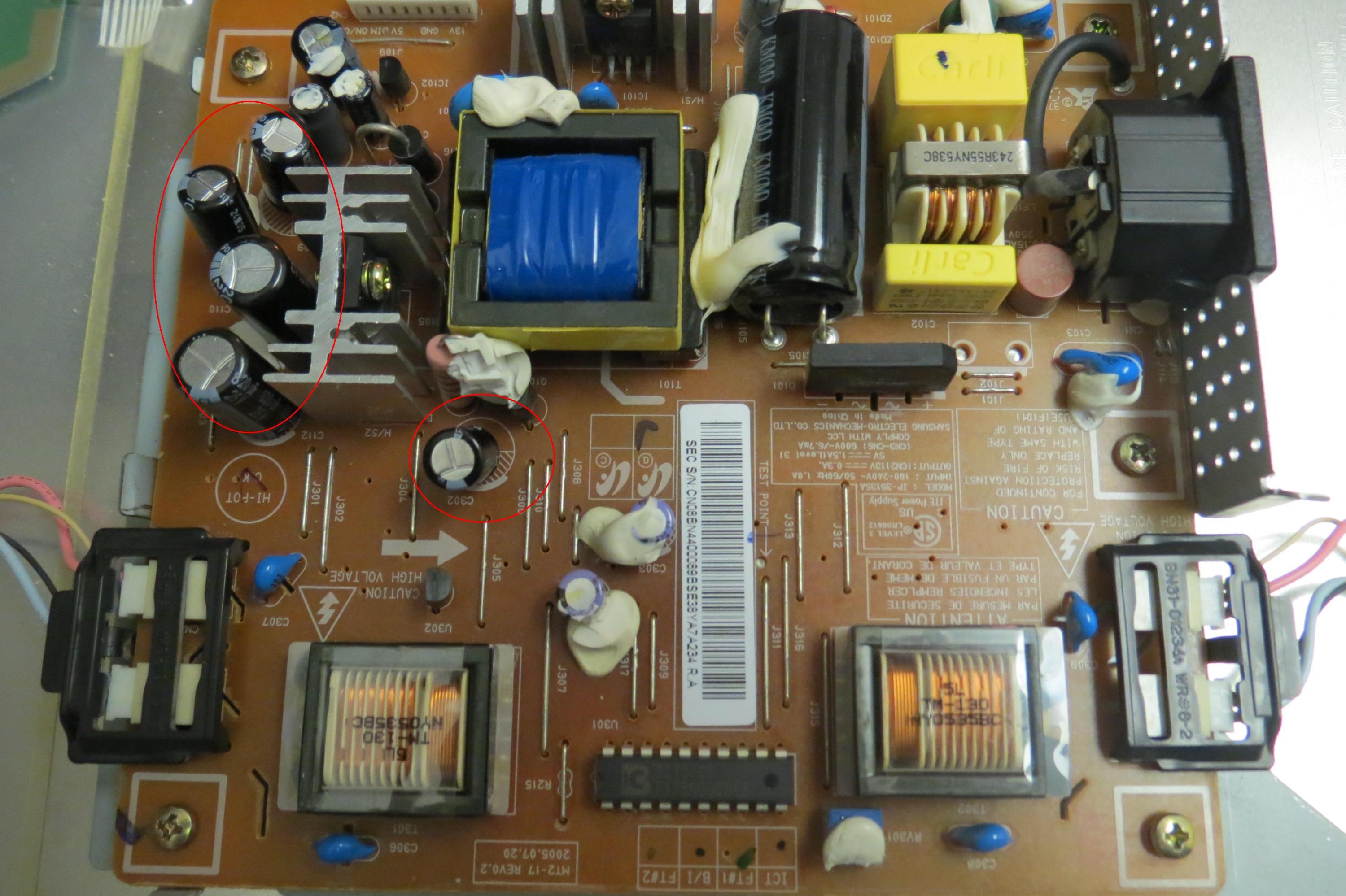

    Hey all, I've been coming across this site's forum while trying to solve this problem and I've hit a dead-end, it seems.
    I have a Syncmaster 914v, manufacture date Oct '05, that I've used for over six years now and has finally developed an issue.
    I turned my monitor on one morning and it began blacking out for a few seconds at a time, similar to how it would if it were changing resolution. It started out several seconds apart and lasted under a second each time, but over the course of 30 seconds or so, it blacked out with increasing frequency until the picture ceased to return.
    From then on, the power LED would blink on and off, and each time it turns on there is a very faint, high-pitched whine before it blinks off and repeats the process. I quickly ruled out any computer/cord issues by using another monitor.
    I searched on the issue a bit and read that Samsung tends to use cheap capacitors, so I opened it up and saw that the two 820uF, 25v caps were slightly swollen on top.
    Following instructions for a similar issue, albeit with a different monitor, I replaced the following caps on the inverter board:
    2x Samxon 820uF 25v
    with: http://www.digikey.com/product-detai...423-ND/2433557
    2x CapXon 1000uF 10v
    with: http://www.digikey.com/product-detai...7CT-ND/3072197
    1x Samxon 330uF 25v
    with: http://www.digikey.com/product-detai...7CT-ND/3072237
    Closed it up, hooked it up and powered it on, and it's behaving identically to before I replaced the caps.

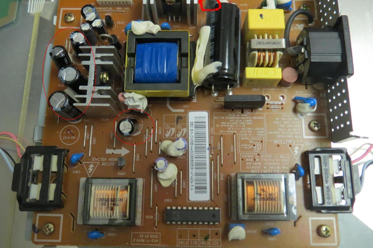

    I've circled the replaced caps in the attached image in red.
    There are still some on the board I haven't replaced, aside from the large one. They are:
    1x 330uF 10v
    1x 47uF 50v
    1x 10uF 50v
    2x 33uF 25v
    Should I go ahead and swap out the rest of them, or is there possibly some underlying culprit I should be looking for? I'm trying to track down a friend with a multimeter, money's tight and I'm ashamed to say I don't own one right now.

    I can only think of two issues for this:
    Either the power supply start-up capacitor has gone bad (the start-up capacitor is usually a small 10 to 47uF 25 to 50 V rated cap)
    *or*
    The inverter transistors have gone short circuit, causing the power supply to shut down and keep restarting.
    Since you don't have a multimeter, I would recommend that you replace those other electrolytic capacitors (the big electrolytic capacitor can be left alone, though). However, if that doesn't fix the problem, then you would need a multimeter to troubleshoot the issue. There are a lot of very cheap (under $10) multimeters on ebay. The cheap Chinese ones aren't that great and many members here will discourage you from getting them, including myself. However, if you have no other options, they should be fine for the job.
    Also, if possible, can you post a picture of the other side of the power supply board?
    It's possible that bad joints on the inverter transformers (the ones labeled TM-130) may also be part of the problem.

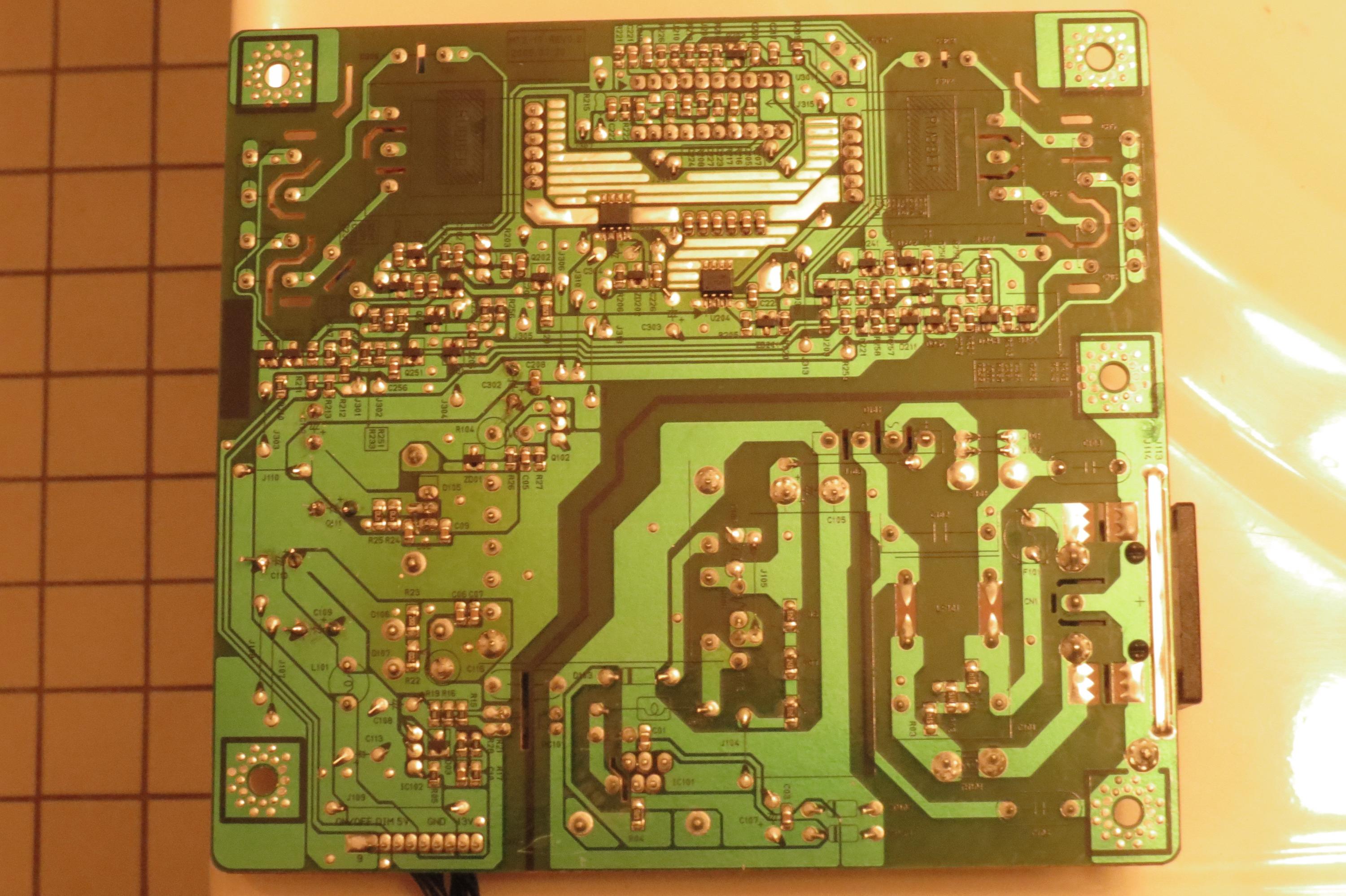

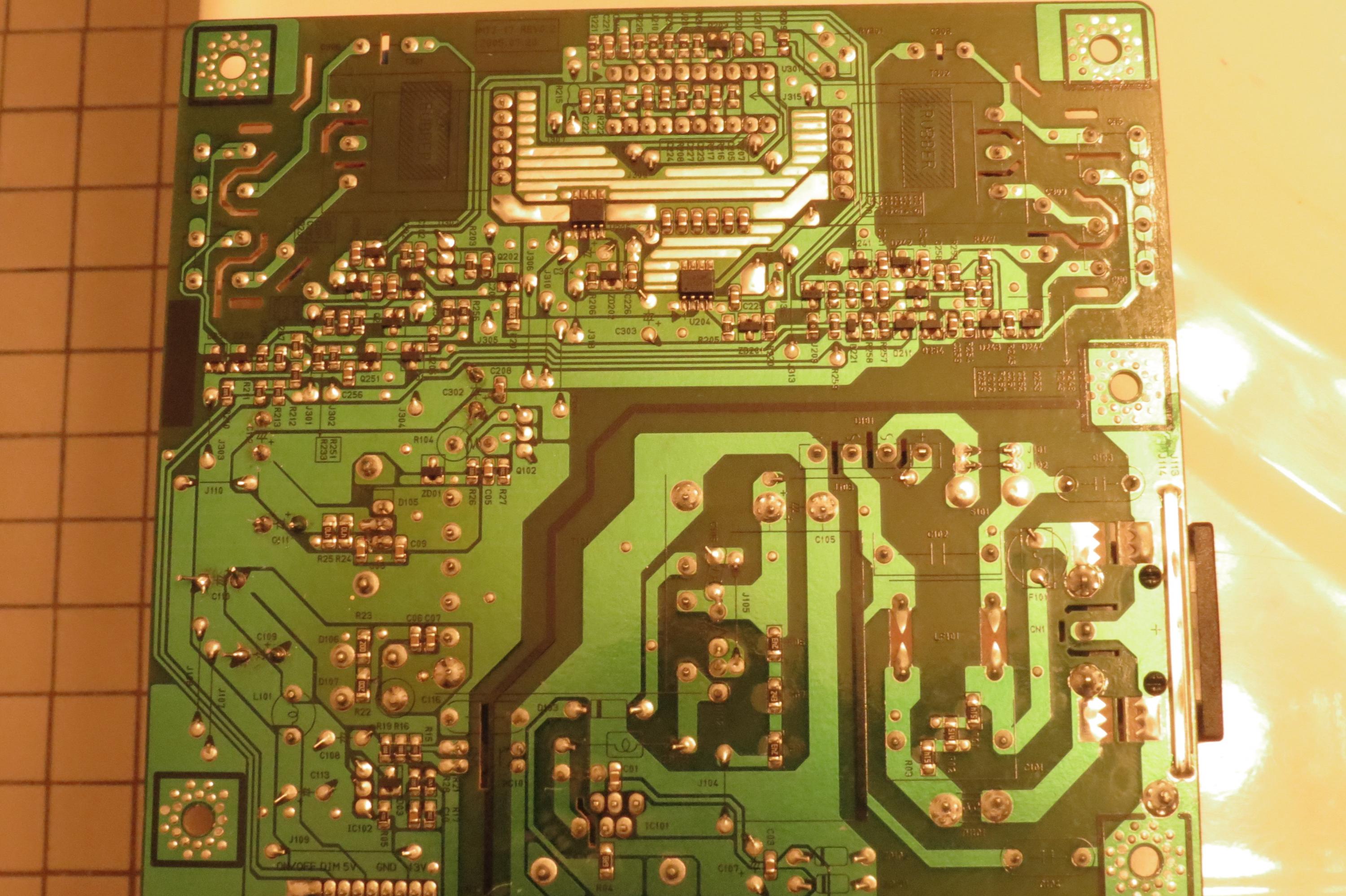

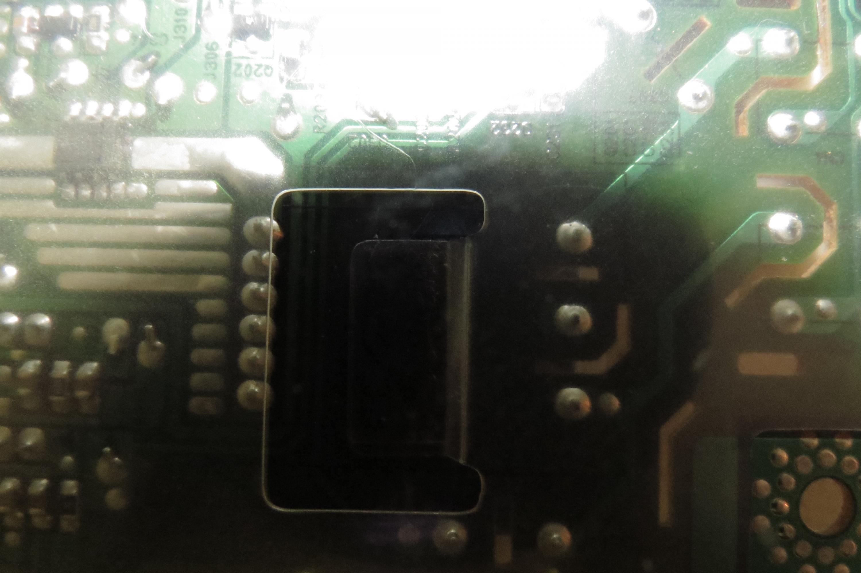

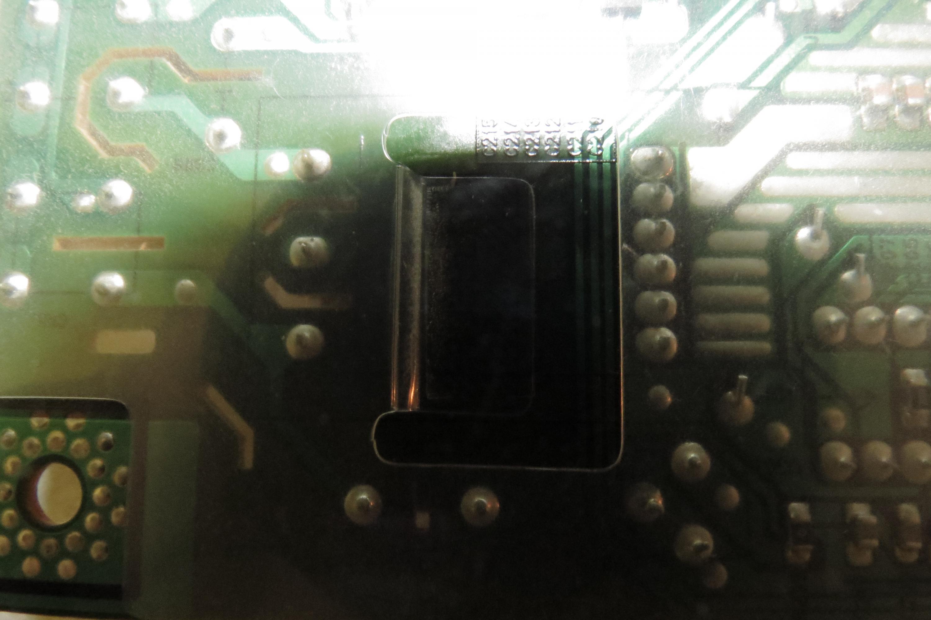

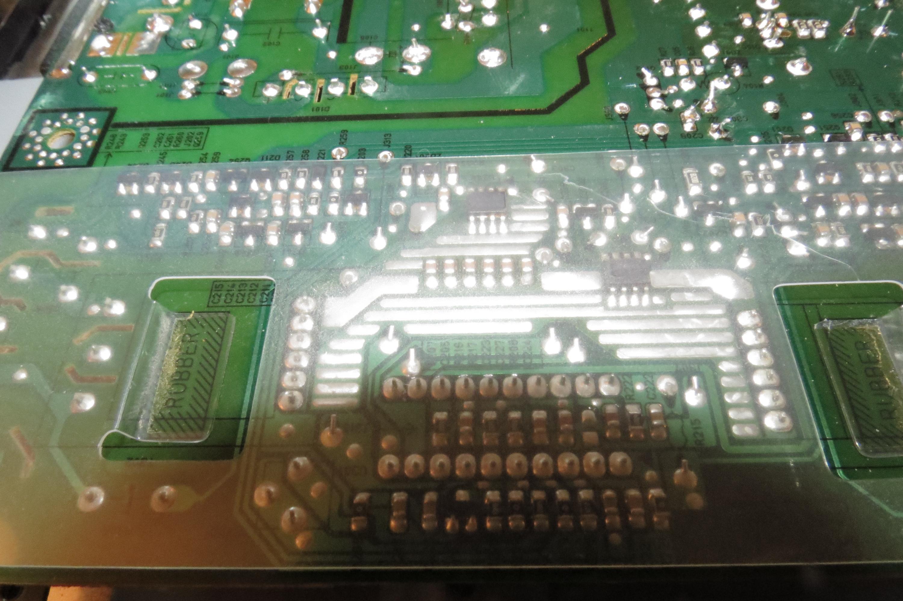

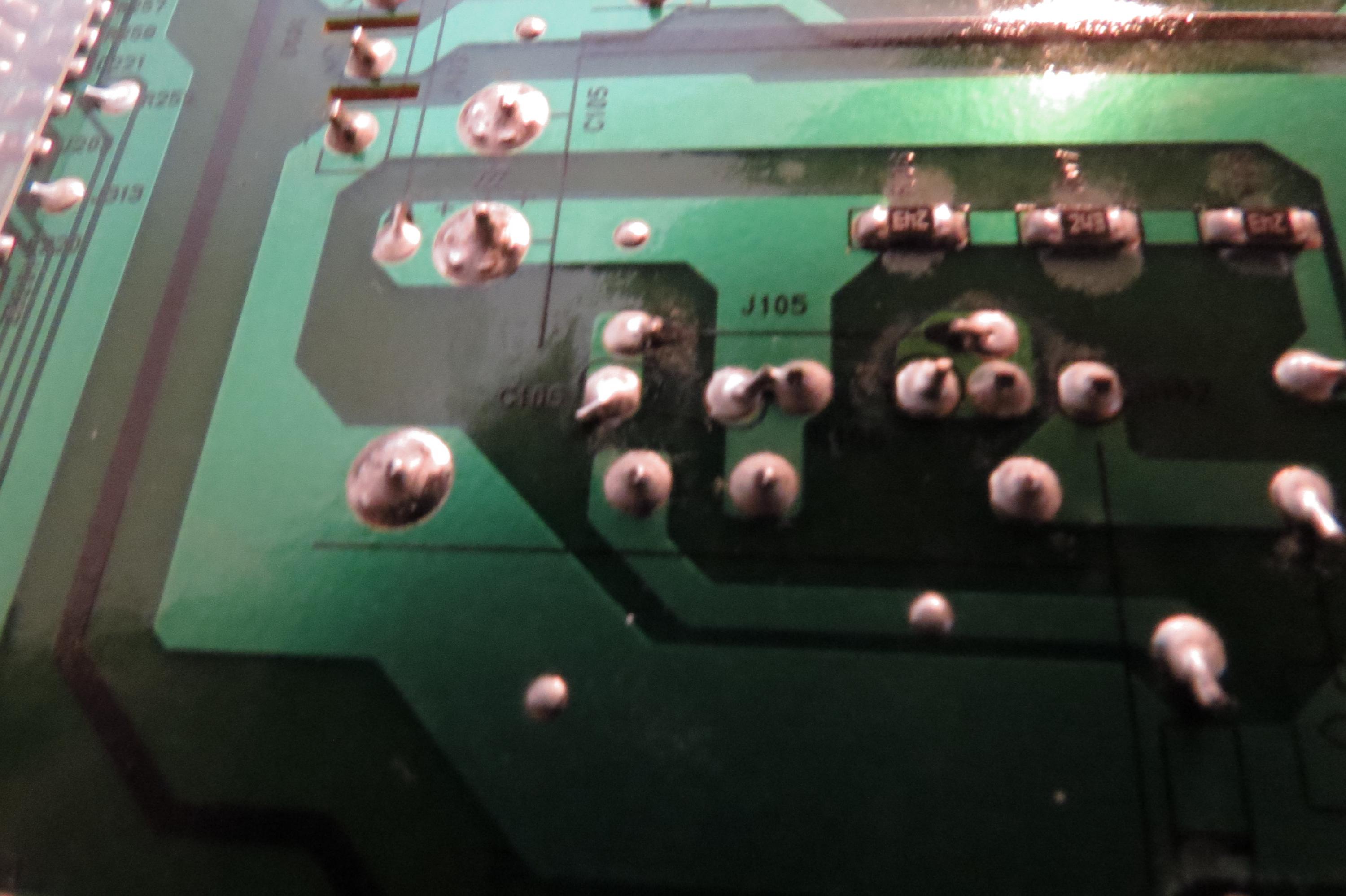

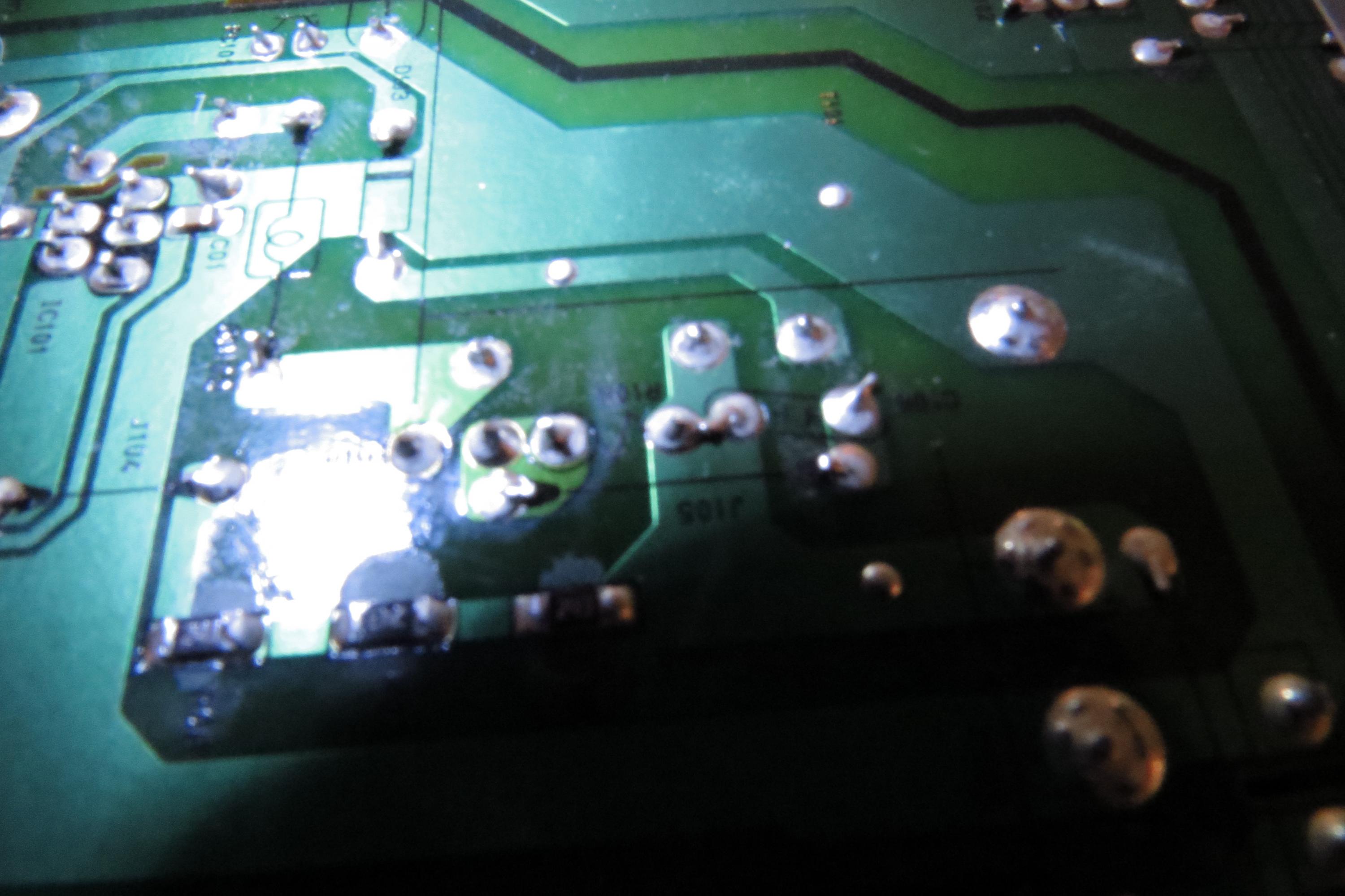

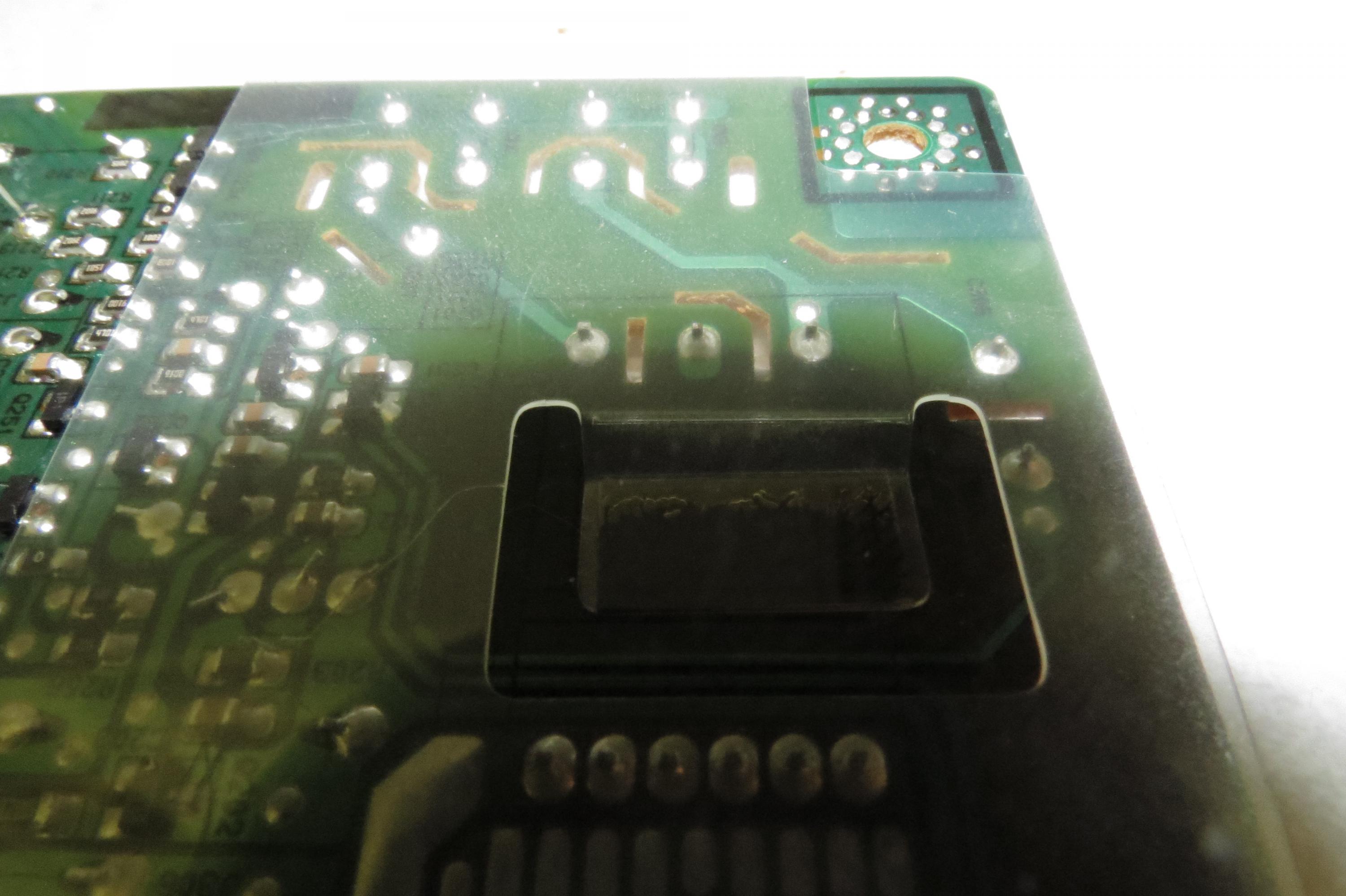

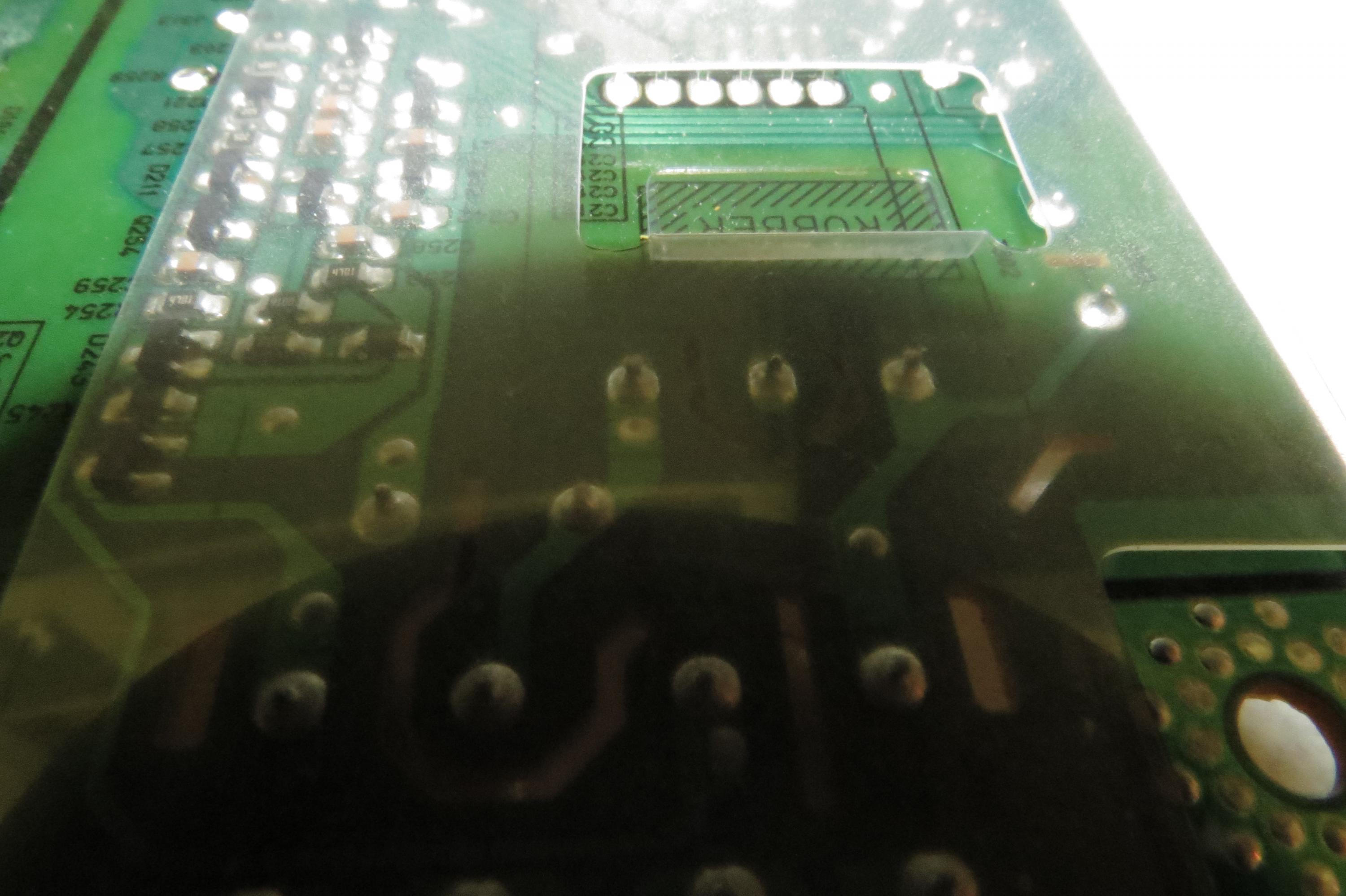

      I tried to get some half-decent shots of the underside of the board, there's a plastic cover adhered to the board underneath the transformers so focus/glare were a bit of a nuisance there.
      I didn't see anything that struck me as a cold joint on the transformers, however I noticed something I hadn't before, the last two pictures are attempted close-ups of it, C105 and R106 have leads barely touching, and I'm not quite sure if either they're meant to be and are just very loosely connected, or if they've fused and formed a short.
      I've skimmed a few 20+ threads on other monitors, and I've noticed that some people replace caps with no luck, only to find that the pico fuse had blown and that simply replacing that solved their issue. Would you say this is a possibility if nothing else seems apparent? I'd have tested it already if I had a meter handy. A friend said to short it with a wire and see if it operated correctly, but I called him a madman.
      If I get my hands on a meter, I already plan to test the fuse and the transformers, but what other tests would you recommend?
      Thanks again!
        You can remove the plastic. Just make sure to put it back when you put the power supply back in the monitor again. Also, try taking just a single overhead picture of the underside that covers the whole board.
        Are these the last 2 pictures you're talking about?:
        https://www.badcaps.net/forum/attach...2&d=1345936258
        https://www.badcaps.net/forum/attach...3&d=1345936751
        If yes, I don't see anything wrong there.
        No, because (at least as far as I can see from the pictures you provided) you monitor has only 1 fuse - the mains fuse, that is. If that was bad, your monitor would appear completely dead (no blinking LED or anything). So that one is definitely not bad. The pico fuse those other threads mention is likely the inverter fuse - but again, if your monitor had one and if that went bad, the monitor would turn on and stay on just without the backlight. Your monitor turns on and off, judging by the blinking LED - that means either a bad start-up power supply capacitor or overload on the power supply.
        With a single overhead picture of the underside, I can tell you which jumpers to remove to disable the inverter to see if your monitor can turn on. That would actually be a useful test since you don't have a multimeter. If the monitor stays on, then we know it's the inverter for sure.
        Other than all of that, I think you should trim/shorten the leads on those caps you installed a little more to make sure they don't short out on to the case of the monitor.
        Also, just FYI - NEVER short or bridge a fuse! Fuses are there for a reason - usually to protect the board from too much damage when something goes bad and to prevent things (including your house) from catching fire.

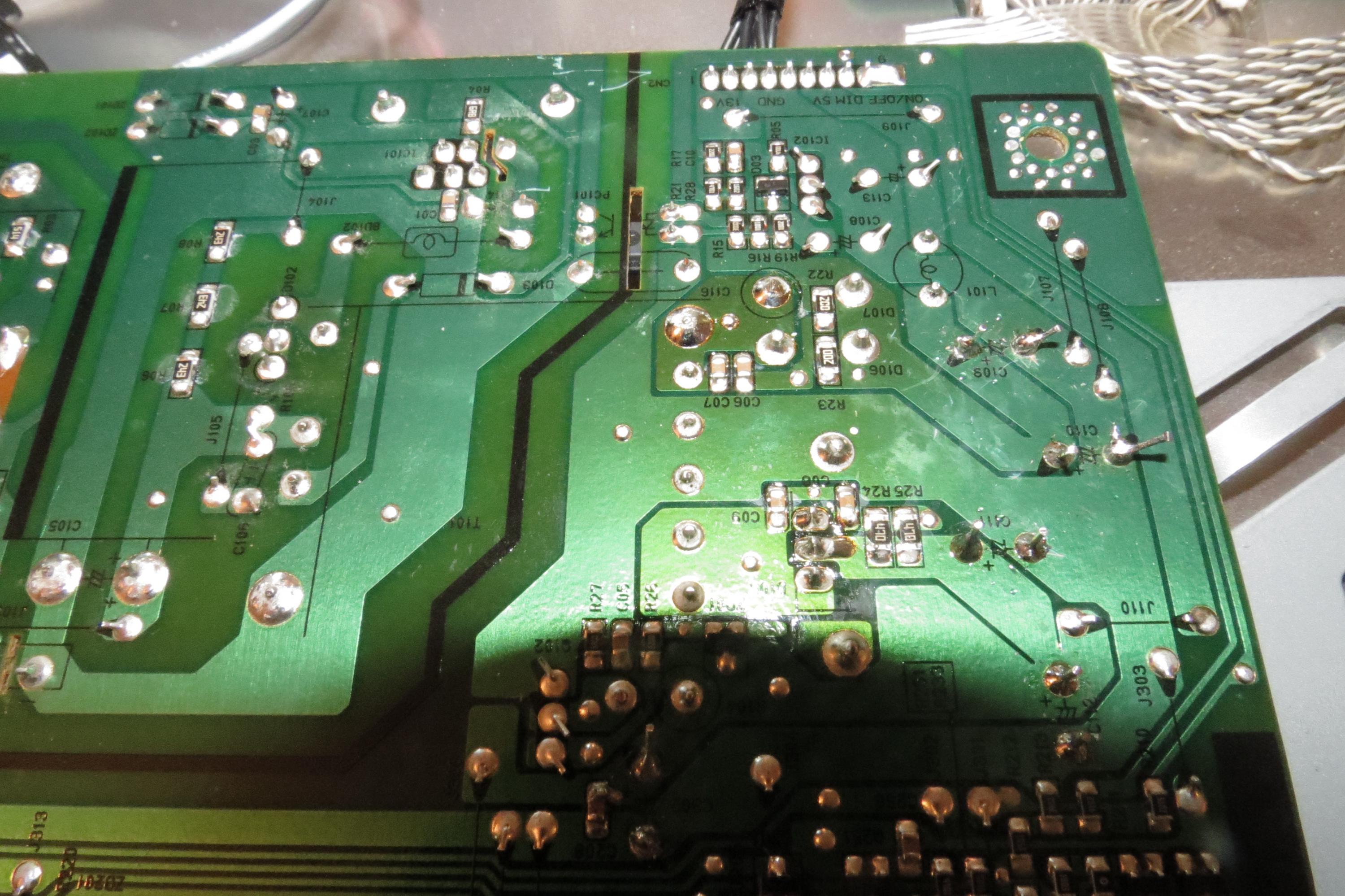

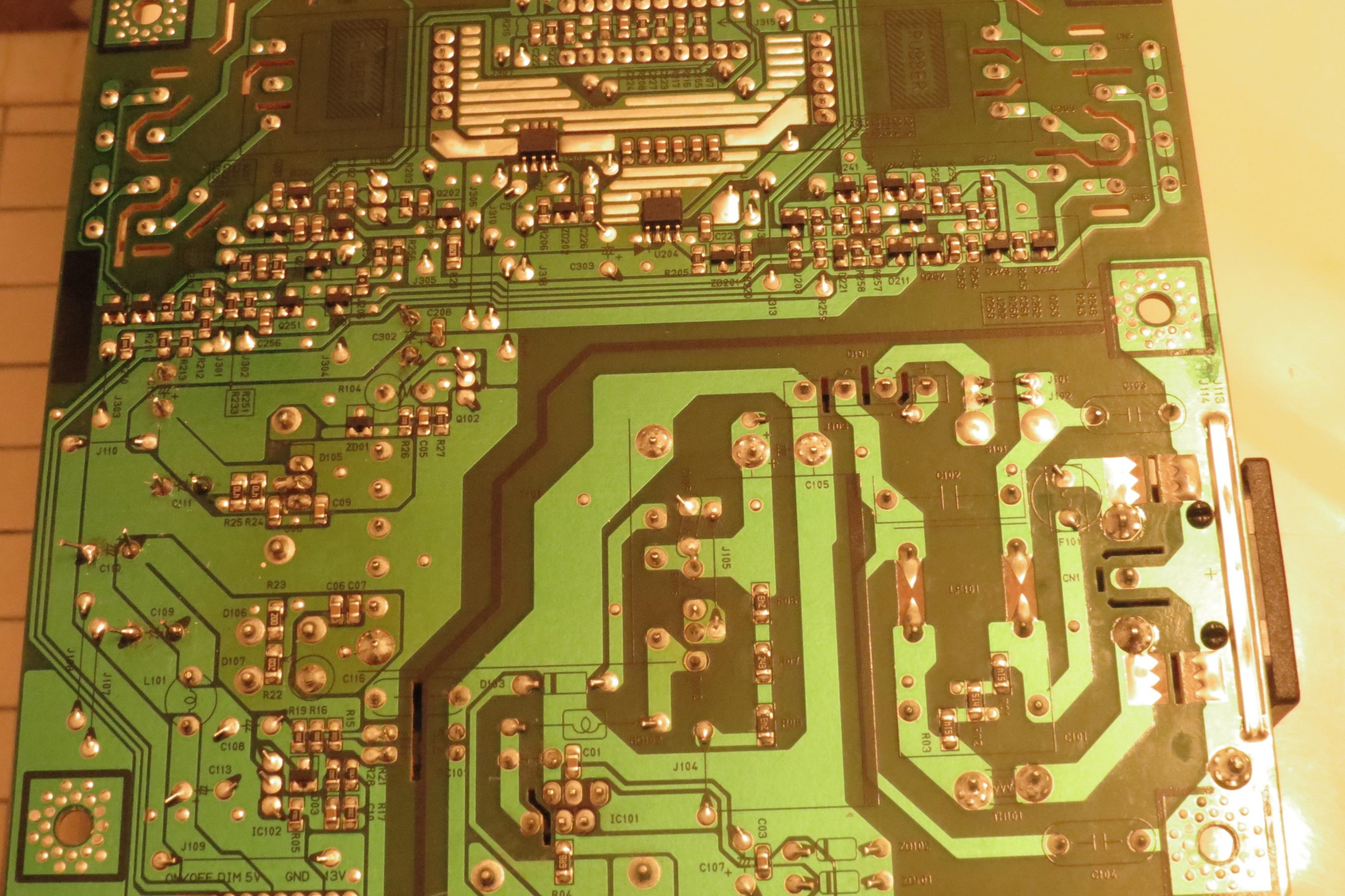

          I was able to see between the board and the panel behind it when it was positioned exactly as it's typically seated, and the leads have a generous amount of space left, so I'm leaving them alone for now.
          I tried to get a solid picture of the board, this time in another room where glare isn't as terrible. Really close shots were casting an unavoidable shadow on the board so I had to back off and zoom a little.
          And aside from simple common sense, I knew from reading certain posts here that you don't ever want to bypass a fuse, hence my telling my friend he was nuts for suggesting it. I remember at least one guy in another thread that burned up a few IC's because he got impatient and shorted one with a length of wire.
          I appreciate the suggestions so far, I've already invested a bit in the caps, a desoldering tool, and a spool of tiny-gauge solder and figured it couldn't hurt to ask here for any further advice before giving up on it. We may bring this thing back yet, and you've got my gratitude regardless!

            Great pictures, exactly what I needed!
            Try removing jumper J308 (lifting one side of it will also work). This will disable the inverter. Then put back the power supply in the monitor and try powering the monitor ON. If the monitor turns ON and stays ON (that is, you won't get a picture on the screen, but the LED should stay ON solid and not blink), then there's something shorted on the inverter. If not, then there's something else wrong with the power supply.

              Seems like a pretty good call, freed one end of the jumper (making sure it couldn't contact anything) and closed it up, and just as you said, power LED stays on, doesn't seem to be "power cycling", and of course, no picture.
              Is the likely issue the inverter transformers (TM-130's) then? Are they the ones whose windings, if they're still good, typically show a similar resistance to one another, something in the 1000 range?

                  I would say the inverter driving transistors (U204 and U205 - the black rectangular 8-pin components) are the most likely culprit for the inverter to be causing a short like that. If it was the inverter transformers or the CCFLs, the inverter controller *should* have detected an overload/underload and would have shut down, leaving the monitor running ON without tripping the power supply short circuit protection.
                  At this point, a multimeter would be necessary to check the transistors for short circuit. Or if you are feeling lucky, buy a set of replacements and change them. That, however, doesn't guarantee they won't blow again because there may be something else wrong with the inverter that caused them to fail.

                                      Re: Samsung Syncmaster 914v
                                      As momaka suggests, check your startup cap.
                                      The composition of the photo is too cropped, but I believe the startup cap is the one that I circled in red (just above the big cap)
                                      Measure the DC voltage of the cap by placing your red probe on the positive leg and black probe on the negative leg of the cap. Report your reading.

                                        Hey again folks, sorry for yet another delay, I did indeed get that job and have been prepping for the move and have been neglecting my poor monitor
                                        I had to test the startup capacitor from the other side of the board, as I can't get at the negative lead from the top. I had my lovely assistant hold it vertical and avoid grounding any components, but to get it in this position I had to disconnect it from the other board. I also still have the jumper disconnected from before, so that it doesn't reset itself constantly.
                                        The capacitor seemed to be getting up to around 10-10.5 volts (taking a few seconds) before discharging almost instantly and repeating.
